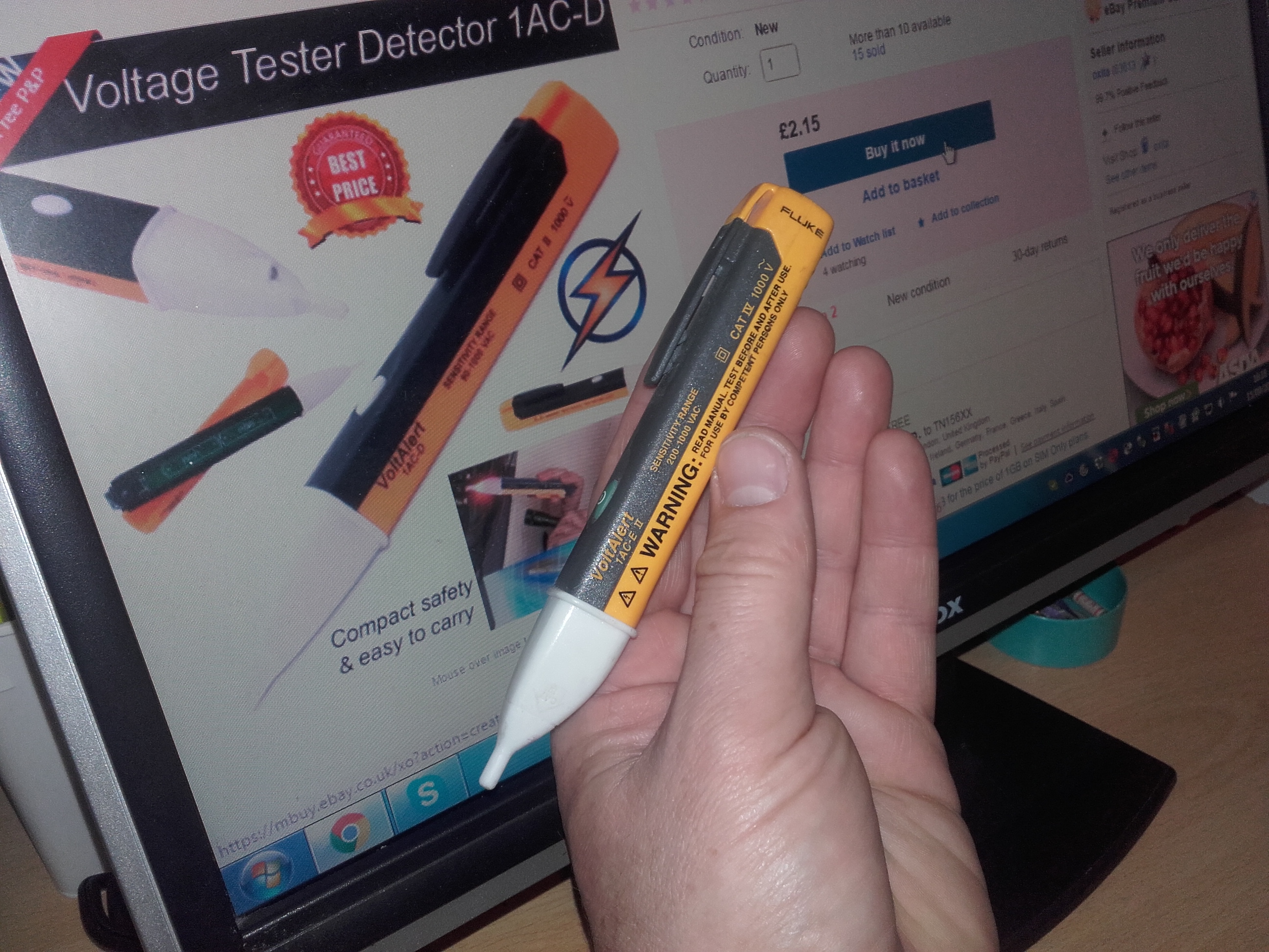

Onoff Posted September 15, 2016 Share Posted September 15, 2016 On 12/09/2016 at 14:03, ProDave said: Well if you really want cheap http://www.ebay.co.uk/itm/LED-Voltage-Tester-Pen-90-1000V-AC-Non-Contact-Electric-Volt-Detector-Sensor-UK-/131754093686?hash=item1ead27ec76:g:bTwAAOSwmmxW6Wph That's scarily close in looks to my Fluke! Straight from the Kyoto Dangerous Toy & Lawnmower Factory no doubt! 1 Link to comment Share on other sites More sharing options...
