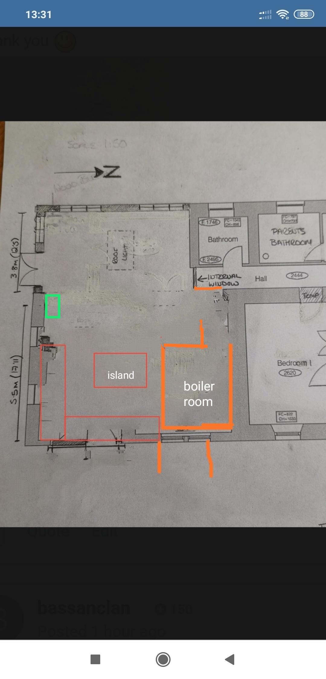

I am playing with designs and a kitchen diner at the sunniest end of the house is something we have always fancied and despite a tight budget think it is something we should invest in.  I was wondering what clever design tips and ideas people would recommend doing or any experiences/lessons learned from your own build?

Can you lose the pillar by using beams, it really impacts on the space, it might cost more, but will likely give a better room. If not incorporate it into the island, see below.
Plan out what furniture you want to put in the room and see if it works. That space outside the mud room at 2.9m wide is a little narrow if you wanted to put a table there for example. I think if you made it slightly larger you could get well defined sitting and eating areas.
Personally I hate internal windows as it makes it look like you added something to the outside of the house without doing it properly. You could have another door and make the door/s into the kitchen glass to allow light into the hall. If you made the window the door into the room it would give a more open entrance into the room. At the moment you walk into the end of a cupboard. It would be a lot neater to have the cupboards go to the end of the wall.
An island is nice, but only if you have enough room, it looks like you are showing it only around 80cm from the hob. Imagine you are standing at the hob and someone wanted to get something out of the cupboards/drawers in the island behind you, you'd have to move out of the way. I would say you need at least 1.2m and ideally enough space to open things opposite to each other which is more like 1.4m. It might work better if it was a breakfast bar between the utility room and pillar. This also removes the pillar from the middle of the floor if you cannot get rid of it.
Roof lights are good, they bring in a lot of light.

Your boiler room is taking up half the south facing wall. That is a waste.
Put the boiler room where the kitchen is show, making it as slim as possible and have the kitchen on the south wall with windows looking out to the garden.

So I am guessing that part of the south wall is the current garage wall hence the width. You won't want to change that as you would need new foundations also.
Considering you said you are on a tight budget, I guess you probably also want to keep the pillar, in which case I would definitely be thinking of moving the island to be a breakfast bar with the pillar at the end of it and moving the door to where the window it. Pillar in the middle of the floor would absolutely drive me crazy.

The pillar will have to be engineered out. It will make a massive difference to how that room works.
I would definitely try to move the boiler room. If you go something like this then it opens the space up more and will let much much natural light come in from the south facing Windows.
 So you end up with a L shape for the kitchen with the island as big as you can get but still have 1m min all round both sides the units are on. Or you could extend more units along the boiler room wall into a U shape and come across where the island is on my pic. Then you can have a wider worktop to allow a seating area.
How many units and how big your island can be will depend on how much you can squeezee the boiler room. If you can get it to 2m wide this will give you 4.3m to play with. At present you have 3.5m which will just be enough to get an island in with enough space to walk round. If you leave 1m each side plus the kitchen unit that gives you a width of 2.6m so your island can only be 900mm wide. If you make the island wider then the space either side is reduced and will feel cramped.
The stove could go where the green box is so it's easier to vent outside.

Hi @Declan52 thank you for your input. Wow, that is some space. I have no engineering knowledge but the wall you are saying to remove is the end of the house so load bearing. Would that not make it a nightmare to do and costly?  The oil tank is supposed to be in the garden by the proposed boiler room with an exhaust out of the external wall for the boiler itself. The exhaust for the boiler on your plan would come out of the front of the house by the new front doorway?
