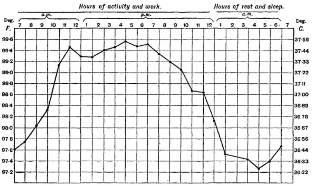

I'm convinced there's a bit of subconscious influence at work when it comes to whether or not we feel cool.  21°C indoors when it's dark, grey and wet outside feels too cool.  the same temperature indoors when it's bright and sunny feels fine.  We've noticed that this effect is far more pronounced in the early evening, for some reason.  I guess we must sense the change in light level for the time of day and that somehow recalibrates how we feel temperature.
Your body temperature starts falling in the evenings - that probably has an effect:
