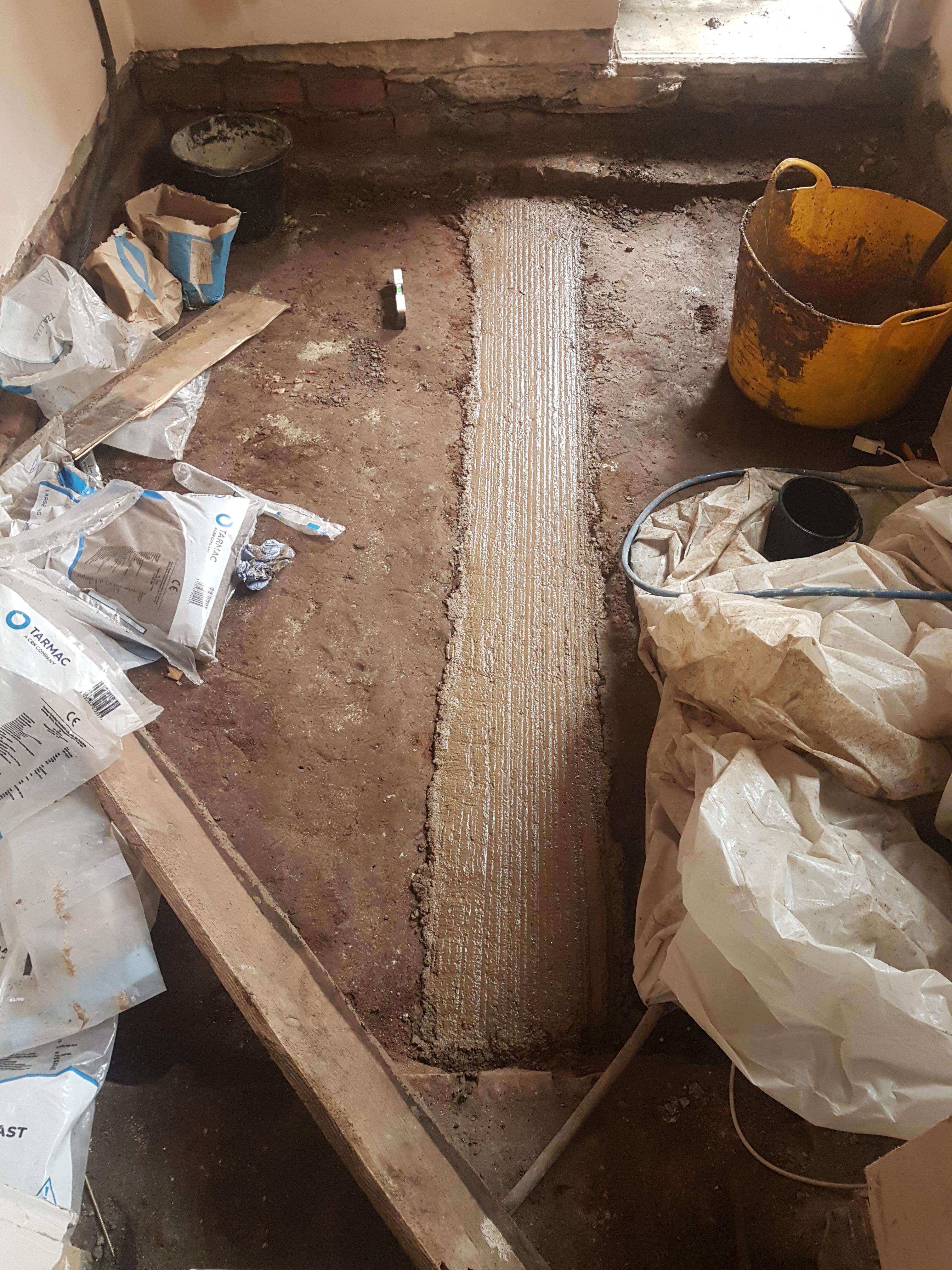

Student Posted June 11, 2019 Author Posted June 11, 2019 There's room for 150mm void below the 4x2 joists. There's certainly scope to go with concrete, it's just a bigger job than I'd anticipated and I'm faced with the issues of where to run services. Appreciate they can likely be ducted in the concrete? Is the consensus that even with a sleeper at mid-span I'm going to struggle to get a solid floor? As I mentioned, I can live without tiles if needs be. I need the floor down asap as it's holding up the kitchen being fitted. I'd originally only planned on a single layer of wbp ply under tiles. This is my first house and hopefully a stepping stone into self build so happy to accept any advice you more experienced guys. My only source of information is the internet as my background is electrical and electronic engineering.
Russell griffiths Posted June 11, 2019 Posted June 11, 2019 So quick and cost effective then dig a small trench down the centre and put a small 100mm deep x 300wide concrete footing in fix treated 4x2 to both walls with chem bolts and 12mm studs level across from both of these and build up your sleeper wall with half bricks missing for cross ventilation lay a treated wall plate on top of the sleeper wall with a dpm under it fit hangers to both pole plates on walls fit treated joists across from side to side screw down to centre wall fit 100mm celotex between joists fit vapour barrier on top of joists screw and glue down 18mm t and g chipboard glue and screw 9-11 mm wbp ply on top for your tiling ensure everything is 100% bounce free ensure a flexible tile adhesive compatible with timber floor. Good luck with your first house, 1
Student Posted June 12, 2019 Author Posted June 12, 2019 Thanks Russell, that's almost exactly what I have planned. I dug the trench last night and it didn't take very long at all thankfully. I must admit that I hadn't given much thought to insulation yet and would adding a vapour layer above the joists make gluing a pointless step? I was hoping to add heated matting below the tiles to add comfort during the winter months. Does this effect things at all? I'd also been warned off of using chipboard, hence I've bought 18mm wbp ply for the bathroom floor (prior to heated matting and tiles as per the kitchen). Is 18mm sufficient or should I be adding a layer?

Student Posted June 15, 2019 Author Posted June 15, 2019 Thanks for the info guys, how long will I have to leave this before it can be weighted by the joists from above? Approximate of course! Cheers. It's 300mm x 100mm x 2450. 1:2:6 sand, cement, gravel.
Mr Punter Posted June 15, 2019 Posted June 15, 2019 Quite a small room! You can do the brickwork tomorrow but leave a day before the plate on the sleeper wall. When you do the wall plates you may find it easier to nail the hangers on first. The joists do not need to go right to the walls, you can leave 100mm and pack those gaps with insulation / foam.

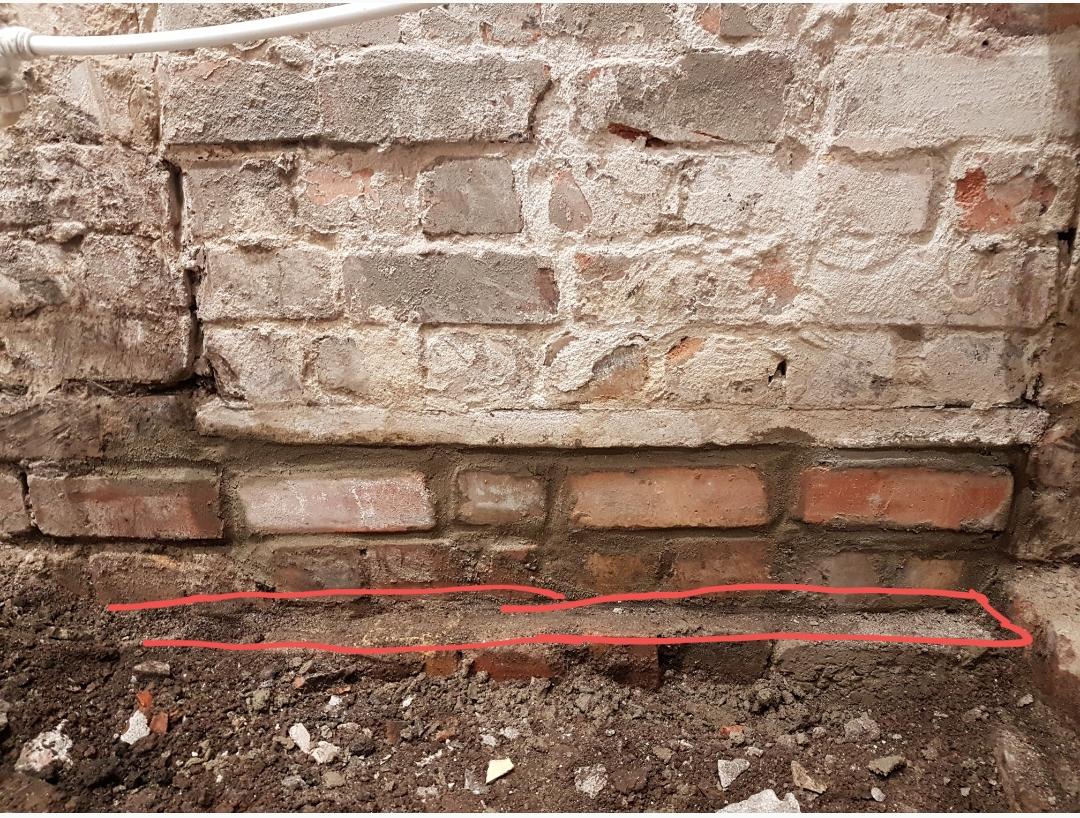

Student Posted June 29, 2019 Author Posted June 29, 2019 Guys, I've run into a problem. Such is my luck with this damn house, the fixings for the ledger plate, if put centrally in the timber, is pretty much in the mortar joints between two courses! ? So frustrating. Is it OK to have the chemical fixings off centre? Thanks
PeterW Posted June 29, 2019 Posted June 29, 2019 Stagger them alternate 50mm from each edge - I think this is stronger anyway.
Student Posted June 29, 2019 Author Posted June 29, 2019 19 minutes ago, PeterW said: Stagger them alternate 50mm from each edge - I think this is stronger anyway. Problem is that it's a 100mm plate, 50mm makes it central. Never easy!
Student Posted June 29, 2019 Author Posted June 29, 2019 20 minutes ago, PeterW said: Can you not make the plate 150..??? Good point. I could do that, thanks! I'm starting to think it might just be easier to build some little walls at the joists ends instead of using ledger plates. Any issues with digging some small strip foundations parallel to the footings? Or better suggestions (other than fill the thing with concrete, ha!
Student Posted June 29, 2019 Author Posted June 29, 2019 Remember that the thing preventing concrete is that there's not enough depth for all the required layers and it'll be so much effort to dig down. Just can't face that right now!

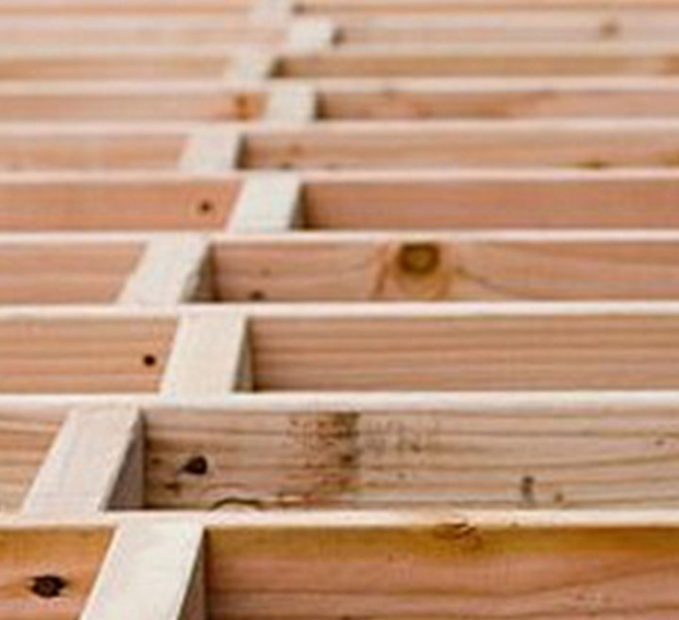

PeterW Posted July 17, 2019 Posted July 17, 2019 Nail it all and it will be tight. Have you nogged it too..?? Glue and screw the floor down and it won’t squeak.
Mr Punter Posted July 17, 2019 Posted July 17, 2019 Are these the hangers in the other thread? I can see that the ones on the right are not in full contact with the ledger board. Continuous blocking pieces of the same section size as the joists run at right angles will fix any wobbles. Maybe do this 300mm from the iffy hangers.
Student Posted July 17, 2019 Author Posted July 17, 2019 1 minute ago, PeterW said: Nail it all and it will be tight. Have you nogged it too..?? Glue and screw the floor down and it won’t squeak. Thanks Peter. I've got timber to provisionally add noggins at mid-span (ish) but it's a very short span at 2.2m and I plan to seal the EPS insulation with expanding foam as advised on here, so I'm wondering if the noggins will be much use? Joist centres are really close at 350mm and there's a sleeper wall supporting at mid-span. I've pretty much taken every action possible to make sure it's solid and it'll be heartbreaking to have it squeak in places when it's stood on!
