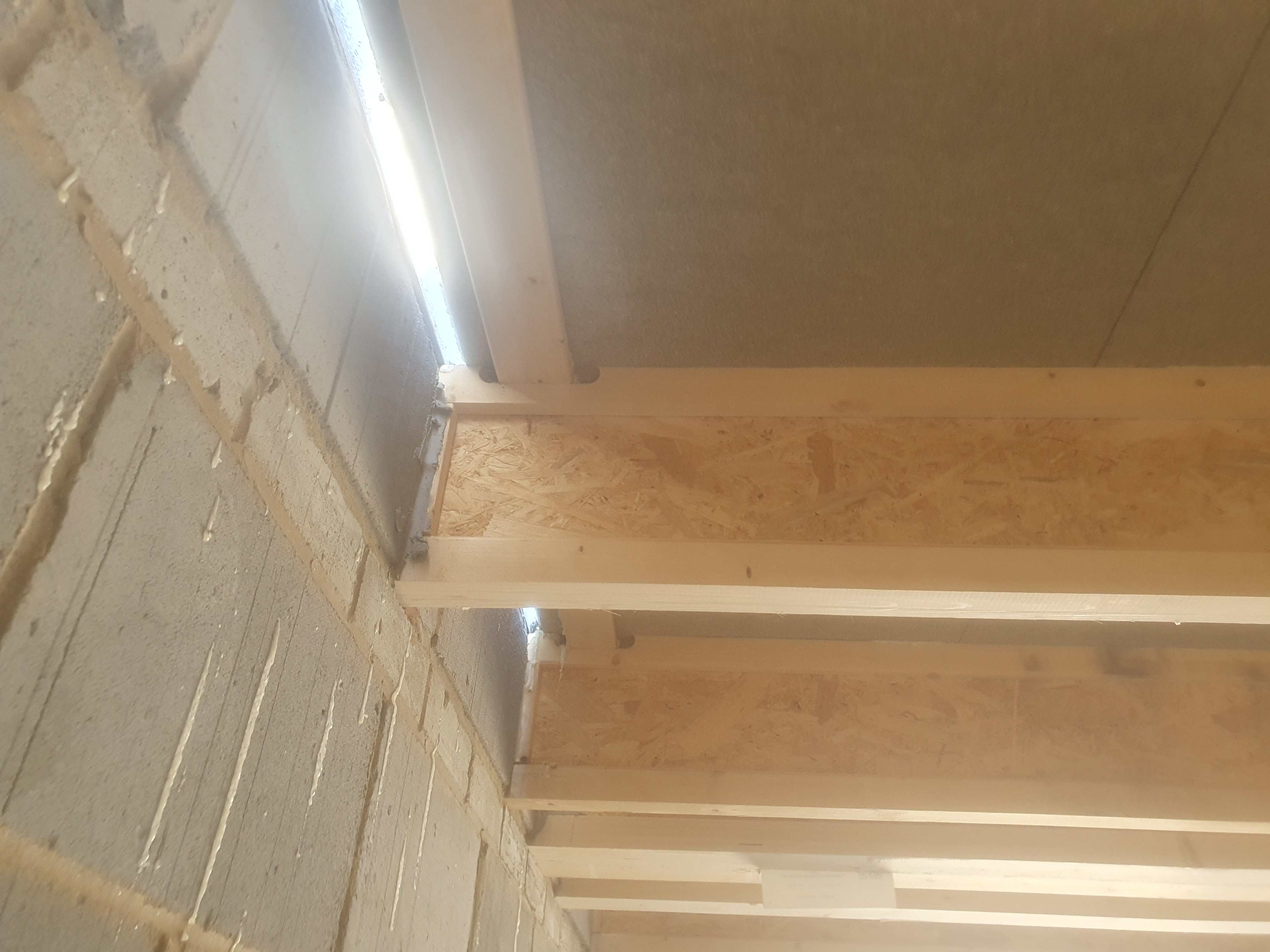

I-joists pre notched for support beams?
Moonshine replied to Moonshine's topic in General Construction Issues
So they actually are manufacturers notches (from Staircraft), saves time having to put individual noggins in between joints if a single piece of timber can be fixed in https://staircraftgroup.com/kb-post/i-joist-notch-installation/ -
Cheers Nick, just to be clear it's not my site but one a visited for work related reason's. I have been to a lot of sites too and have never seen this. It is a neat hole and that what made me think of the manufacturer. May ask the SM about it. -
I was on site yesterday and saw a standard i joist, but with a notch taken out to allow a support beam. Is this allowed and done by the I joist manufacturer, or done on site? Seems strange to be cutting into the main beams of the I joist.
