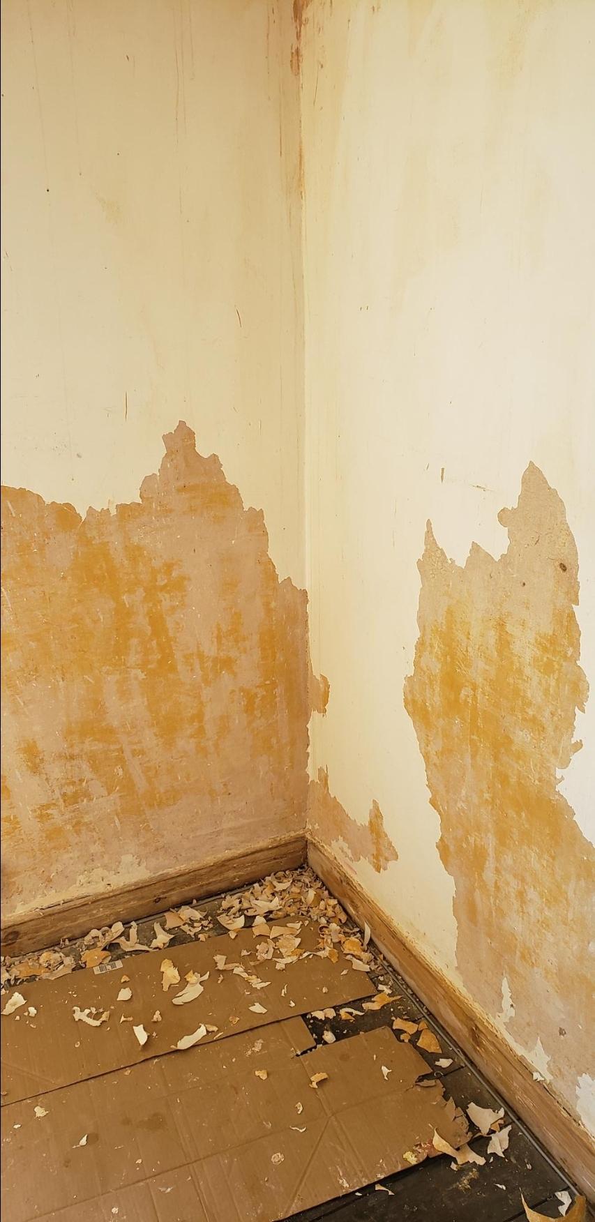

  5. Thanks! Would the dark yellow parts be the residual wallpaper paste you mention? sugar soap from asda OK? do I need to seal it once cleaned? Thanks for the advice, much appreciated.
  6. Hi All! I would appreciate some advice please. I'm currently prepping one room for decorating. It is currently painted and since it is peeling off - I assume it was not sealed before being painted! Also, the person who had the room had a guest that always kept the door and windows closed and ate in there etc. - no fresh air, so some of the room developed damp or mould patches. It grew onto the paint and once the furniture was moved, you could see it growing through. So, I found out it was peelable when I was trying to remove these damp/mould patches. The pain just peeled off with some relative ease - some areas more than others. I attempted to peel most of it away, so my questions are 1) it is not new plaster, but would it be an idea to seal it anyway? (the areas were the paint has peeled off) before lining it - which will then either be papered or painted 2) do I need to wash the areas with some sort of mould/damp killer, where the mould/damp was growing as I can see stains of it on the old wall/plaster - but ever so slightly 3) do i attempt to peel away as much of the paint as I can or just peel away the affected mould/damp areas? Prior to being painted - it had been wallpapered - wallpaper removed, then painted. Any advice would be much appreciated. I have attached a photo.

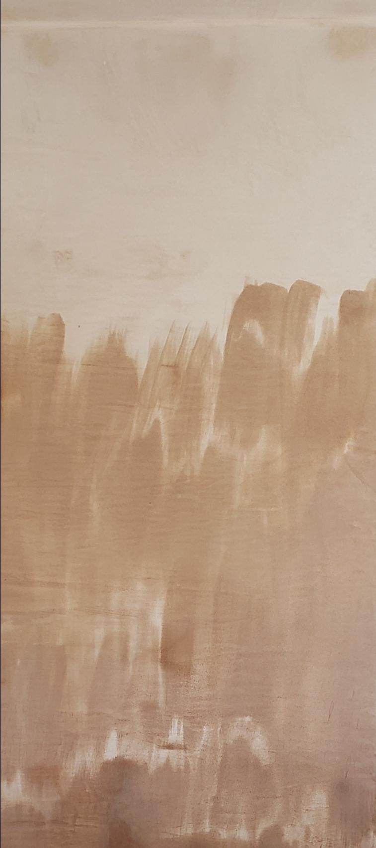

  10. Hey All, I'm in the process of sealing/priming my wall which has new plaster. I have used some sealer/primer and diluted per the instructions. When I diluted the mix, it just looks like gloopy water with floating Philadelphia cream cheese in it. Is it supposed to look like this? I stirred it as much as I could, but I do not have one of those professional mixer type things. So I hand mix and the cream cheese is melting in but it is still a bitty in the solution. I start putting it on the wall, and it is clear - is it supposed to be clear? or white? then when I go over the wall, it soaks into the plaster and it shows me where I have applied the solution, however, some parts ( see photo), you can see areas which look dry (not the top of the photo as that is actually dry), I started applying bottom going up, and where I have applied all of the bottom parts, it looks completely DRY like there is nothing on it. Like it is repelling it. But I for sure have applied. Does anyone know why this is? Also, how many times do I have to apply this diluted solution/primer? I am nervous I have done this all wrong now, with it not being fully mixed in - I watched a YouTube video and they called it misting and the solution after dilution, still looked thick, but one guy used a lot of emulsion and a jar of water only...so that might be it? Help please!

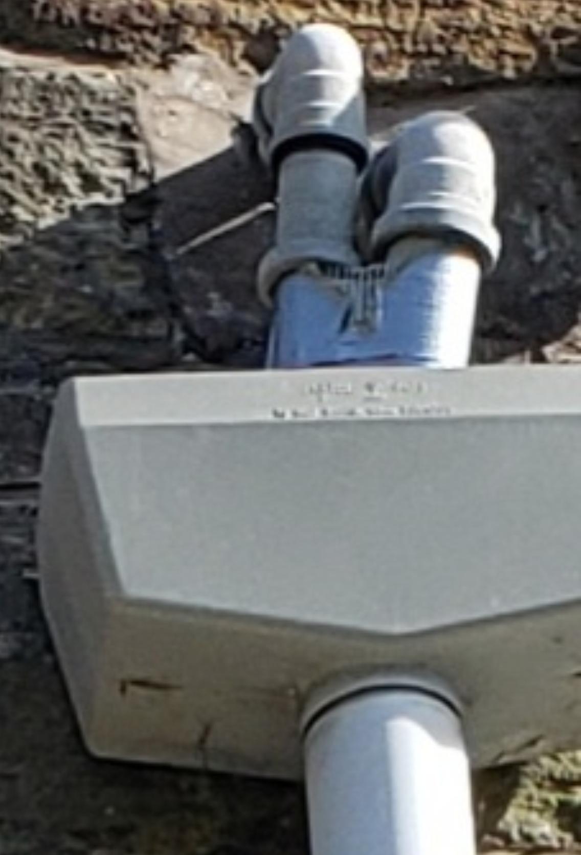

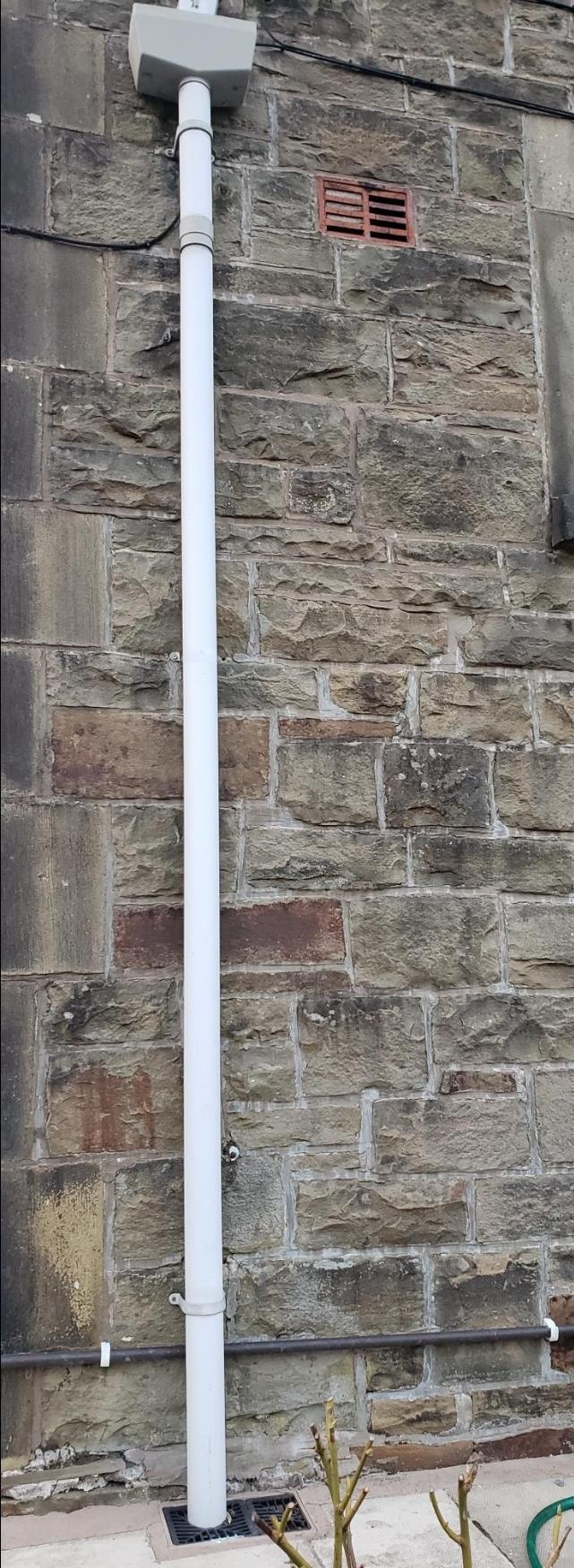

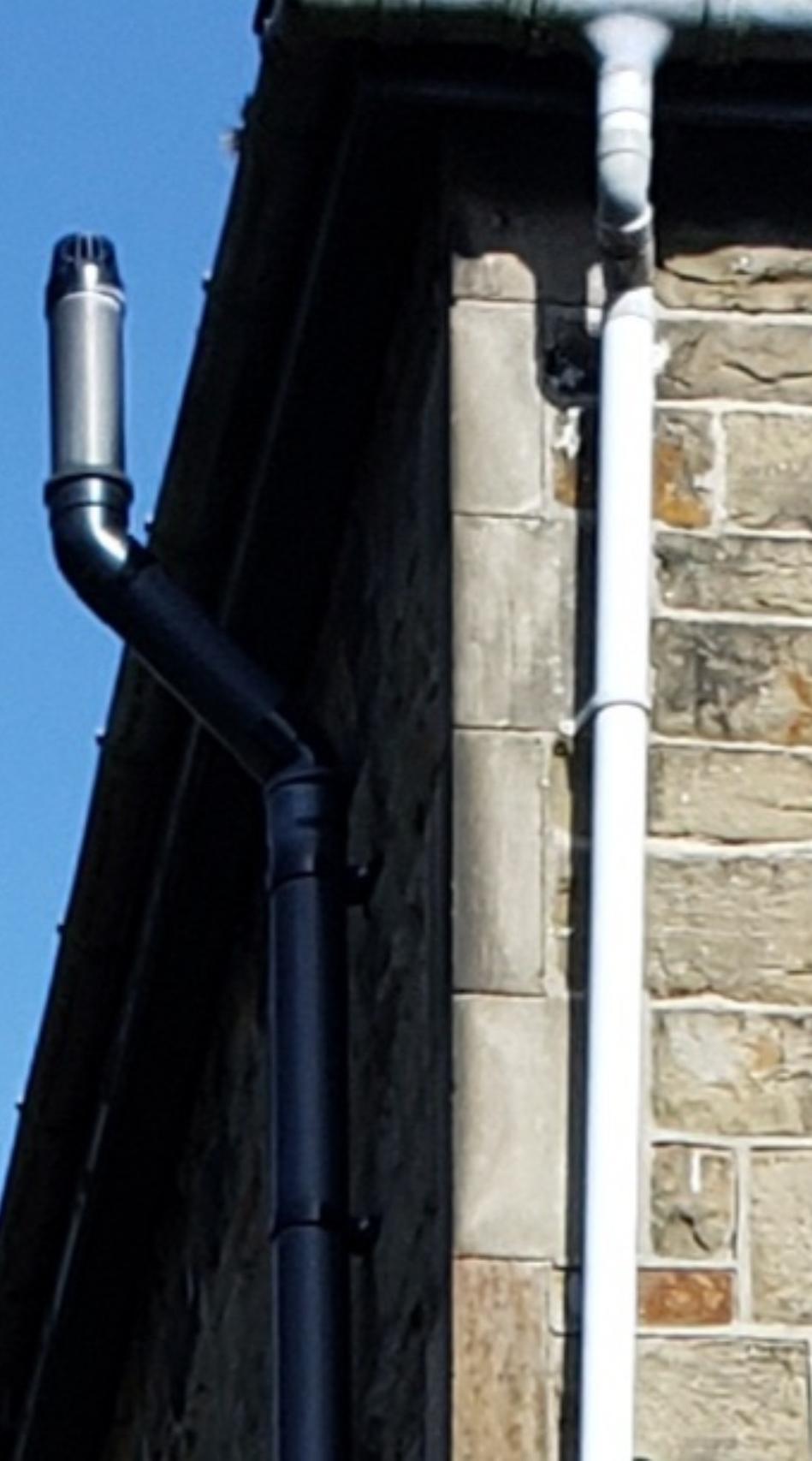

  12. Hi All, Just following up with another image I mentioned yesterday about there being two pipes going in the bucket thing (what is this called anyone?), zooming it, it seems that it is duct taped together!!. I am guessing one is the sink water and one is the bath water pipes? Here is a photo of a nearby house who have a toilet upstairs - we cannot ask who did their pipe as it was carried out by the homeowners who lived their previously. It seems a lot of the pipes in other nearby homes look similar to this but some are different. I think it is the black pipe. is that the air admittance vent you mentioned? one of the fellas who came to quote said that is there so bird's don't nest in it. I'm not sure if this piping is done well or not as another fella commented on the same.

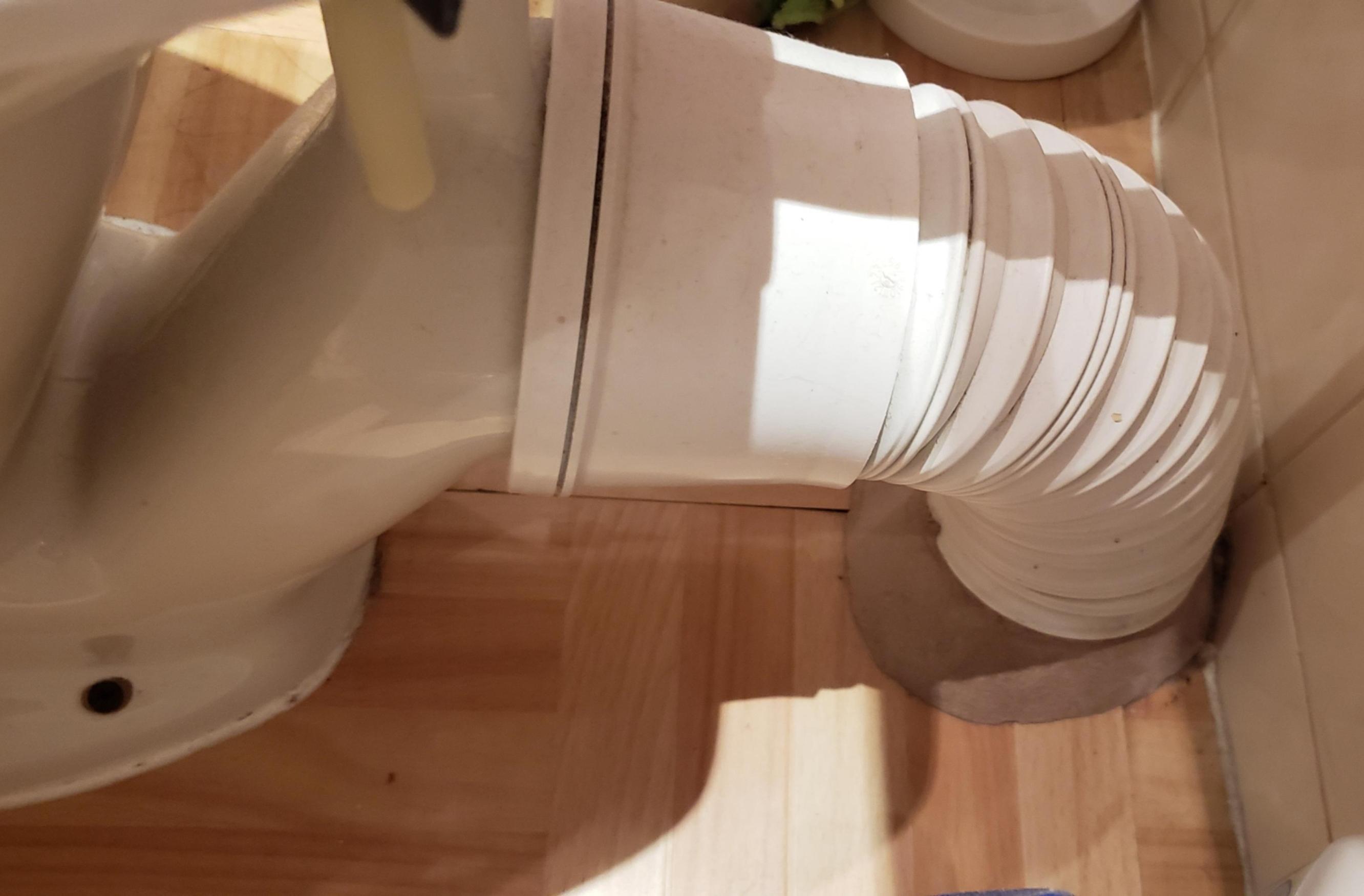

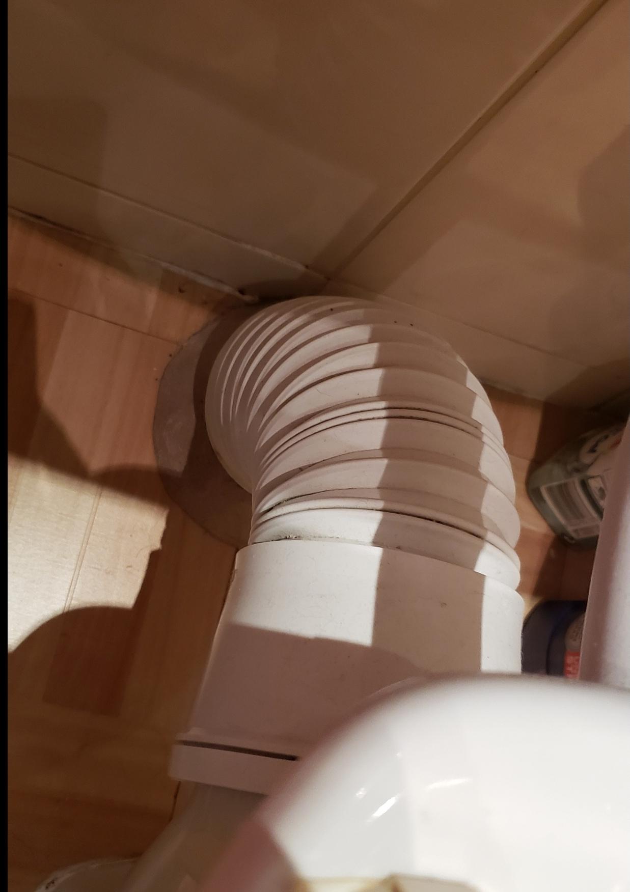

  16. Thanks for your advice and information. It is very useful. I managed to take some photos to show you the existing downstairs WC. Pardon the dusty images ha ha. I have included two photos of the internal pipe of the toilet downstairs. We actually got this fitted about 17 years ago. I don't particularly like the pipe they used but the fitter is the neighbours son (who is a joiner), don't even get me started on that blob of plaster/cement... The original toilet was one of the old style types, I don't actually recall seeing a pipe on the old one, just a little pipe running up the wall which connected to the cistern and a pulley thing to flush! The third photo is of the outside of the WC. I hope this makes sense. Apparently, the soil drain and fresh water drains are separate and not combined like what is more common these days.

  18. I'm not sure what a stub stack is. Surely, if it is easier to run a new stack up on the outside, the ones that have come would of said? I would I need to specifically ask for this? (as if I know what I am talking about! ha ha)
