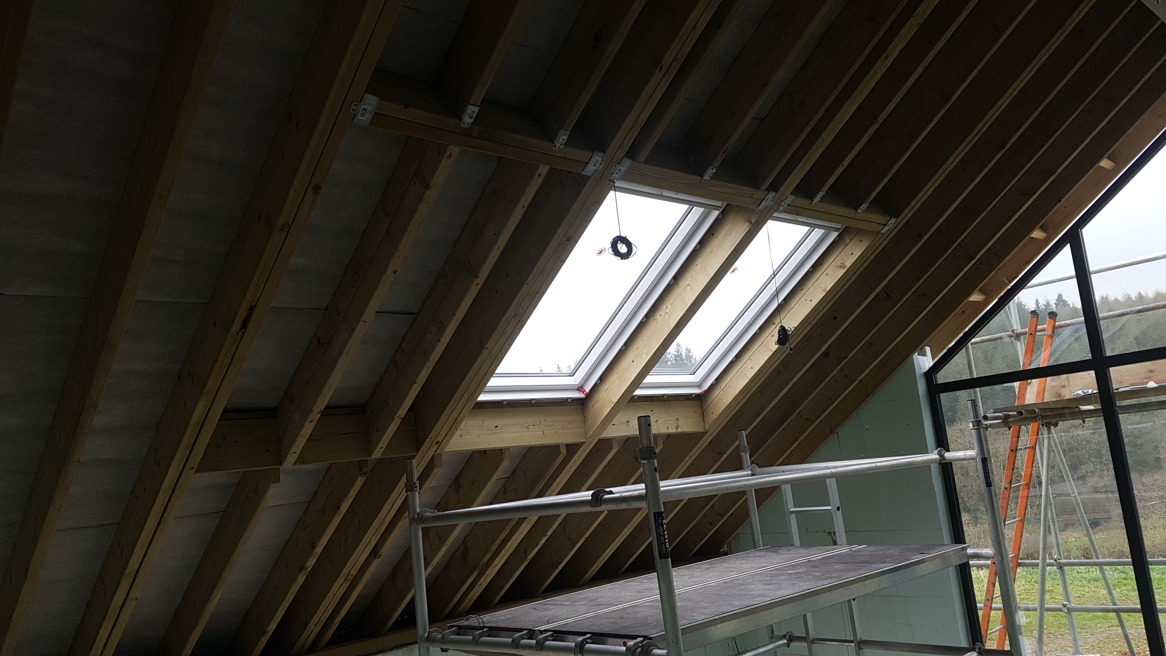

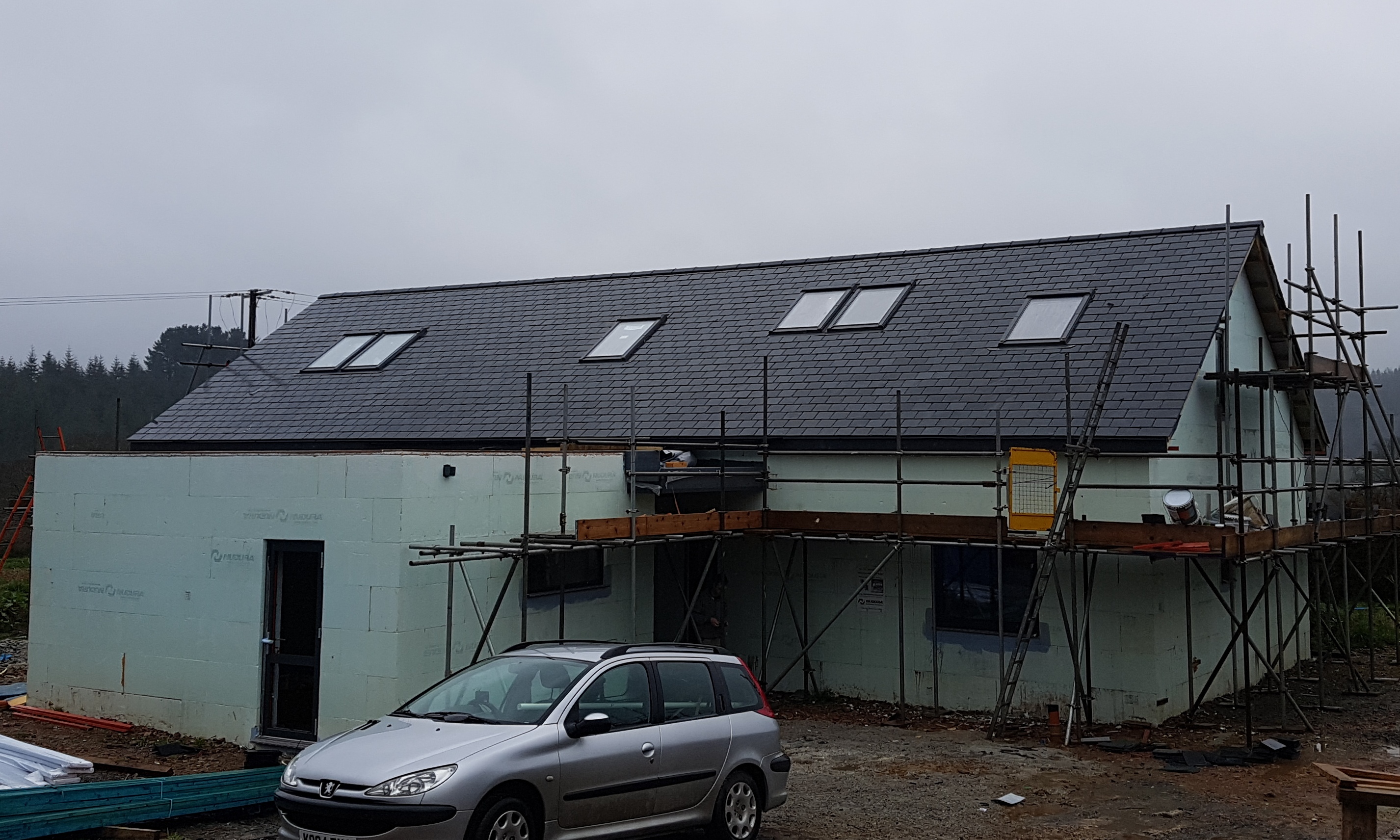

After messing around for a few days looking at options it basically came down to a cost and time issue. I didn't want to spend more money as over budget in a number of places! () and putting cost implications to one side all of the options were going to take time and therefore delays. So I took a pragmatic approach to this.... ( see pics) The slating is now done and the roof looks great, just got to find the time to get the fascias and soffits finished now.
Hi All, Issue cropped up today when getting ready to slate the last of the roof. When we reached the roof light opening and were measuring up to batton out the openings we realised that the openings are to big for the Keylite Combi flashing supplied. Basically the flashing requires max 100mm between openings. However due to info given to me by Keylite I've allowed for tolerances on each of the openings so middle opening is approx 45mm to wide since it turns out the middle opening doesn't allow for any tolerance with this flashing kit!! I need to move the twin rafters over by this amount. Options: 1. Strip roof, gutters, fascia and soffit, cut out trimmers and then add new full length rafter (birds mouths both ends as seated in web of steel ridge beam and wall plate) and then cut out rafter in the way. Add vertical trimmer on far right to maintain spacing 2. Come up with a way to cut out part of twin rafter (XXXX in picture) and add vertical trimmers (white boxes in picture) I'm posting as my structural engineer was busy on another job and now it's the weekend so have no idea what I should do. The roofers were going to be finishing off this last section tomorrow (sat) which would mean that the roof is finished and they're due to start a new job on Monday! So may be a couple of weeks or more before they're available to help finish off... The spec by engineer is for twin rafters between windows. If I cut and trim as per the picture it would mean that there is only 1 continuous rafter but with the amount of structure around it to my untrained view it should be ok! I'm a mixture of annoyed that I was given duff info months ago and stressed as I can't afford any delays at the moment (mainly due to needing to get to weathertight stagepayment!) I'm resigned to having to chase engineer on Monday but hoping I might get some ideas / reassurance before then that I don't have to go the extreme of stripping the roof to move a rafter 45mm!!!
