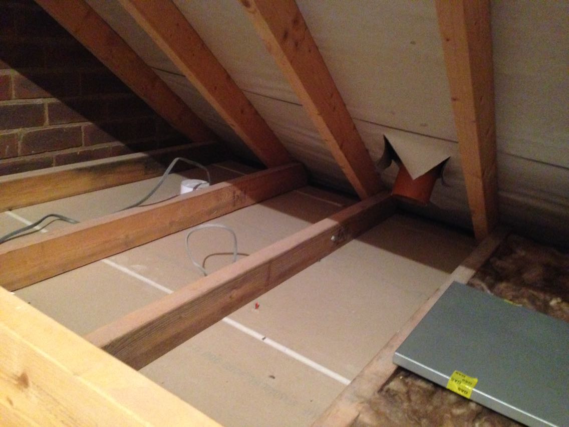

Why? This is just an accident waiting to happen
In the picture the 2 loose cables on the left are for lighting and the cable clipped to the joist along its length is another power cable. This is the one Dave suggests is unclipped and left on the plasterboard

To be honest I'm not sure if its ring or radial or whether that would make a difference. It is only this one cable that is trapped by the joist that I am really concerned about. Also aware about accessible cable connections and MF for inaccessible. If I did lengthen the cable, I'd probably run the cable along the purlin way above the insulation. As such, although its the loft, I understand I could use standard screw terminal JBs as it is accessible. This or this would be fine? http://www.screwfix.com/p/chocbox/54936 http://www.screwfix.com/p/debox-in-line-connector-box/8692h

No offence to electrician's here but they're all daft. That's what the book says but in the real world, what should I do? Over? Under? Putting the cables in contact with something as a heat sink (spare UFH spreader plate)? Chop and add a length with JBs either end?

The transverse cable is through a hole in each joist so cannot be laid on the ceiling.

But this is new build... christ the 1960s wiring didn't even give me a socket in every room. back to cable placement, is under insulation ok?

Why do electricians never allow enough slack on loft cables so they can be raised above 300mm of insulation. Its not as if 10”-12” of fluff is the cheapest and quickest way to meet a government requirement, oh wait… I’m not too fussed about the lights, low load, yadda, yadda. However the electric sockets for this room are distributed via the loft not under the floor. I’m not sure if it’s a radial or a ring main circuit. One of the cables has actually been fed through a hole in the ceiling joists. This seems like complete *******ery to me, when all the other cables are laid above the joists. As well as the unnecessary damage to the joists it makes it difficult to lay the insulation as there’s a 50mm gap between the cable and the ceiling. I either squeeze the 100mm loft roll under it and lay 200mm above it or just put the full 300mm over it leaving a small air pocket under the cable. As I understand it, the cables should be in contact with a surface like the ceiling or a joist OR they should be open to the air so as not to overheat. Although you would normally consider a bedroom to be a low electrical load room – I must consider the use of more than one high load device: hair dryer, straighteners, curlers, rollers, iron etc. I’ve slapped 100mm of roll over it for the moment as it was bloody cold without it but I wonder what is ALARP before I put the other 200mm over it?
