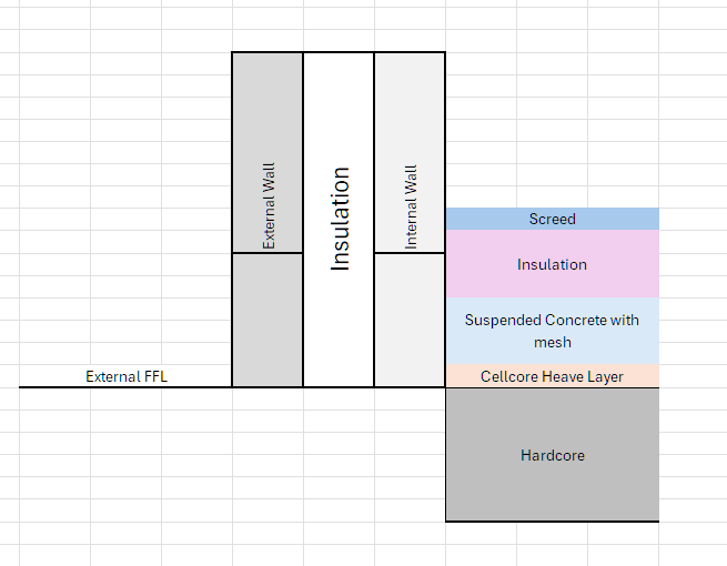

  1. Right, a question about the DPC in the internal cavity wall and the DPM under the internal floor level. We have the internal cavity wall built to what we planned to be the DPC level in the wall But, due to the build up of the floor being suspended on the foundation by the time we put the insulation and screed on top of the slab the GFL will be higher than the DPM Please note this is not to scale, just to show what I mean, the external FFL is 150 below the DPM rather than a whole block. So, we need to have DPC in the wall with the sheet under the insulation, I know we have to have some insulation running beside the screed as well, but just not shown here. The plan was to place the DPC in the wall with a 'skirt' to be joined to the DPM sheet, but is it okay to have some of the insulation and the screed on the internal wall above the DPC Or, should we put the wall DPM a block higher so it is all wrapped, we have full fill insulation of 150mm This would mean that the external and internal DPM would be at a different level. FYI, the only thing in situ yet is the suspended floor and the internal wall to planned DPC. The brickie is starting on the external wall today. One of the things we need to do with these levels is conside the level access for doors, but we plan on doing this will a gently sloping ramp and French drains. TIA

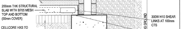

  15. Hi, we went thru the B705 v B785 a while ago, the SE just didn't update this bit of drawing. They also provided full details of the mesh and Shear Links, I just didn't know what they did, so I was trying to educate myself. They have designed the mesh to go in a particular direction, basically side to side, although it is only the sides that take the weight all 4 sides have the rebar on top. The conversion has 3 sizes of rebar in different areas, underpinning in shallow foundations and secondary foundations where they don't think there is enough bearing size for the rebar. All in all quite complex drawings, not helped in the least by them making typo mistakes like B705 when I'm trying to get best price. Thanks for you help.

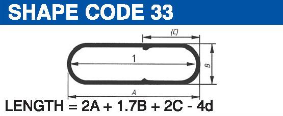

  17. Still getting a big bogged down on our suspended floor. Our SE drawings were fine, until we started to clear to underpin an existing single skin wall only to find it wasn't attached to the ground so was not viable. So, after all the hoops that involved getting permission to replace some unstable walls, which appeared stable on the initial class Q conversion survey. We then continued in our merry way and dug out, trench approved, and poured foundation. BCO came out as he wanted to check our mesh suspension and then insisted that we had new SE drawings to cater for cavity walls. Some cost and lots of time later we have the drawings as requested. All fine except he's included shear links. More back and forth as these seem to be unusual, we eventually got the code H33 and have found them. Apparently the H10 in the drawing just means bumpy steel. Right, my question, what do these actually do and what does 100mm cts mean. I guess they sit 90 degrees out from the wall partly on top of the foundation and partly within the mesh. This is for a single storey barn conversion, not the rebuild of Luton Airport carpark Any info greatly received.

  20. we have a reinforced 200mm concrete slab with 2 level of mesh. The cellcore goes 'in the hole' sitting on top of packed hardcore and blinding sand. The mesh then sits on the foundation trench (all 4 sides) with castles to keep the layers apart and the concrete poured on top. The bearing is 200mm with the cavity wall outside it, foundation is 700 wide. We then have 200mm insulation with screed on top, so total floor depth is 550mm, so very deep. We have a DPM above the slab and below the insulation with a VSL above the insulation below the screed (with UFH). this was all specified by our structural engineer, over engineered according to our BCO for a single storey property, but as that's the spec he says we must have it. so, it's not tied in as such, but when the slab is poured it will adher to the foundation.
  21. I wouldn't think you want DPM under cellcore, the whole point of it is to crush if the ground heaves. We have cellcore and in the recent weather we flooded and if the DPM had been under the cellcore then it would have become a swimming pool with no where for the water to go to. In fact we have the DPM over the slab and Cellcore with the insulation and screed on top. Where is your floor insulation going. out cellcore sits inside the foundation with the suspended reinforced slab resting on the foundation. But, ours is a whole house, maybe a garage is different.
