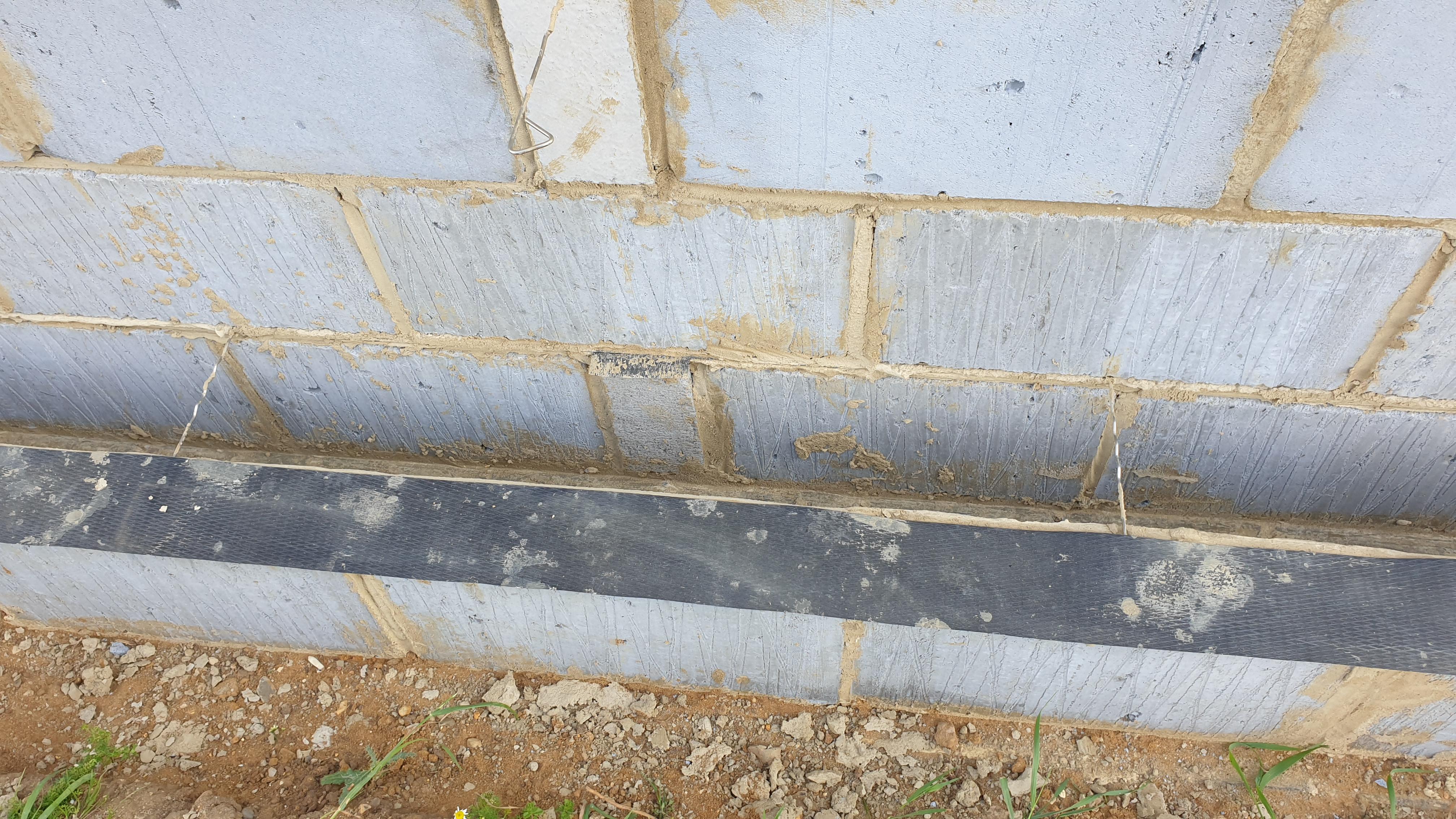

  20. LSB
    DPM on mortar
    our build is single story, but we are also planning to put mortar on top of the DPC We were just surprised that it was didn't take at all. Well, now we can carry onwards and upwards.
  21. Our DPM has been laid on a bed of mortar on blocks. This was done Mon / Tue and was left with loose blocks on top to weigh it down. But, the DPM hasn't adhered at all to the mortar, should it or will the weight of the walls just hold it in place and keep the walls stable. See below how it looks when we took the block weighing it off. It's the same all along Standard 5:1 mortar
  22. no, block / block
  23. depends on what ?
