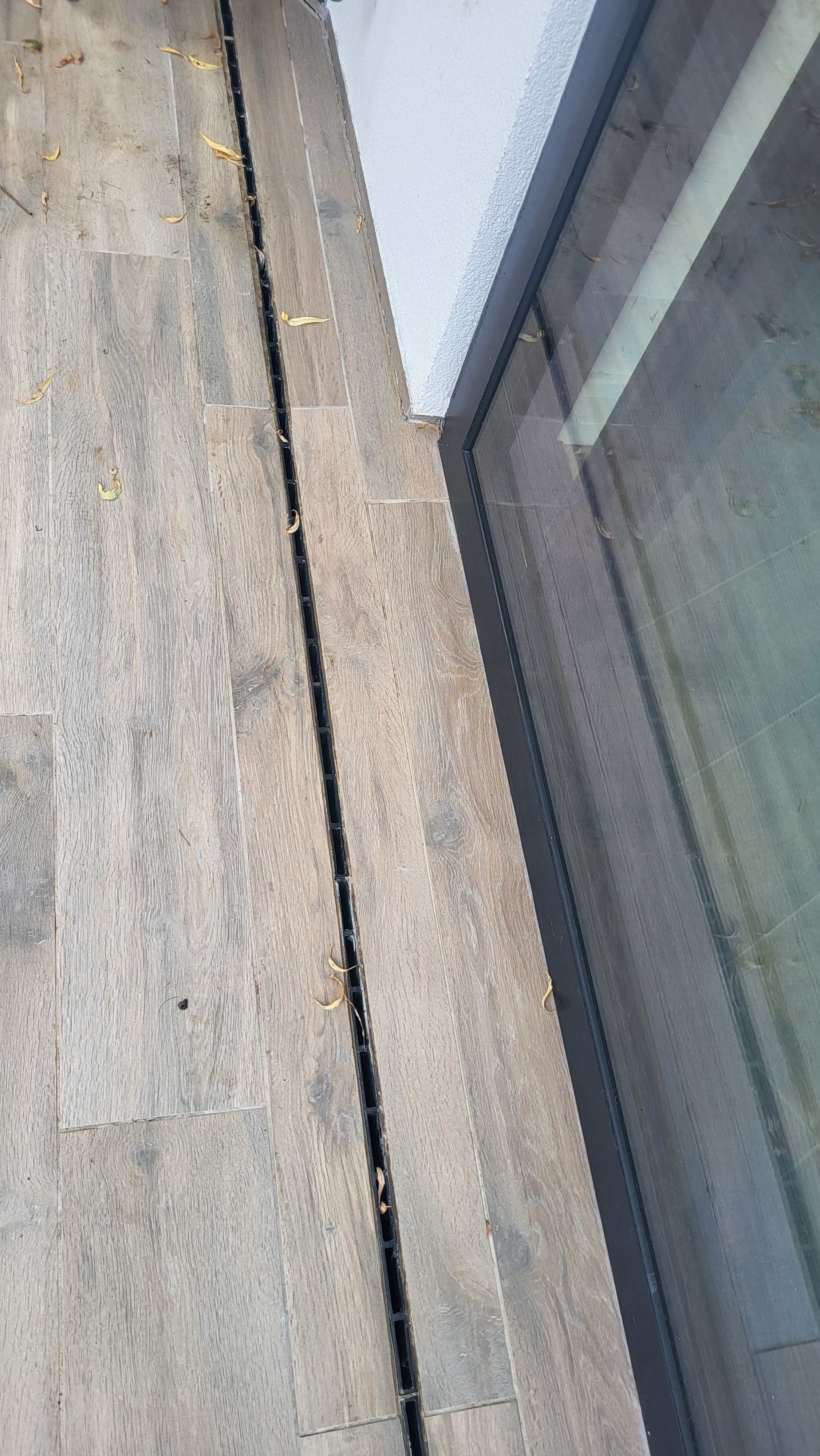

  1. Pretty sure the two drain thing is to ensure that if there is ever a blockage or excessive flow, it cant back up into the over flow. We have it going into two drains, that then combine into the same as it exist the building into an external drain. No issues in 2.5 years of operation.
