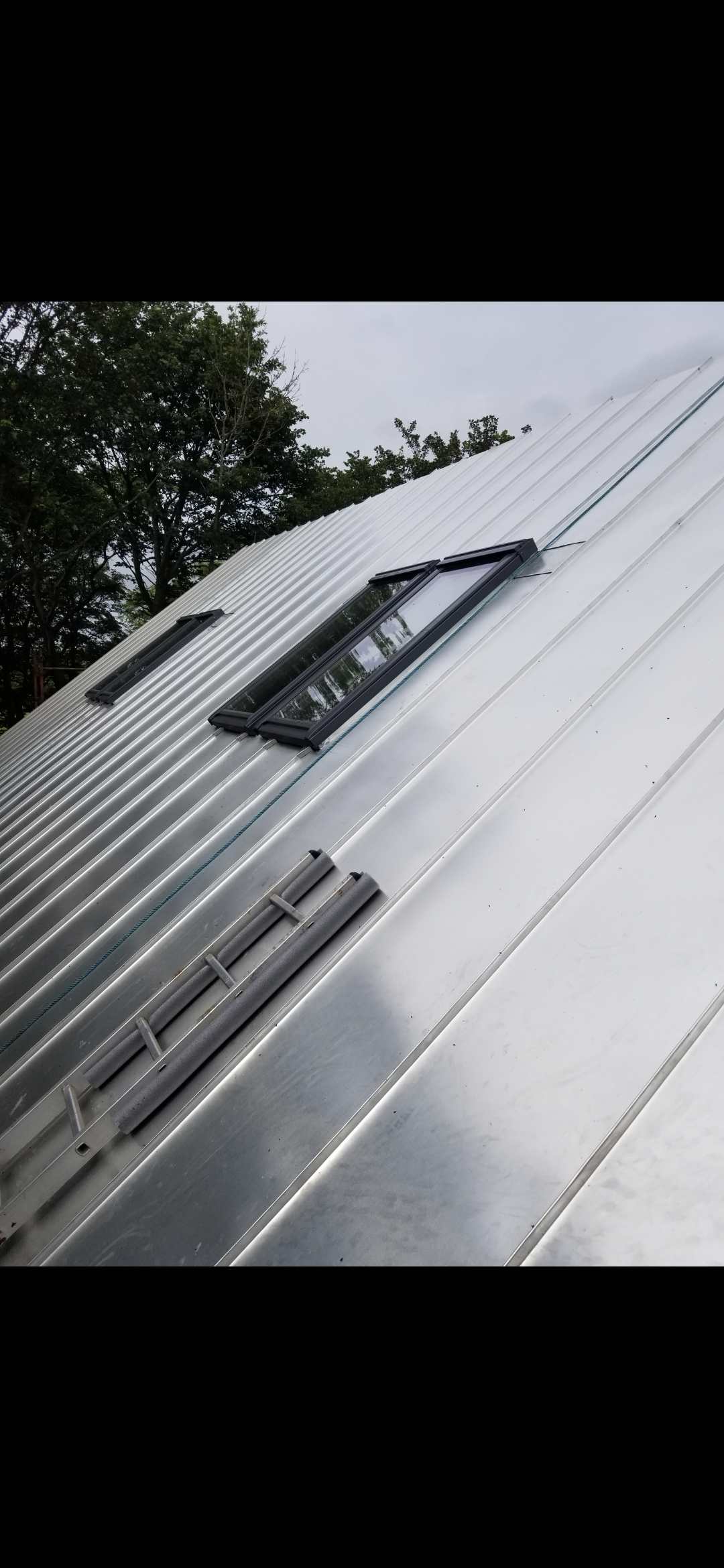

Self installation standing seam roof options
Alexphd1 replied to flanagaj's topic in Roofing, Tiling & Slating
We diy'd uginox stainless steel standing seam. Lot of work. My auld man done a two day training course at Bolton with metal solutions who we bought most of the tools from. Not sure if was financial worth it for one Build but were doing two self builds.- 1 reply
