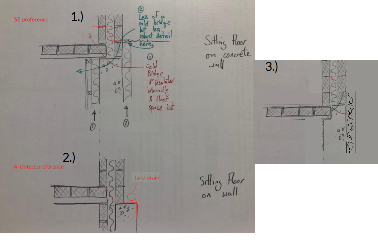

Yeah I agree its a good idea to protect the tanking, as I am sure I will have to purchase some other thin board otherwise. So I have 3 options overall to choose from and it all comes down to what is the best method of insulating and reducing the cold bridge whilst ensuring there is no sloppy looking termination detail around the base of the house

tanking is going externally for this. There are some other images earlier in the post showing insulating options which is what I need to decide on.

We could create this, but it is more work and the same as it sitting on the top of the wall. Maybe this below reduces any bridging..i dont really know

The SE wants 10n blocks he said, so I have also added on a little for the extra scaffold too. The walls are going to be 300mm at the moment but he may push them up to 350mm if we use the concrete walls. That extra 50mm increases the concrete/sika mix by £2k So the trade off is the saving on not using the internal block work compared with the external insulation termination detail....plus I gain more space internally without the block, but it is a large house so wont notice it in the basement. And....extra space means more ££ on tiling as we have a large pool area to tile ICF...I have looked into it and I prefer the poured concrete. Not priced ICF though to be honest.

My SE has said he is happy to progress using the blockwork as structural providing we use 140mm block. So I have 2 options available at this point 1.) Use blockwork internally for ground floor support, this means I have to install 210sqm or over 2000 block in the basement perimeter. unbroken insulation zone 2.) Use concrete formed walls as support, which means I do not have to use any block in the basement. Walls supported on 1st floor from internal block. Insulate basement externally I am tied between the two options because option 1 will cost me £10k more minimum in block and labour. We have standing water according to SI report at 1.5m so not sure if insulating externally is the best option either.

100% agree and in this case we have other SE opinion who said although a steel frame will work fine, its not necessary

Architect is saying professionally he cannot disagree, and the SE is in review again, however I can echo my thoughts after consulting with the builders and from what I am hearing there are really no issues building up off the block wall as per the Architects preference, and that's using a solid floor at first and timber on 2nd floor. If we go with the SE preference it means we do not require block internally in the basement or the internal insulation, so it would save about £10k materials and labour

Its always going to be the SE isnt it

I agree with you and this is what my Architect was telling him on the call too and the SE seemed more comfortable using the concrete wall so lets see what he comes back with later having done more work on the calcs. Maybe he is using software that makes is job easier and it brings out steel all times.

thats great, thanks for providing this I will speak with my Architect about this design option
