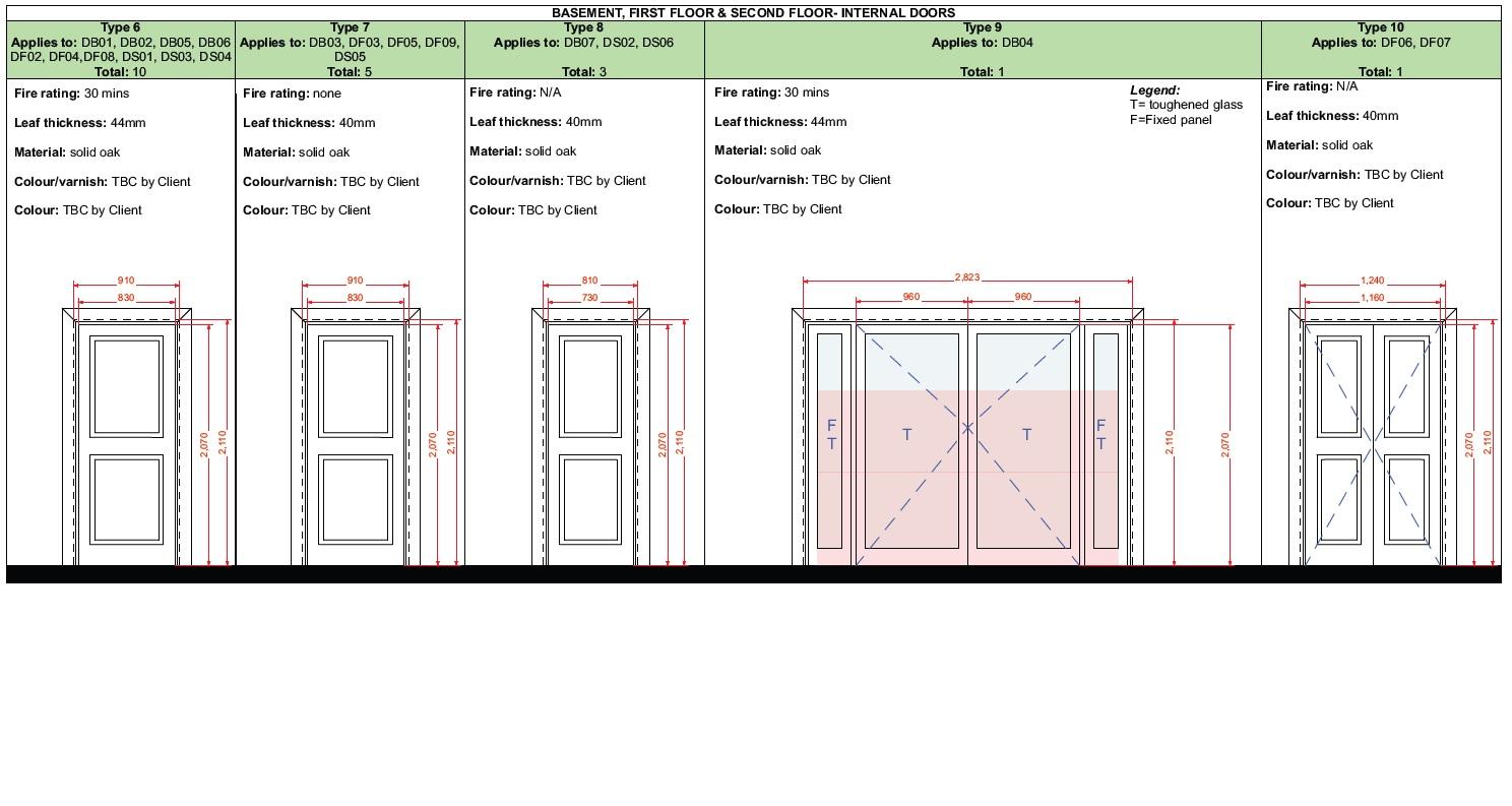

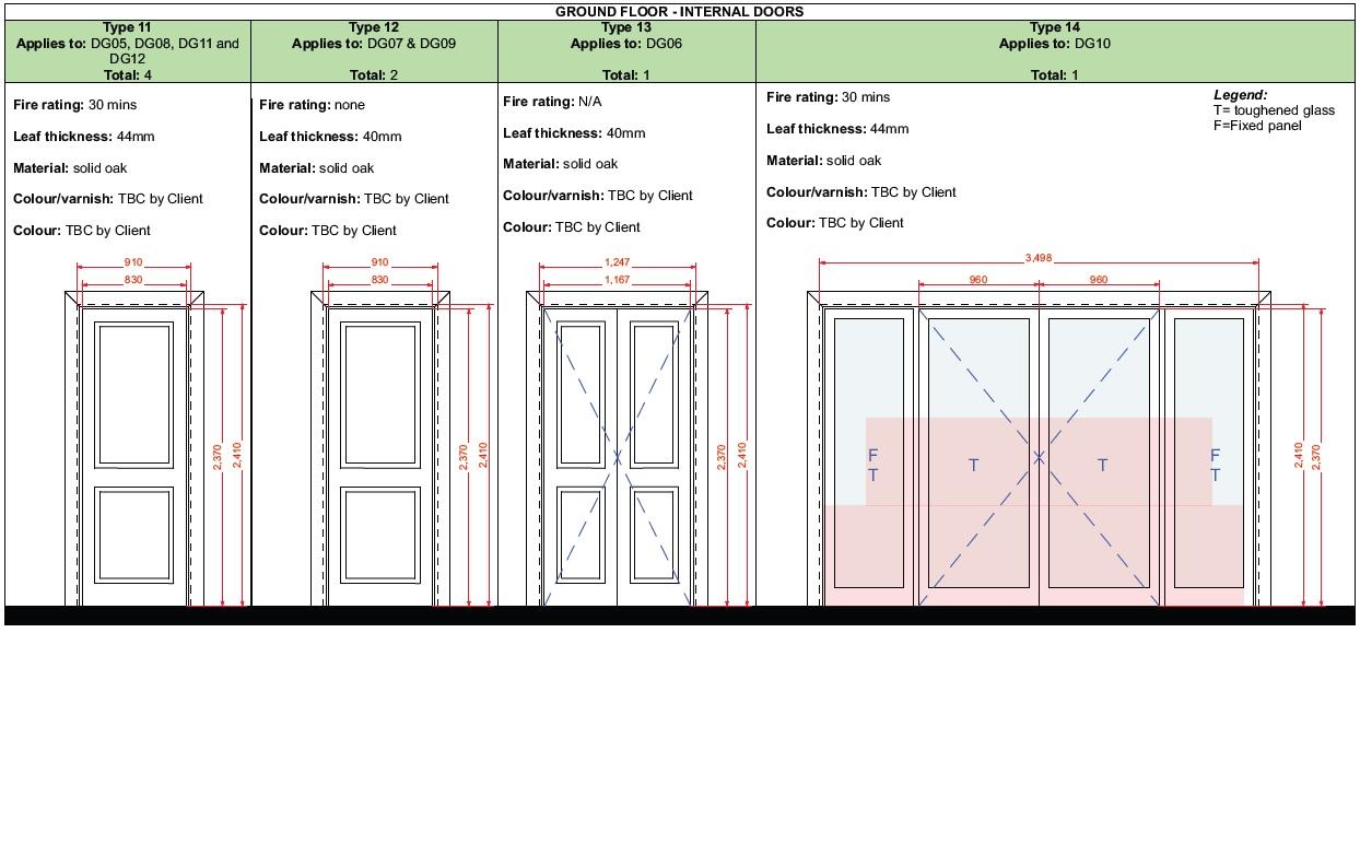

Hi, looking for some advice on my Architects chosen door sizes on my new build. I am comparing some of the sizes from the single doors attached and not really finding an easy match. Just about to have the openings built with blockwork so would appreciate any advice. Block to block is 910mm and the 810mm one is a smaller toilet door under the stairs. Heights vary on the images depending on what floor the door is on, 2110mm high to blockwork opening in the basment which will have 2400mm high ceilings. Do you think I will find it easy to buy doors without them having to be made bespoke sizing? Would I purchase a door frame kit for these openings or just have them made up to suit? Thanks C
