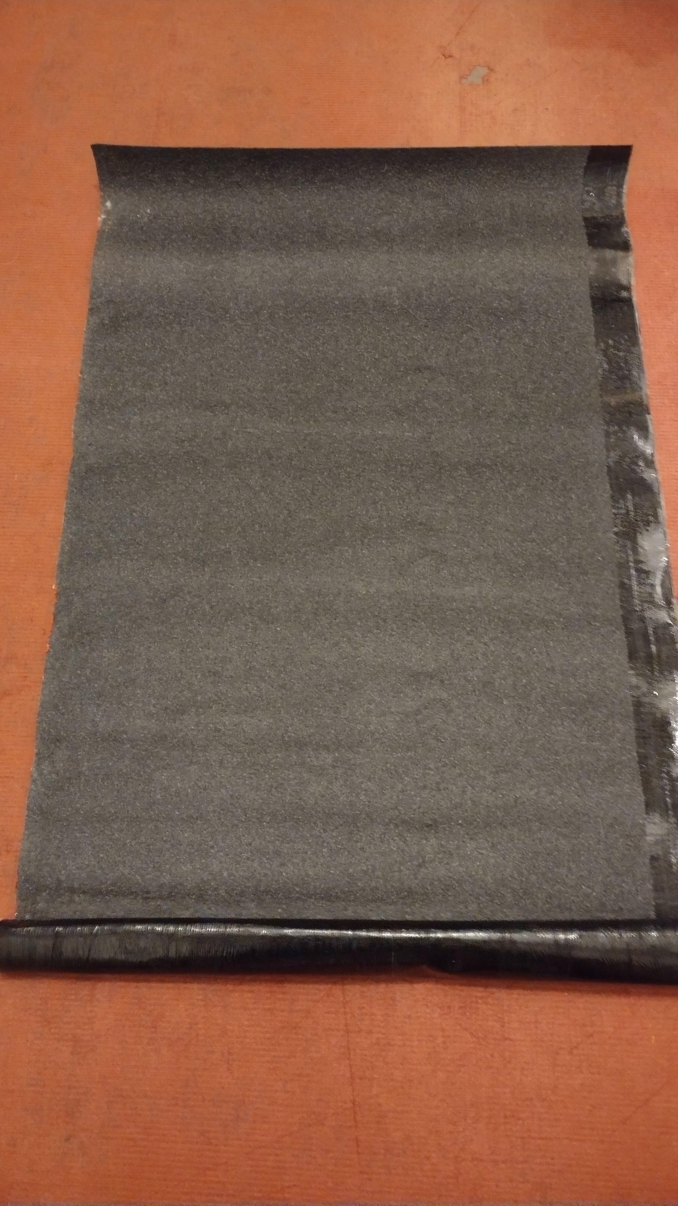

  11. Hi all Hoping to do this repair at the weekend, so any thoughts as to whether I can use either of these torch on felts as a substitute for 1f (and use it in the same way as 1f - i.e. nail it only) would be a great help... Ta
  12. Hi I've got a repair to do to my roof. The roof has sarking boards, with 1f felt on top, battens, then slates. I'm repairing a hole in the sarking and felt from where a flue was removed. The whole area to be repaired amounts to approx. 1.2m x 1m. I was kindly given some felt to use for the repair. I was told it was 1f but I've collected it and it's actually torch on. In fact, I was given two different rolls. One is this stuff: https://www.jtatkinson.co.uk/iko-glass-torch-on-app-universal-underlay-16m-61020216 The other felt is thicker and I'm guessing is used for the top layer in a torch on system? Photo below of that one.... My question is whether either of these can be used instead of 1f for the repair? I'm only looking to nail it, as you would with 1f. Or do I need to make a trip to the BM and fork out for a roll of 1f? Many thanks

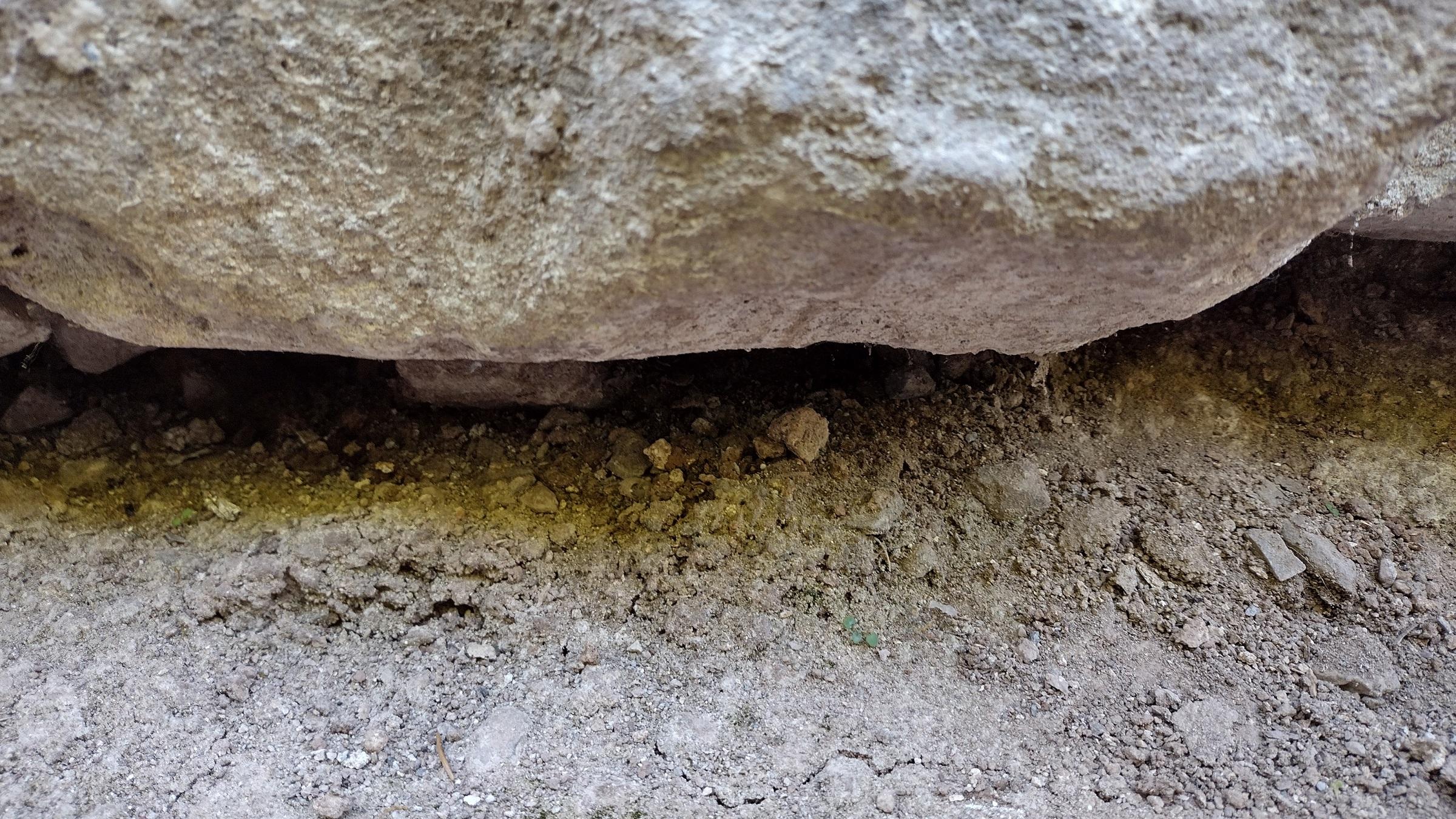

  13. Hi Been away for a few days, but hoping to do this tomorrow/Friday. Just got a couple more questions if you don't mind. Can I just pack the mortar in against the compacted soil? Or do I need to do something to the soil prior to using the mortar? And is it best to work when the compacted soil is wet or dry? Many thanks

  17. That's fair enough and makes sense. In a lot of ways I'd prefer to use 3.5, so all the better if that's the most appropriate. Regarding repointing though, once I've finished I'll leave the "trench" as it is so that the mortar can set. But at some point (not sure how long to leave it?) I'll back fill the trench and re-instate normal ground levels, after which the work won't be visible or accessible and so I'm not sure repointing be an option in the future? Cheers
  18. We do live in a wet area generally. and since the "trench" has been exposed, water has pooled in it after rainfall and takes a while to go. I guess the ground is very compacted there which prevents the water draining away. So due to the amount of rain we see and the fact that the ground is so often wet, I had wondered if NHL5 would be better suited? Perhaps for the extra strength too seeing as it is beneath a two storey wall? On the other hand, I appreciate it is also a balance of getting the most breathable option. With all that in mind, would you still say 3.5 is best? Funnily enough, I have been reading that in some brands there's little difference between 2, 3.5 and 5. And that across brands there's so much variance that a 2 by one company is close to/the same as a 5 from another. Which I guess make a mockery of it all if true!! Many thanks for your help
  19. Would NHL 5 still be too weak do you think? Would you use that strength and add cement as well? Many thanks

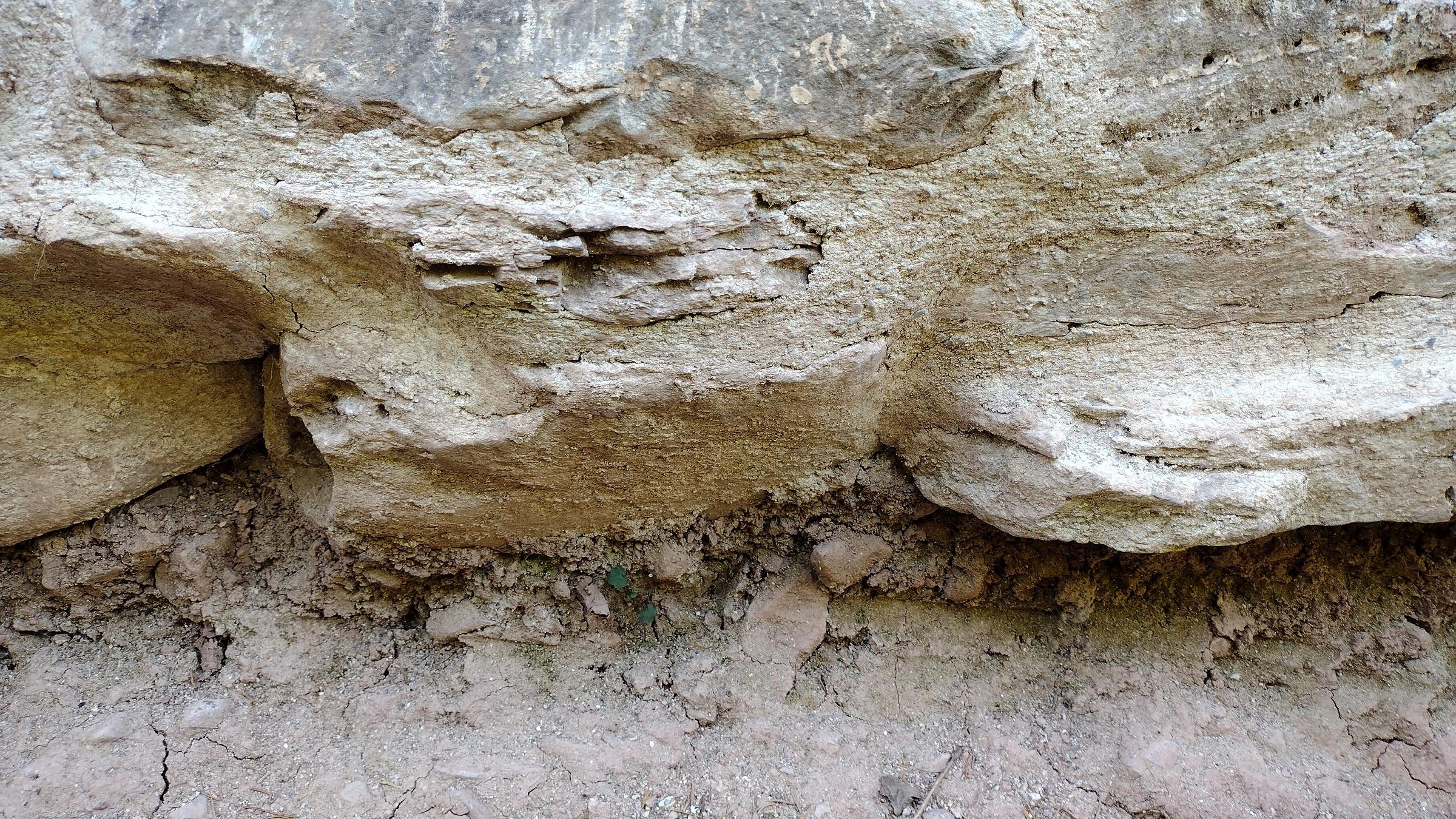

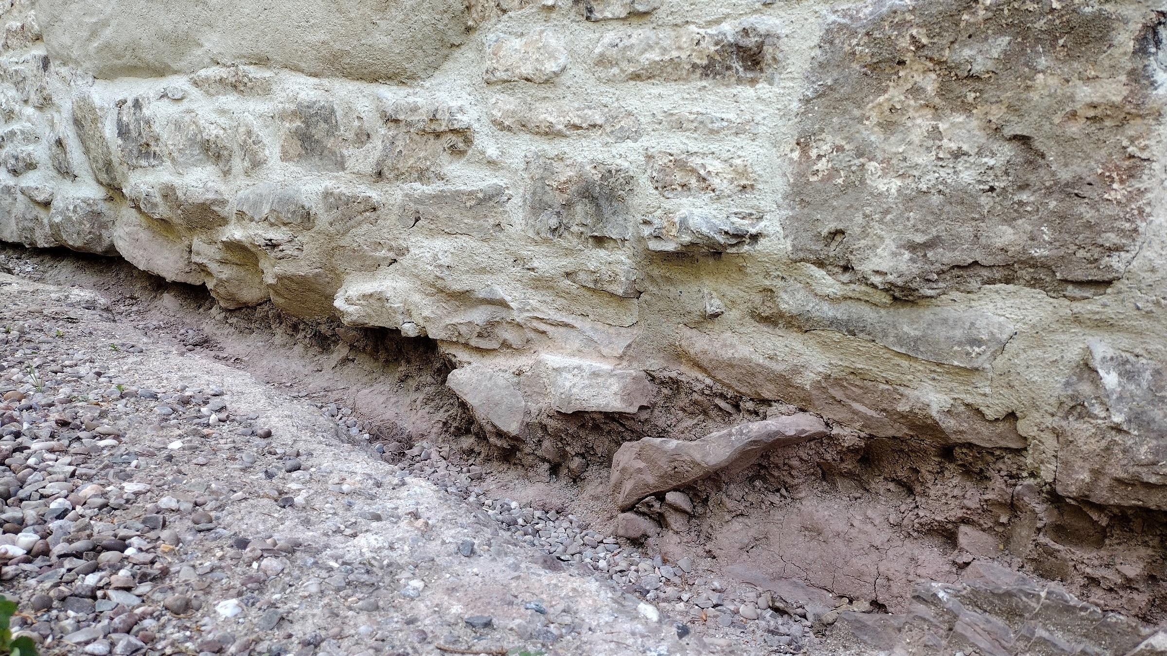

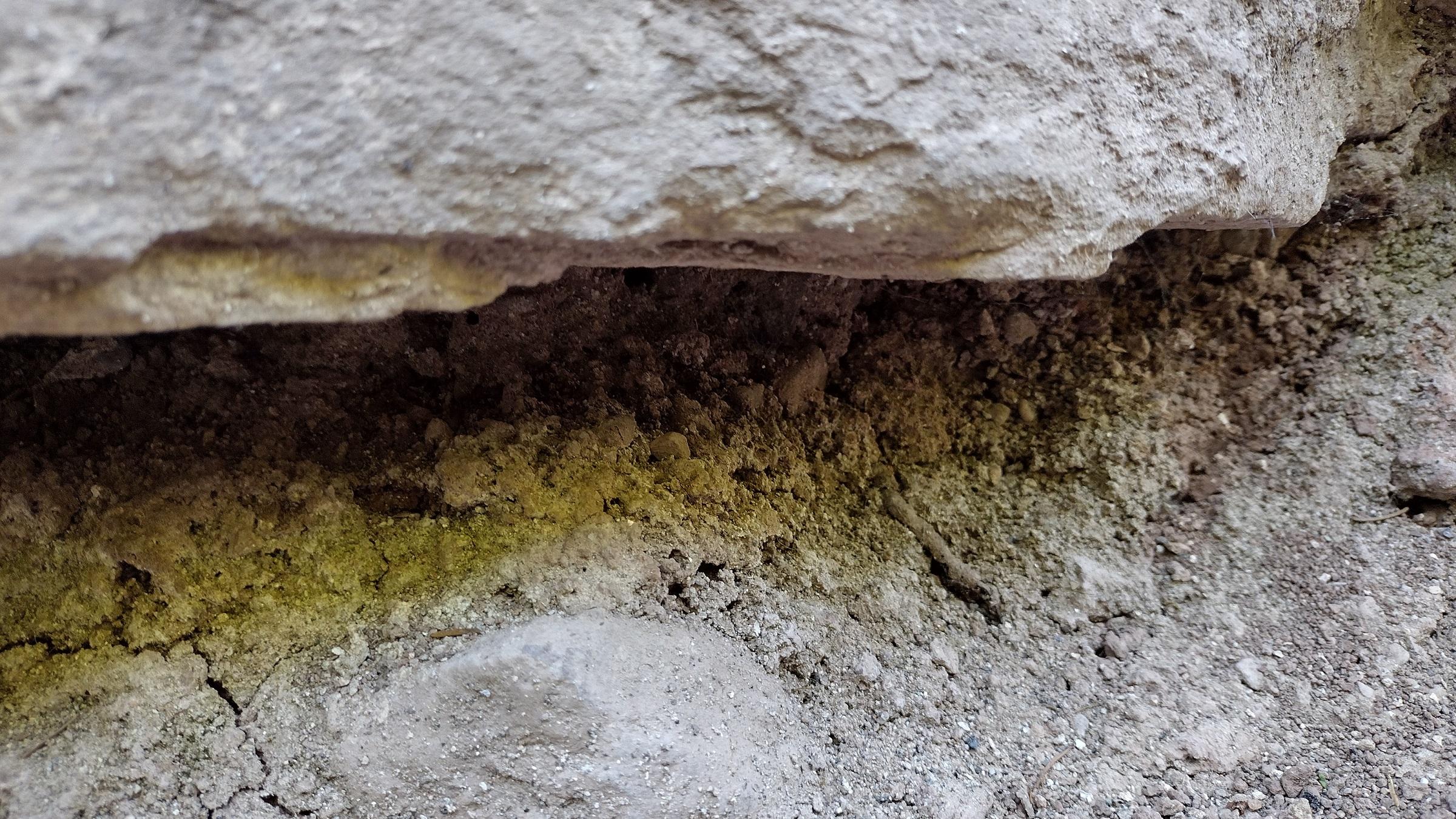

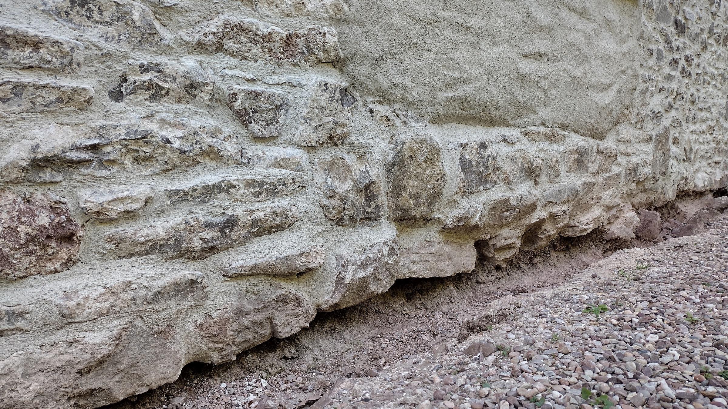

  20. Hi We had the roughcast render hacked off the stone wall of our house, and the pointing replaced with lime mortar. There are no foundations. At the time, I pulled back the gravel at the footings of the wall, creating a bit of a trench. There's hard compacted soil beneath the bottom stones. But in some places, there's quite a deep void until you get to the soil (a horizontal void). In the "worse" places, I can get my hand and wrist in there to around halfway along my forearm. Should I look to fill these horizontal voids before all the gravel gets pushed back into place? Or is it enough to just let the gravel fill them? If I do fill them, what would be best to use? I was thinking NHL lime (3.5?) but also using stones under there to help bind the mortar and to prevent having to use too much of it. But that's a total guess and I'm all ears on what I should use, if indeed anything. Aside from doing what's right for the building, it does seem that mice are quite keen to scurry their way into the wall (and house) through these deep voids. I've got them blocked with plastic at the moment to stop that. I'd want to make sure whatever I do stops mice getting in. Pics below, showing the deepest and shallowest sections. And just to be clear, when the gravel is put back to how it was, these voids would be below ground level. Many thanks
