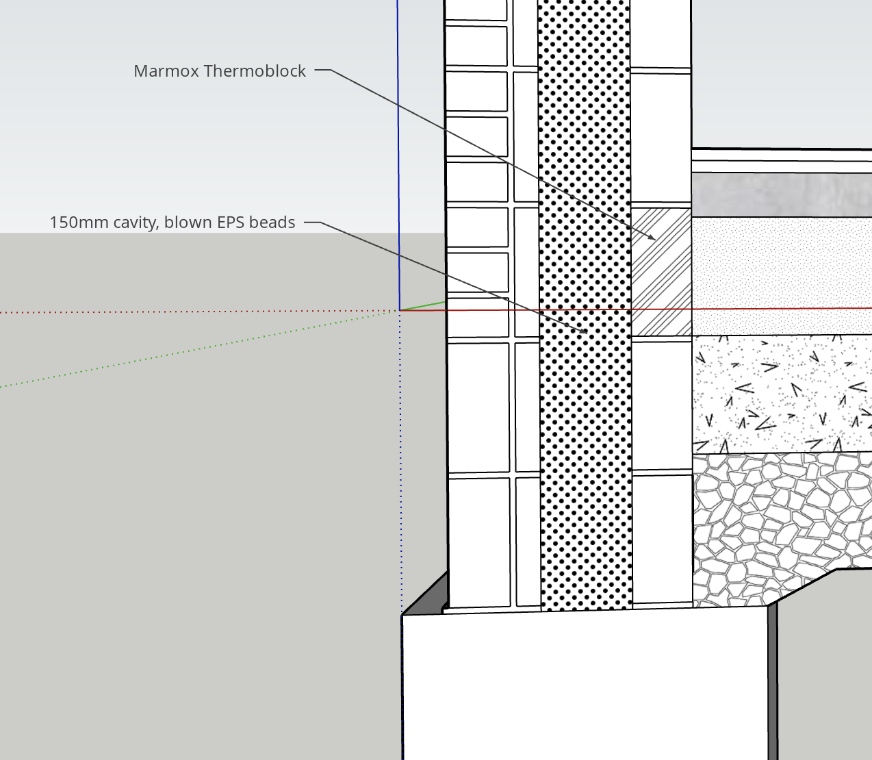

Understood. So you would recommend thermalite up to insulation layer then a layer of Marmox rather than another thermalite in line.
That seems to make sense... 65mm marmox 0.05, 215mm Aircrete (10N) 0.19. So Marmox is slightly better at 3.3x BUT if it's courses below and then courses in insulation layer say 3 courses the aircrete will be much better.
“far” better sounds like I’m going to make the more expensive choice then…
I'm just finalising my foundation details and I hope someone can help me make a decision... Do I emlpoy Marmox Thermoblocks on the inner leaf at the insulation level or simply use thermalite or similar below. Can anyone help with the potential performance of the two different methods? I expect it to be significantly cheaper to use thermalite blocks. Traditional slab build up of 200mm with 200mm insulation above. Also I've drawn the Marmox block at 215 tall below but it's 65mm so ignore that.

Great thanks for that… yep been through those. Redone this. understand the point on maybe 100mm EPS, membrane then 100mm PIR. Is that going to give a significant difference? Or much better 2x 100mm PIR. I also haven’t taken the slab over the block work in this version as won’t have the EPS to shutter it. the willows - foundation detail (mh).pdf
So I’ve taken to drawing it up prior to chatting through with builder… thoughts? (Ignore some of my dodgy scaling eg courses not lining up)
