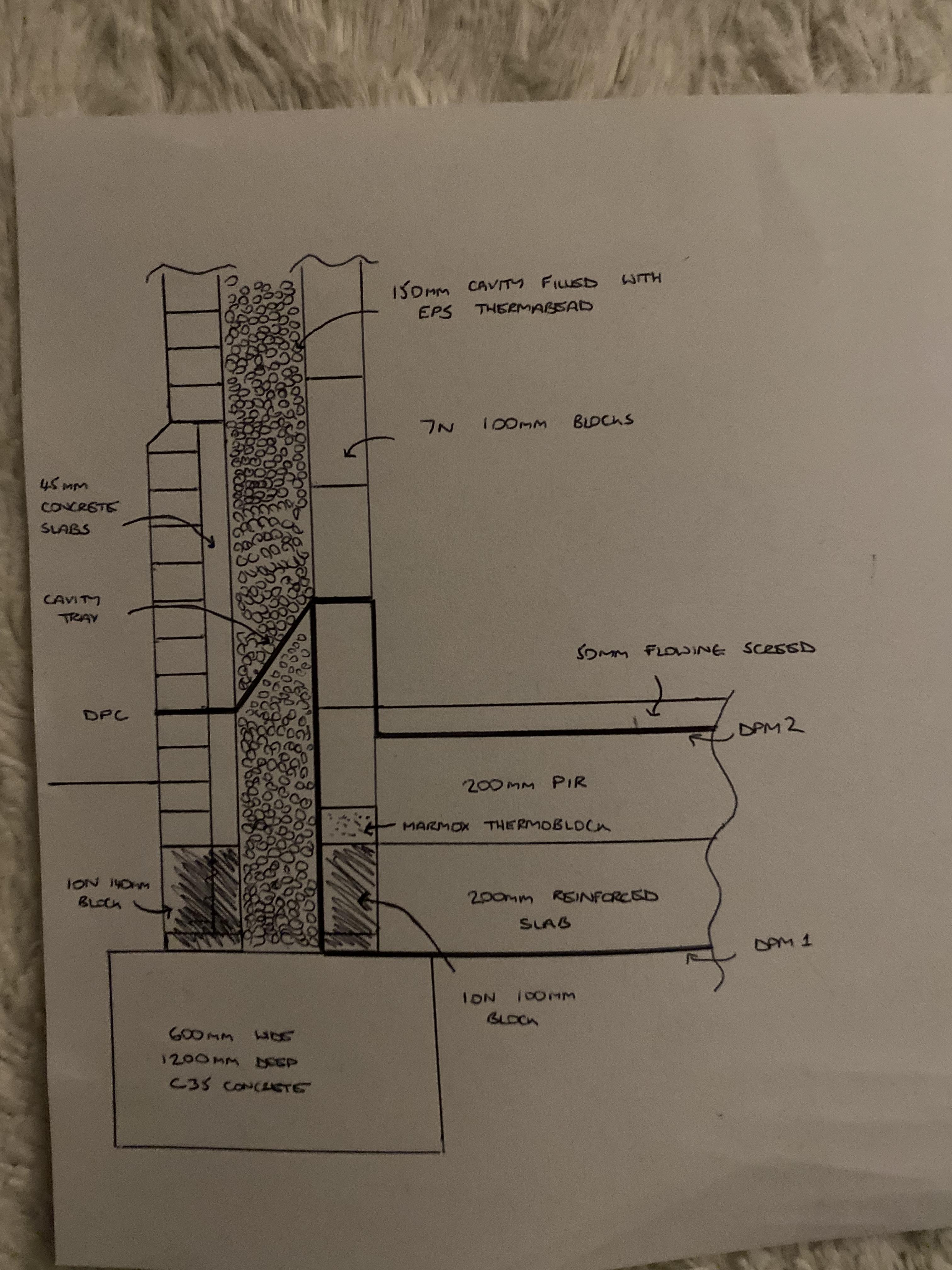

  1. Unfortunately yes paid. Really not happy but at a loss as what to do if he won’t respond really. We’re now at the point where some steels are on site and up so I need some questions answered asap…

  4. Yep fully agree with all of your points. I think our DPM 1 achieves point 2, assuming we only put ties above that level (we’re quite high with DPC due to terrace at rear being level threshold - so first ties will be three blocks up). Point 1 I agree with but I had that debate with BC and he was extremely persistent that it needed to go in. We then had a debate about the Marmox blocks that he told me were pointless. So that was nice too. I particularly like it when he asked me what ventilation I was having in addition to MVHR!!!!
  5. I cannot see why we need 2 DPM’s though. Only thing I think is we were talking about how do we get wall ties in and that’s when he said

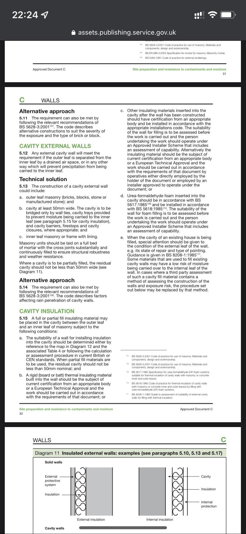

  6. Yep I found that. That’s the standard dealing with rising water. there’s then one below dealing with water ingress from outside
  7. problem is that would be drilling through the DPM that’s lapped up the outside of the inside leaf. made the call to remove the paving slabs on top of DPC, that way we have 50mm to join cavity tray to DPC then bed the slabs on top.
  8. The additional problem I have is how do I get the thermabeads injected in under the cavity tray without piercing the DPM. They’ll need to be injected from the outside so drilled through outside brick and the paving slab which I’m sure the installers are going to love me for!
  9. I drew this last night. This is what they’re asking for. Atm the cavity tray isn’t in, we’re up to plinth brick height on the exterior skin and have the Marmox blocks in on interior. Obviously no insulation and screed yet. This is a standard detail, at the back we’re level threshold so the garden will be two bricks higher, so there we’ve stepped the DPC up another two bricks so the cavity tray and DPM would effectively be two blocks higher than FFL
  10. My favourite bit however is that we need 2 DPM’s. Have one under the slab that we will lap up the outside of interior wall. They want another under screed that also laps up to cavity tray. We have a level threshold at back so our cavity tray will effectively be block and half above FFL inside.
  11. Nope. Just demanded there be a cavity tray. We haven’t done interior block work so they suggested taking out the mortar 5mm or so at DPC and beading a tray in with silicone there then tape to interior block at a higher level.
  12. So revisiting this as I’ve now started on site. We dispensed with the cavity tray and planned for beads all the way down. Up to cill height on external brickwork and building control/warranty have come round and said we absolutely MUST have a cavity tray and they won’t do an off without. Help!
