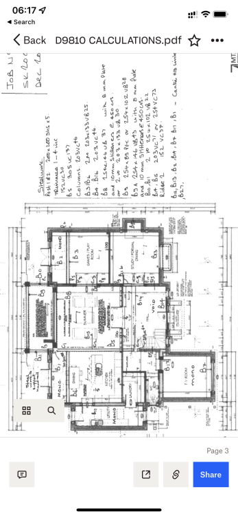

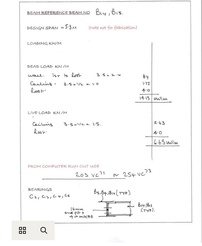

Structural engineer issues… help!
matthyde83 replied to matthyde83's topic in General Structural Issues
Does anyone have any recommendation for an SE I could get a second opinion from? -
Oh and 20mm plates and stiffeners everywhere. Over 5m and 300kg of 20mm plate in the one beam and connections. -

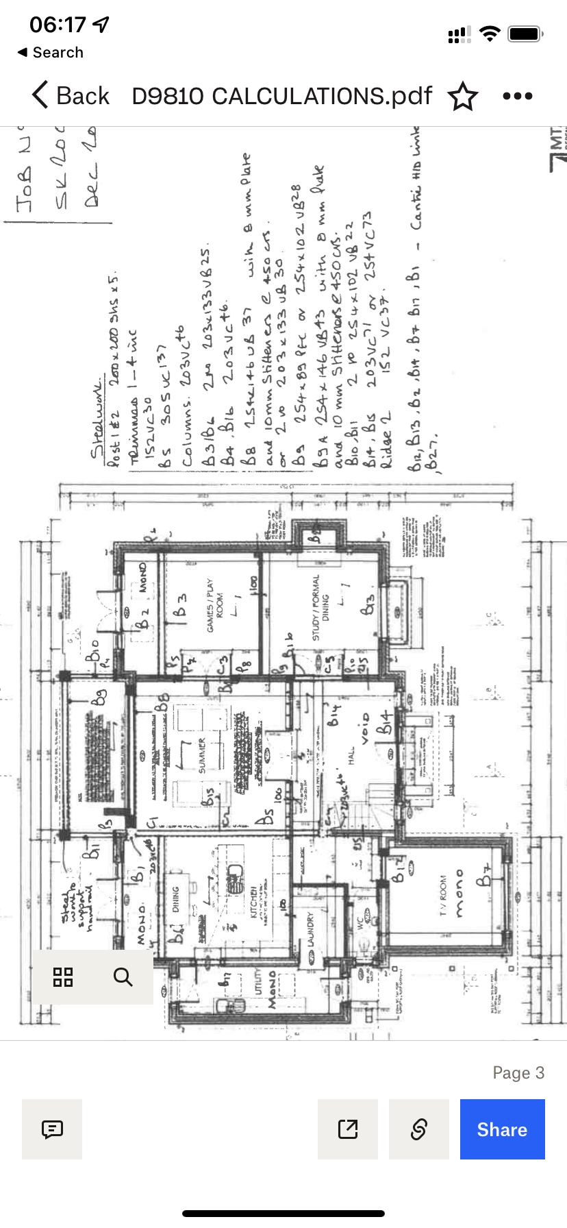

i suspected over engineering as much. So far we’ve had a slab with two layers of 10mm mesh and B5 has changed to a 451 UB 97. Fabricators struggled to locate one so short as they usually come in 30m length for railway bridges!! -
That might make more sense but a lot are labelled as UC and they’re definitely not. B5 etc. Below is the connection detail which also indicates it’s in the gf ceiling… -

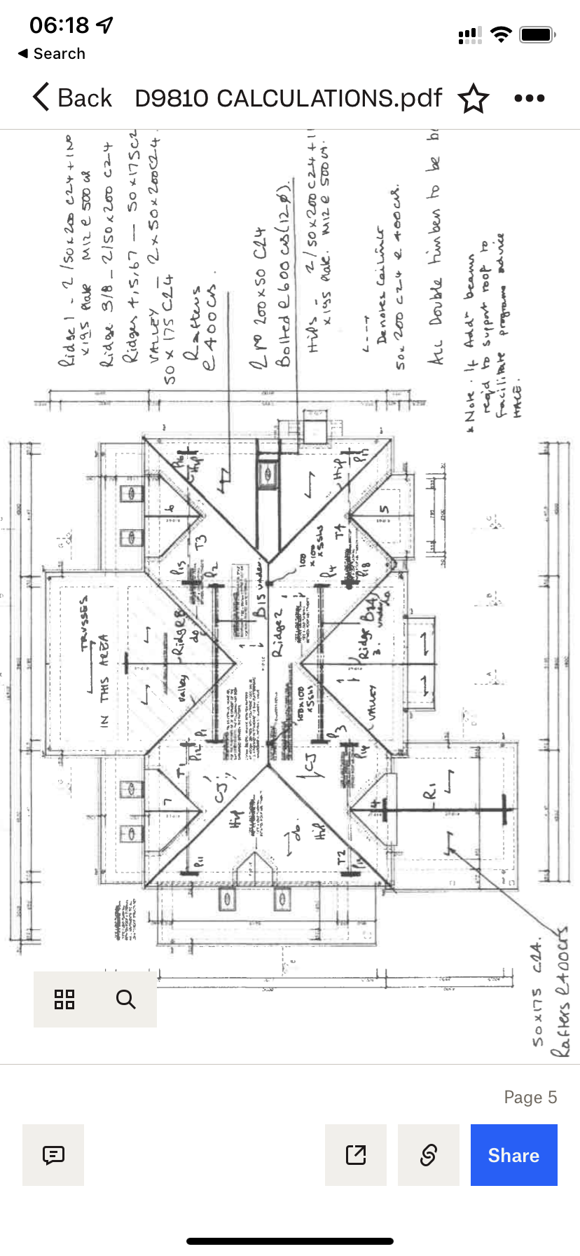

Also Trimmers shown. I’m assuming they’re to support the ridges but it’s a hipped roof so they can’t be at ridge height else they’ll be sticking out the side. Also ceilings will be sloped as eaves height is quite low so they’d need to be below that? -

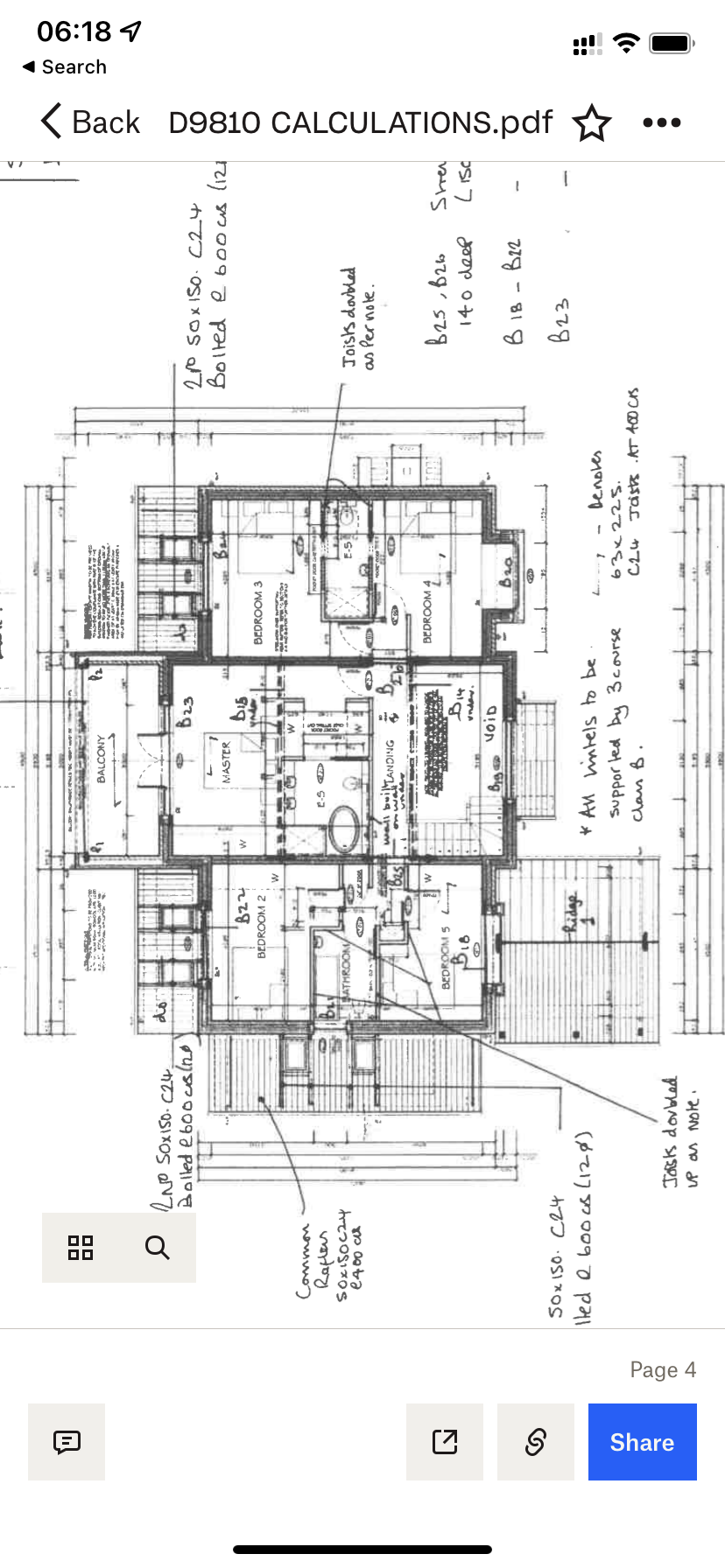

Ok… one of my main questions is B14 and B15. Where are they? They’re labelled as in the gf ceiling but also labelled on the roof plan as ‘under’. Also what is their purpose? They are below a stud wall, if it’s support for that then can we not double joist to allow for MVHR etc.? -
He can’t. One of my questions is recommendations on here really. I can google obvs. -
It’s been a month… plus architect has said he’s talking to him on other jobs. He’s trying to talk to him about mine also and getting no luck.
