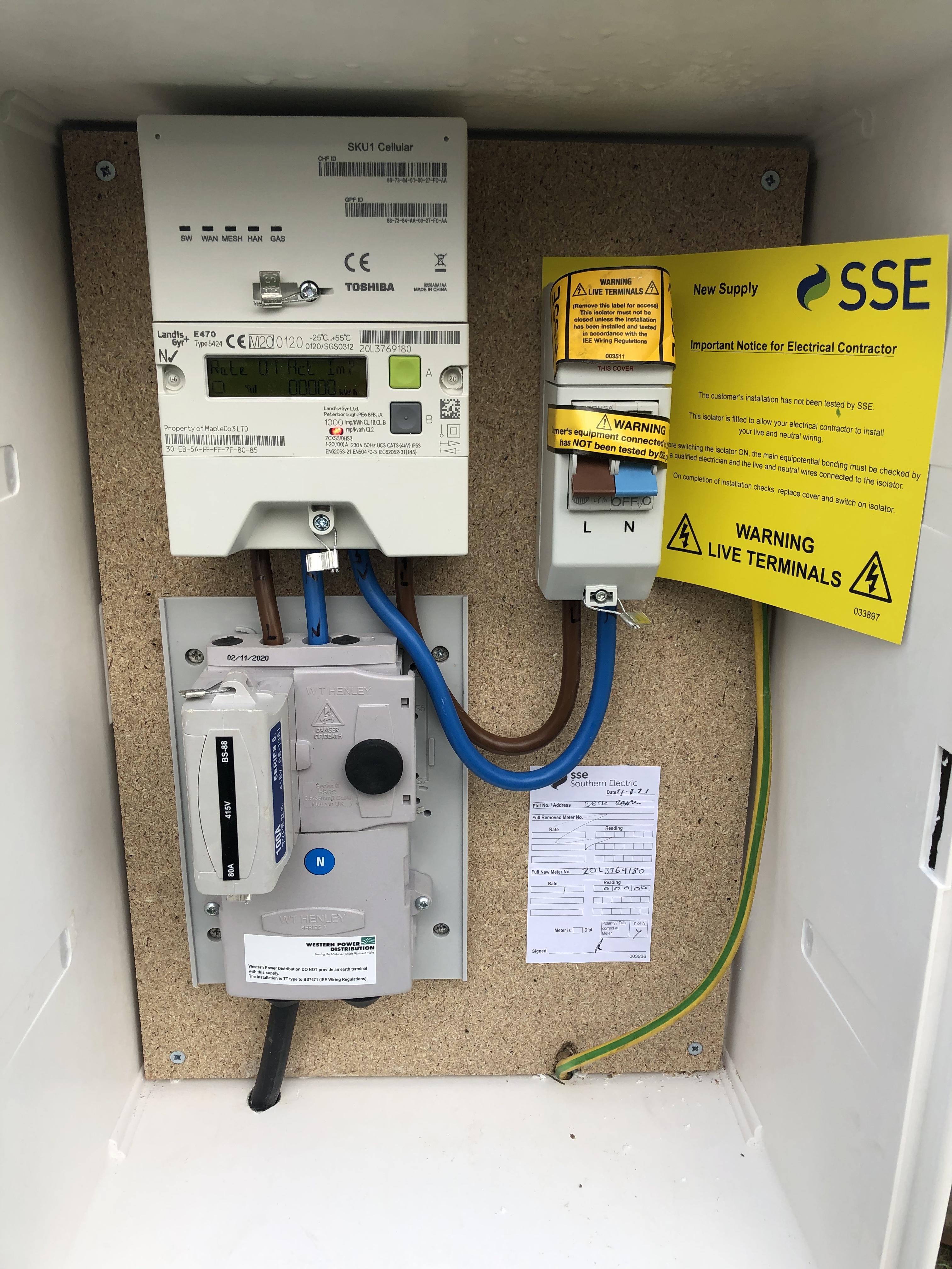

@ProDave - see attachments On a connected subject, SSE failed to turn up to fit the meter today - I’d taken a day off work so I’m furious. ? -

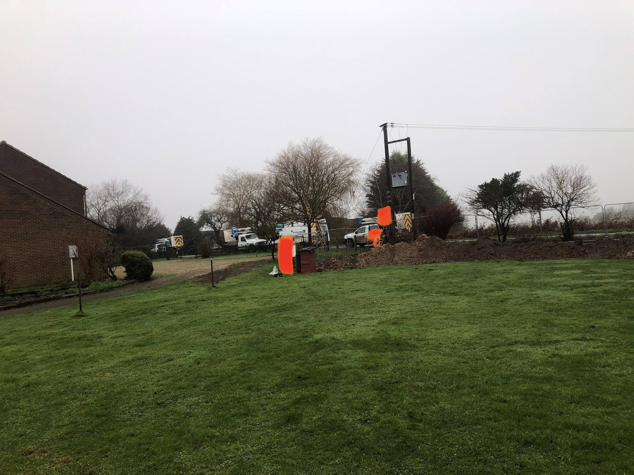

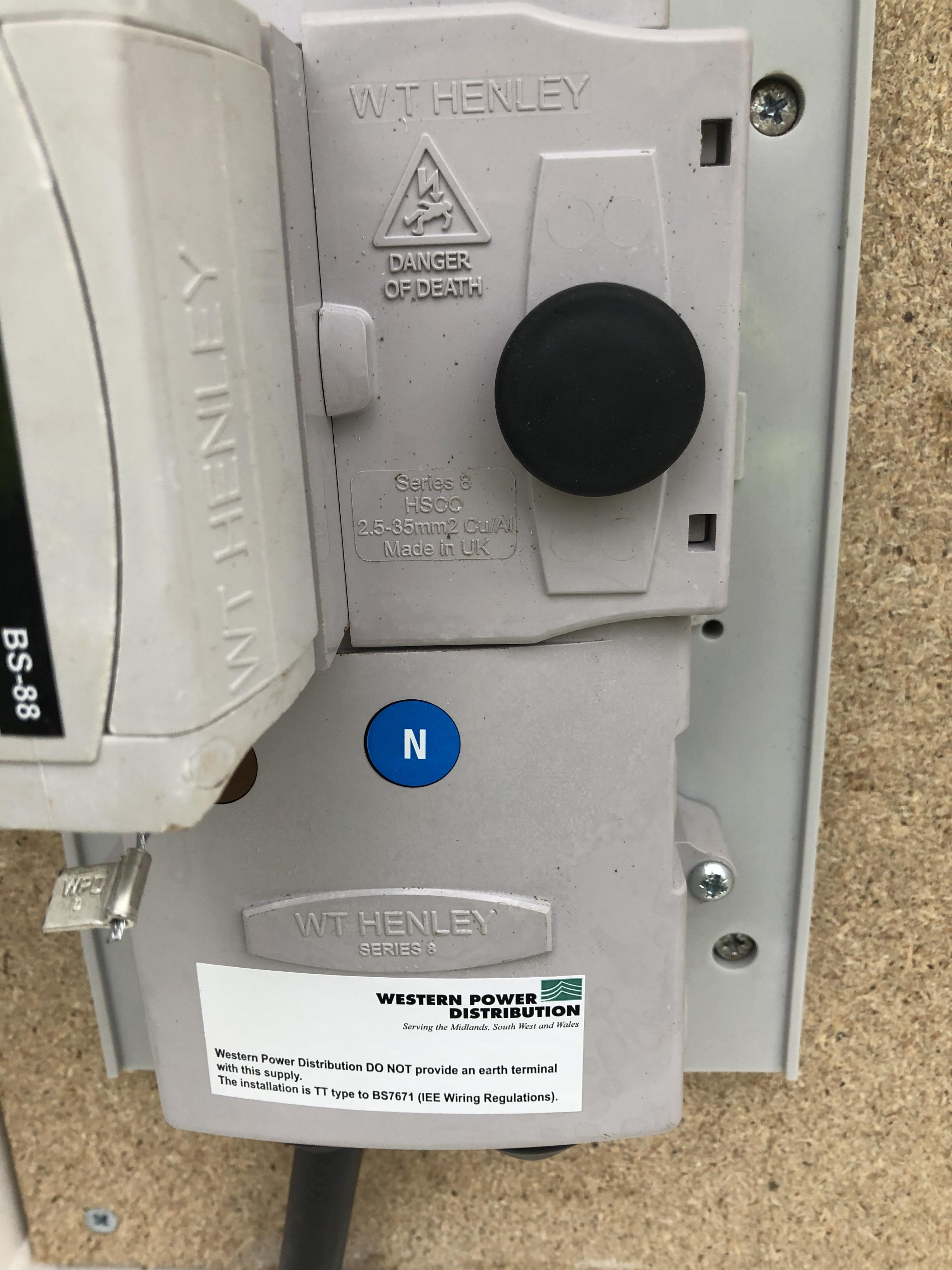

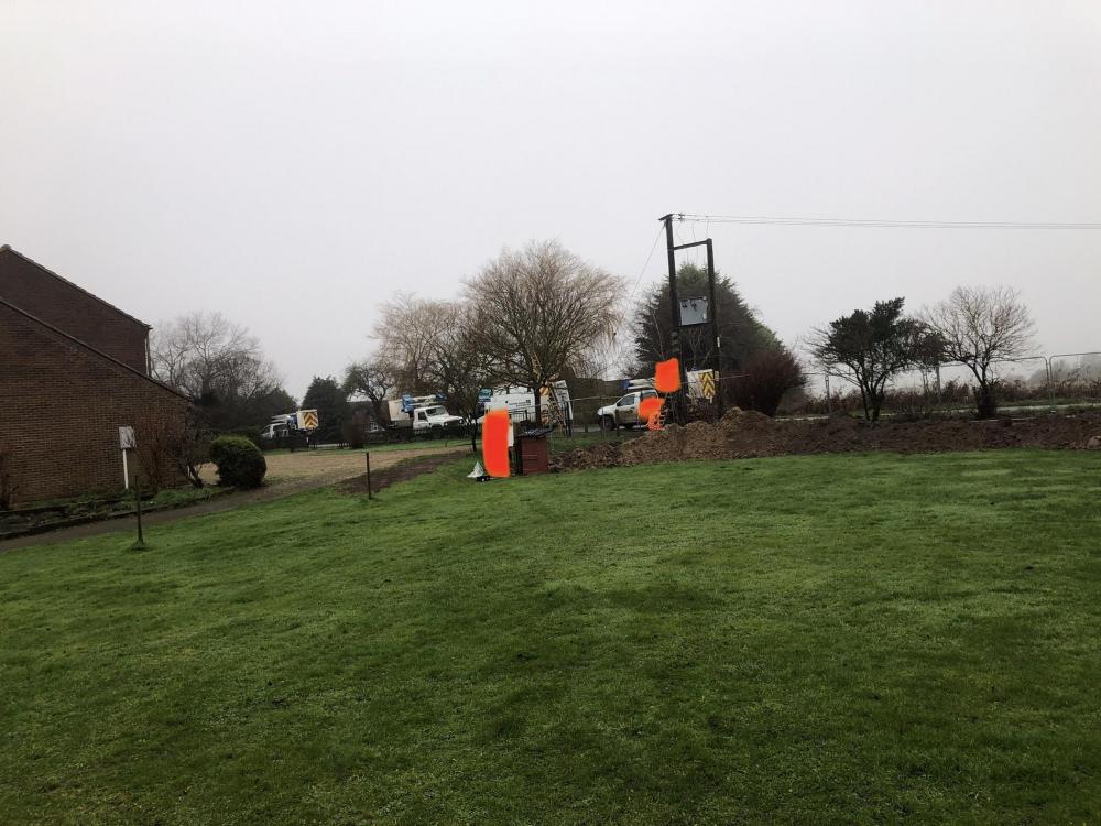

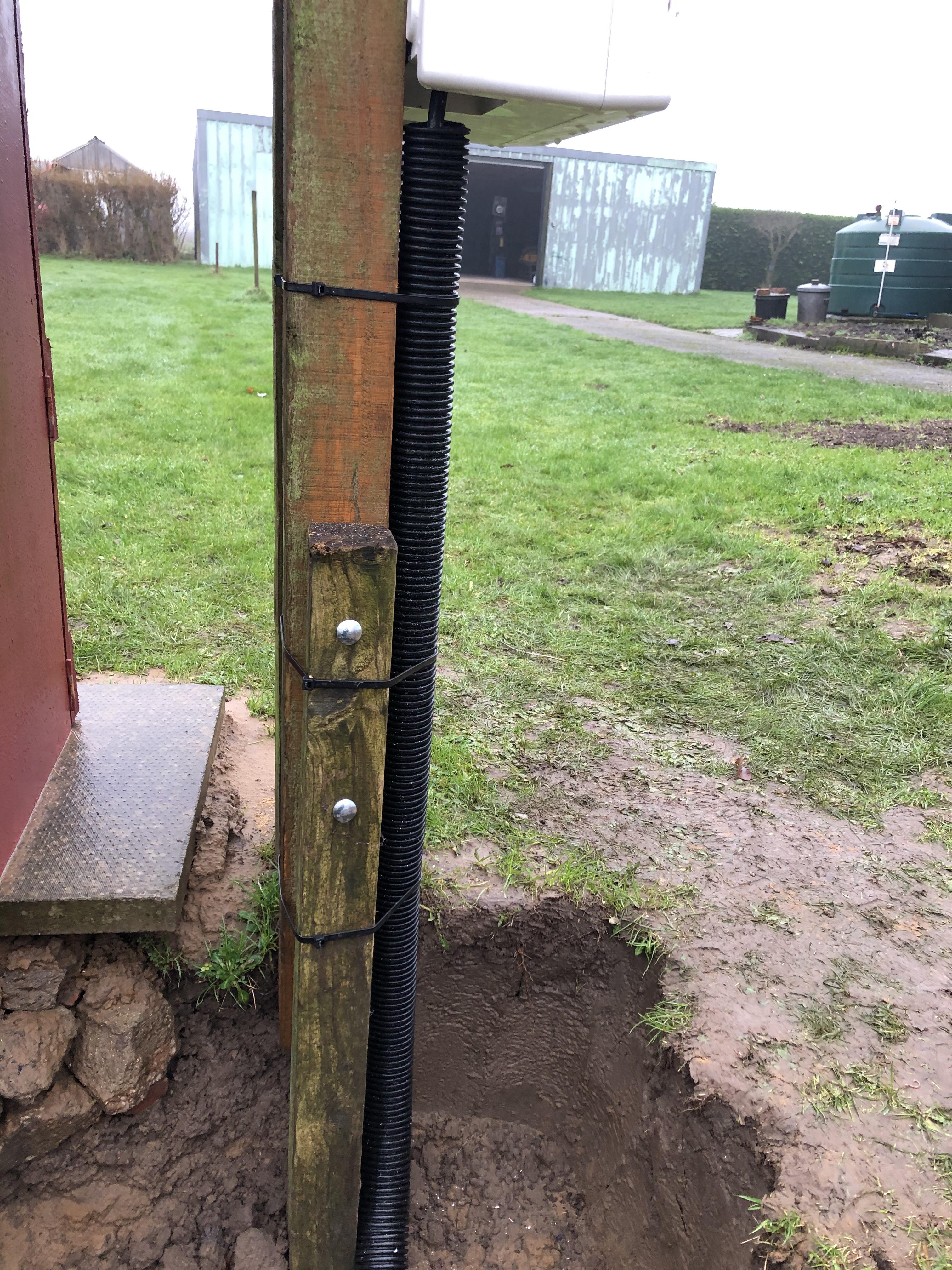

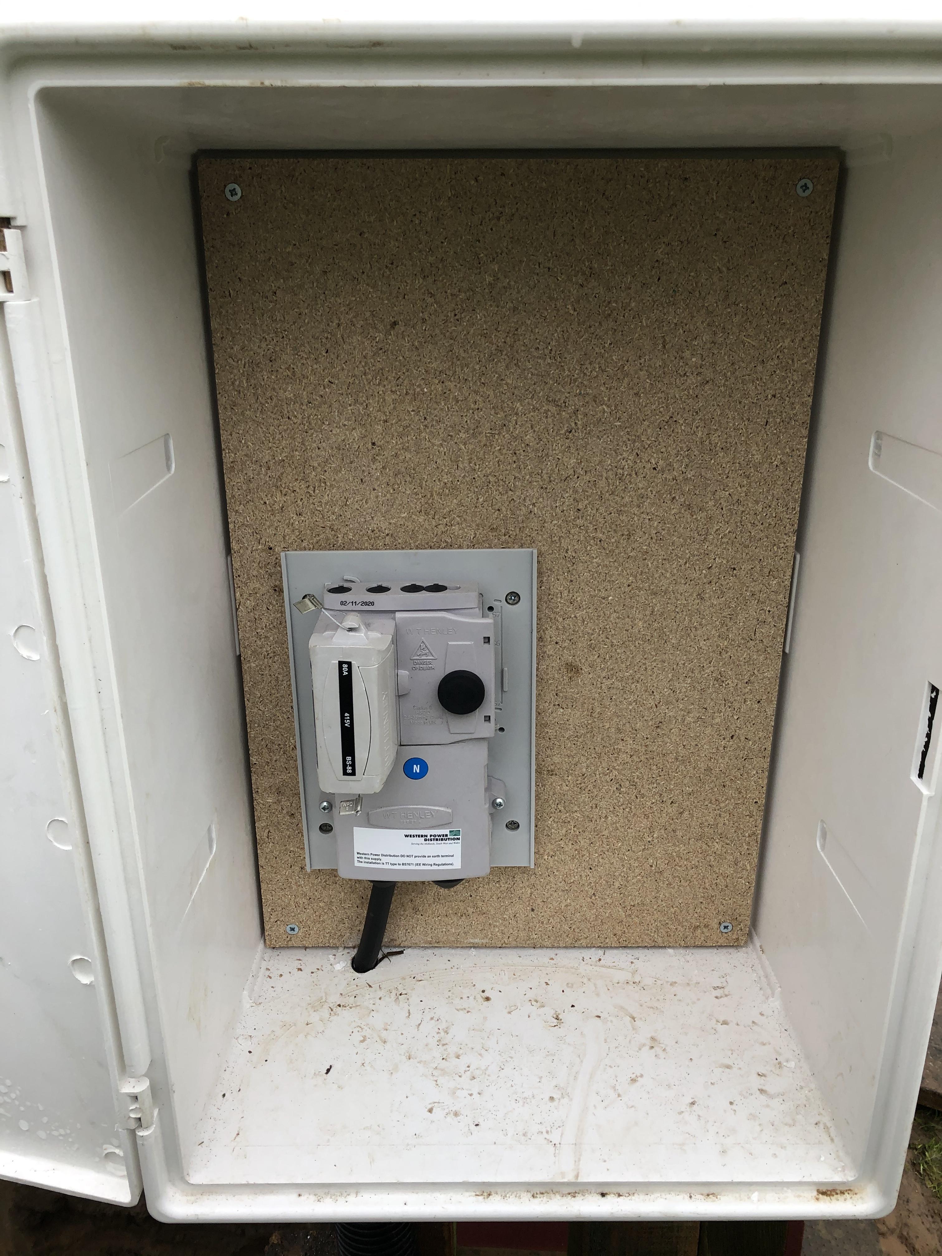

WPD installed the cable and cutout two days ago, 4 men, one van, 3 cherry pickers - and they only needed to use a ladder for the connection to the pole! All done very quickly and without issue. They did leave me a hockey stick but it was agreed that there was little point in installing it to a box on a pole - I’d left the ducting long on purpose so they just ran that up the post. It’s much less likely to get damaged than the hockey stick would have done... New style Henley cutout - no Earth terminal, as was predicted... -

I understand the why - and in just about any situation a static caravan or even a metal shed should be TT earthed as near as possible to it, even if it’s being fed by a PME supply inside a nearby building. I just don’t get what circumstance might arise which could lead to the loss of the neutral/earth conductor in concentric cable, where the phase conductor is not also severed or shorted out sufficient to blow the main supply fuse at pole or substation... -
Connecting-up my empty meter box…
Randomusername replied to Dreadnaught's topic in Consumer Units, RCDs, MCBOs
I’m assuming that as they’re going to be providing power from a PME feed but insisting that I TT on site, they will not provide a MET and I’ll have to fit one in the cabinet attached to my earth rod, and completely separate from their cabling? However that doesn’t change the fact that their supply neutral will still be tied to their PME earth as there is no way of keeping them separate when they’re visibly connected on the casing of the local transformer! ? -
Western Power Distribution here in Lincolnshire have confirmed to me that they have no interest in finding an earth spike in-situ when they come to run the supply from the pole to my TBS supply. Until something is supplied from the box, ie there is a meter and main switch/consumer unit in place, it’s not classified as a usable supply and does not require a TT at the point of connection. However by the time that the meter installer arrives, they would expect to see the earthing rod in place as the supply is then classified as live and usable on completion. -
