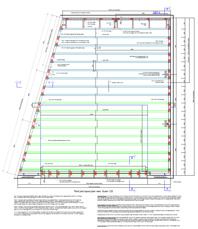

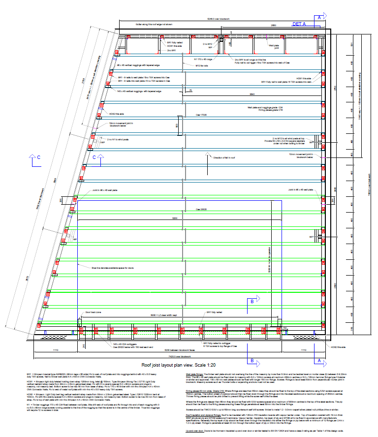

Ok. If you fancy let us see the drawing (include the weathering detail if possible) and a few photographs of what's been built so far. What's the beam span and confirm the loads if you can. Has your SE provided calculations? -

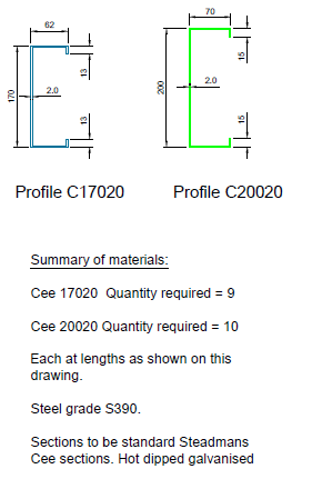

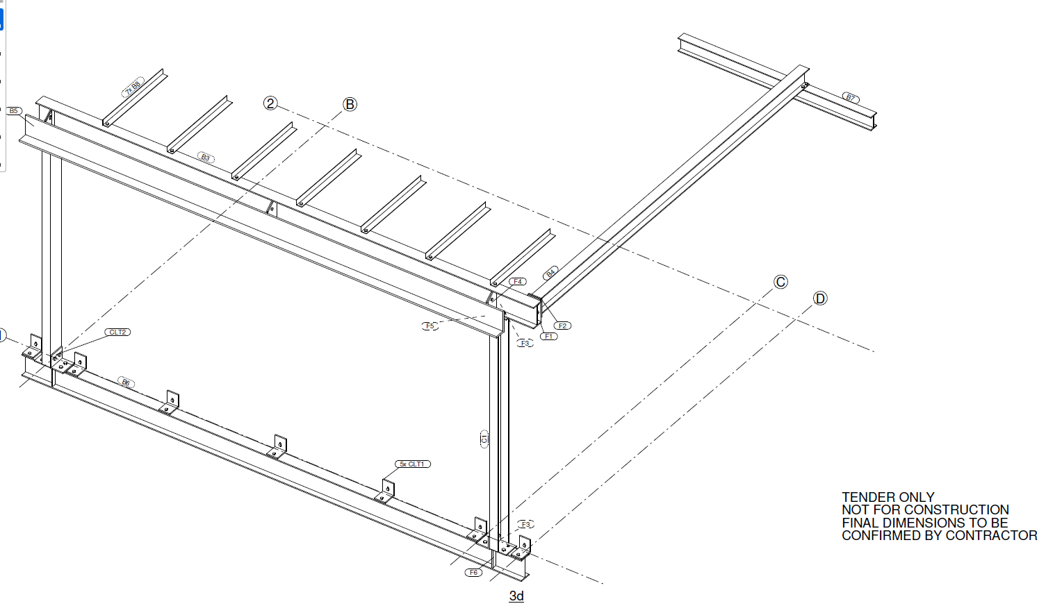

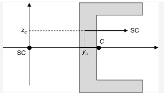

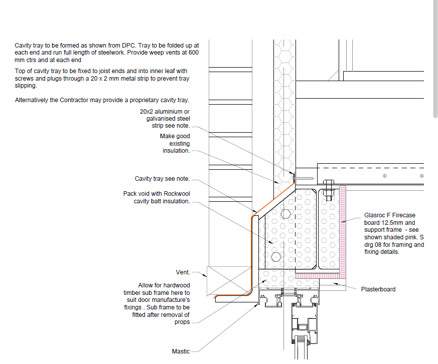

That’s good news the SE is coming to site. It's also very encouraging to see your builder chipping in with their concerns, demonstrates competency. From time to time I use an unequal galvanised angle to support an outer leaf. They are prone to torsion and warping. Just as an aside, the angle is galvanised and the internal I beam is not. If there is too much moisture floating around the angle will become a sacrificial anode. Thus we could electrically decouple the angle an internal steel. Or we could paint the angle and make sure the drip above keeps it dry and protects the paint. I tend to plump for an I beam on the inside, especially if supporting floors, heavy roof loads down the inner leaf for example. You can use Cee sections, but again they are prone to twisting, torsional effects. Going into a little more detail. An I beam has it's centre of gravity in the middle of the section. There is a also a thing we call the shear centre. For an I beam the shear centre coincides with the centre of gravity. But on a Cee section the shear centre lies outwith the actual section profile! If you load a Cee section in the middle of the top flange it immediately twists. Now we can actually take advantage of this behaviour by making sure the floor joists for example frame into the web side, the flanges face towards the outside. But this makes it a bit harder to insulate as the inside of the Cee faces into the cavity. Below is an example where I'm using an angle on the outside and an I beam on the inside to support floor and roof loads. This project had a fair bit of steelwork thus the method I adopted of coupling the angle and internal I beam didn't add much to the over all cost. There are three thermal bridges, one at each end and one in the middle, but the coupling plates are thin and the work was to an existing build. Yes technically, thermally not perfect, but is does the job in the round. Part of the 3D steel model: There are three plates called F4. One at each end and one in the middle. The first detail shows the DPC arrangement etc. The next two show a plate called F5 welded to the back of the angle and a plate F4 welded to the I beam. F5 has a slotted hole to allow for tolerance. Below is a diagram of the shear centre of a Cee section: The shear centre is marked SC, the centre of gravity marked C. @flanagaj It might be worth you reading around this a bit (including the finish on the angle, galv or painted) and then ask your SE about it when they come to site so they can explain to you and the builder why they have designed what they have and explain to you in lay terms how it works. Well, lets hope they can answer your legitimate questions. -
