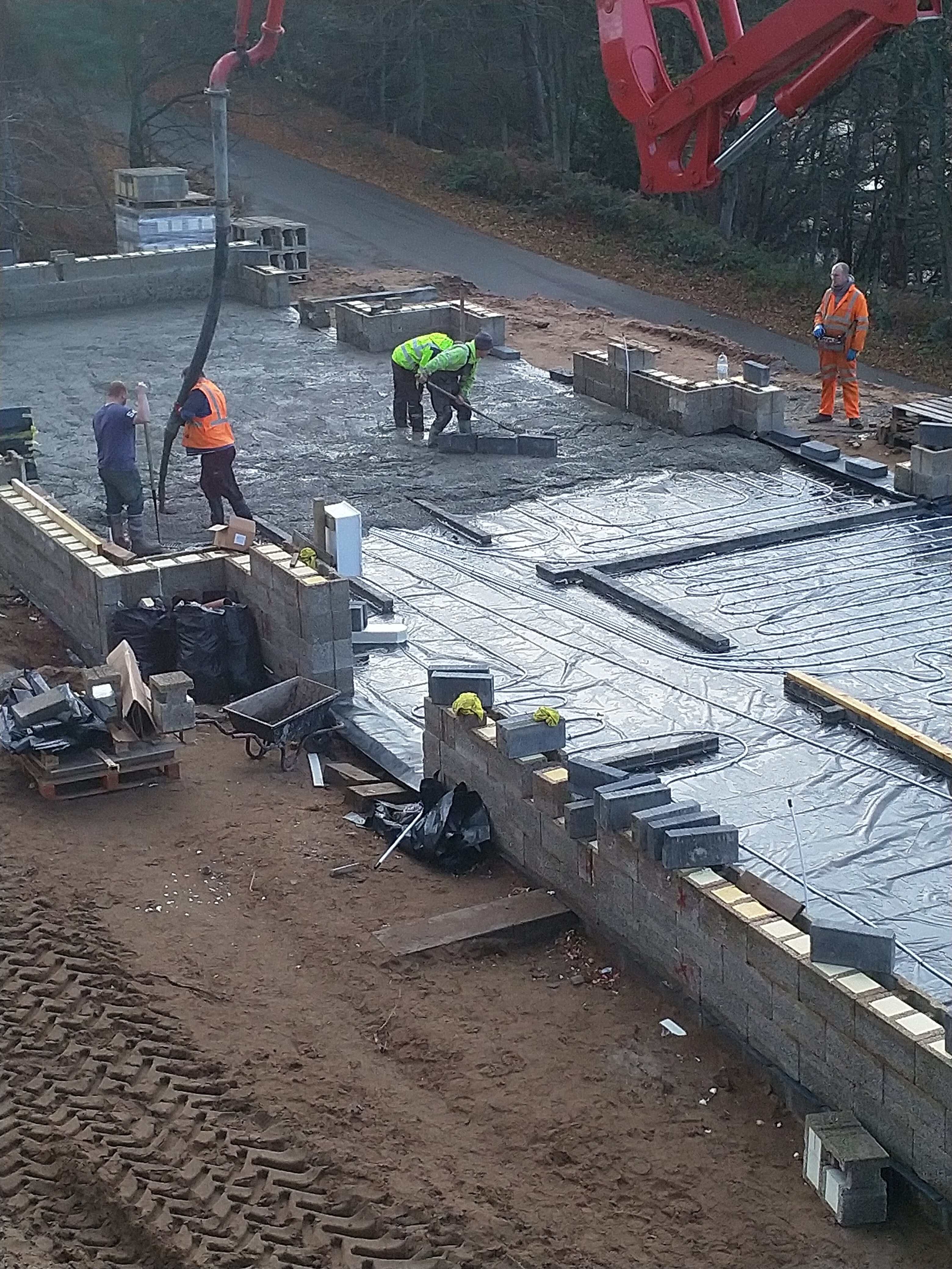

Keep it all simple and functions separate First ventilation is ventilation, it isn't heating/cooling. Separate the ventilation keep it a stand alone item. Cooling via MVHR is an expensive folly and in the round doesn't work as flow rates are too low. Why oversize the heat pump - bad for SCoP due to cycling. Plus Vaillant don't do cooling out the box and cost way too much So is that 3kW or less? if so heating bey direct electric isn't going to be cheap - 3 x 24 hrs is 72kWh. Direct cylinder are fine, not sure I would pay the premium for an OSO A rated one. Slightly oversize for house and heat to 50 degs. Low tariff charge not from battery, use battery for other stuff, not worth the round trip losses when you can charge direct, without going via battery. I would do Decent no frills MVHR, if you want a Passivhaus certified one, fine, but leave all the optional extras on the shelf Stand alone small heat pump - A Haier 4kW is £2100 from Wolseley incl VAT (you can reclaim) Telford Tempest 250L direct cylinder £610 UFH to ground floor, £1k - fully open system, no room stats or actuators, flow direct from ASHP circulation pump Or direct cylinder and a good quality A2A heat pump for heating and cooling Option 1 - no Option 2 - no, almost but not quite - £10k for MVHR are you mad? Options 3 - no -
