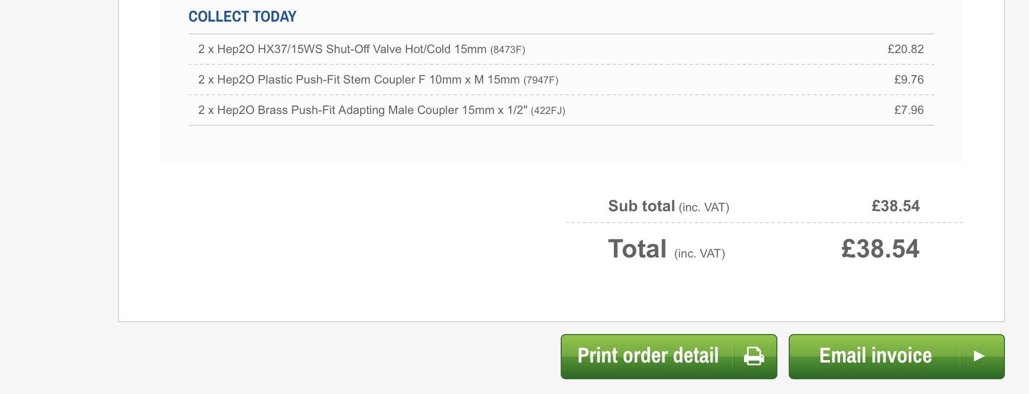

  6. Going to post this as could be helpful to visitors in future. For a Basin I have 10mm Hep20 and the tap tails with 1/2” connector. Because I’m working upstairs and I cannot be bothered running down and back up to isolate at the manifold, I feel I could do with some local isolation to the basin to make life a little simpler. What to do? I used the shopping list below https://www.screwfix.com/p/hep2o-plastic-push-fit-stem-coupler-f-10mm-x-m-15mm/7947f https://www.screwfix.com/p/hep2o-hx37-15ws-shut-off-valve-hot-cold-15mm/8473f https://www.screwfix.com/p/hep2o-brass-push-fit-adapting-male-coupler-15mm-x-1-2-/422fj

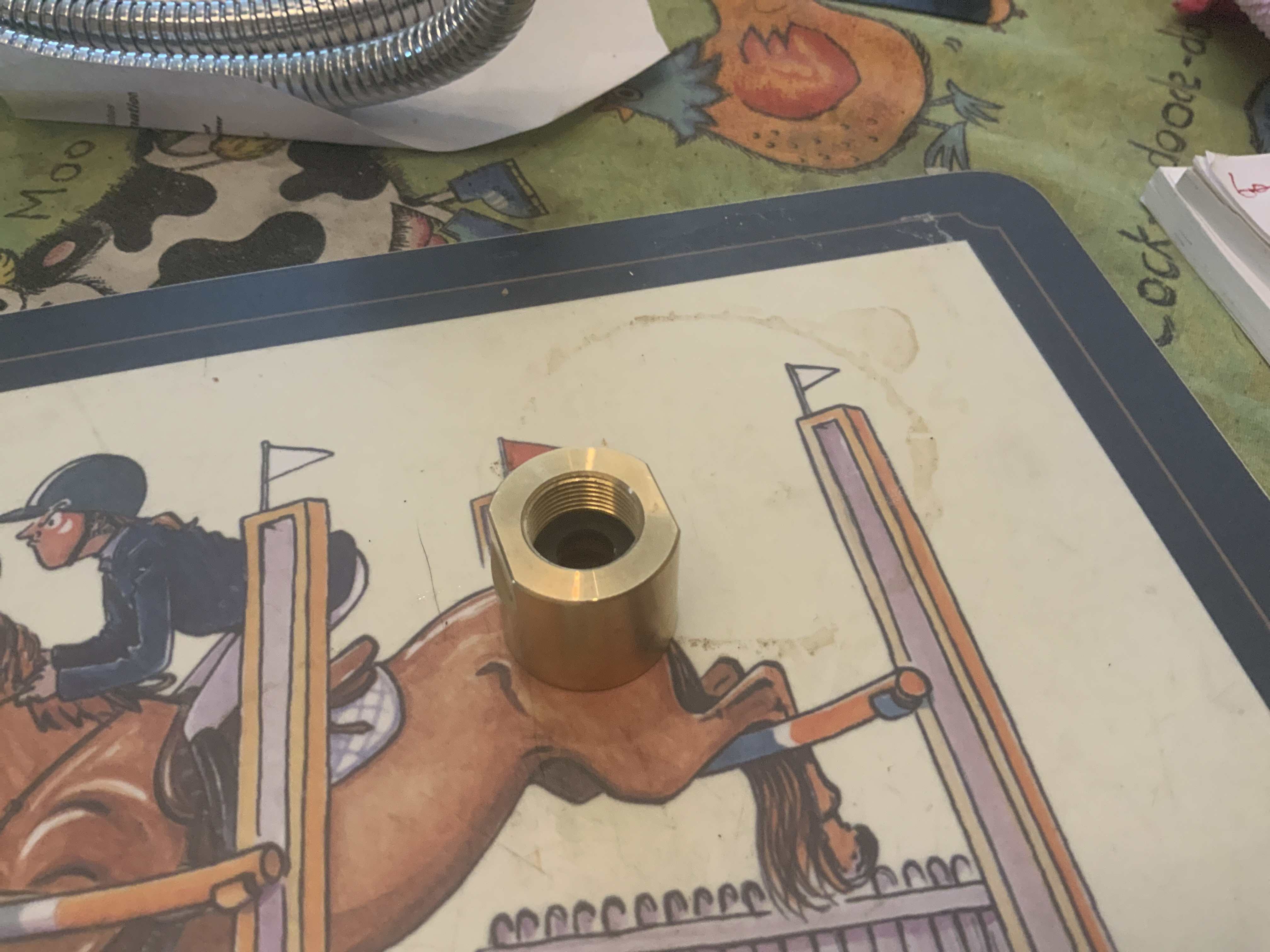

  7. Almost, but I think the problem I’d then have would be, a shower hose with the 3/8 female connector wont fit through the chrome deck mount, 3/8 male no problems. This plumbing lark and all these connections, well you need to have a mind of a contortionist. It’s a Problem solving bonanza. Almost like this company who manufactured this mixer from has some kind of protectionist thing going on, it’s all odd sizes. Firstly, the valve didnt have a backnut (must be lost somewhere), tried 3/4” too small, 1” too big, took it to work so the inspection team could measure it up for me, turns out M30, 1.5 threads, thankfully a chap on the machine shop floor found a large nut and recut the threads for me.

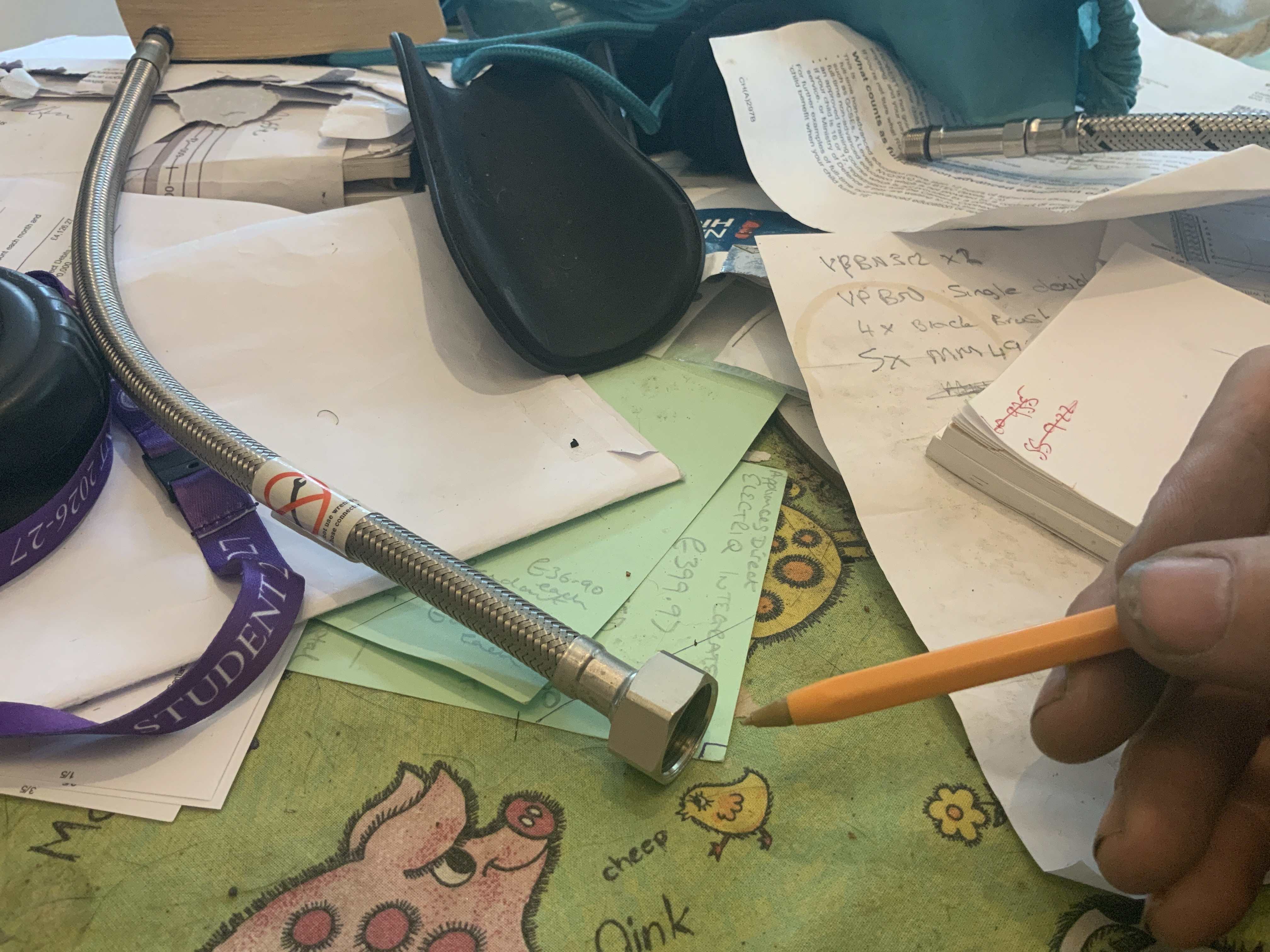

  9. Want to replace a through deck shower hose to a longer one, valve body has one of these adapters with it, bought a replacement hose but the 3/8” male wont fit the narrow end of this adapter, the valve outlet is 1/2”. I guess I’m asking if there is such a thing as a 1/2” to 3/8” adapter, or is there another way?

  12. slowly getting dizzy from going round the bend... Seem to have an array of fittings except the one i need grrr! What do i need to attach to a copper pipe to allow this to connect please? I can solder, but compression, or push would do me equally as well. Got some lovely Hep20 tails, but the connector doesn’t fit my bath mixer controller. Thin hep is 10mm and the mixer is 8mm. Ta.

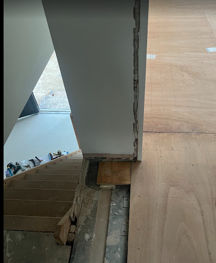

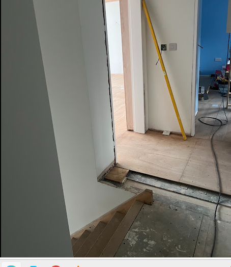

  13. Maybe a bit of 25*25mm angle drilled and screwed to each stud, bit of 15mm ply/osb spanning between them screwed to the angle. Might need to experiment with screw lengths…. Or dry lining boxes!
  14. If push comes to shove (last resort type stuff) and you don’t have enough clearance room and you don’t want to mess with the strong back then you can transition to oval mvhr ducting.
