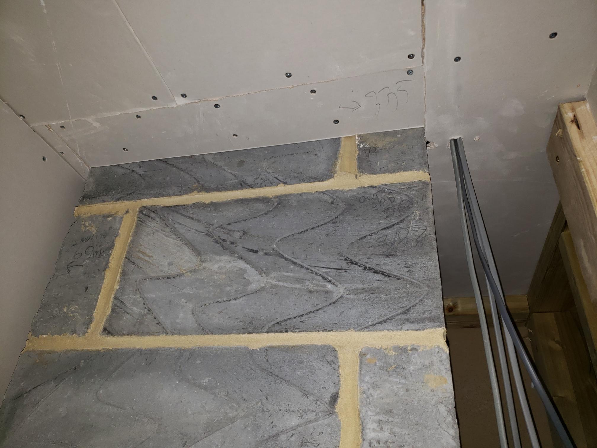

	Any ideas on the best method to seal around blockwork Chimney at first floor ceiling. Must be flexible.
