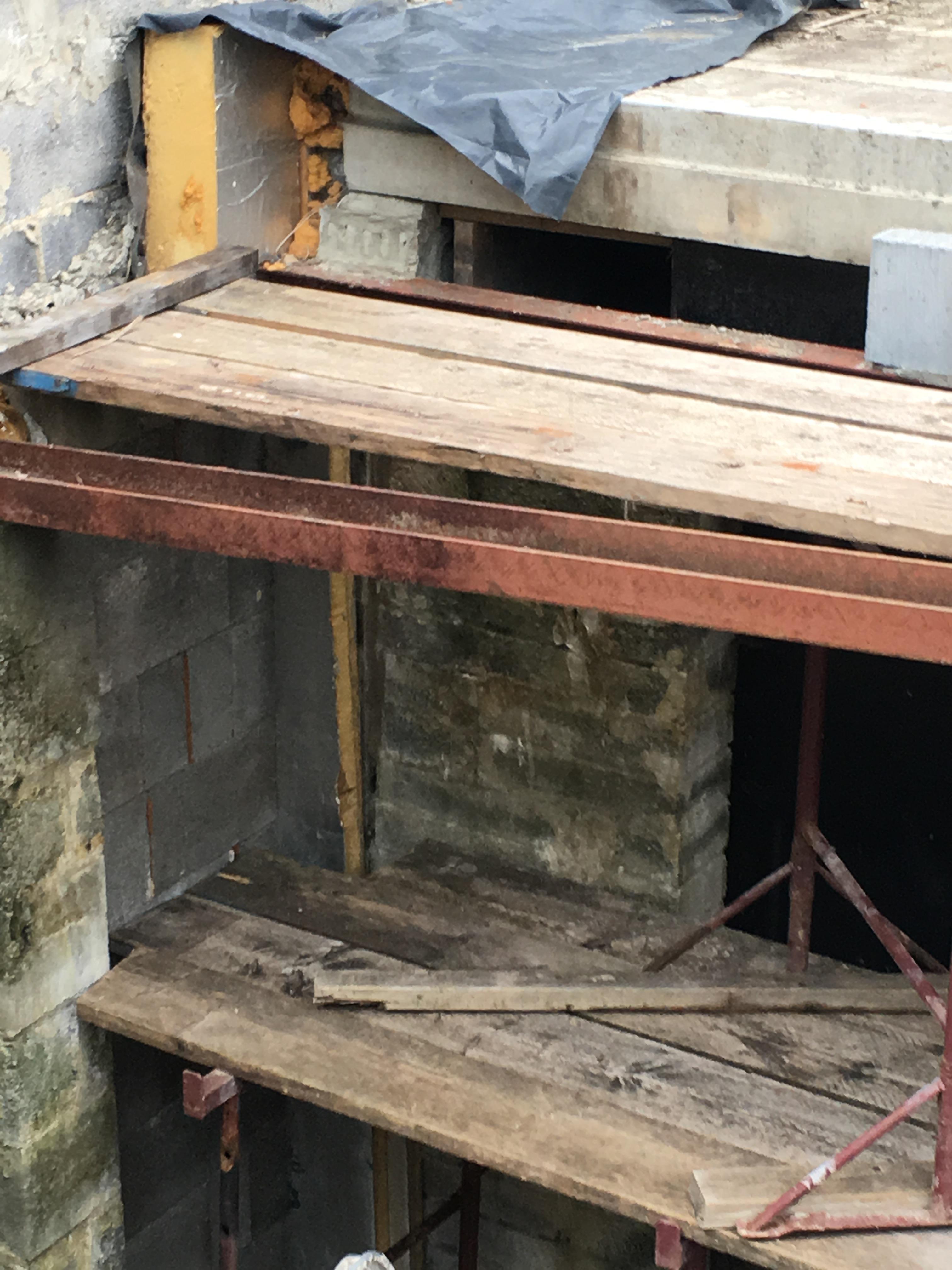

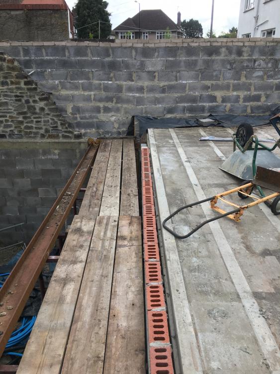

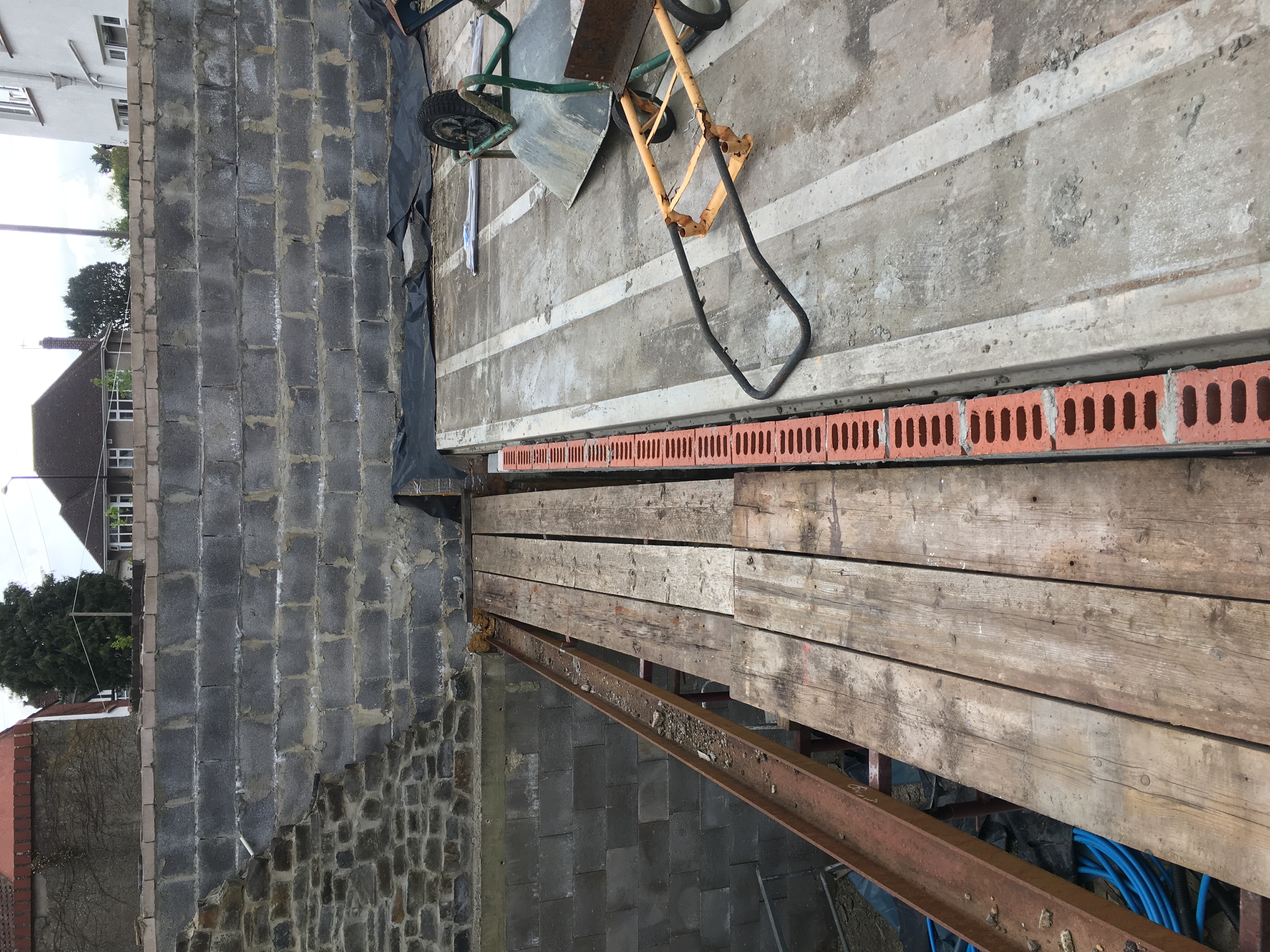

Thanks guys the beam curved not an issue just the gap looking face down between the brick work and the concrete beam . might just foam a bit underside then put concrete in . I did notice as I tapped each block as I laid them the beam 'bounced' which isn't very re assuring ..... cheers
