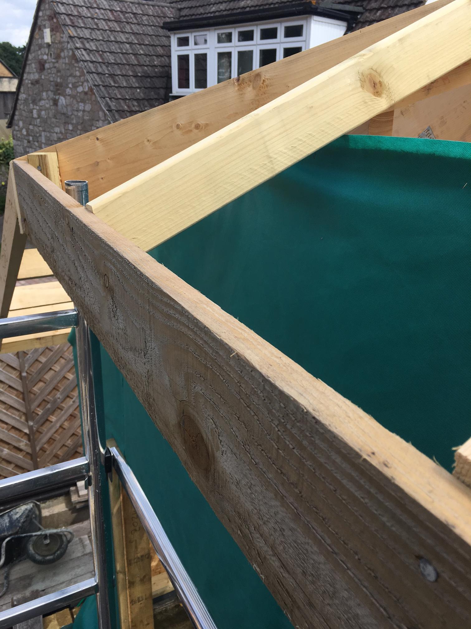

SO! Before I start batten and felt. I should put my fascia on flush with the fascia board (top edge i.e. where meets tiles). Then put those (what are they called!) bits of plastic that overhang the fascia but felt goes over to stop the felt sucking up water from the gutter. This is the very first job yes? ; then felt batten side and meet horrible (bloody architect!) hip thing !

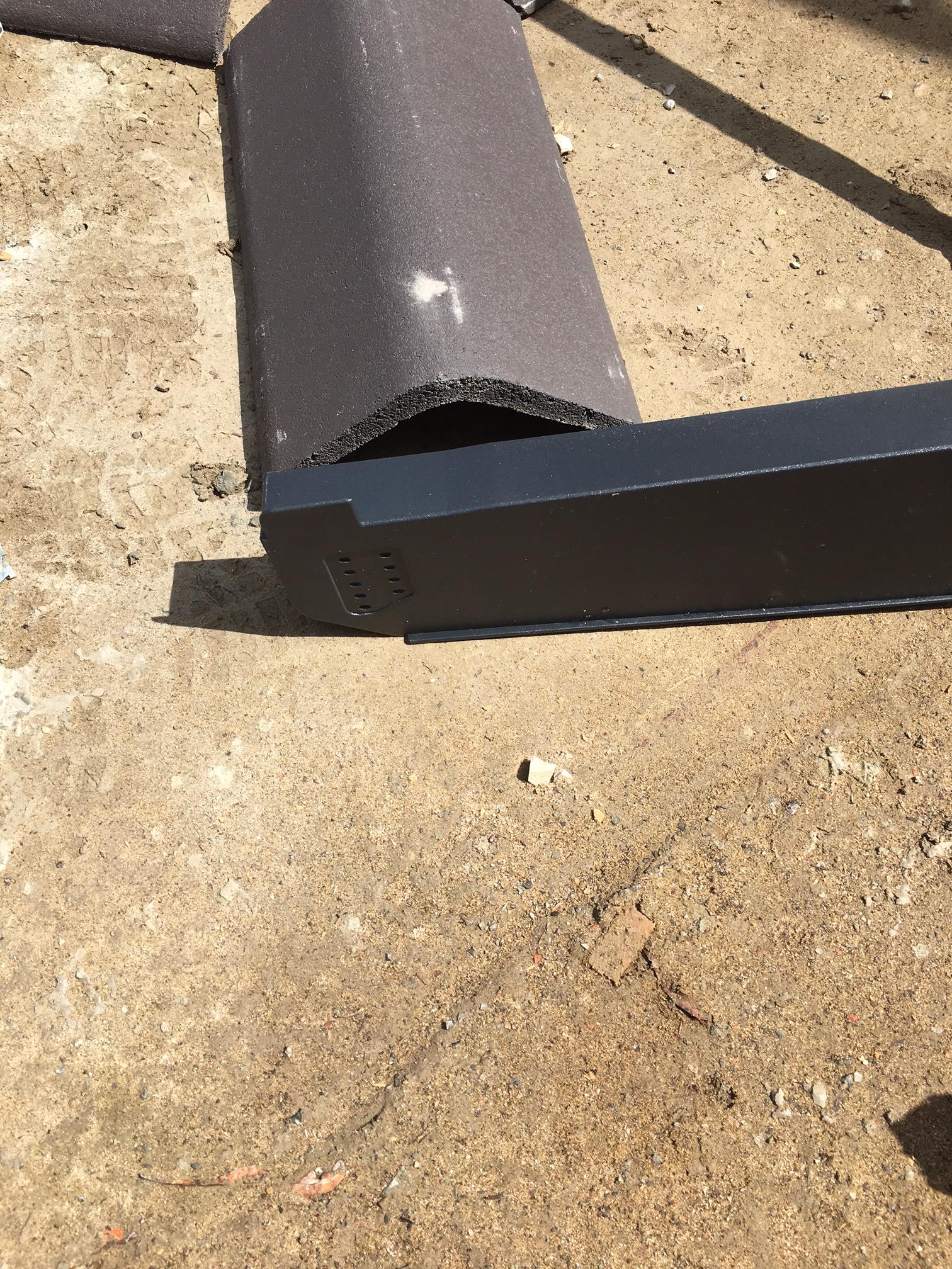

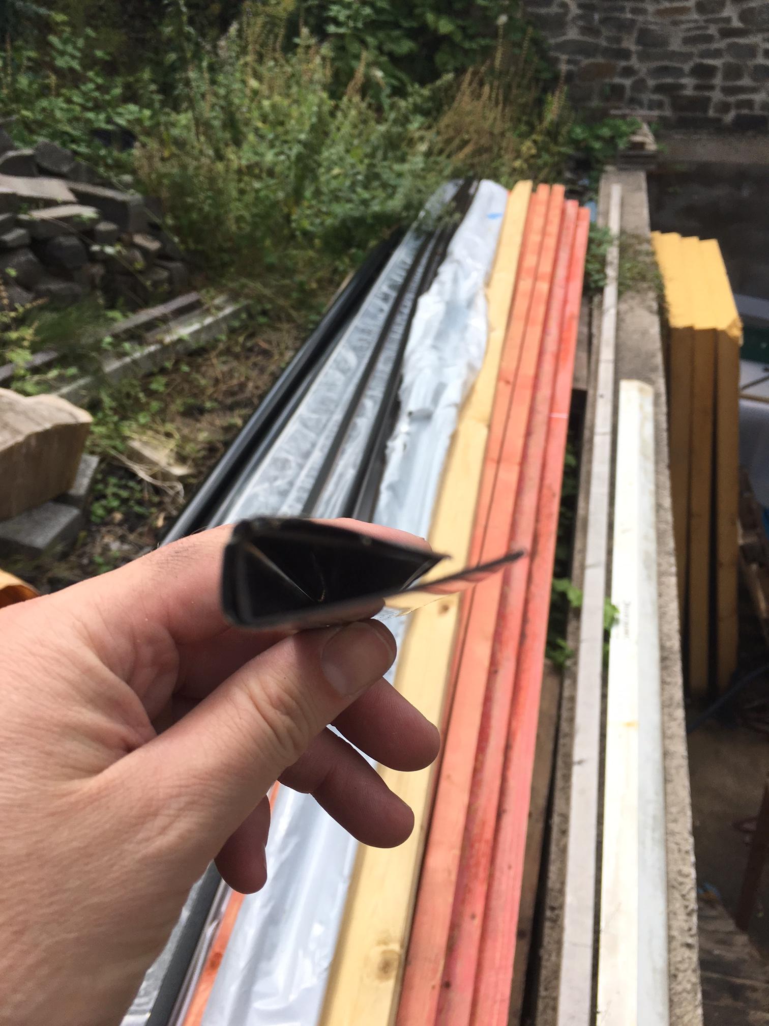

Oh yes! I found out what those plastic strip things are for!. They are for where you cut the soffit and have to attach to the building side i.e. they cover up the rough cut!

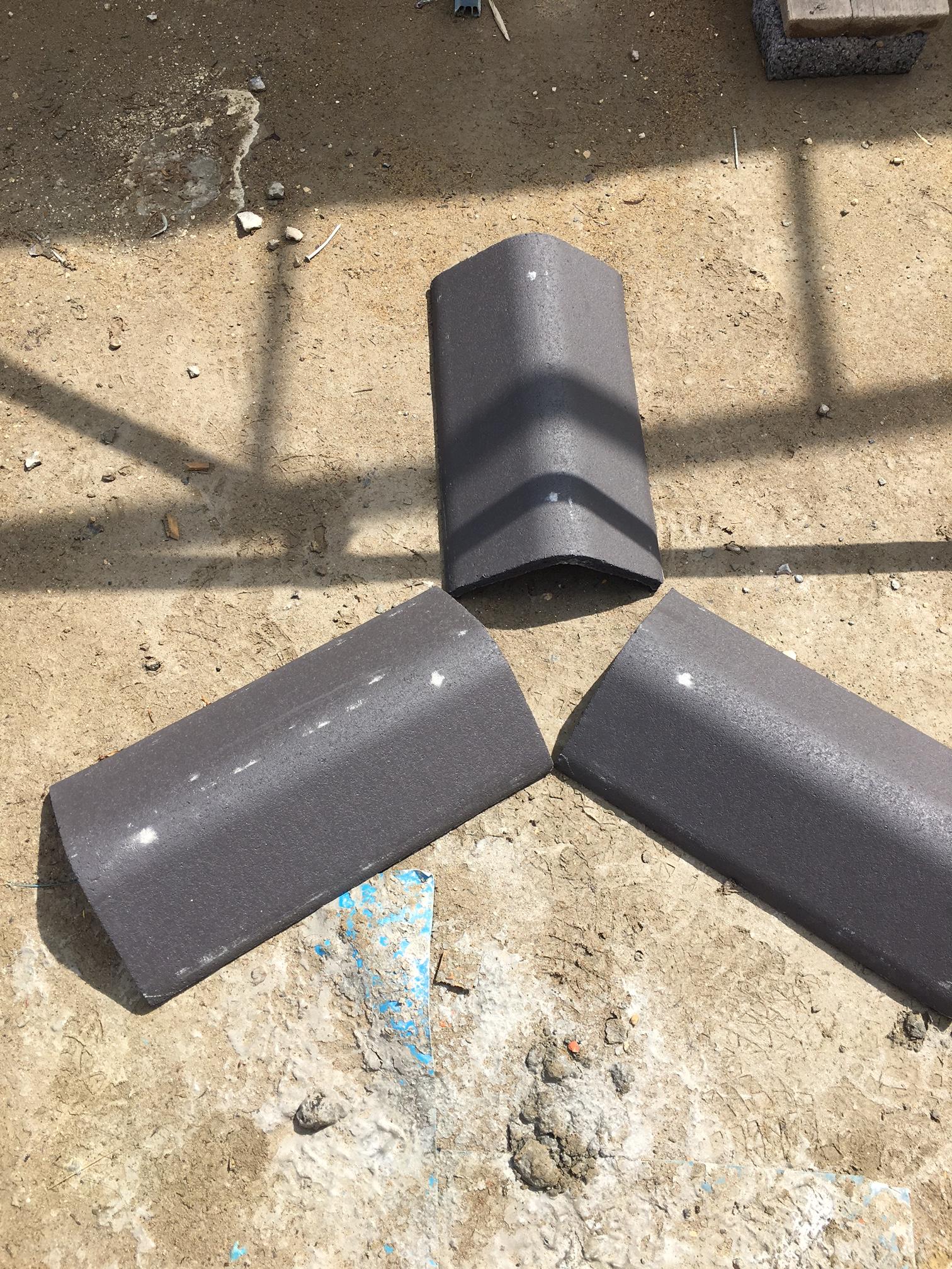

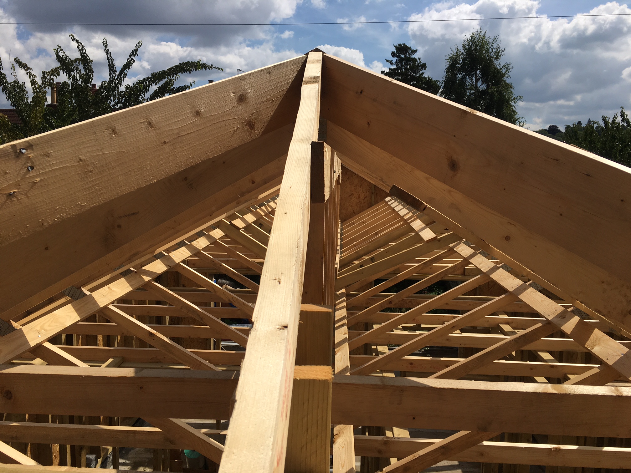

SO! (Assuming I understand!). The front verge plastic stuff goes up under the front 'end of hip tiles' ? I can see the issue getting the 'sides' and hip flat tiles (not the ridge) to line up. Because my roof tiles are laid right to left I'm starting on that particular side i.e. at the front - then I can check my hip stuff before I entire an entire side of the roof!
This is the other end of the build for me. This is easy (ignoring the height!) I got this bit sorted in my head. Special bit of plastic to 'tie' the 2 verge angled runs together!
https://www.roofingsuperstore.co.uk/product/marley-modern-plastic-hip-apex-cap-for-36-45-degree-pitch-grey.html AHHHHHHHHHHHHHHHH!!! This is what I need for that 'messy' 3 way angle. I did speak to a roofing supplier and they said 'just chuck cement in there' - which seems rather crap. I guess the issue is getting all the angles right.....
Yeah I did think this ! but where's the kudos of "I did it " :-) im sure I can muddle through ( got this far ) - but any help from people whom are experience at this sure appreciated.

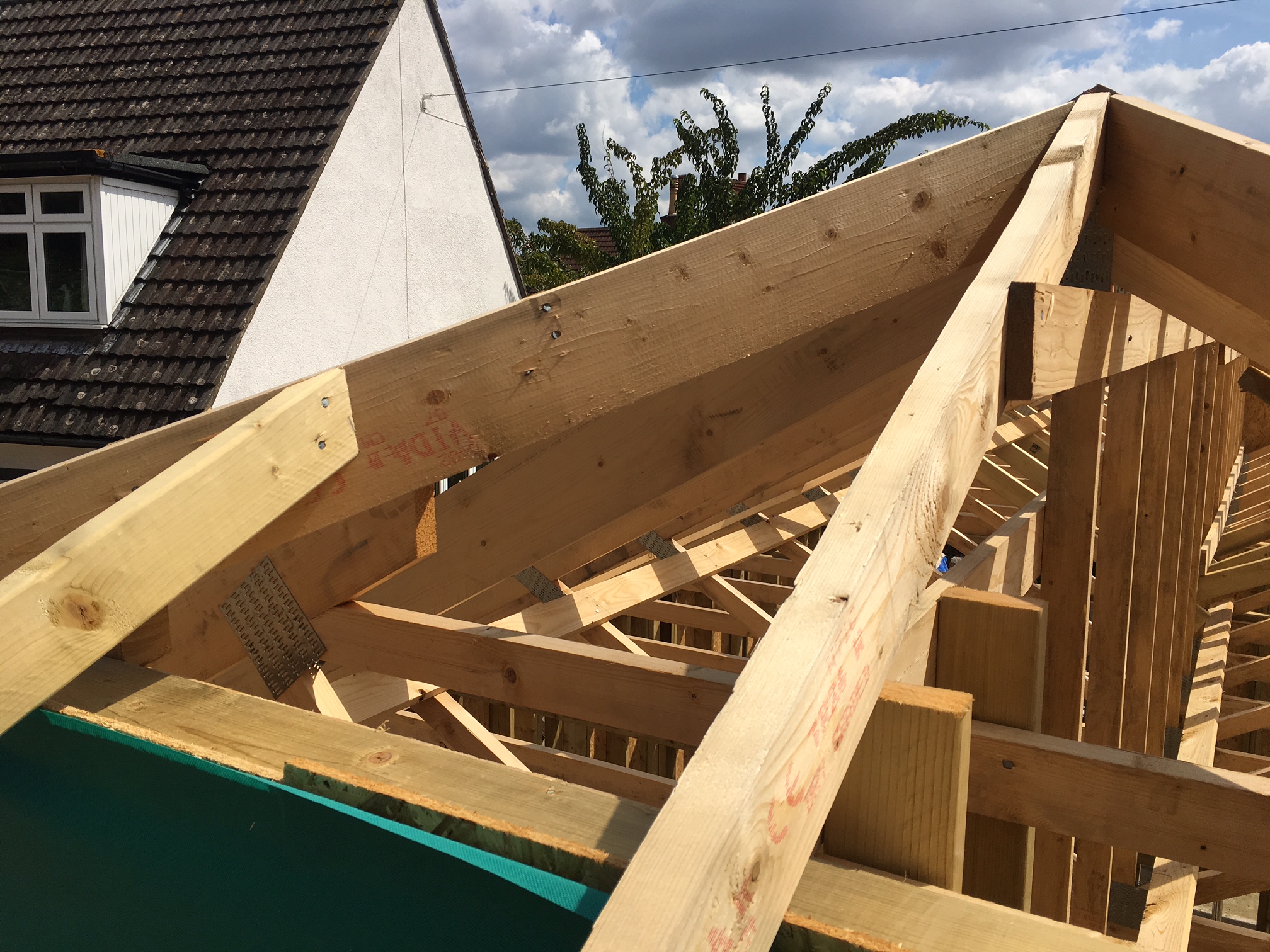

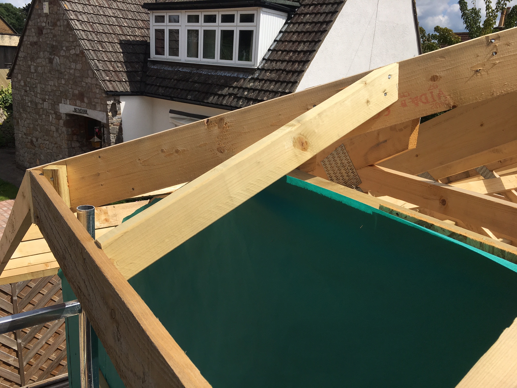

Hey all, Be prepared for lots of noob questions!; all help appreciated!! Guys have finished the timber frame and it looks AMAZING! - almost like a real house The roof confuses me (no sh*t). I understand on the main 'sides' it should be quite simple. Felt, batton with over hang at sides to allow for plastic fit verge things. I appreciate I need to get the spacing of the battons correct so the gauge is correct and also they ultimately over hang the fascia enough for the gutter. It's the front detail that confuses me. I have this hip thing! (not because I am cool!). SO!; the dry fit hip is fine for a continuous row along the apex of the roof - seems simple enough. But what happens when I meet the 'hip' and the hip tiles go in different directions? There will be a gap between the meeting point of the 3 hip tiles. Also when the 2 separate runs of hip meet the dry verge how does that marry up? Equally; assuming fascia is tacked onto fascia wood and tiles over hang edge and dry verge screwed to batton ends (assuming thats all correct) what happens when the angled verge meets the straight run at the base of the hip ? does it just run under the tiles that over hang the front? Appreciate lots of my questions aren't perhaps clear! So some photo's! Final 2 photo's show lots of strips the roofing company sold me (typically!); what are they for? All help appreciated as usual! - this thread might get quite long!
