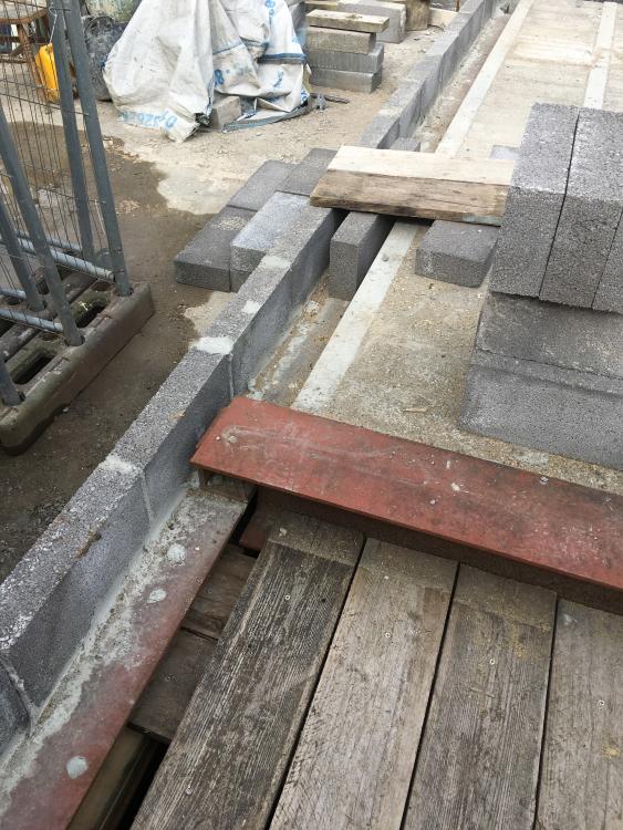

Hey! The timber frame sole plate will sit on DPC on a 140mm wide (140mm deep) brick 'wall' that I have to build. The majority of timber frame designs have the insulation in the timber frame void - which is fine for me even if different to the architect's spec. What I am tempted to do here is have the timber frame (just at the front as in the photo's) tight to that concrete block run (effectively the external wall); then the timber frame would sit on the block work which in turn is on the steel i.e. supported! so insulation internal. If BCO complains; then I could insulate externally. Why though does external insulation (and say then clad) require no cavity?. This is my real concern....

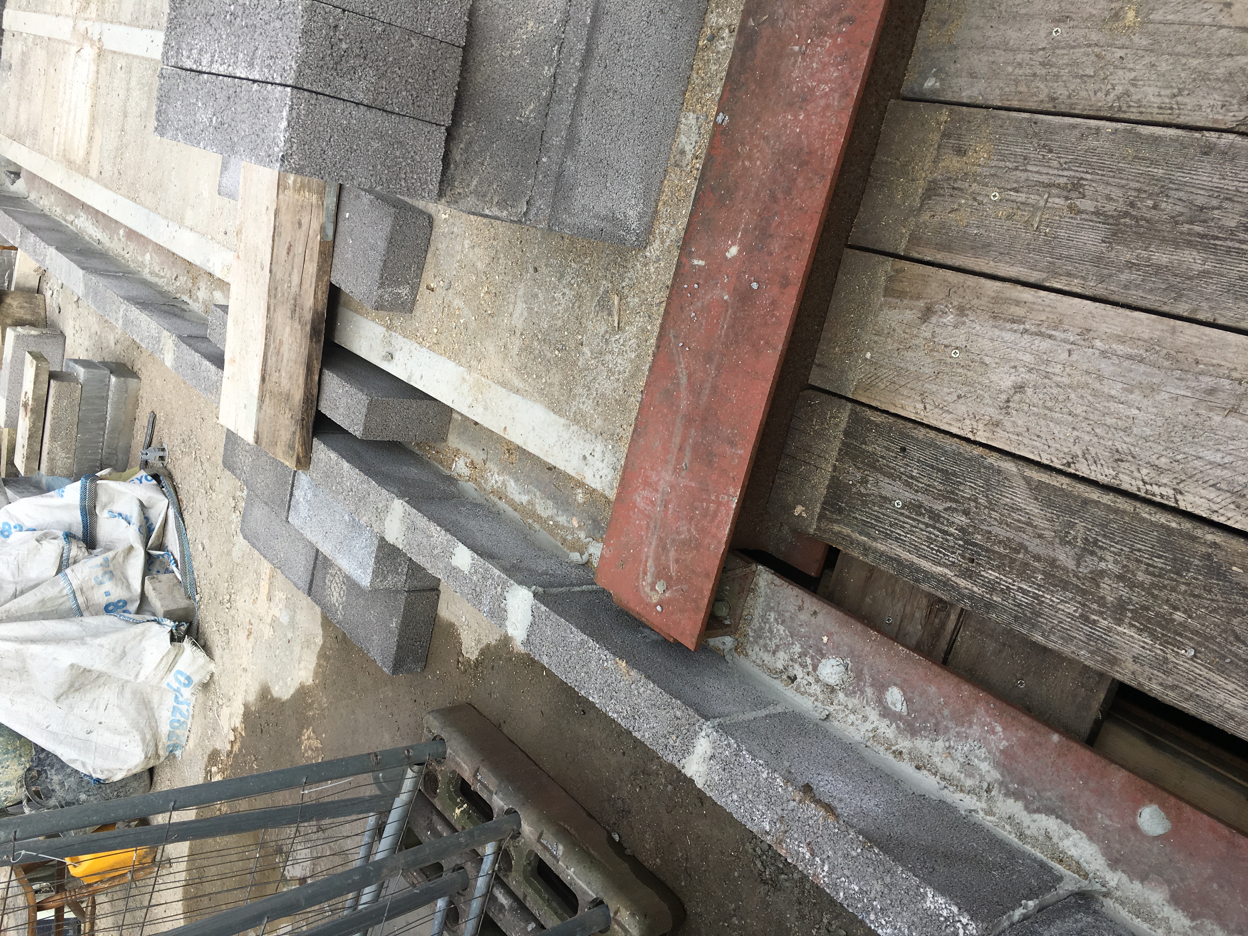

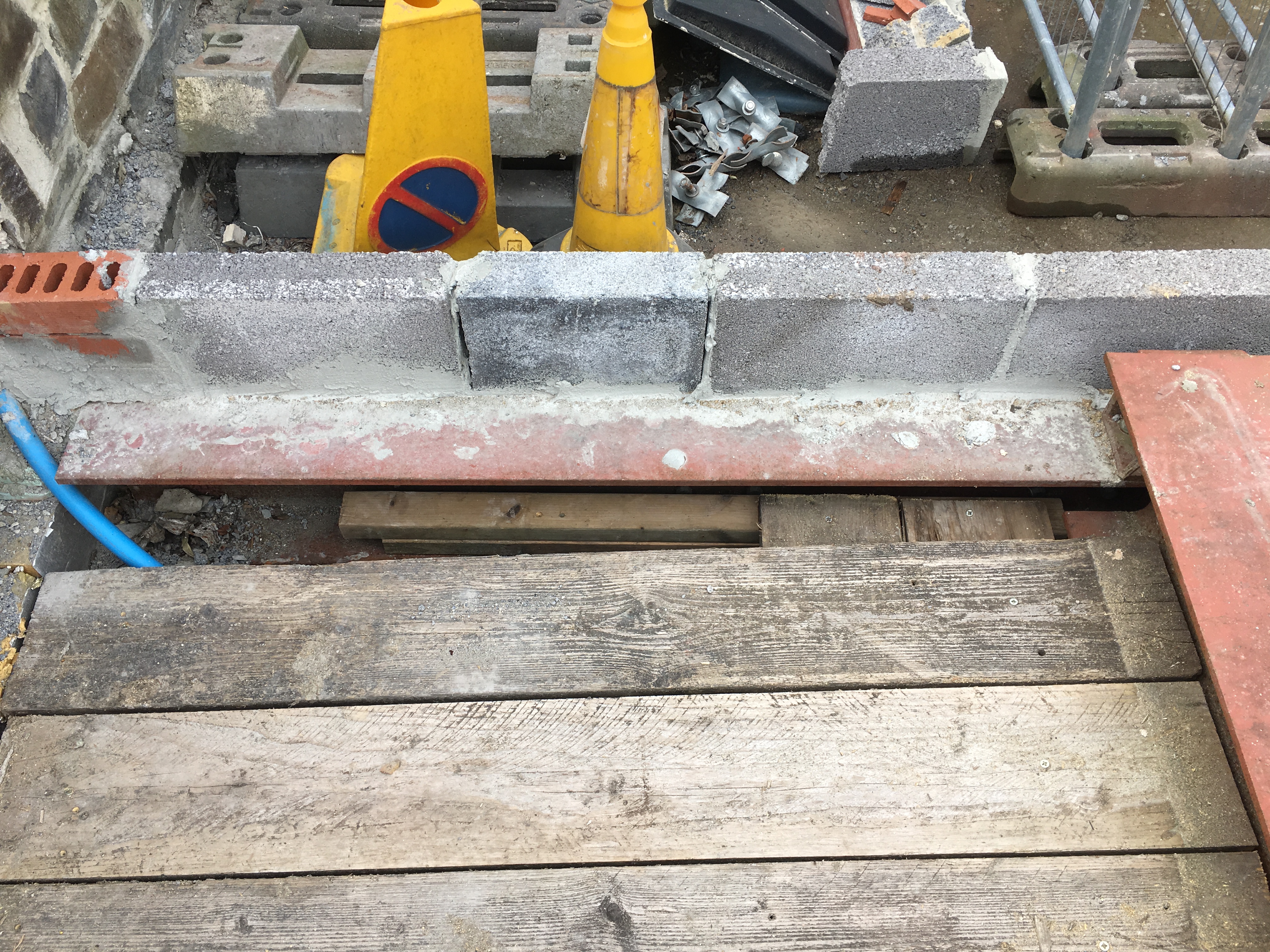

Hey all, My architect's original spec was for a 100mm timber frame. It would appear all suppliers min is now 140mm. It's not a problem apart from 1 issue. The steel works at the time etc. were designed for 100mm. So (please see photo's); whilst the timber frame can follow my block & beam but by the time it reaches the stairwell there's just the steel left spanning (which isn't wide enough now). I assume quite sensibly ( I hope! ) that the timber frame can't span that gap unsupported? I could put a nice 2m lintel across. But as the timber frame is structural I assume I need proper advice on that? Timber frame supplier hasn't got back too me yet; but I think they'll say 'your problem' .

What about a steel sheet bolted across to make this extra floor? Surely I don't need an SE for this - cost more than the steel...... Oh architect! ; please design stuff; not just nice pictures.....

The tf guy said to check with boc if insulation as well in timber frame void . the tf at 140mm sat on b&b ; at the edge of b&b which in turn is sat in reinforced concrete walls . So nothing should be sat on un supported b&b if that makes sense . cheers
