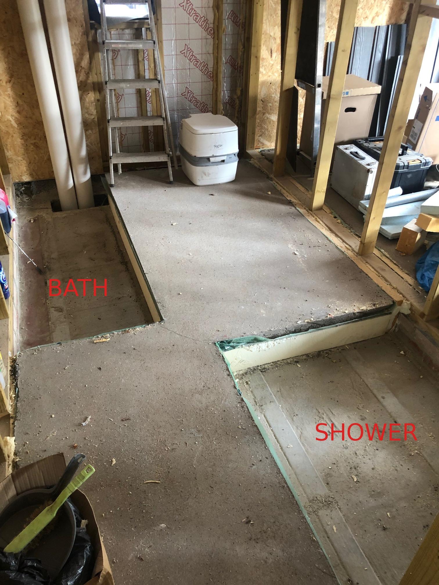

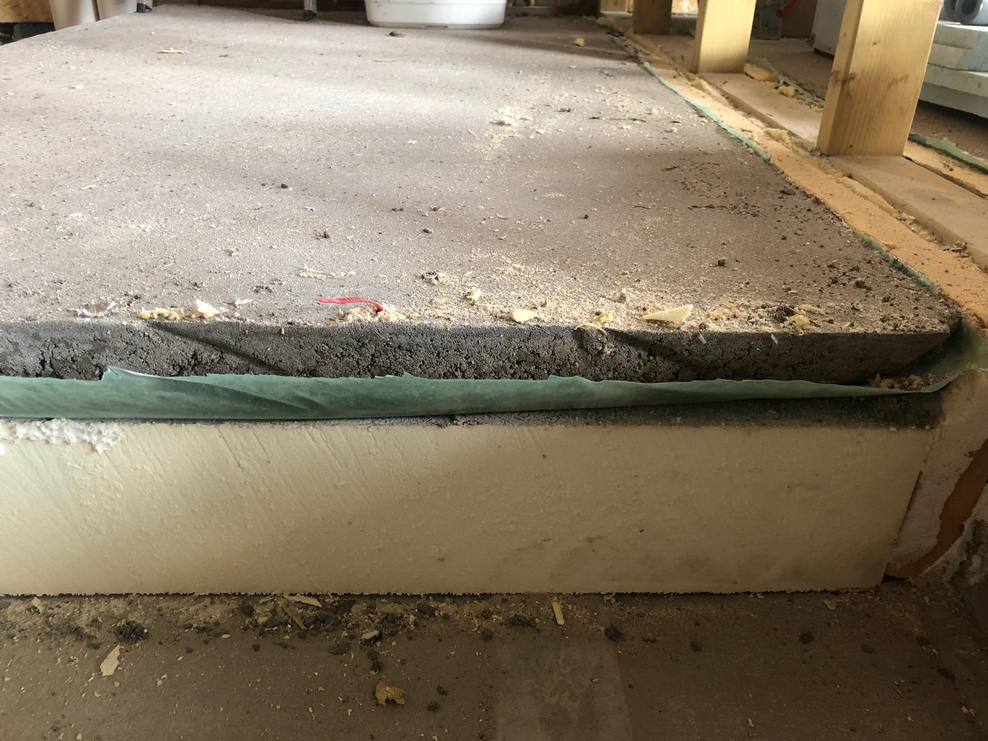

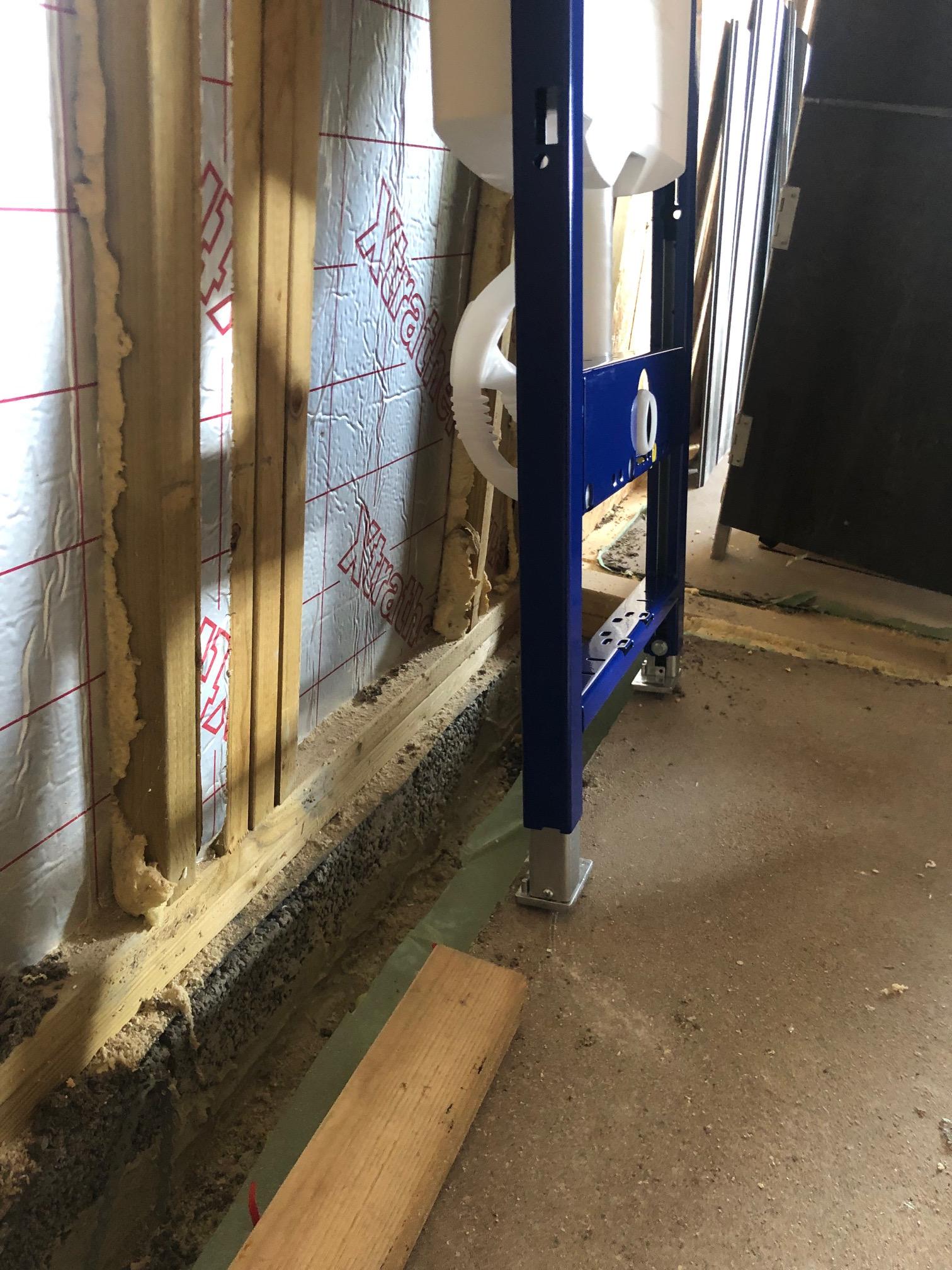

OK! Related to my bathroom thread but specifically about floor and other issues. So!. We have large gaps for bath and shower tray to sit. Mainly so I can position waste and any necessary pipework. The floor as you can see is 150mm PIR then UFH screed. How should I fill these gaps once I know where my waste is going?. Just 150mm PIR and then mix my own screed? - I'm just worried the separate screed will not bond to the existing and therefore not be stable. 2nd issue is the false wall I must build to house the cistern and also hide a multitude of pipes etc. It needs to be away from the timber frame. Will this be strong enough for a timber mounted geberit frame?. Should I use steel brackets so that the false wall is tied to the timber frame for extra strength??? ( Photo shows frame and rough position of timber for the false stud wall).
