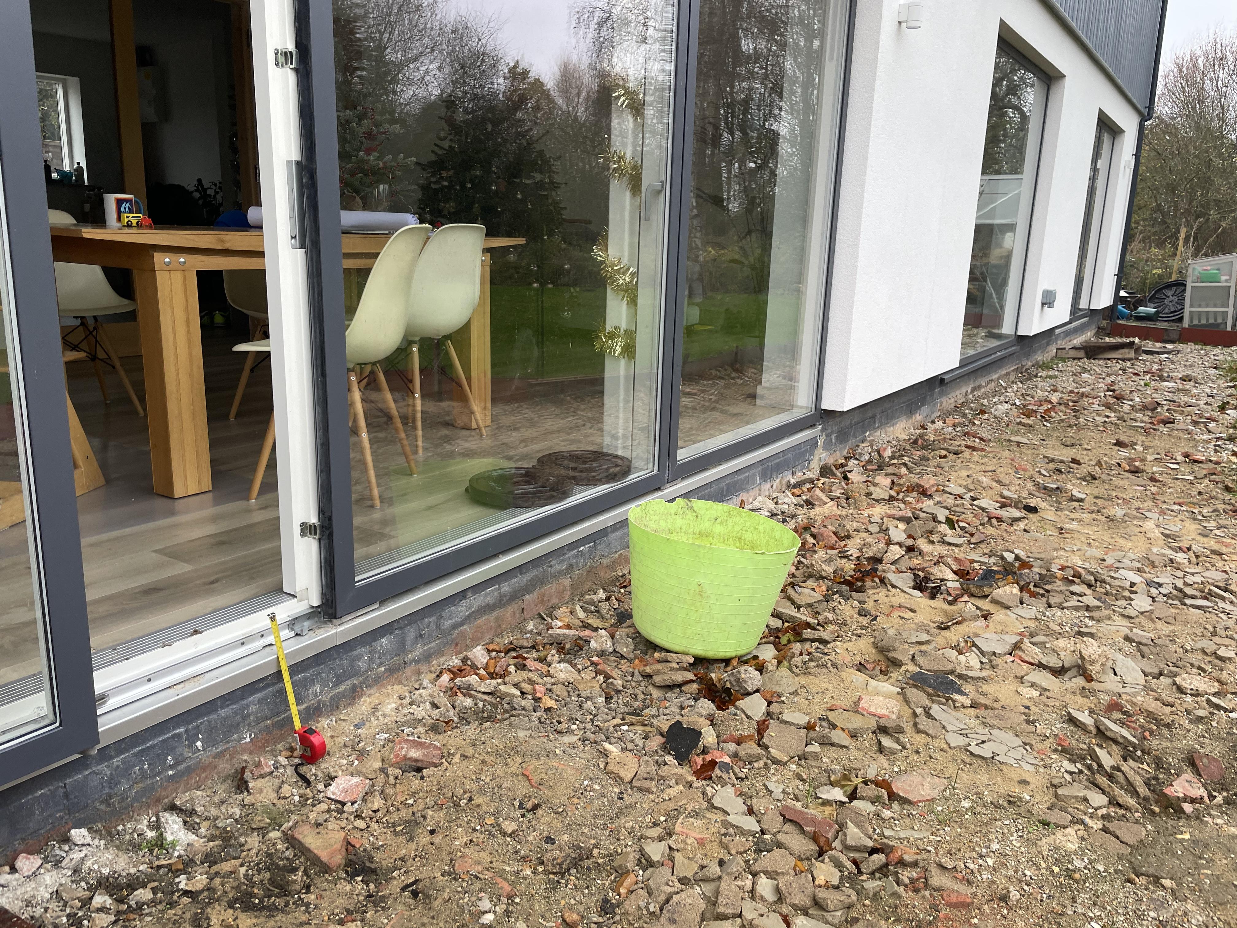

We can live with 1 brick below dpc and the floors are set at dpc level. Is a linear drain or pea shingle the least risky as I don’t think we can move to a step option so we will have to hope for the best. That means the patio will be just below the silver door strip on the image.
So we have 3 fairly big (one huge) opening on this face I don’t think we can make a feature out of steps! The EWI is set 100mm above dpc (I know this is totally wrong but it one part of the house dpc was set at a different level due to an extension).
So we wanted to bring the patio to about 50mm below the DPC and was thinking of using an aco drain (or linear drain). We can’t change the cavity tray the building works are done plus it sounds pretty costly on an existing house, we had initially considered painting some dpc stuff on the brickwork with a 100mm wide pea shingle channel but then didn’t think this would be as effective at preventing damp as a linear drain. One of my relatives just had a damp survey (admittedly on a older property with solid walls) and the surveyor said do not reinstate with a french drain but use a linear drain as they often cause damp and lead to more water sitting against the wall (their ground levels are already raised and cannot change them). The garden slopes away from the house. So will an linear drain lead to more likely chance of damp than pea shingle? I mean I guess this work isn’t recommend but our EWI insulation is overhanging by 110mm so maybe the splashing thing is quite low risk on the brickwork below that is exposed? I should add if we can’t bring the patio up to 50mm below dpc along the back of the house (we have a lot of not very far away from each other patio doors) then it will mean quite a drop when going outside as it’s already 150mm as it stands if we go with 50mm below dpc. Should add also our 50mm cavity is filled with eps beads, maybe the overhang with the EWI and the number of openings makes this level change all very low risk.
@Dave Jones So there is no way to achieve this it would be like a 250mm drop from the flush floors inside if we used 150mm below as bench mark. We were hoping to bring it up just below dpc to get the drop nearer to 150mm. We have some very wide bi parting doors and I don’t see how a step would work. Just to add it’s a refurbished 1960s place.
We have some sandstone paving we are laying, we are also building up the threshold to be more in line with the DPC so there isn’t such a drop from the patio doors, as such we were thinking of putting in some kind of aco drain to prevent damp, is this the best way or is there a cheaper/easier to install alternative to this option? Do we literally just set this aco drain in concrete once we’ve hopefully got the right levels? The house is 16m wide so it’s quite a wide patio!! Probably making it even harder for novices to lay correctly.. Any tips or pointers most appreciated as whilst we might not start until the weather thaws a little now we do want to get everything we need ready and have a bit of a plan on how the hell we do this.

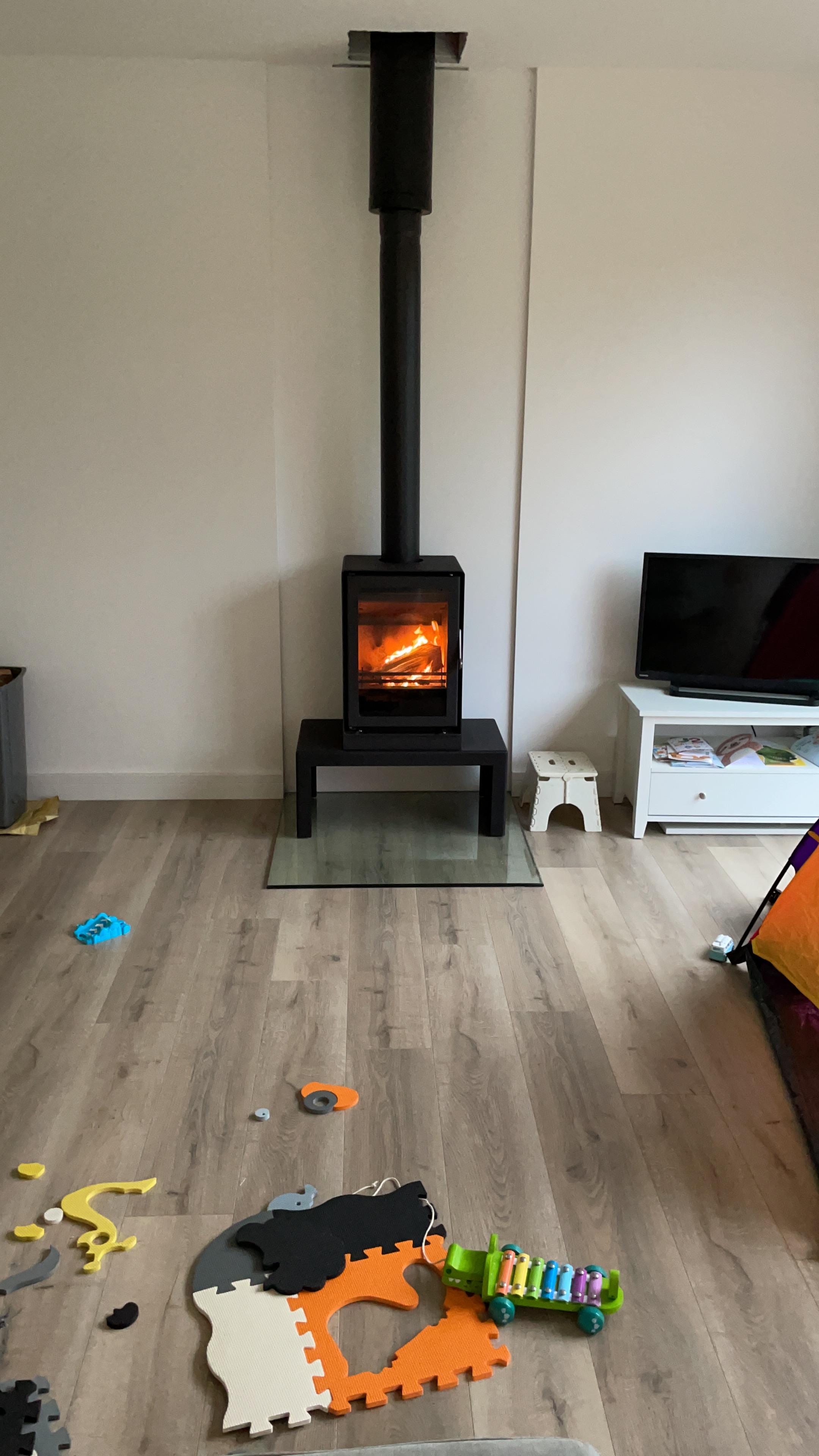

I can report back that everything has been resolved without cutting? just took the twin wall adaptor off slid the stand and stove along the glass contructed all the bits & slid it back in using the extending part to lift it into position, luckily the adaptor was the thinner part and gave the clearance to do this and I decided a scratch on the glass was the least risky option. Now the next issue, it’s not burning amazingly not sure if that’s the weird weather or our place isn’t drafty enough or the conifer of unknown moisture content I’m using! -

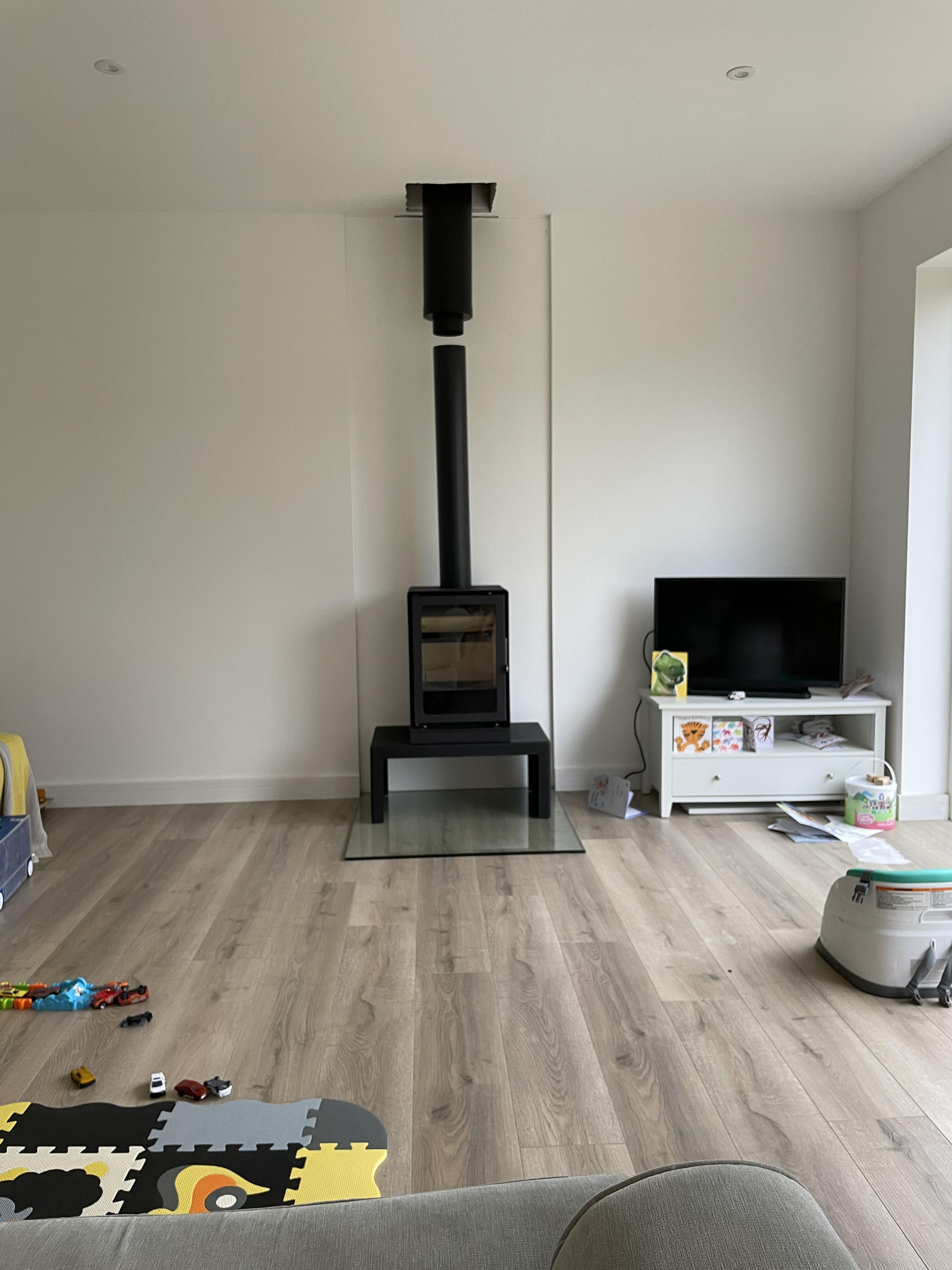

So anyway just so it’s clear I need to cut 10mm off the top of the long vitreous pipe you can see in the photo to get it installed. Now I’ll start with 10mm because it will probably need 15 attempts but I’ve got an extra 220mm of error to play with as the adjustable pipe can extend this much -

So yeah the most painful thing of this whole saga is the black pipe you can see in the photo of the gap had been 10mm further away we could of got the adjustable section of pipe in and then slide it up onto the twin wall! -

@ProDaveI have an adjustable piece which goes in between the gap and the twin wall you can see, I couldn’t buy the right size, 500mm was too short 1000mm too long, twin wall was installed ages ago and is not moveable now. The adjustable pipe slides down into the longer section of pipe you can see as far as the end where it widens to connect onto the twin wall, I can’t cut the hidden male end on the long pipe going into the stove because it needs to be the end which reduces that goes in the stove according to the manufacturer which also means I couldn’t buy a brand of pipe that has more different lengths as it doesn’t have the right reducing end detail at the end of the pipe for the stove. -
Issue is in the title we need to cut our black wood burner flue so it can fit and it will be on show, damn. I’ve got an angle grinder with some kind of diamond blade in that I can’t get off (neighbour said they used this to cut their aluminium door letterbox so I’m hoping it’s sufficient), is this really going to work to get a straight clean finish on a black pipe ??? Any Other ideas?
