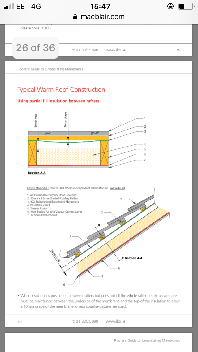

Sorry for the multiple posts but I am reading different things on different websites regarding what is a warm roof.. maybe we do have a warm roof but what we are missing is the vapour control layer no.6 in diagram attached otherwise our roof structure is identical to this image with the addition of insulated plasterboard. However I am slightly confused as we are not using just plasterboard rather insulated plasterboard do we still need this air tight barrier before the insulated plasterboard goes on or can it just be taped like normal for plastering as a 3mm skim will be going over it all? -

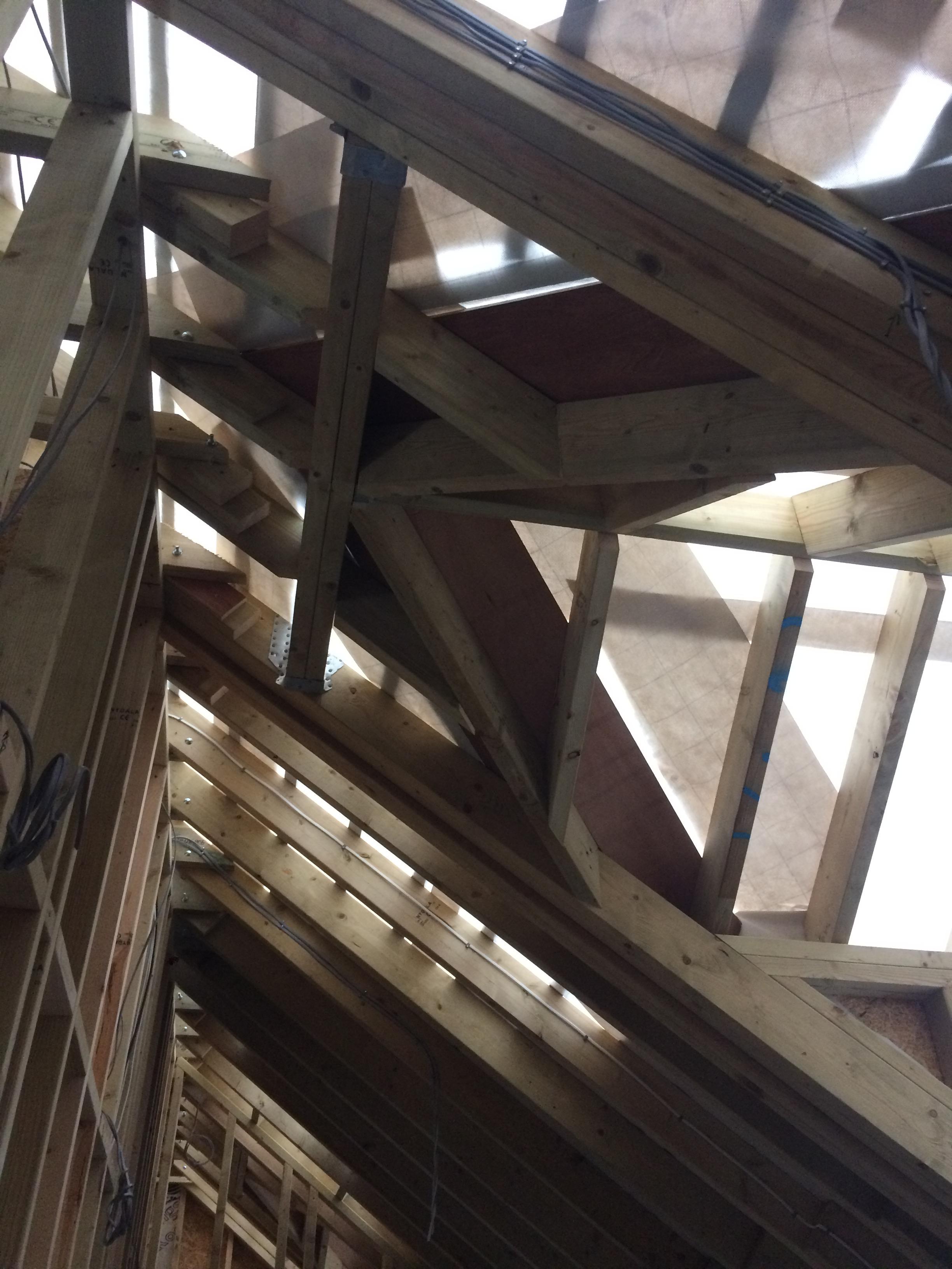

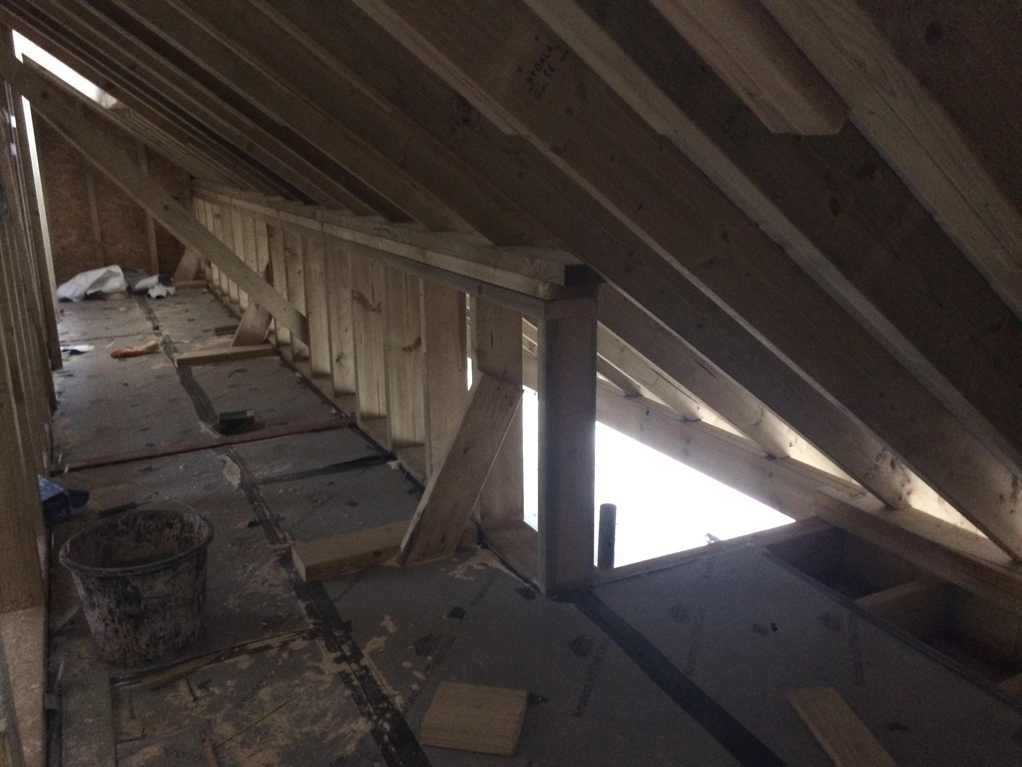

@Russell griffiths I enclose some images of the most complicated roof structure we could have chosen (or rather to appease planners). As you can see the roof detailing for airtightness has not been considered properly in hindsight & I am not sure I grasped what a warm roof was but it turns out that’s not what we’ll have rather a cold roof oops! Considering this is all new roof we could have done better but oh well. I see that I need to tell the builder to not stuff little bits of insulation in gaps like that as they haven’t finished & maybe tape it ourselves as not specified but this might be pointless as no squirty foam used, there is then some insulated plasterboard covering over it all. Is it ok to use an airtight membrane inbetween the rafters and the insulated plasterboard or will this create damp? I also don’t know how we easily tape a membrane over such a high complex vaulted ceiling my YouTube searches have been fairly unsuccessful in figuring out how we do the second option if it’s pointless to attempt option 1 as foam hasn’t been used? The new external walls (unfortunately only to 3 sides as asymmetrical dormer pitch) don’t suffer quite this same problem as I guess they are effectively warm walls if you can call them that, but obviously the junctions between the cold roof and warm walls have not been considered at all so still a screw up as anything we do now to improve can be internally only with difficulty.. we do have some downstairs EWI going on existing masonry which can maybe improve the junctions slightly but probably not totally. The guides I’ve found don’t seem to help me especially for the cold roof as we also have old joining onto new and some sensible new warm wall arrangement with a less sensible new cold roof coming together! Thoughts on last minute additions for upstairs before it’s all boarded in plasterboard !!? -

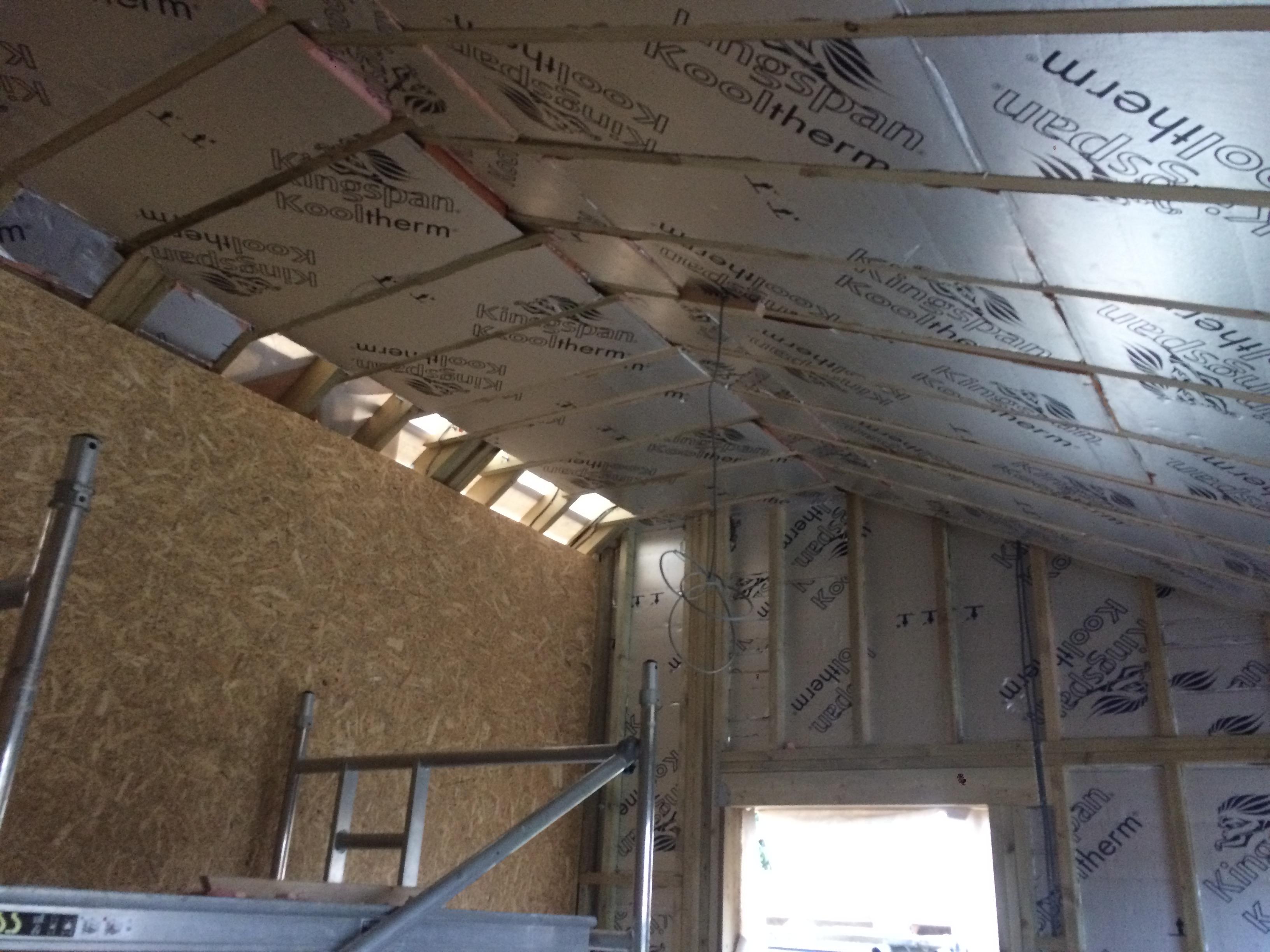

@Russell griffiths @Onoff? roof rafters will all be overboarded with some pretty expensive phenolic insulated plasterboard, can we make this layer into the airtight membrane or is this impossible? The insulation cut and installed between the roof joists has not been inserted with squirty foam gah! I don’t see any internal membranes or tape on the roof internally.. The entire outside walls including studs (but not the roof ?) have been wrapped in big boards of PIR, they used a membrane to wrap the house before the external PIR went on and then a Kingspan one after - this was the insulation brand . I didn’t see any tape but it all overlaps, surely all these membranes are for airtightness or manufacturers wouldn’t sell it?!? They also both looked more like a breathable membrane than a plastic looking one compared to your images. There is also PIR cut between the wall studs but the studs are very thick so insulation not flush and again pretty sure no foam used.. the walls will just be plasterboarded no fancy insulation plasterboard... Pretty worried now that our expensive insulation is about to go to waste but also at least the wall build up sounds a little different from the usual approach or am I wrong on that too? Why aren’t there better guides for this and why don’t architects understand the principles pretty sure they are working exactly to as drawings described ? -

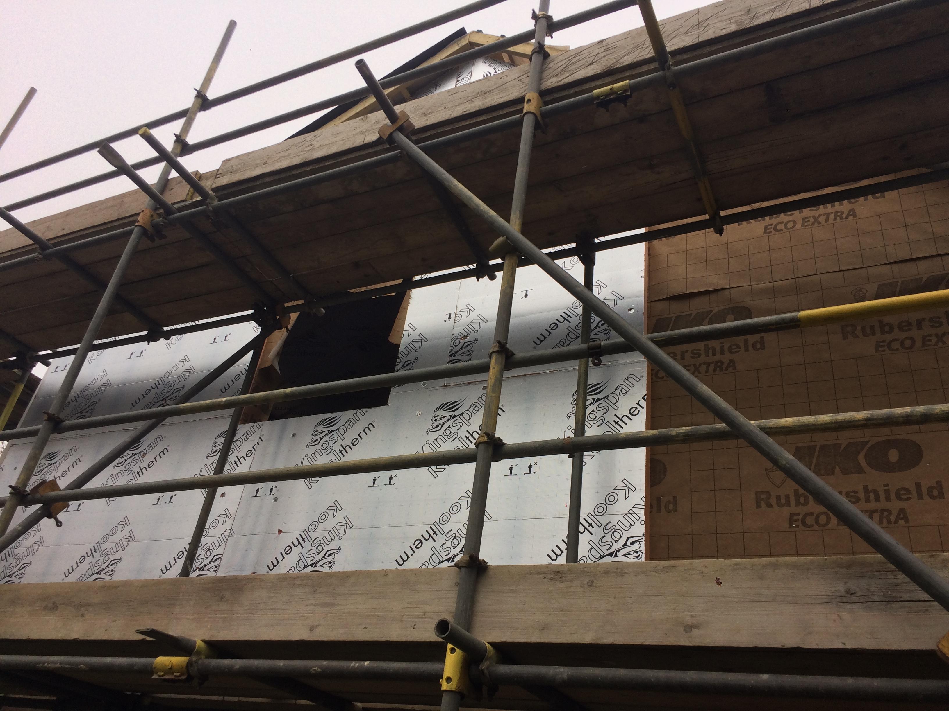

Morning, Probably a bit late in the day to be posting this but our architect didn’t really have much knowledge of the area & our builder just does things the old way (much more common in the refurb area than new build I know)! The new roof & 1st floor is a warm roof formed of 100mm PIR between the rafters with 50mm air gap & roof membrane & then 50mm phenolic insulated plasterboard below rafters. For the walls it is 70mm PIR between the studs with membrane, then 70mm PIR externally with another membrane on top before the cladding. Outside walls & roof etc done but insulation still exposed on the inside/not finished as pretty big area for them to cut between. Anything we can do internally at weekends at this late stage to improve airtightness? We have ended up going with a air source heat pump as no gas but are now concerned we should be doing more on airtightness as nothing else other than the description above put on the drawing so I presume it won’t be particularly air tight hoping others have some suggestions as really struggled with information on what we can do to reduce leaks? FYI downstairs is a refurb with 90mm EWI & 50mm EPS cavity fill we are having velfac windows set out using lugs into the insulation but doors/patios are another leaky conundrum and have to be set on the bricks (not even in line with cavity due to some old steel lintels we hadn’t considered & render not being able to go over these). We know this is a cold bridge issue but window orders are done so cannot bring insulation into the reveals now & velfac sashes have no fixed frame it all moves so cannot overlap at all externally. Would some Xtherm 20mm insulated plasterboard on the door internal reveals make this situation any better or is this just throwing more money after bad? These are all things we requested to be added on insulation wise with architect but really we are not experienced in this & have just been trying to make sure we could get it built quickly given we are renting so our ideas may be somewhat of a halfway house. Basically we think other than the downstairs door screw ups we had some kind of insulation plan just execution might now not be right as I get the impression from reading it’s actually the details that matter especially to stop air leaks?

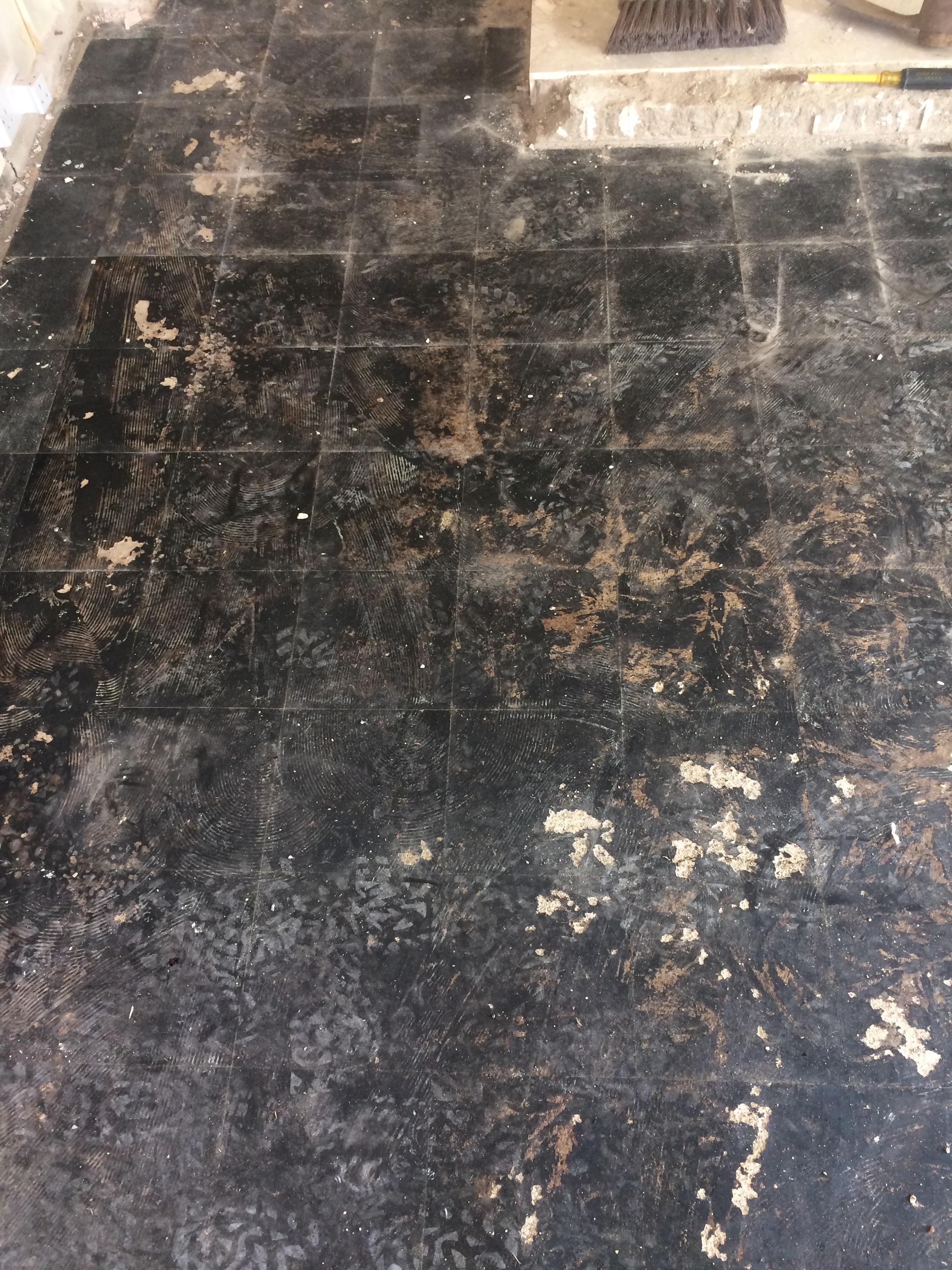

We were planning on underfloor heating and then we started looking up costs for reinstatement, materials, labour etc as its about 117sqm of existing slab and started thinking it might be a bad idea... We might have more news on what we find at the weekend as we're hoping to prize up the bizarre floor tanking system put in the large retrofitted mobility access wet room which will leave a big hole and hopefully some clues at the edges.. We are still intending to put in a planning application for replacement, not sure it that will really help with the objective of saving money but it might just mean things are much less risky albeit will probably take longer but a better house at the end. Either way we need a fall back so doing what we can ourselves now as bungalow needs stripping and possibly even roof off to get rid of the maze of load bearing walls even if we have to retain it. We have certainly learned our lesson on what not to buy and we haven't even really started!
Thanks for info yes tiles are gone came up whole. We had considered initially digging up the entire floor for insulation & heating purposes but it sounds very costly having to reinstate everything like dpm, concrete, screed, hardcore. I was reading that there possibly isn’t a DPM layer anyway and the tiles and bitumen stuff might be all that was used along with 100mm concrete groundbearing slab (pretty cheap 1960 council construction). I wasn’t sure if the waste from the concrete would still be considered hazardous and the process of digging up floor might make the trace asbestos airborne. Maybe we’re overthinking it and with all the new plumbing it’s going to make very little difference how much of the floor is removed?
Great thanks for info. We need to dig out at least some of the concrete floor for new soil pipe and heating pipe work etc so not clear on what this means for asbestos concerns as sealing it won’t solve the whole problem. If we get a asbestos survey will they want to test this part of the property even though black glue is basically ingrained into the concrete floor?
This is the floor, tiles are gone, concrete below
Just wondering whether there is anyone on here with experience of renovating a 1960s bungalow either extensively (floors/ceilings removed) or full demolition. There were some asbestos vinyl tiles and we are trying to work out whether the black bitumen stuff is likely to trigger specialist removal requirements too? There hasn’t been any obvious panels or other surprises either in loft or garage so far and we’re keep our fingers crossed about the fascias as they look fairly recent...
