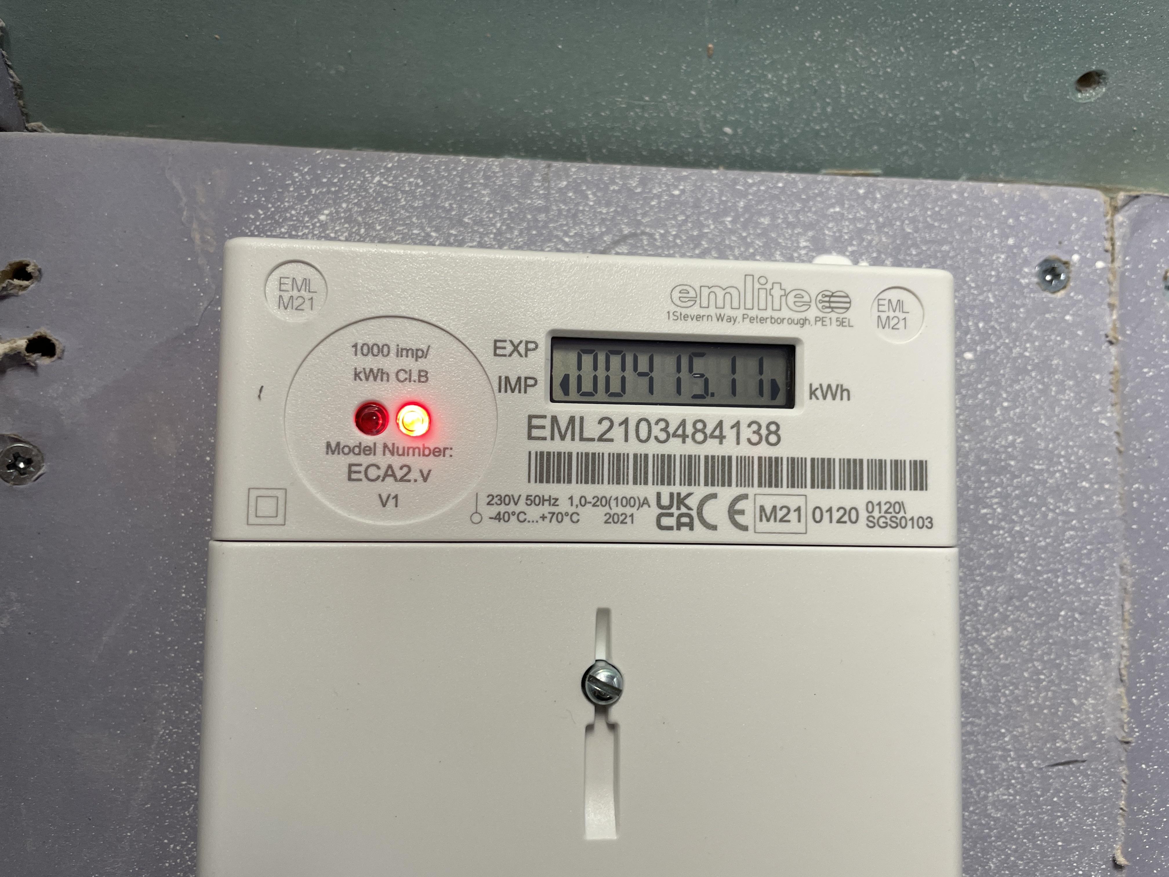

Ok I’ve checked our electric meter readings in exactly the same duration (5months pretty much exactly since heat pump went in) we have used 1102kwh in electric. This figure is after I have deducted 417kwh for ASHP & immersion. So I don’t think the electric usage figure sounds too weird maybe a little high but possibly explained by the multiple dishwashers microwaves & ovens, bathroom electric underfloor & that we both worked from home entirely over this period & have a toddler!? The heat pump has used 1kwh this evening since I messaged at 3.5C outside. Inside around 19.5C. So maybe the wall and roof insulation has been the big thing as we have no floor insulation & 50sqm of double glazing almost certainly not helping heat loss & about 20 other cold bridges I can think of, and as I mentioned our new radiator pipe system is totally old school. So yes I am rather pro heat pumps now!

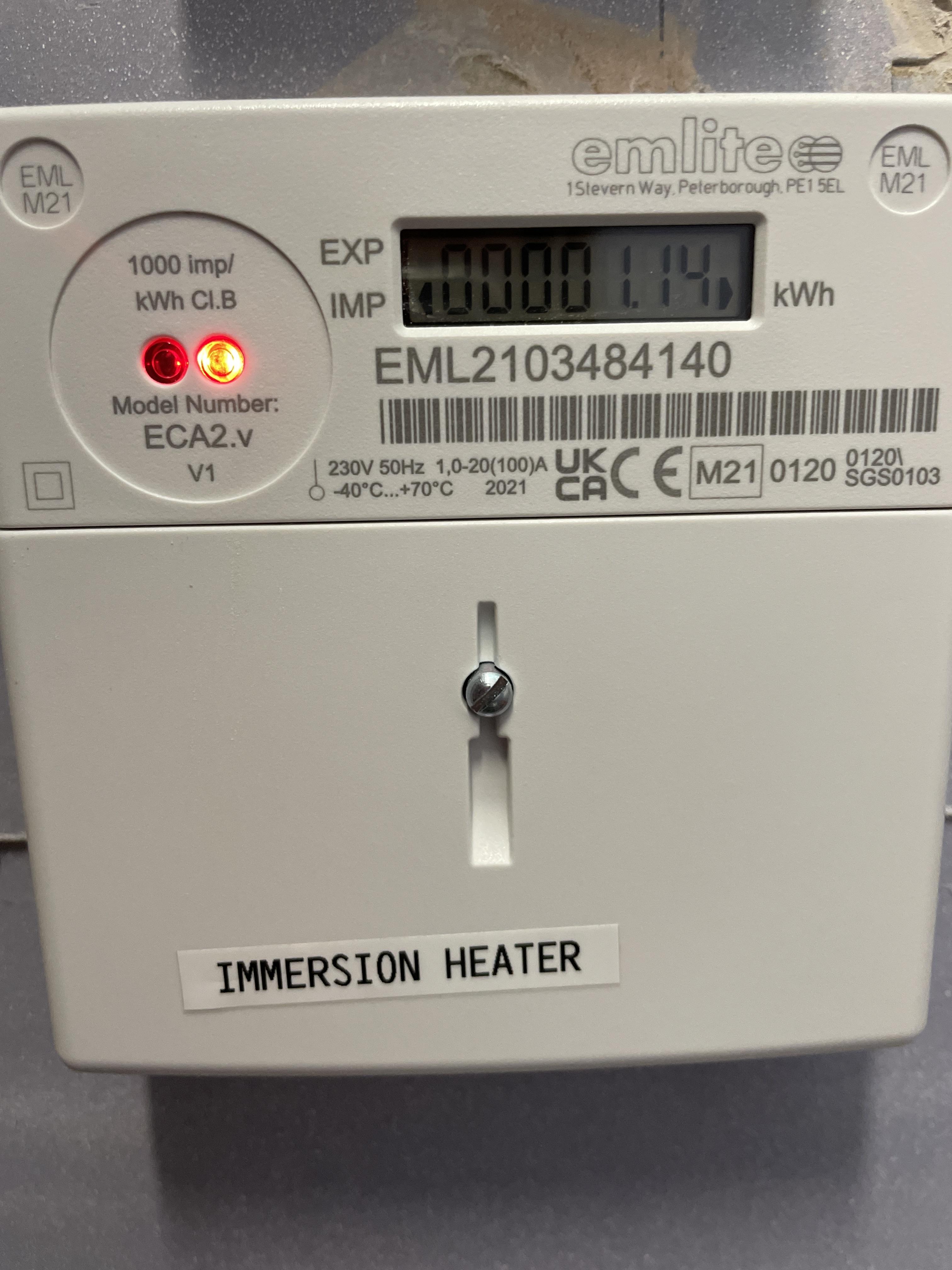

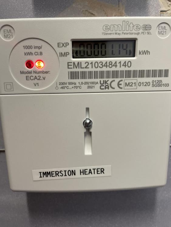

So what about the weird immersion reading. This is also since may obviously only comes on once a week or so I was told.

We only have radiators on a crappy big loop spanning a 16m wide house & no manifolds so I really don’t think this is the epitome of good efficient design either! But in all honesty I would really appreciate whether these meters can actually be wrong because I don’t think we have a magical house. It’s refurbished by a bog standard builder after all and there’s a lot of details I knew where bad haha.
It’s a heat pump yes no gas in the village! Now I’m freaking out about whether these meters are busted!
Hmm no, though you are doubting me because also we have this weird thing on the immersion heater which states we’ve only use 1.14 kwh since may. @Mr Punter would love to know whether I just don’t know how to read a meter or it’s broke!
We are in the same boat, no idea what even is efficient? How much kWh should you expect to use in a day, we thought our system wasn’t too bad but it’s cold today & now it’s drinking the electric ?. 15kwh today so far it’s heated the water once for 1.5hrs & been on for 4hrs so far set to 19.5C. It’s a 220sqm refurbished place. Since install at end of may we’ve used 415kwh.

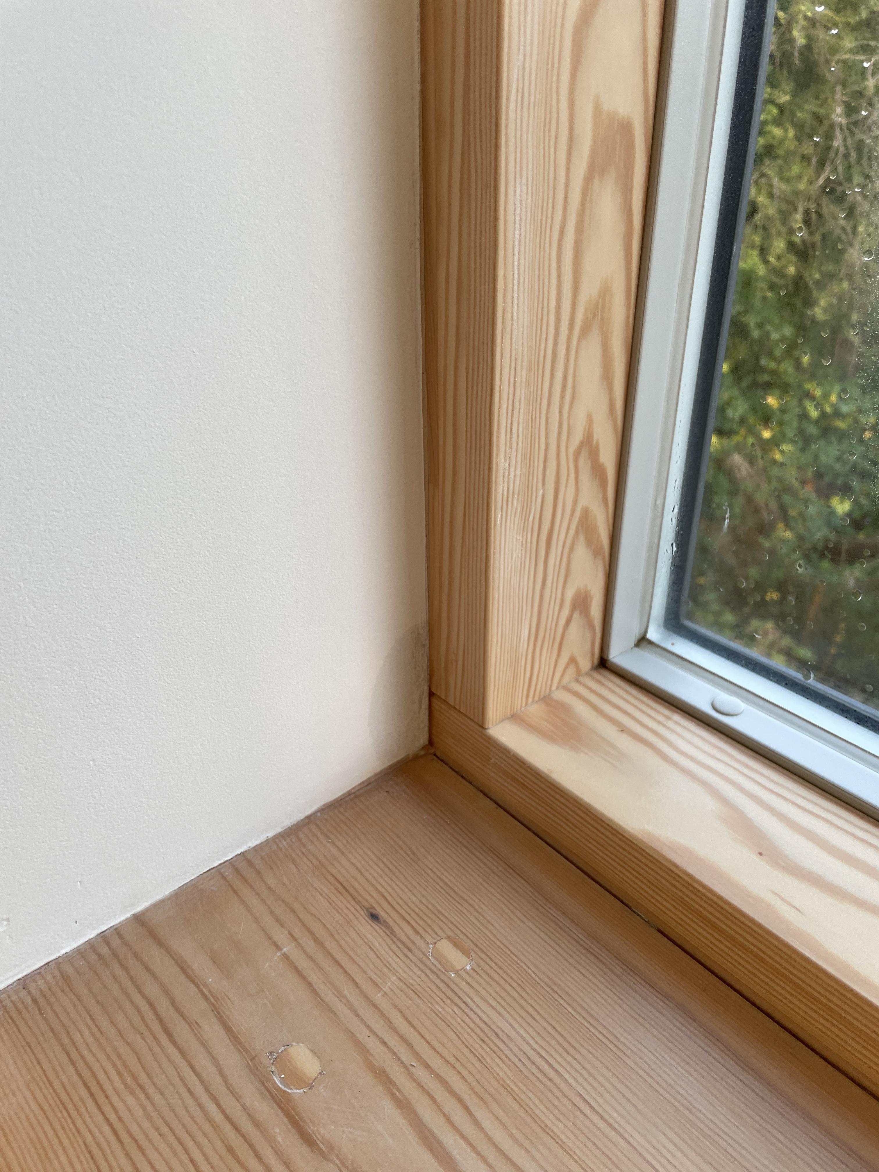

So we do have a slight condensation issue on all the windows, probably skimped on ventilation with basic extractors in bathrooms & trickle vents everywhere else which we sometimes open.. as the whole house was refurbed & wrapped in EWI plus additional rafter & internal stud wall insulation that we spent weeks taping it’s probably making condensation more likely when it drops near freezing … however this is the only one that goes beyond the window pane in terms of a sign of damp but it’s never obviously run from the glass onto the wood frame before so I think it’s more than just window condensation. We have some weird vertical cedral click concrete cladding that made this detailing worse! I will get a ladder up there to see whether it’s obvious but I remember the builders generally being very bemused by such strange interfaces (installing onto a completely prepared reveal). And I do have some vague recollection of discussions around the lintel drip detail on this particular window (it didn’t come up on any of the others), can’t really remember what was said so I hope it’s just the mastic or compriband!!
Extension is 6 months old. Just noticed this on one of the window reveals, it is the only window not under the eaves we had these annoying velfac windows that have some pretty atrocious interface detailing so I’m guessing it’s got something to do with the reveal, how bad does this look and any ideas? Extension is timber framed.
