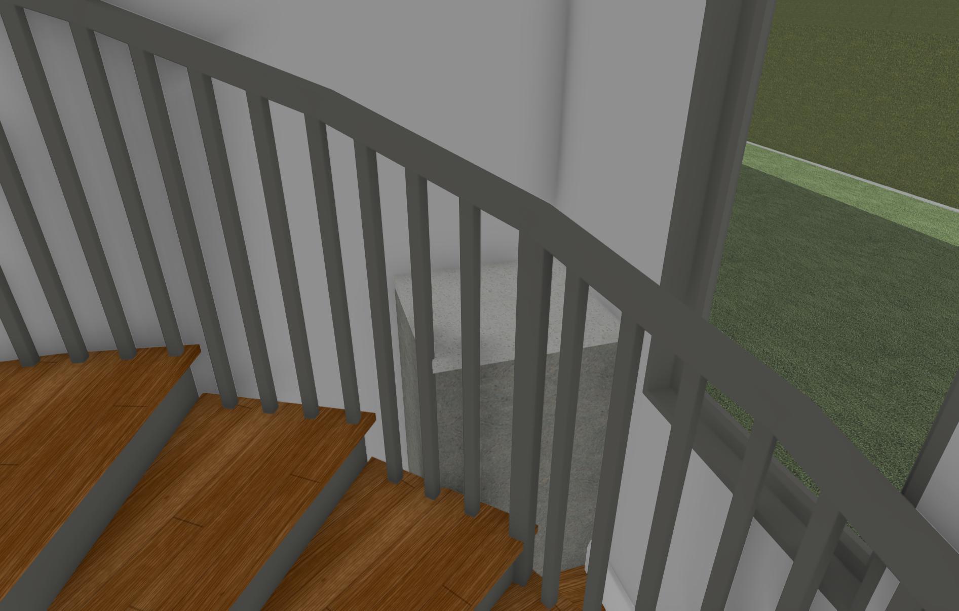

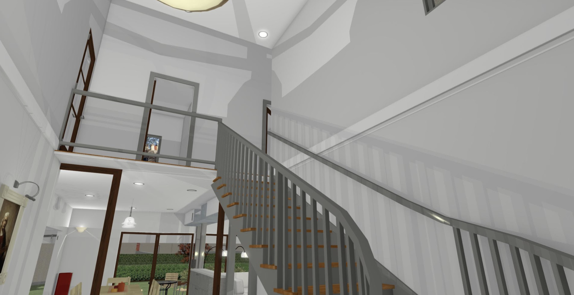

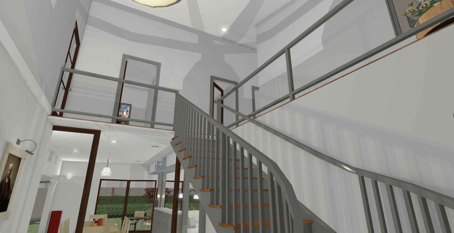

  1. Thanks @NSS, to be honest that's exactly the type of feedback I am looking for, pieces of design that do not make sense. As an example, the 'coffee machine area' to the left of the big hallway door is really an artifact of me trying to both make the garage fit an actual car, as well as trying to have a pocket door.. problem: bifolding door between kitchen and dining could block it. Not completely sure what you mean though, are you saying if they step inside their foot might 'snag' onto the staircase and trip? To be clear, the design as attached is mine, where we like a lot of the principles, but we have asked our Architect to convert it into something 'professionally done' and fixing any mistakes. Your comment is def. something the Arch should hopefully fix, but good for me to be aware of it already..

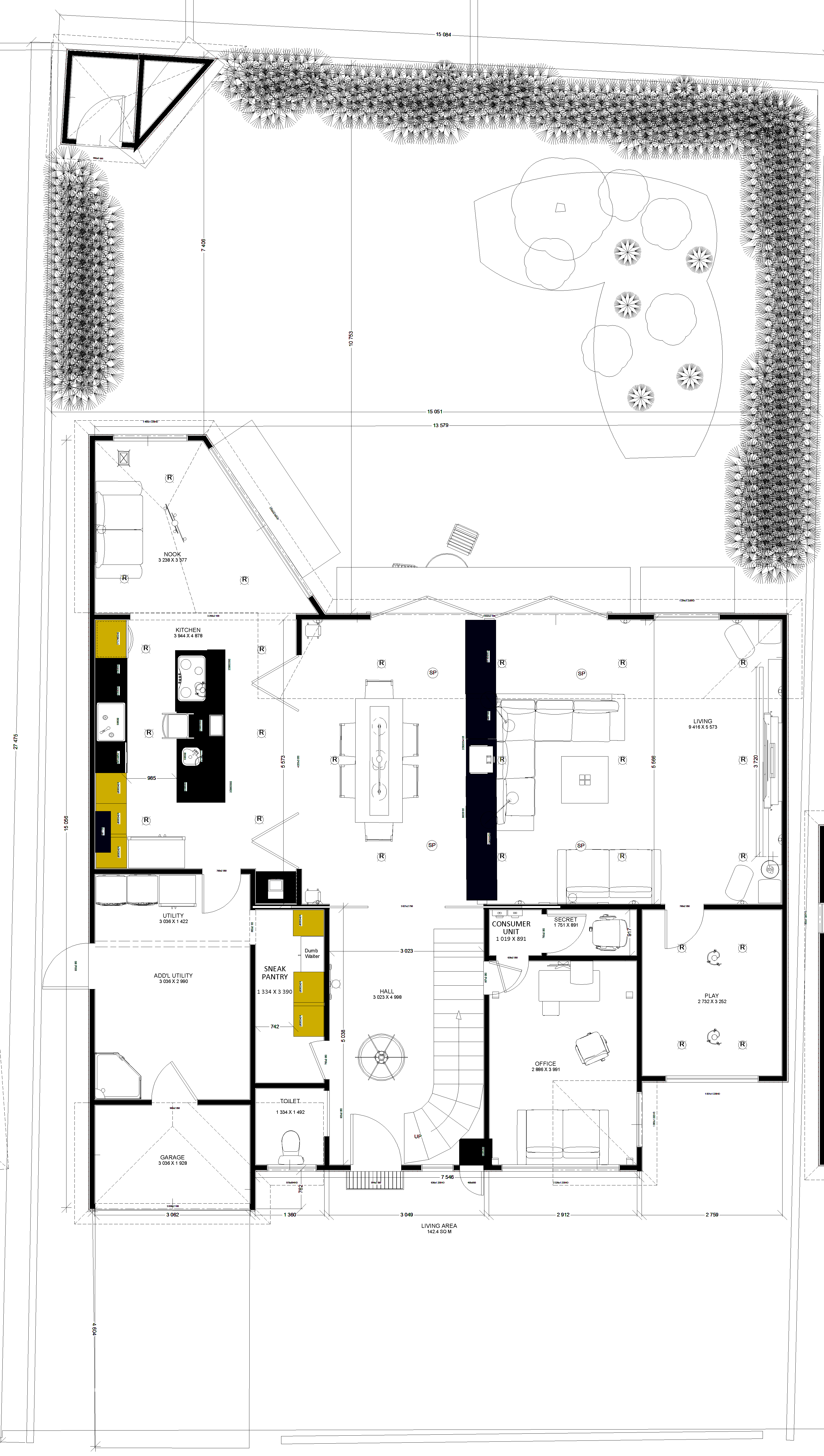

  3. Anyone? Anyone? @Sensus, @Carrerahill, @Bueller? Is the link problematic or not working? Ground: - Note that the uplighters are just scattered evenly, no deep thought went into them - The first part of garage likely to be a carport 1st (but a lot less developed..) note that the walkway above the office gives a surprising amount of spacious feel to it. Is there some science to when a hallway feels 'grand'? My hunch is that the amount of distance between most high walls is the key thing. if we remove the dead end walkway because it's "useless" it feels much less nice..

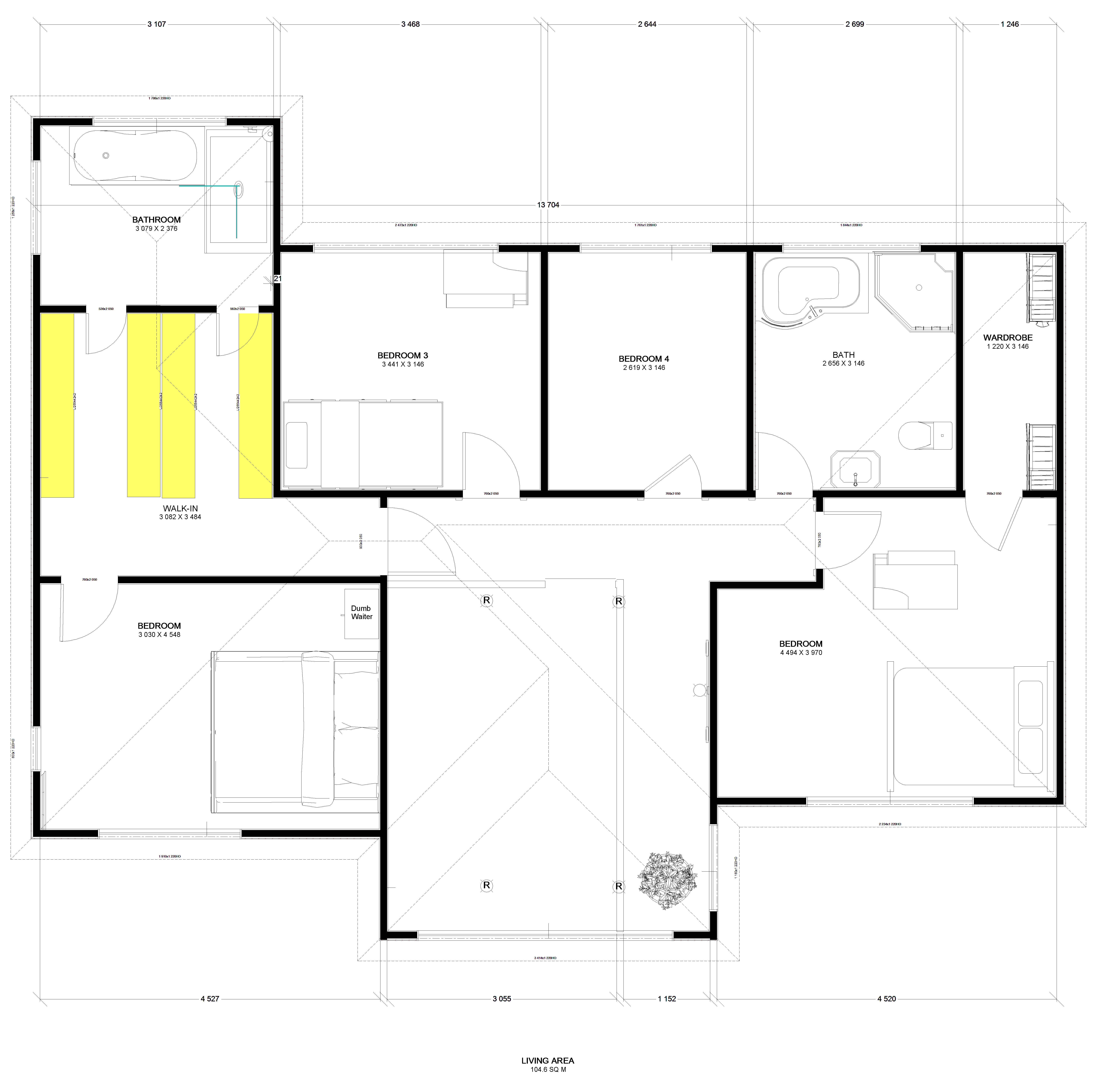

  10. Hey all, As you might remember - Critique my Brief was received with some mixed thoughts, although our Architect was really enthusiastic about what we provided to her. (or at least she pretended to be ) We have received her initial designs, and based on this, we have extended our own design and put a lot of extra detail in there. Please note that I've spent next to 0 effort on picking 'the right' objects, e.g. lamp shades, hobs, paintings, materials for walls etc. Core thing to focus on is the shape and location of things. Would love to hear opinions. What do you think, in particular which things will never work, and which things should be really good? I've used a pretty cool presentation system for this - Focusky is free (up to a point, but I've only used the free version so far). It allows me to talk over stuff, give some commentary, then upload to the cloud for free.. and people can zoom around themselves too! It's pretty nifty. http://focusky.com/zcxt/kgig/?html5. (click away the right side-bar!) Final tip, the final slide (click bottom right) contains a ton of extra stuff, incl some renders, and the written summary for the various spots. [UPDATE]: reconciled many of the points & thoughts in a followup message
  11. Take my comment with large amounts of salt, not an architect, but "clearly" it would be better if your fam/din/kit area was wider, but I guess it depends on which rooms you expect to be in, most of the time. My family primarily uses the family area and a lounge would be very occasional. If you're like me, then indeed emphasize living area. And, to me it seems you can: 1/ make straight stairs, running roughly from dining entrance to front door. 2/ Cloak/toilet under the stairs. 3/ Lounge takes a hit of say 1m - 3x4 isn't bad. Can even move the side wall a bit more to the right (with my suggested stair design) 4/ Utility will probably be compromised. I don't have a great answer there, but perhaps worth considering putting it behind the kitchen
