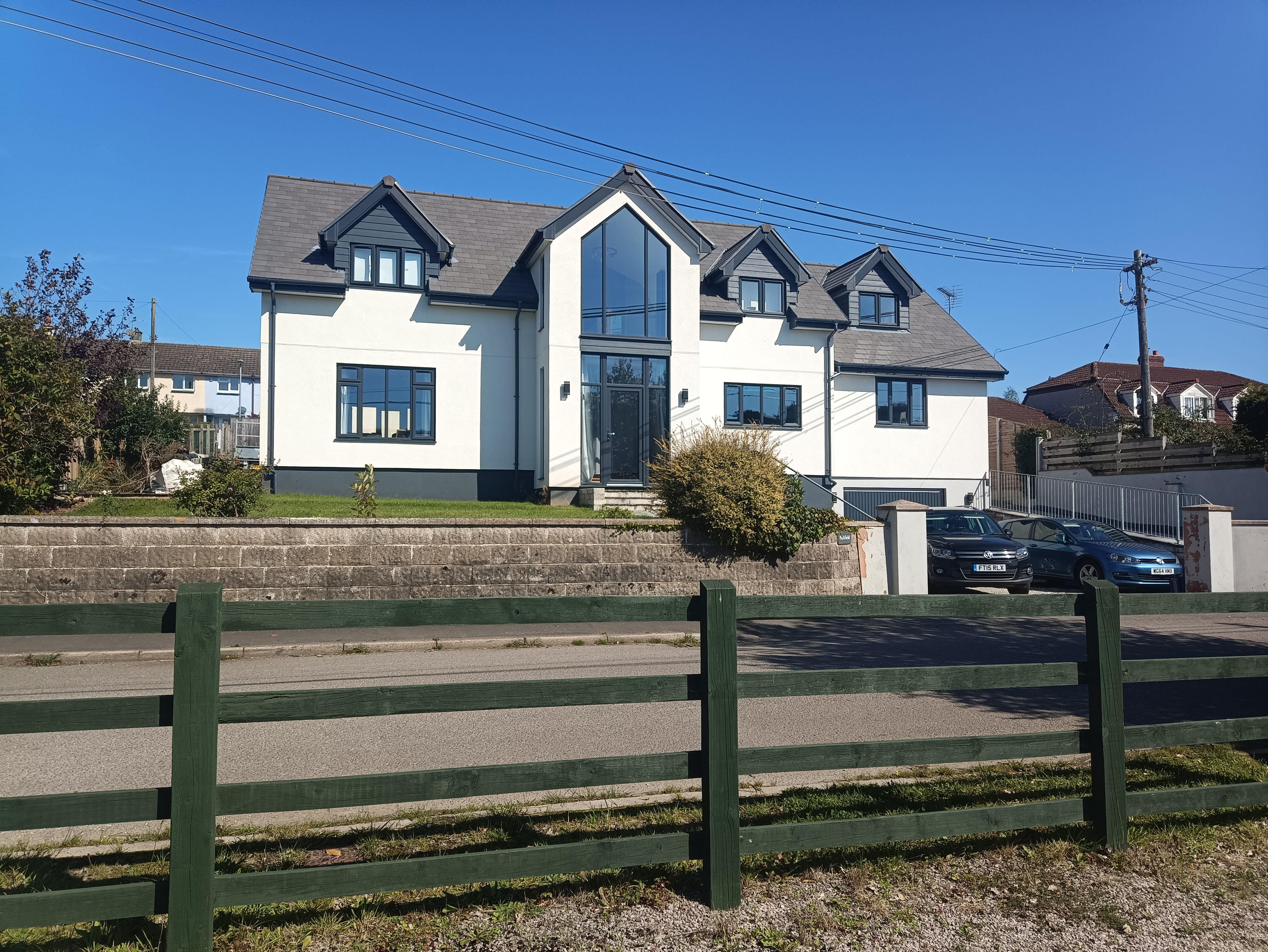

Hi @Conor I just filled in the move in date of 26th June 2021 and hoped for the best. We did not get the valuation letter until November 2021 so that was to late anyway, Fortunately they paid it all out. Also a picture of our house, it's still not finished. But getting there. -
