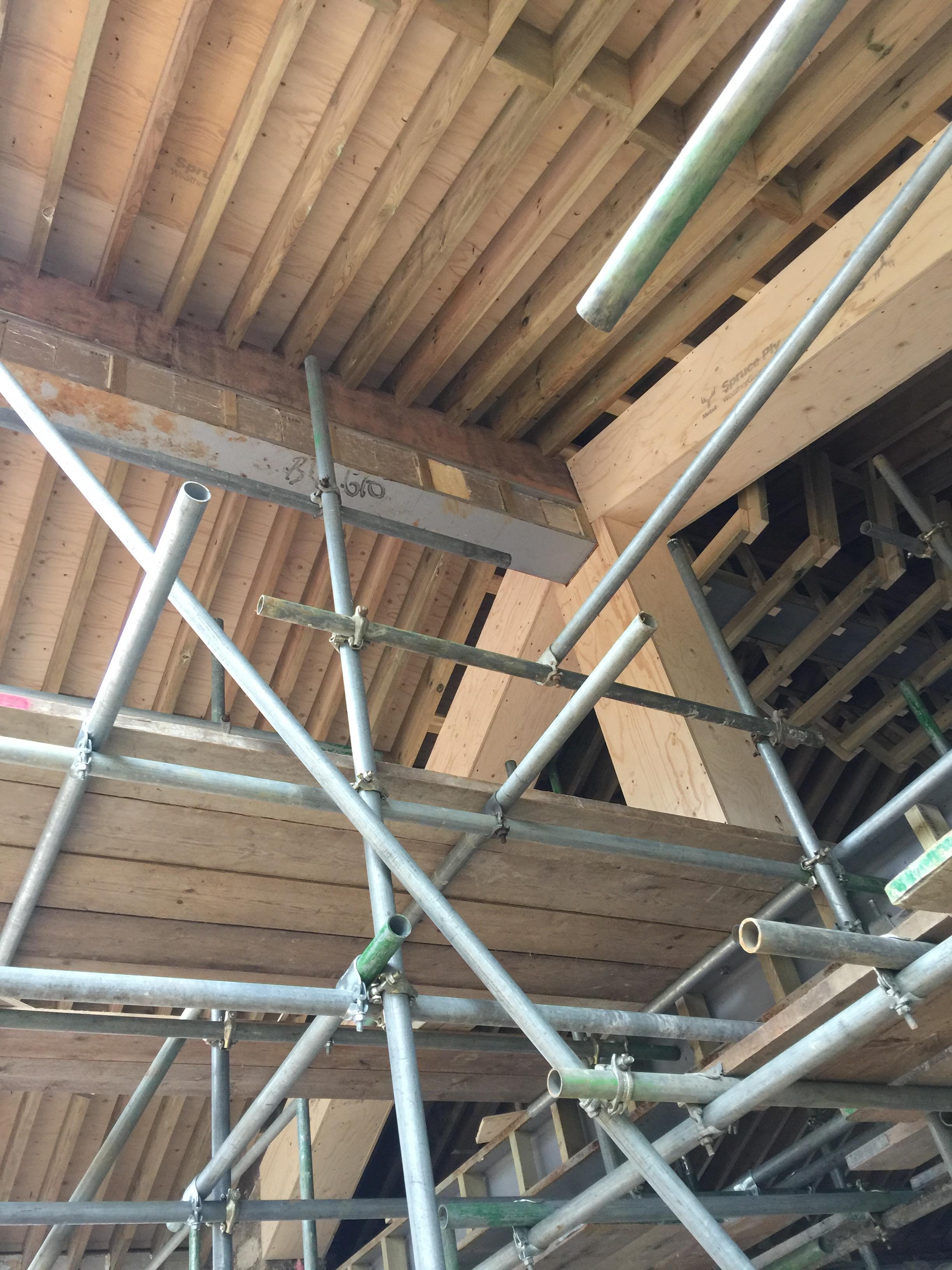

Up to roof level and about to install the timbers. We are having hand made clays and I want as much insulation as possible as we have used Durisol blocks as main construction due to their U value. Husband is being told to use multi layer insulation and I want as deep as possible warm roof. We have put this material under our barn roof and it does make a difference, but I don't live in it! Has anyone else used a thick warmroof under tiles, is this possible at all due to possible fixing problems? Any info at all would be helpful please.

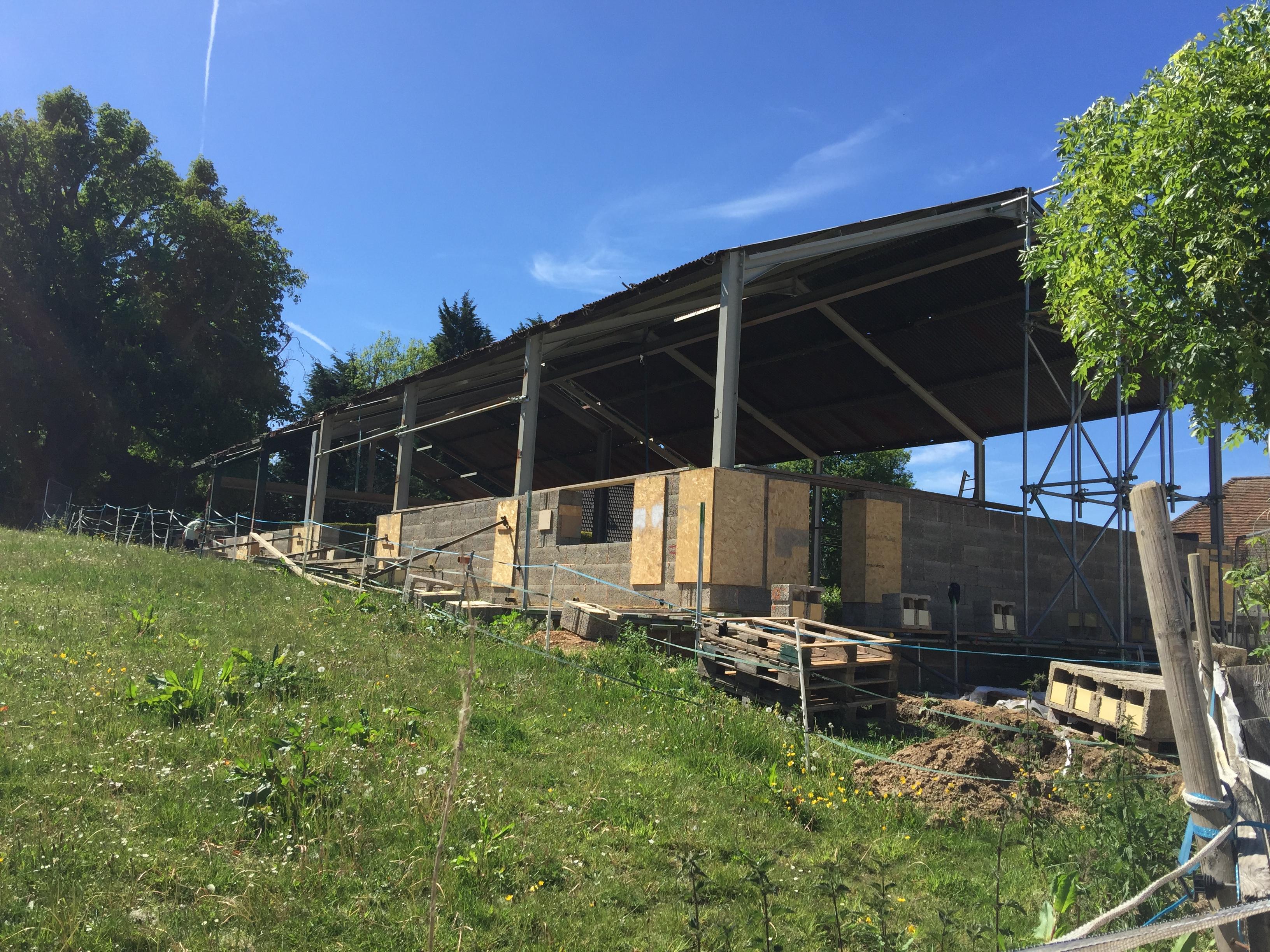

We are converting a derelict cow shed and are up to the roof. We also have a steel portal system, our Durisol blocks have been cut around the steels for cold bridging, super quilt clad and foamed. Closed cell foamed between roof junction and steel where the 8 m sliding window will be. Photo shows insulation blocks in the beam, these will then be covered in superquilt and then ply. We also converted 3 metal silos into a house (you tube) if you want to have a look, these being metal were also sprayed with closed cell foam, there was no other way to deal with the metal and condensation forming. The silo's are a year old now, they are wonderfully warm and no problems that we can see as yet. Hope this helps.

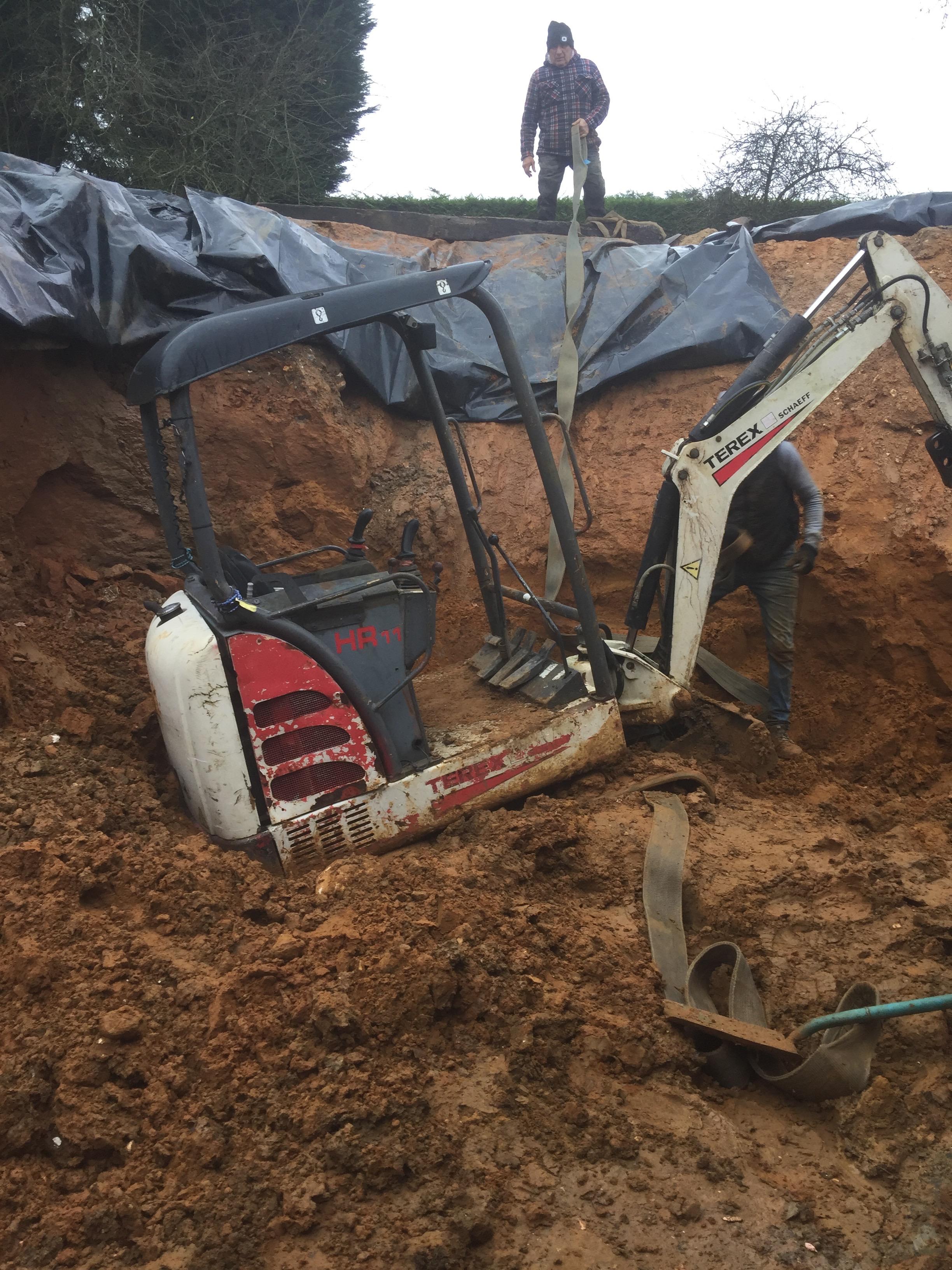

We're up to ground level on the Durisol build and nothing went wrong with the pour due to belt and braces by the other half. The rain has been never ending and the small digger ended up stuck in the mud. We have very sandy ground and it just sucks you in, managed to Lift it out from above with the digger. We are now putting in the step foundations as we are on a hill, the previous house had massive great lumps of concrete installed, obviously to stop the house slipping down the incline! Because of the awkwardness of these and the ground being in such a state, he's filling up jumbo bags with concrete mix and dropping it down into the deep foundations. Yes we could have pumped it in but there's no hurry and it's kept him busy whilst we are in the dreadful lockdown. My daughters main builder got ill and then the daughter and her husband got it, on the mend now but both my husband and l have no idea why we didn't get it to! Hubby is in the process of making a wooden template for the half round bay which he thinks will help with the foundations and the laying of the durisol blocks to get the shape correct, it's 4.6 across and looks very large but rather good. HVMR has enormous pipes...so glad we have a basement as all the equipement for the ground source and ventilation will be in here, I didn't realise how much pipework is needed. The daughter has had to use large pipes almost everywhere as the structural engineer wasn't happy with 28 pipes being put through a structural wall! Her standing seam roof is going on and it's about 1/4 done, it will take 6 weeks to install, a lot of work. Part of it will be gold, can't wait to see this bit, sounds awful but knowing her it won't be. New year will see her roof window installed, this also comes down the side of the building as well, it's been a nightmare finding a company to supply this, fingers crossed it goes well. Happy New year to everyone, if your just about to start your build then best wishes for an uneventful outcome, but expect your pocket to be quite empty by the time your finished!

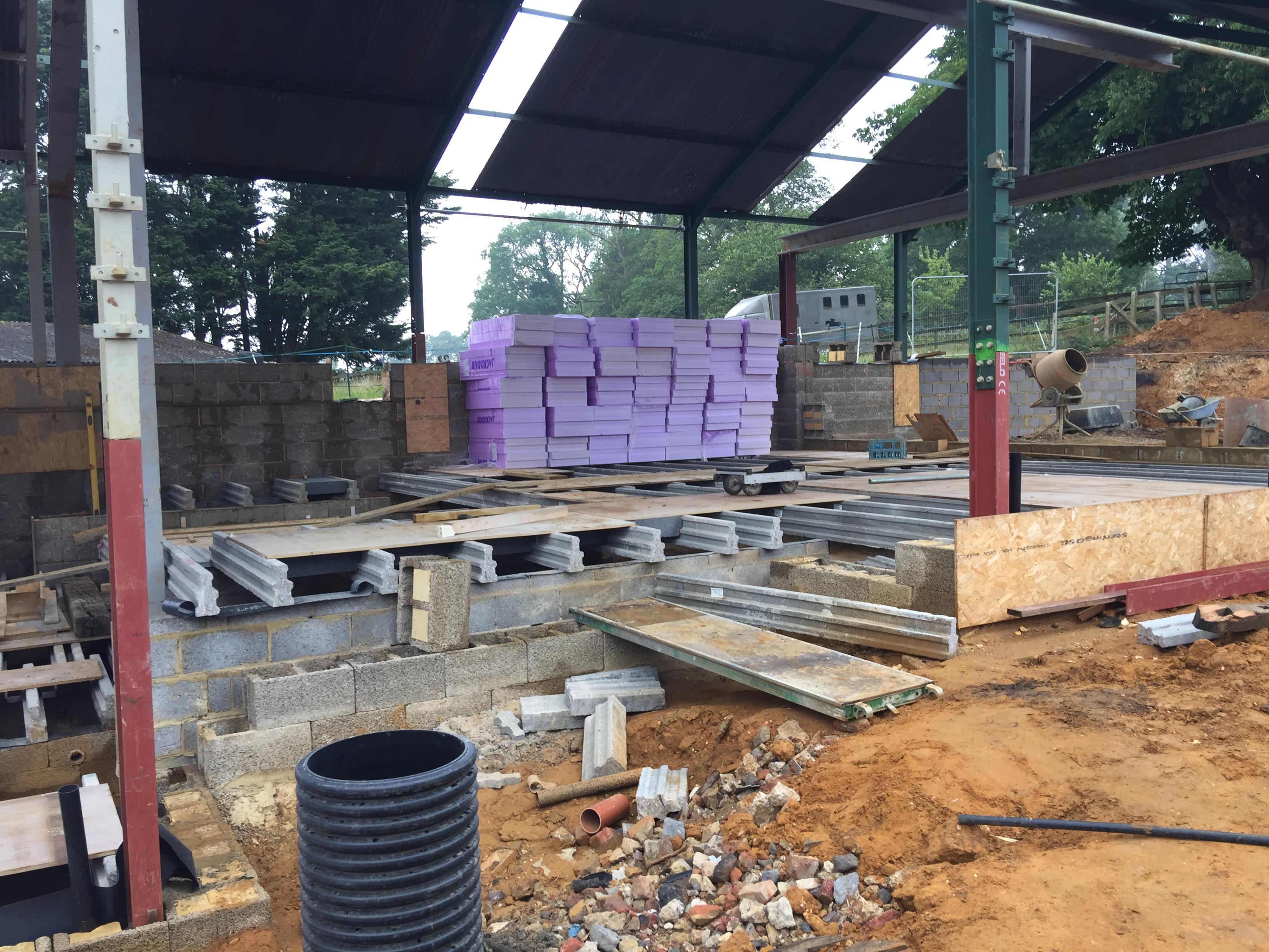

Can anyone advise on the best way to have an insulated floor above our new basement? Part of the house will be on ground level and the other with a basement beneath, I'm wondering how I can merge the two floors and make it as insulated as possible? The original design didn't have a basement, this was an afterthought. Durisol blocks used throughout. Daughter has used warm floor beams, but she's only got a void underneath, not a basement.

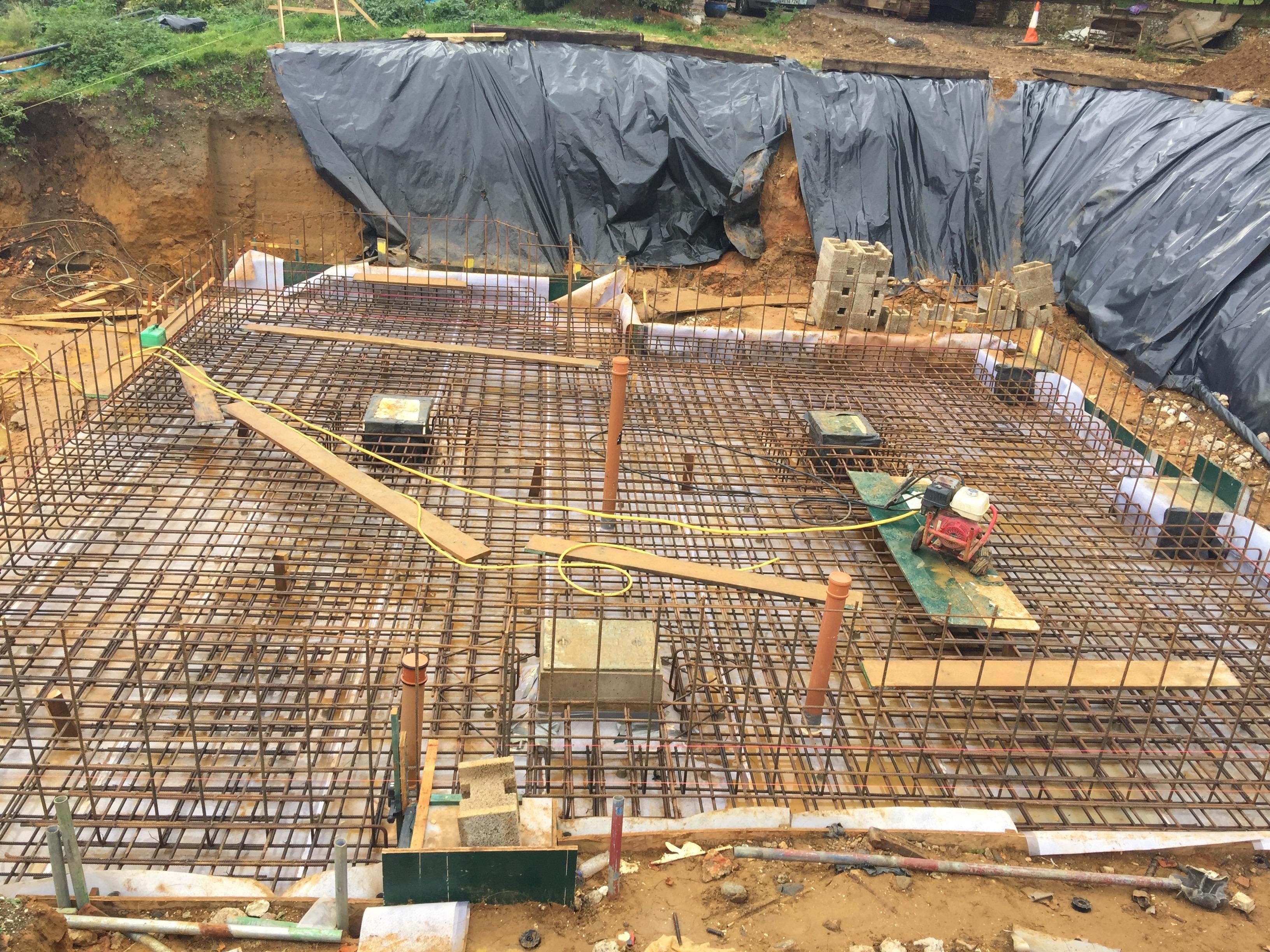

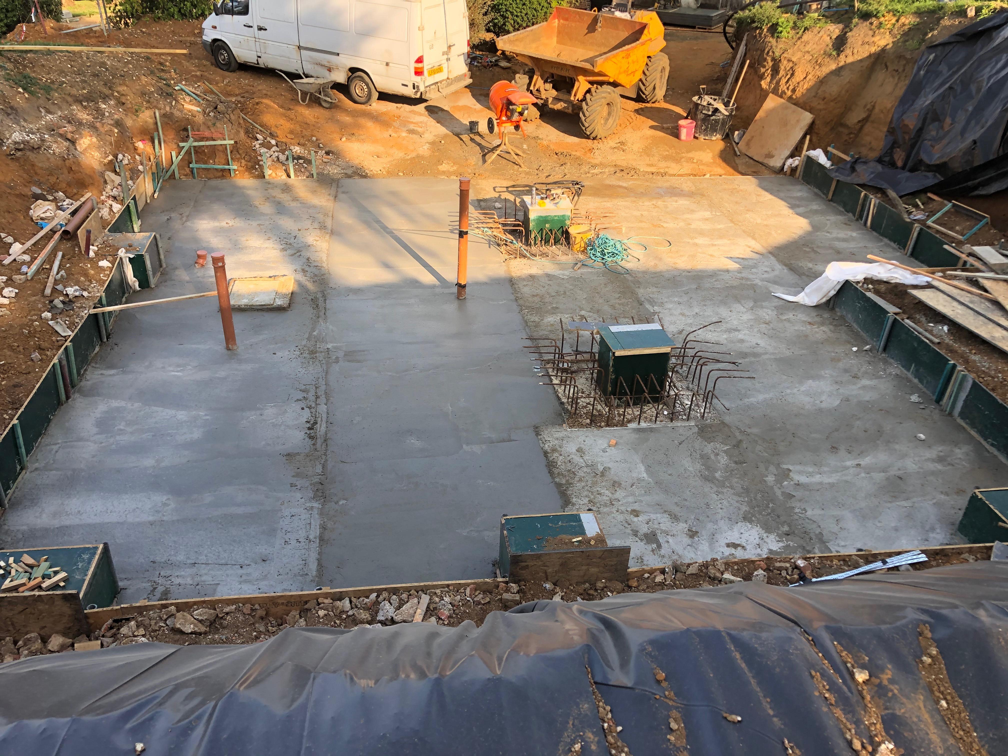

Morning, the slab concrete has been laid over the rebar and we took 5 samples of the concrete as it was delivered. Do I really need to send these off for testing? Cheers Everyone.

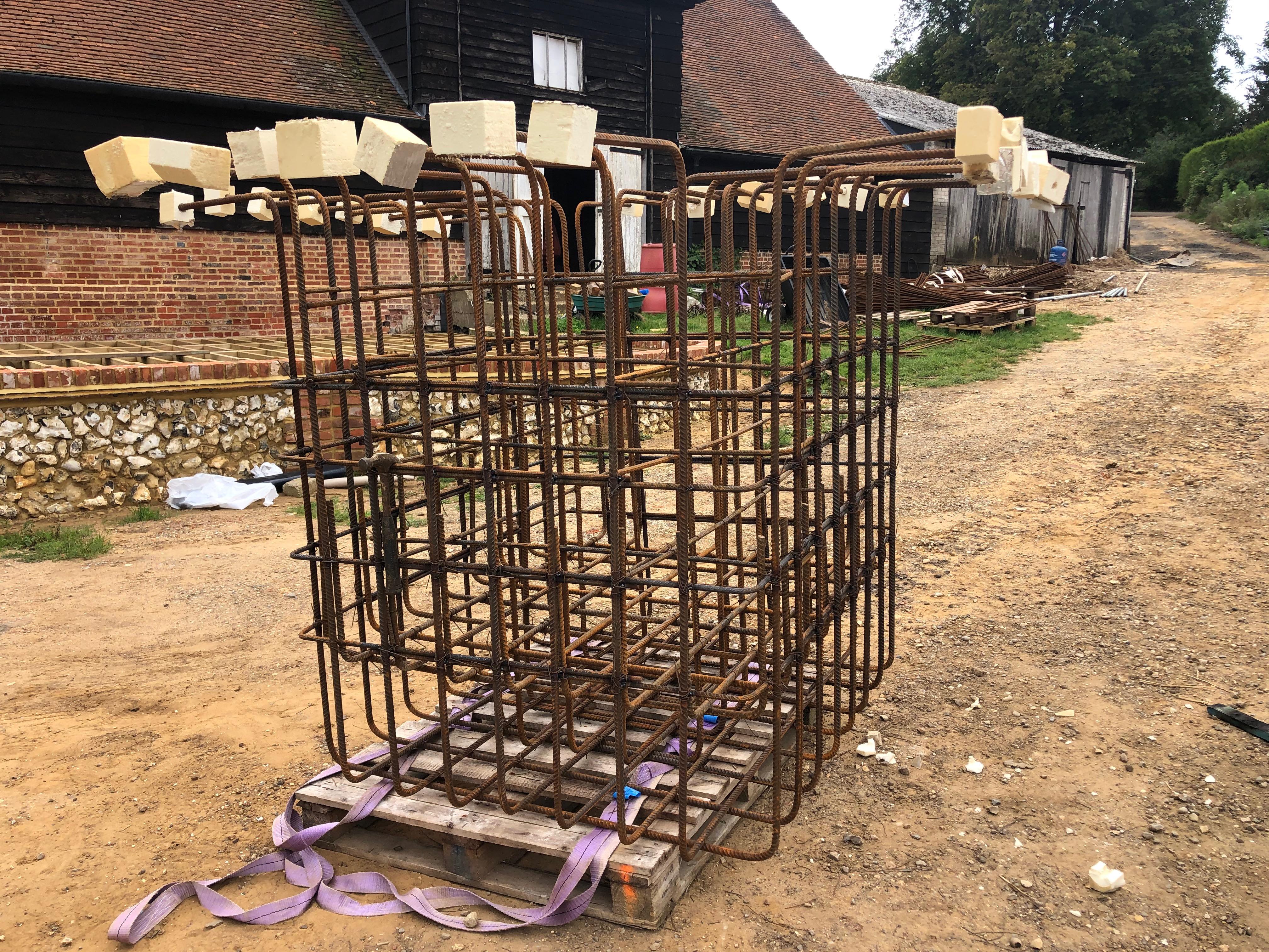

Many thanks, he's a lot happier now knowing this. Still putting together miles and miles of re bar...ordered a machine to do the job!
Hi Conor, it's a basement...so l suppose 28 days then.....he's going to be spitting feathers!!! Thanks for the reply.

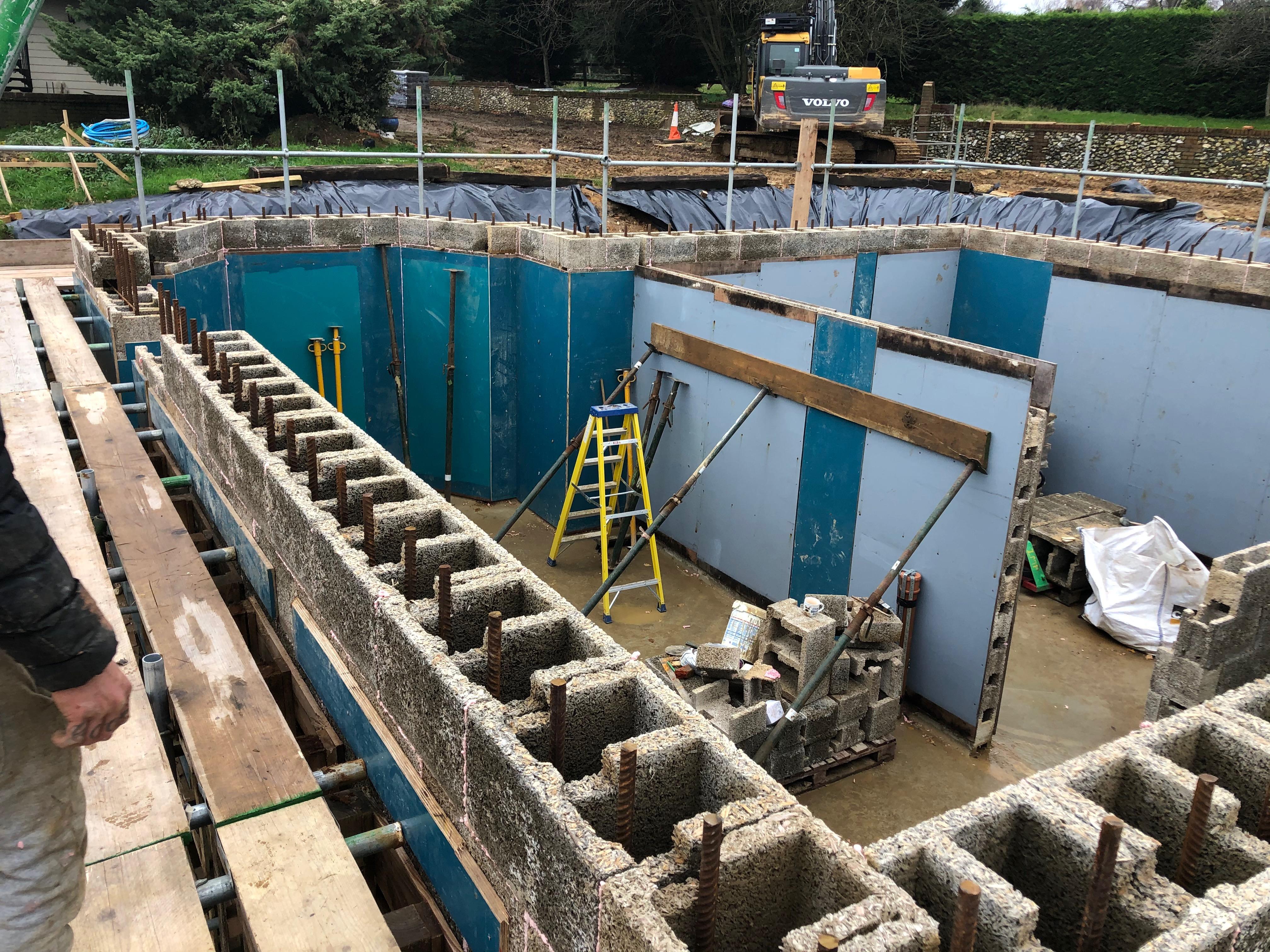

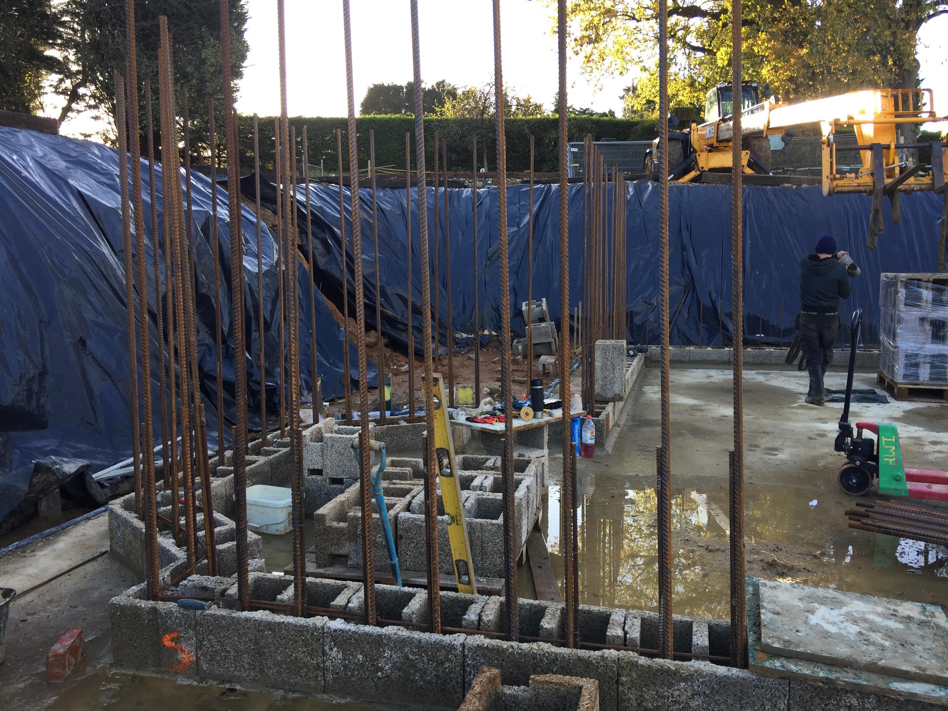

Hi everyone, Do we have to wait for 28 days before we can start placing out our Durisol blocks, hubby is chomping at the bit, anyone advise anthing else?

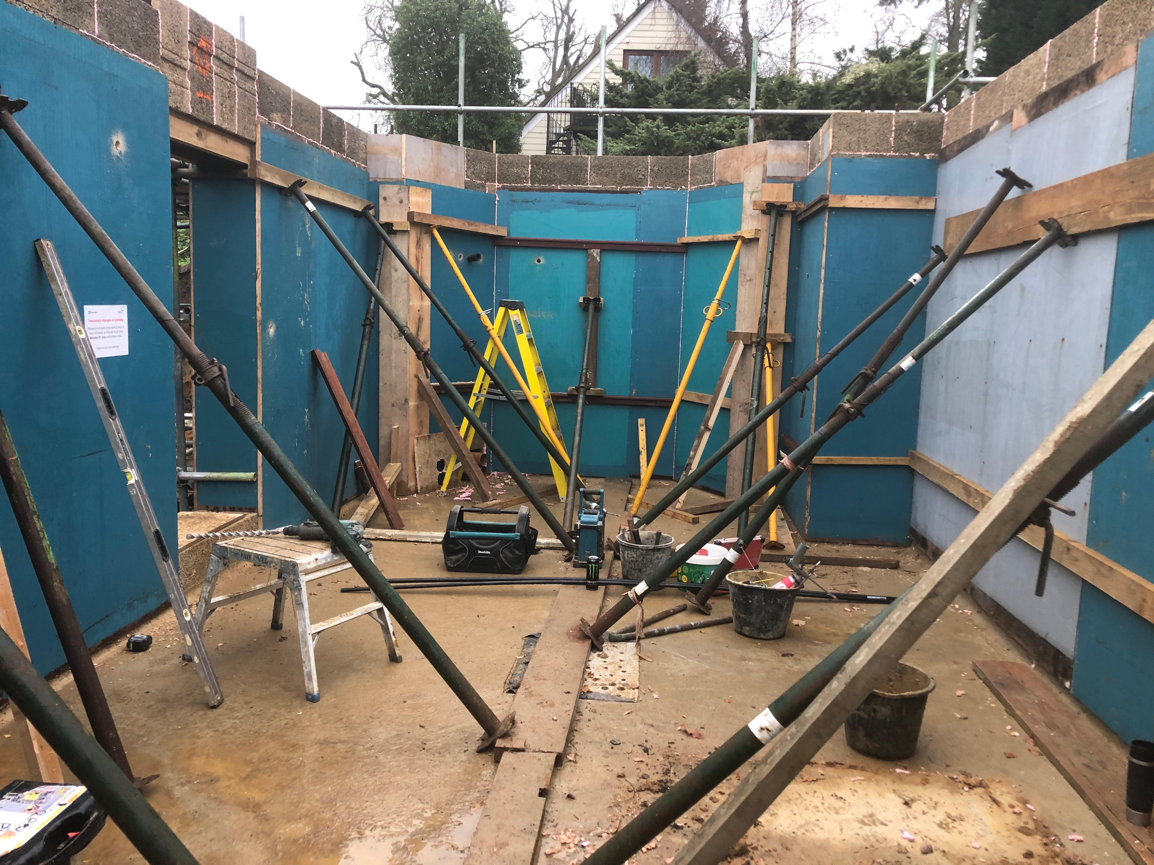

Using Durisol blocks on 2 builds here, the sumps for the basement are shown here. Our SE was not aware of this type of build but she has certainly risen to the challenge. Crystal Engineering, Kirsty Hudson. Lots of rebar for the basement as we are set in a hill, sumps took some head getting around but no 2 went far quicker than no 1.

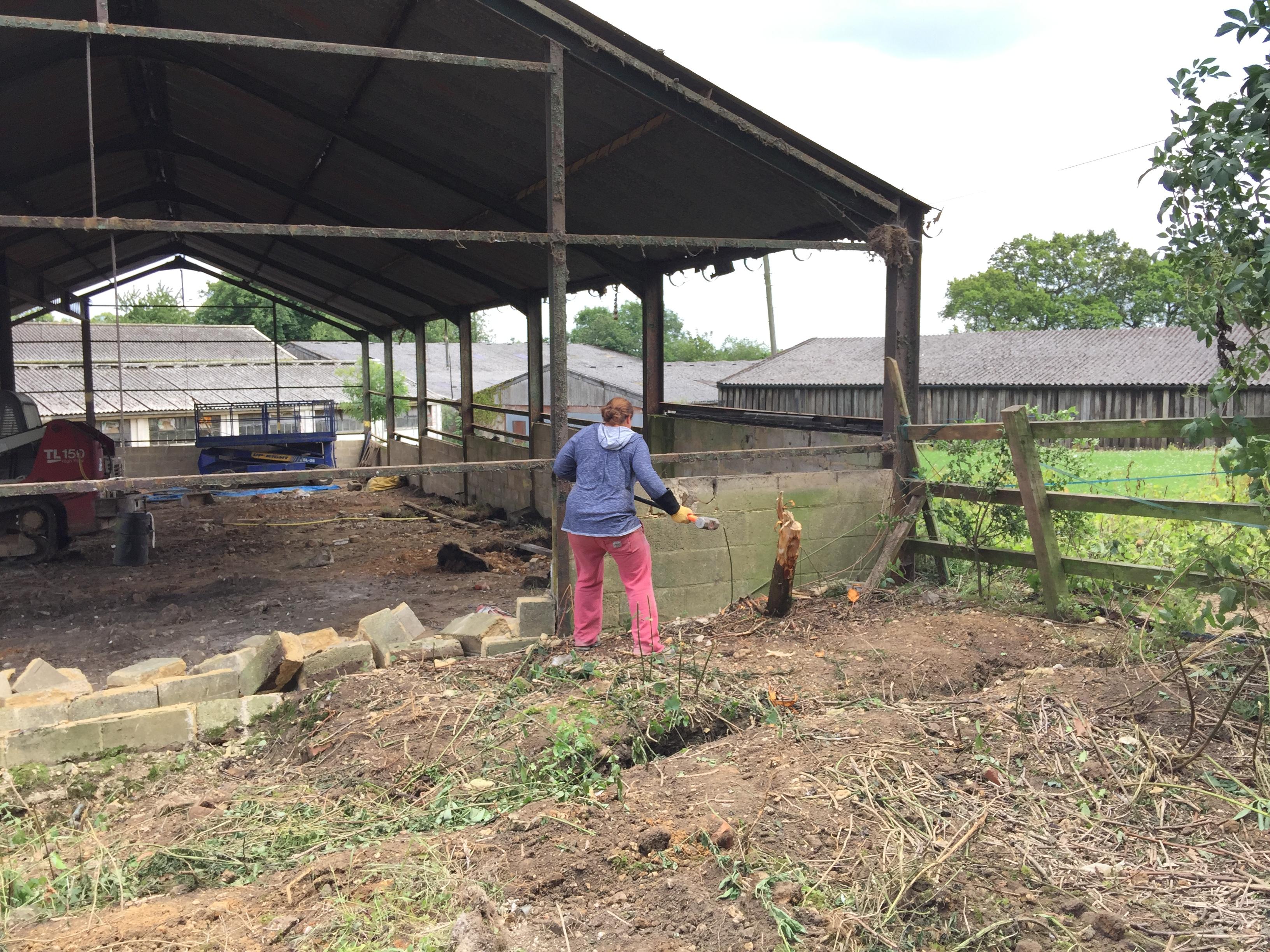

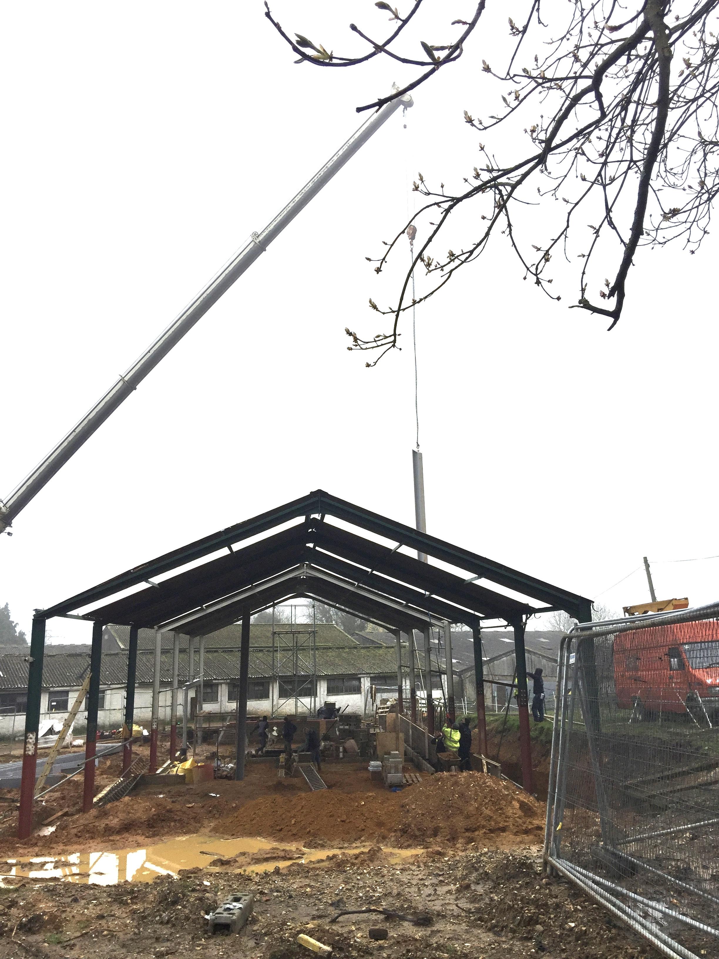

Well.....we have continued to carry on with the conversion of my daughters Cow Shed using Durisol blocks and fortunatetly we have a really good builder who is also a friend which helps. He has been amazing. We all went on the day course and he also studied many hours of internet content before starting so that he was totally familiar with the product. Converting around stancions wasn't easy, if we could have taken it down and just built with the blocks it would have been far easier. Cutting them and keeping the insulation around the steels was difficult but he managed it. Not realising that the ground level at the rear was as high as it was meant re-jiggling the design somewhat with lounge window being shoulder height, not being terribly amused with the architect and his idea of how the rear should have looked! He got sacked a long time previously, daughter and l got to grips with Auto cad and did the alterations to the drawings for both projects ourselves, not easy. Due to the ground height meant more foundations once the engineer saw what was necessary, she also has been a marvel having not come across Durisol blocks before. After applying copious amounts of water based bitumen type product (we bought the wrong stuff previously, it would have eaten into the insulation) lots of this, sheets of that etc.... the ground has gone back against the newly built wall. O'h and we had to get new steel beams inside to hold the roof up as the structure only holds a tin roof at the moment. This has been very handy keeping off most of the rain (we did have swimming pools earlier on this year and spent hours pumping it out or using buckets....AND it kept the sun off this week, especially yesterday! We are now ensconced in "The Silo's" you tube video's (if your bored with the telly) "How to turn 3 metal silo's into a house". Aplogies for the music on one...my own composition...more like an Indian restuarant theme! Pic 1. Natalie starts demolition July 19.Pic 2.The rear elevation.Pic 3 block and beam insulated floor, front door and kitchen /dining room elevation.. Pic 4 Steels being craned in. This end will be all glass. We have had 2 pumped pours but some of it has been filled by hand because (a) the crane wouldn't be able to get to the inside walls easily and Terry the builder was concerned about filling 170 blocks and having them move with the weight of the concrete going in. If your going to use Durisol blocks and have any queries, please ask, between Terry (builder) Natalie (site manager and order person daughter) or me....(Resin top installer and composer of awful music) please ask away, we will try and head you in the right direction (brick or poured concrete...hahahaha).
