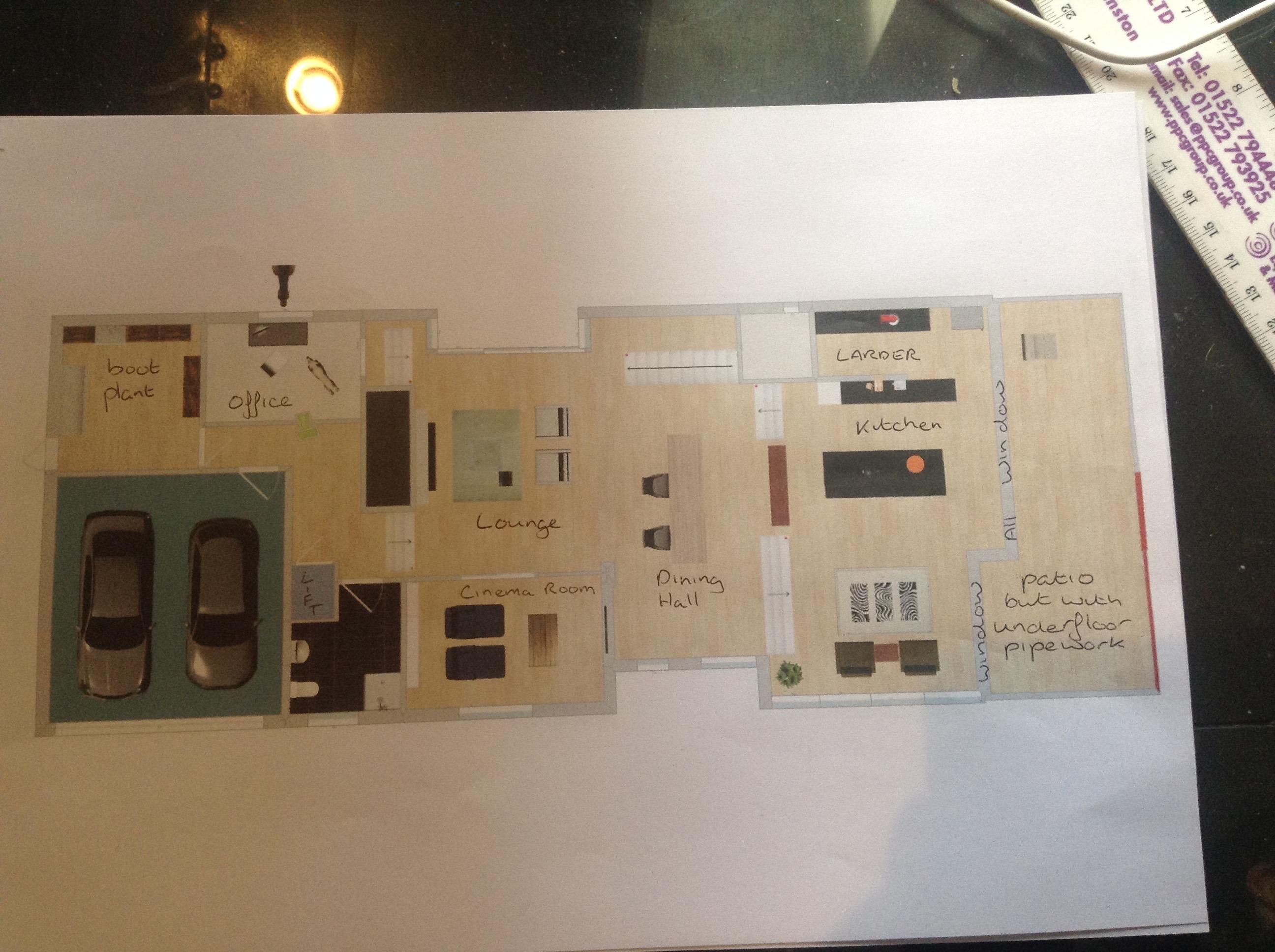

Hi Big Neil, yes it was done in Sketch up, I use it quite often, you can copy and paste the drawing, I'm no expert, but what my daughter has just shown me......OOOOOO!!! Command A, Command C, Command V, that will select all, copy all, paste all. That's the shortcuts on my mac, your may be different. If you only need part of the drawing then the arrow at the top left of the tool bar will highlight what you want to copy. Hope this helps. I also use homebyme which shows you in 3D it can also draw a whole house plan, from basement to 1st/2nd floor and place items of furniture etc to scale so you know if things are going to fit in...it's been invaluable. I drew up my new house plans and then sent these to a CAD operator who then drew them up technically. The photo shows my daughters cow shed ground floor plan to give you an idea on what it looks like, you can even walk around the space. -

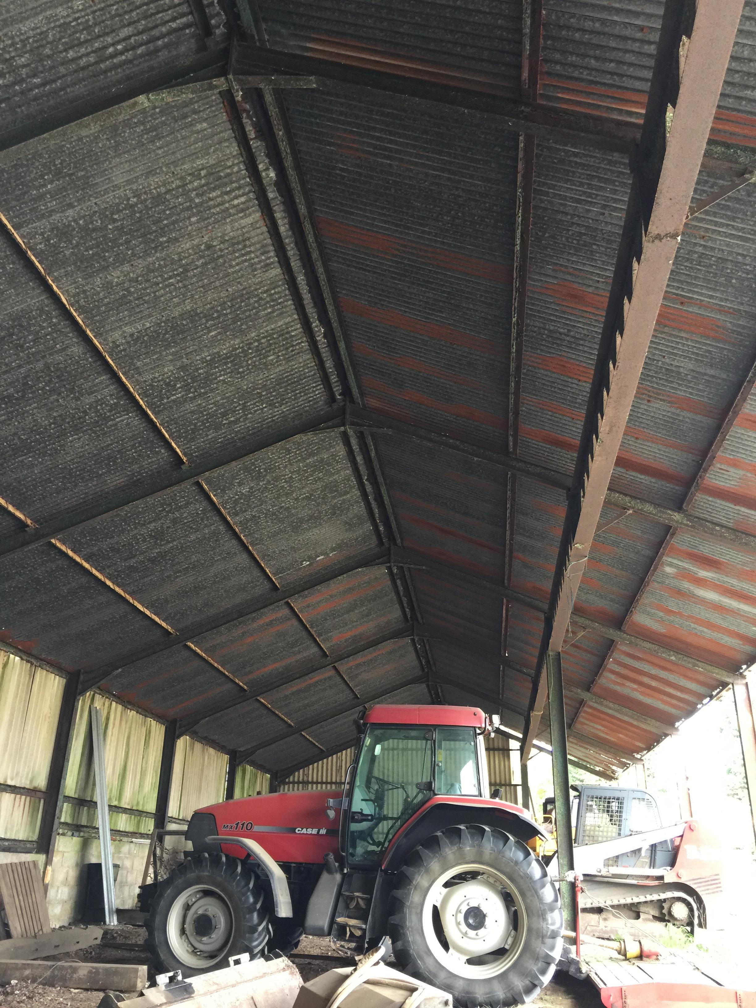

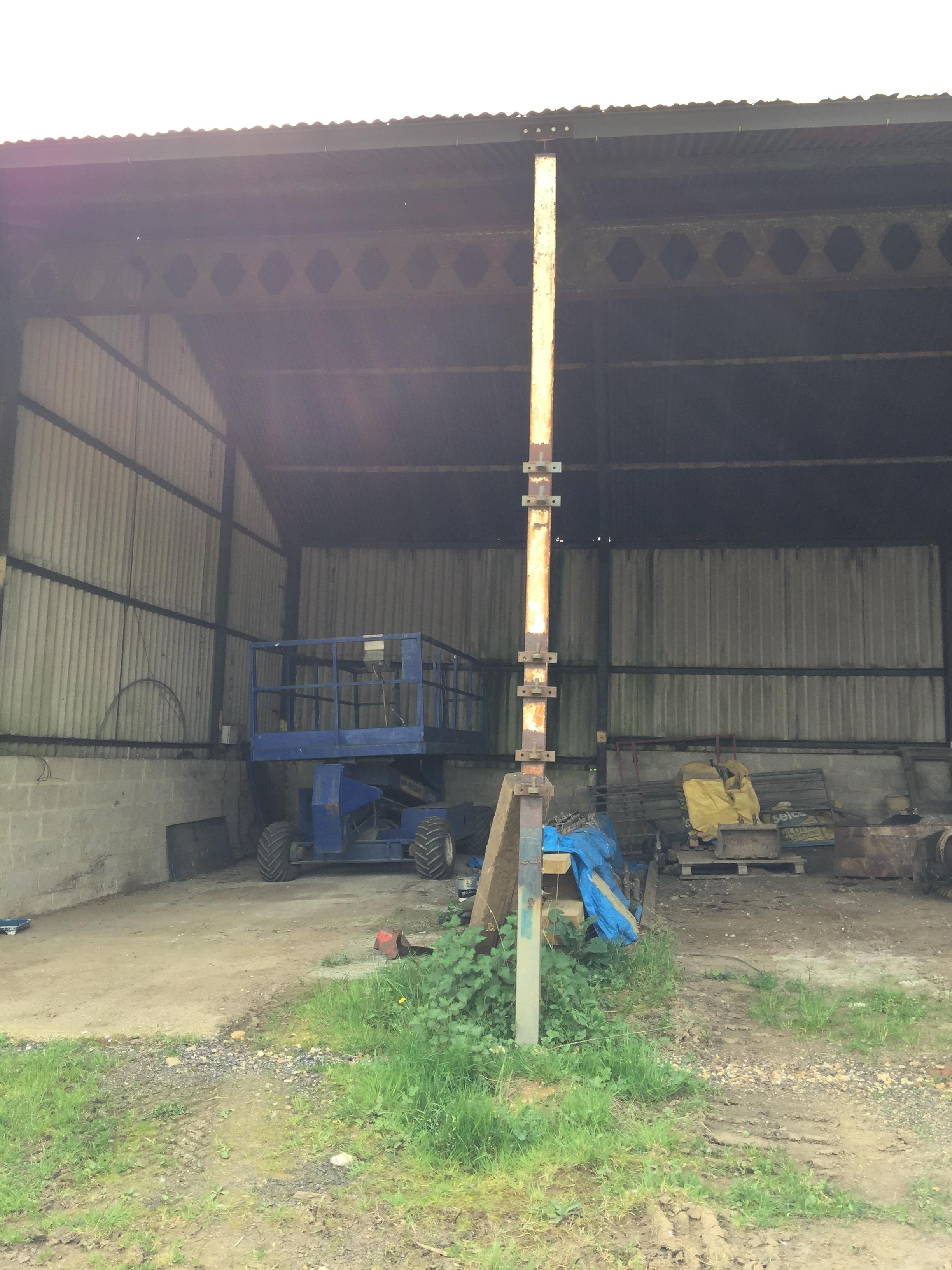

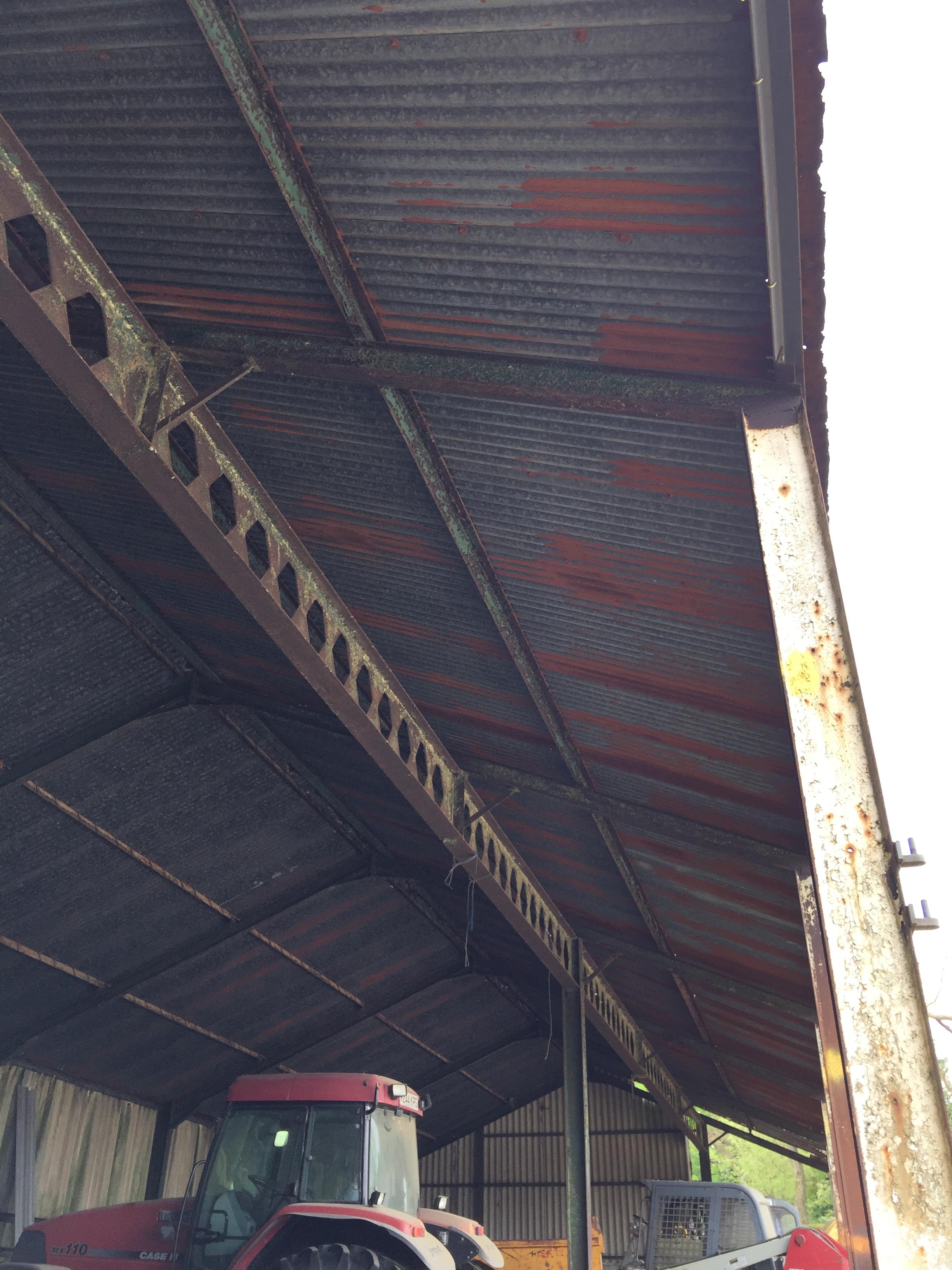

Stanchion to be removed in photo 2 and 3 , we have to put in a new ridge beam, Castellated to remain. Durisol blocks to infill. New rafters to take weight of thermo roof necessary? I think we are having problems because maybe the engineer doesn't know much about steel buildings...?
The steel frame that I have for a conversion has stanchions every 5m one of these is in the way of the garage door, it would be nice to be able to drive in 2 cars together rather than manoevere one in backwards and forwards until it fits the space and then put in the other! Could we strengthen the frame either side of the new wider garage door and remove the one that's in the way? We intend to infill with Durisol blocks, these have a 30/35n strength so they will hold up the roof...Won't they...? This blooming steel is being a right pain, we keep mentioning it to the structural engineer and she keeps ingnoring it. there is one hefty castallated beam on one side of the roof structure, this is nearer to the front steels area, but there are structural walls going up inside as well to hold the roof up. Any thoughts would be helpful please.

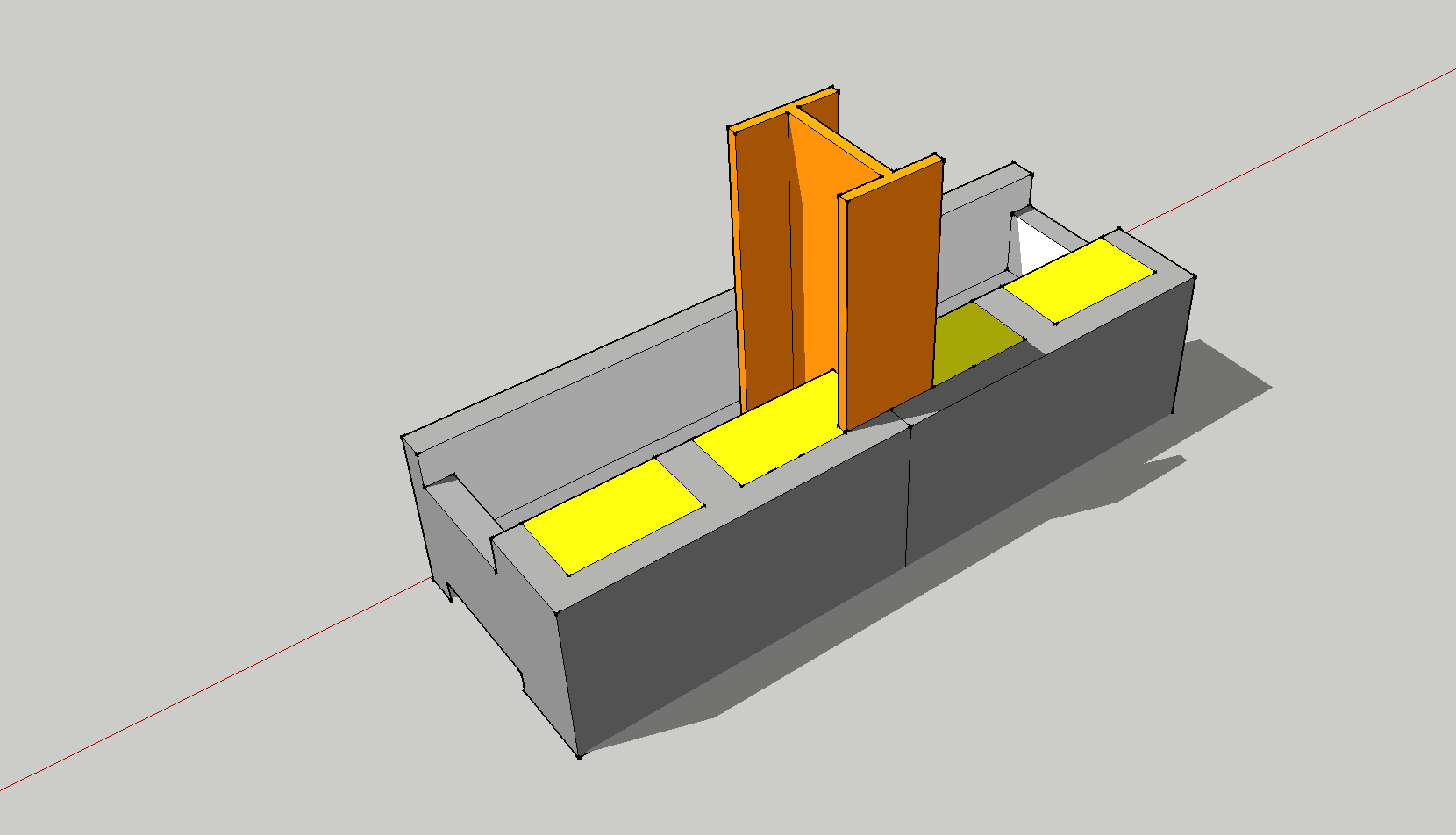

Well I was rather pleased with the reception, different area maybe. As my daughter and l have spent all the time researching and the hubby "doing" we appear to know what we're talking about (we are very clever at hiding the "I really have no idea what your talking about" syndrome!) Thanks for the advice, and yes it may cause a problem. We are hoping to foam the stanchions first somehow and cut the blocks around them, they were happy with my sketch up design, see below. Because of PD we are not permitted to go outside of the existing build at all. Our lady rep suggested a mesh under the finish plaster to eliminate hairline cracks, have you plastered yet (not in the pub)... Face blocks on edge above doorways with rebar, cut the top off to get the same height as the walls. Hubby has gone along this morning to watch the pour....they didn't seem to have any platforms inside to assist when walking around with the pump, that should be interesting as on the outside there is a 2.70m drop into the void....hmmmm! Are you happy with these blocks, I saw you had problems earlier, it must have been a nightmare, like the 1987 wind that ripped through here and took my barn roof off! -
An afternoon of getting close up and personal on Durisol blocks, I am very impressed and so is the hubby....makes a change from "we must go down the traditional route of block, cavity, insulation and more block"....NO.....get with the programme! We are hoping this will also solve the problem for the daughter who has a steel frame to contend with, just spent 10 mins on Sketch up drawing a block with a stanchion in it...seems to work, anyone got any good ideas on cold bridging issues going down this route? We don't have a lot of room on one side as the land belongs to someone else and the building is very close to the boundary, just enough room for cladding and that's about it! The steel will be covered by 40mm of block and whatever cladding she decides on.

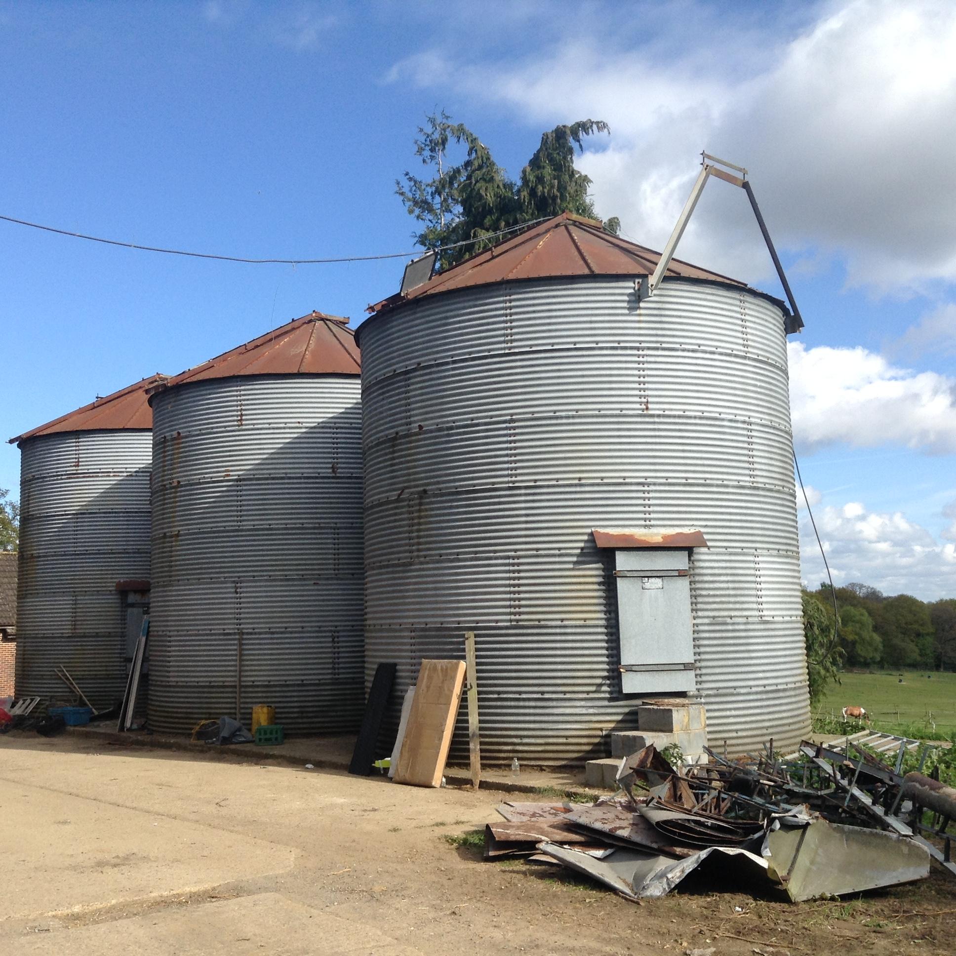

Morning all, thanks for the warm welcome. Not sure what ICBM's are Onoff, but the floors were perforated, there were ducts in the sides, machinery at the rear and gantries on the top, ladders attached inside and out, a lid on each on the roofs, they hadn't been used as grain silo's for some years I suspect as we have been here 32 of those and the folks before didn't use them. The Farm was a working one in the 50's and then sometime in the late 60's early 70's it was sold at auction which then decided it's fate of being chopped up into many areas and sold off as "amenity" spaces of an acre or so, we bought the house, 300 year old barn, a small stable and sand school and about an acre field. Over the years we have managed to buy another 90 odd acres along with other buildings, but there are still 10 + owners of the original farm. OK....here are your photo's, not finished yet, still to put in the bathrooms and kitchens. Underfloor electric heating in all three, hubby managed to cut off the top of his middle finger, break the one next to it and quite severly damage the little finger mixing the screed with a "mudley" let this be a warning to one an all..(a) don't rush the job (b) don't ask your friend who was a milkman to actually handle this machine (bless him, he's 73 and has NO idea on safety measures) (c) don't lean in too close with the bag because it's windy. 60 odd years of doing this job himself, day in day out and NEVER a problem, now he only has 7 1/2 fingers left! We have an amazing friend who did the wood structure inside, hubby took three weeks to cut all the cedar shingles to fit the corrugated profile. they are 5 metres round. The metal entrance doors are now windows pic 2. -
Hi everyone, well our planning aplication is almost there, got it once but decided to add a basement, the first was refused and so l put it in again but smaller, we will see by the end of the month whether we got it or not. In the meantime we have been working on 3 metal silo's and have connected them so that we can move between them, this has created a 2 bed property with a kitchen/diner, lounge, utility room, 2 bedrooms, 2 bathrooms and a chill out area. It's not been a cheap job, my idea of buying a caravan and making it cosy was rejected by the hubby, we then looked at a log cabin at 29 grand and he said no way...so l said why don't we convert the silos! Well we did start them without permission as they were already a gym with facilities but it wasn't insulated and it was an oven in the summer and a freezer in the winter. Then someone gave us the nod and we had to go for planning, refused the 1st time as someone put the red line around the wrong area, no parking, no amenities, and no access to the highway, even though the planning officer arrived on sit, parked his car and we have 90 acres...O'h well. Planning no 2 was handles by a consultant who was amazing, a rotweiller in a jag...like her a lot! Planning came through last friday along with 10 conditions, I'm wading through these at the moment, my worst nightmare is the soil sampling. If you have any questions regarding the silo's, pleaseask and I'll do my best to answer them . Onwards and upwards and as my daughter says "STILL WINNING".
