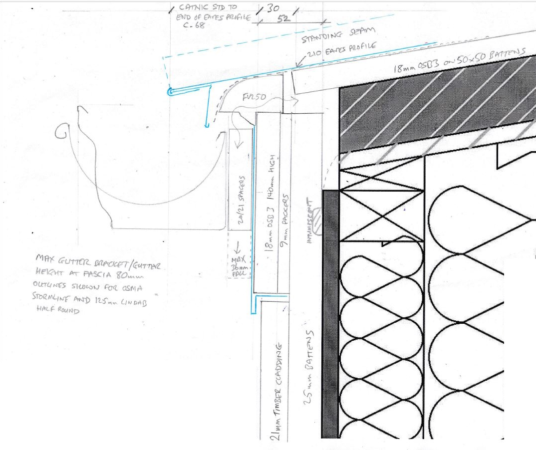

flashing over windows and doors - timber cladding
marmic replied to marmic's topic in Building Materials
many thanks - was thinking that as a possibility if I couldnt find a more purposeful trim and already have a roll here....... I did same on a garden office (posh shed!) few years ago at last place but wrapped it down over and stapled to the front edge of the reveal board (which were gravel boards!) - not sure how well it will withstand UV / full exposure etc. -
hello all, anyone know please if a preformed flashing like this/similar is available off the shelf from anywhere? so far not found.......... (25mm vertical battens + 21-25mm horizontal cladding/reval boards). ideally anthracite grey to match windows and roof. or if not best/easiest/recommded thing to use? be interested of course to know what others have used please................... many thanks
