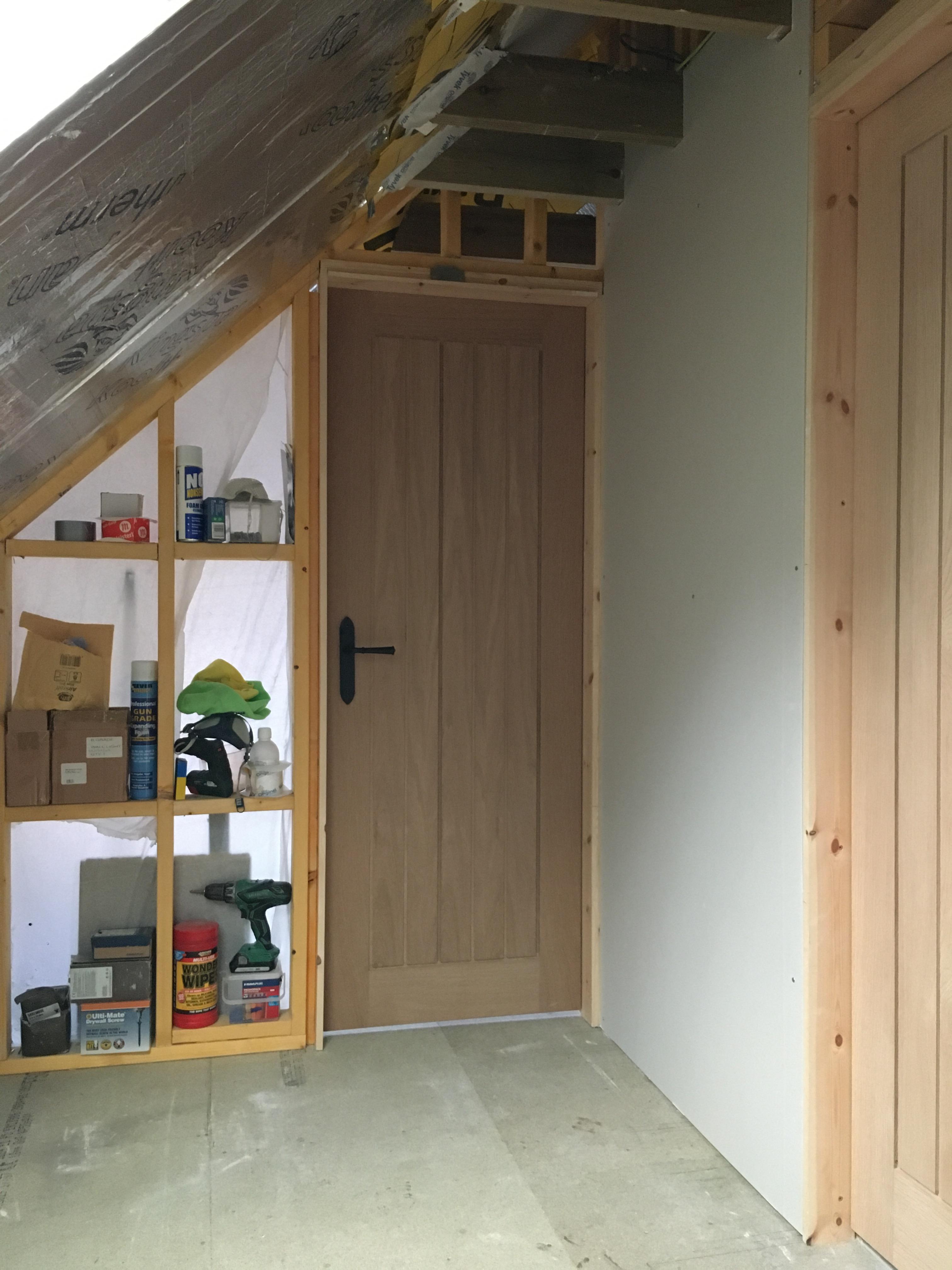

Hi folks, our sparky is currently not around as his wife is still shielding which is holding things up a fair bit but not really a big deal as just getting my head around the lights. Upstairs I'm getting closer to knowing what i want for lighting and I'll be combining spots and pendants and do similar in the extension. Anyway, can anyone tell me - I would like to mount spotlights on the collar ties (Probably Astro Ascoli or similar https://www.oceanlighting.co.uk/spotlights-c68/ceiling-c69/astro-6142-ascoli-single-1-light-spotlight-white-p26690 open to any other alternatives or sugestions!) The spots can be then aimed as required. What my question is, can I mount the lights on the collar ties (particularly in the hall pic shown) what are the regs on being near surfaces etc? Also is there any way I can hide the wiring going to the light better, the best I can think of is using white cable rather than grey (is 1.0mm allowed?) there will be 2 cables to each light I think, I assume I can't drill the collar tie but any clever suggestions appreciated. The lights will ideally be mounted on a face rather than the top or bottom. Any input appreciated, thanks
