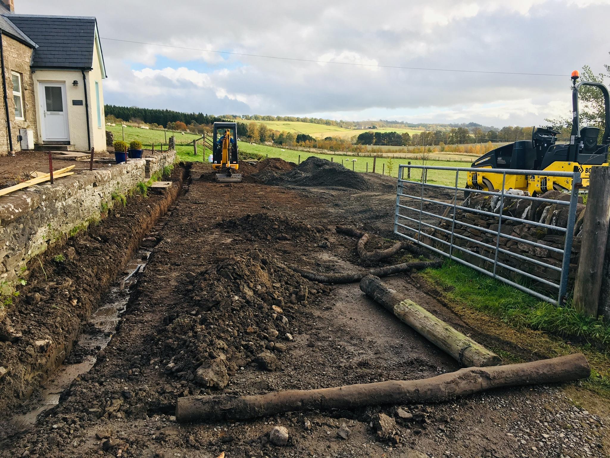

Don't panic! The area needs cleared a lot the top is very heavy going so it will get the top 300mm taken of over a fairly big area, after that its pretty easy going by hand as its good soil! -

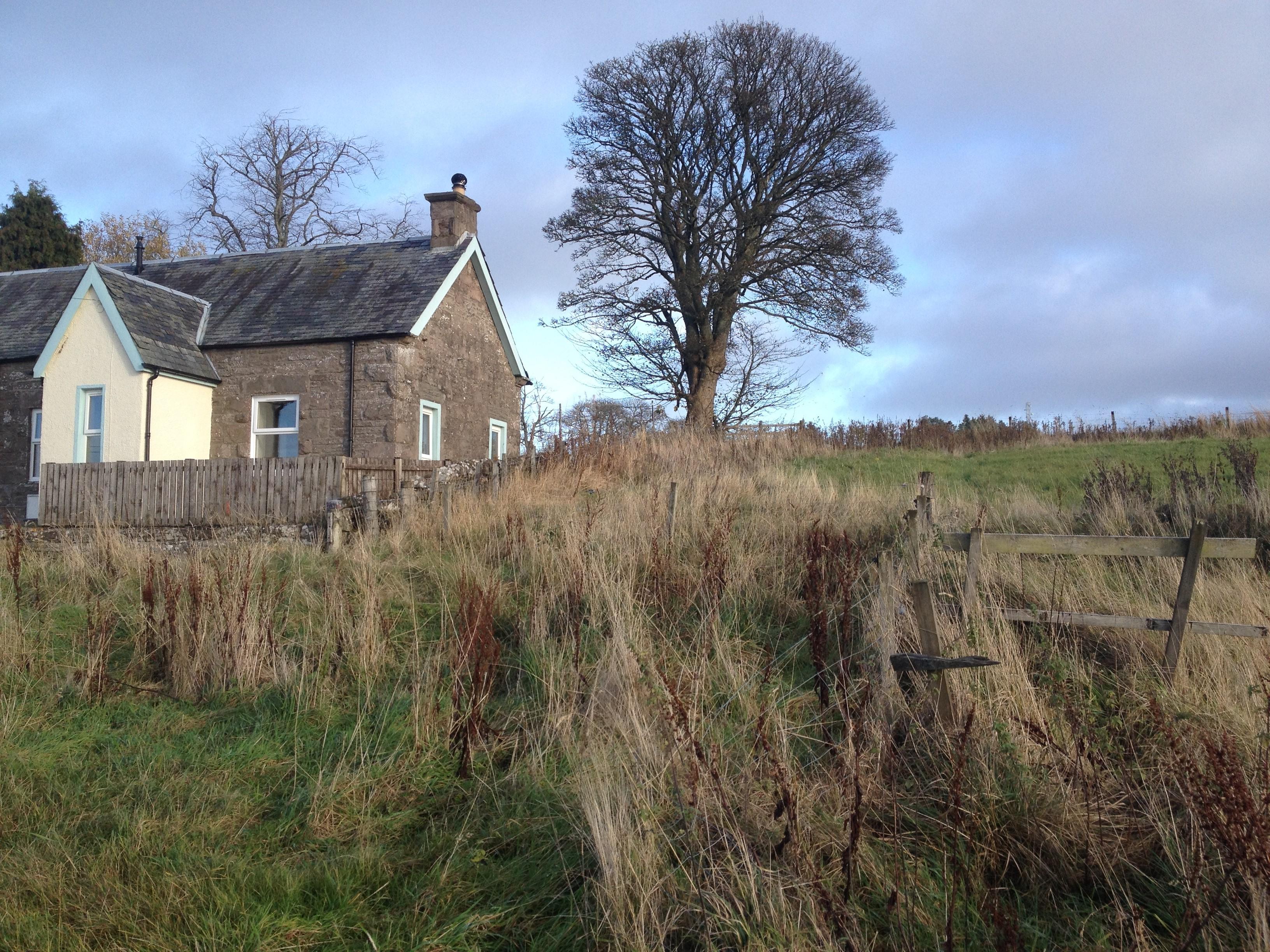

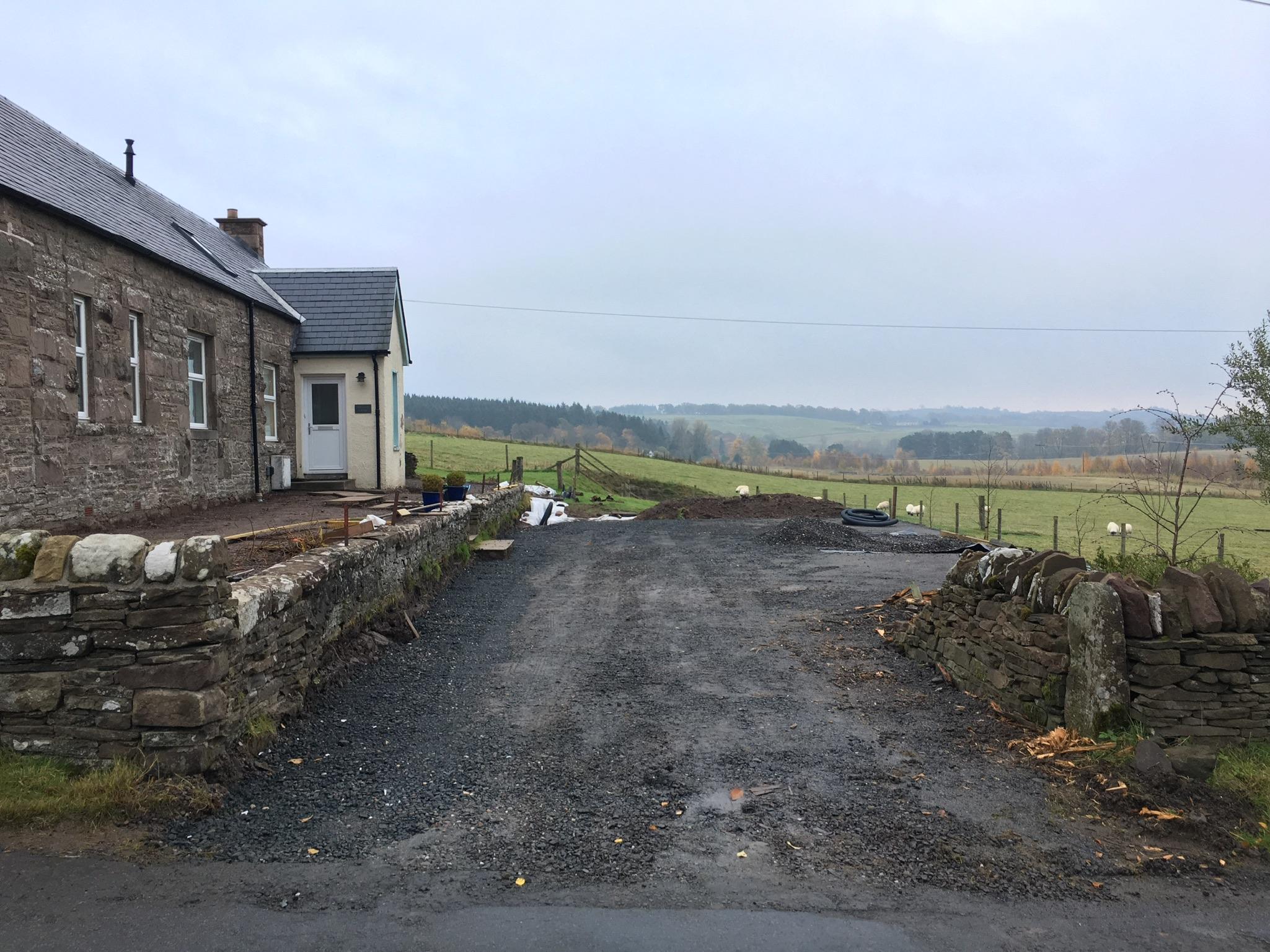

The house sits lower than the field the pipe runs through, the 4m I am just going by where the services map and where landowner thinks it runs. I also have my suspicions that the plastic pipe doesn't run straight. Have added a pic of the ground, above in the op. -

thanks that depth is probably more accurate! We have black plastic pipe coming into the house and have traced that about 3m toward said pipe but can't go any further without a digger now due the area needing cleared a bit!! -
Hi folks, as our refurb progresses we are looking to build an extension this year hopefully. We have a private water supply pipe approx 1 mile long passing 4m from the gable of our house approx 1.5/2m deep, it supplies us via a toby (which we have never been able to find) and about 8 houses downstream! The pipe is owned by the local estate and I am unsure of the bore, there was some mention of it being concrete asbestos in nature however I am unsure if this is correct. I just wondered what the general route here is, if it can be left in situ it would be directly under the extension which I have no real issue, however rerouting looks like a major pita. We are very rural and field all around so finding a new route isn't an issue. Just wondering if anyone has any input or experience in this and what what happen and costs involved?

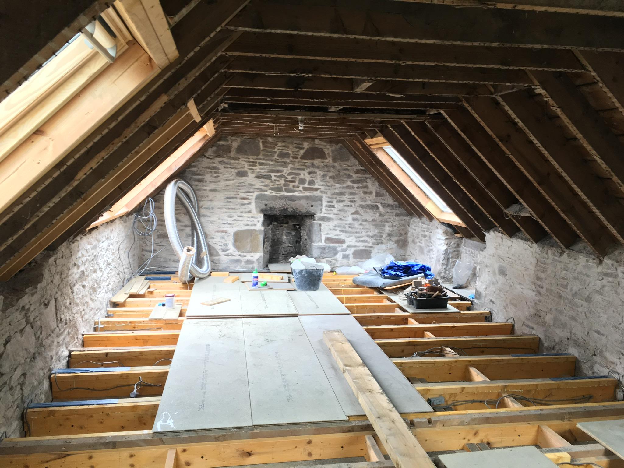

Hi Folks, Some input appreciated on the following! In our loft conversion our architect has most recently specified in agreement with BC - 150mm insulation between the 160mm deep rafters (externally sarking, high performance breathable membrane and slate) 25mm on top of the rafters to stop cold bridging etc (then plasterboard to finish). Originally we had planned 100mm between the rafters with PIR but Building control wanted a roof vent top and bottom on every!!! rafter bay for the 60mm void (which externally would have looked ridiculous) but it was because we have no eaves space for top to bottom and bay to bay air flow (very old house the rafters terminate in the wall head). Because of this we have gone for the route at the start, this also means we only need the 25mm insulation on top of the rafters mentioned which increases ceiling height internally. So what I'm not sure about is the architect and BC officer have agreed on the 10mm void behind the insulation with a highly breathable membrane over the sarking externally (under slate). What are peoples thoughts on this my feeling is that there should be no void in this application compared to say a 50mm void behind insulation board where vents are present (I have spoken to the kingspan technical team and they said it was fine but for some reason I wasn't totally convinced! Is there benefit to the 10mm gap? I was also surprised to see on a Kingspan Kooltherm that it has small pin holes compared to none on normal PIR does this mean that vapour can pass through it? Finally how does xtratherm safe-r phenolic compare to kingspan kooltherm? In general thoughts or musings appreciated!

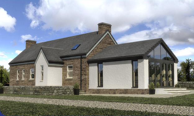

Hi thanks, Sorry I do actually mean gable ended (have edited above) - should have read back through what I wrote. We want to benefit from the amazing view (which we barely see just now) by glazing the gable. Yes you are totally right the long thin style is very difficult and we loose a lot off the bedrooms as a result to hallway but going to the front would be problematic due to the ground and planning and to the rear there is a big height differential so to the side is the best option. We have no living space currently (currently have a sofa in the kitchen diner) and we have been converting the loft as such however as we now have children we feel this won't be enough and want a ground level room that flows outside better that the house does at the moment. We had a quote and a mock up done last year and were quoted £80k by a bigger company, internal size approx 4.5m x 8m (we'd like to go a bit longer if possible) they were planning to use block work but without ground works costed in, not sure why. From my own research groundworks would be probably anywhere from £5-10k++ depending who we use. Said quoting company specialise in Scotland in conservatories and now do solid roofs, I think this project although not beyond them was maybe a little bit too far from the mainstream and I felt the cost was pretty high. The basic style isn't too bad but not sure what any feedback is, I feel our only real route is cladding or render because the stone could never be tied in too look good due to the original stones nature. I want the ceiling to be vaulted / open and would like possibly depending on height have a small mezzanine for the children to play on and to create a nook within the room. Finally I'm not sure what it is called but would like a verana / overhang of the roof at the gable end as we get a lot of rain year round and when its vertical! it would be nice to still be able to open the doors and or sit outside. I have attached a rough plan 18thdec pdf below & and a mock up. Any thoughts much appreciated! FYI current gable height to ridge from ground is 6m and front to back is 5.6m wide dec18edit.pdf -

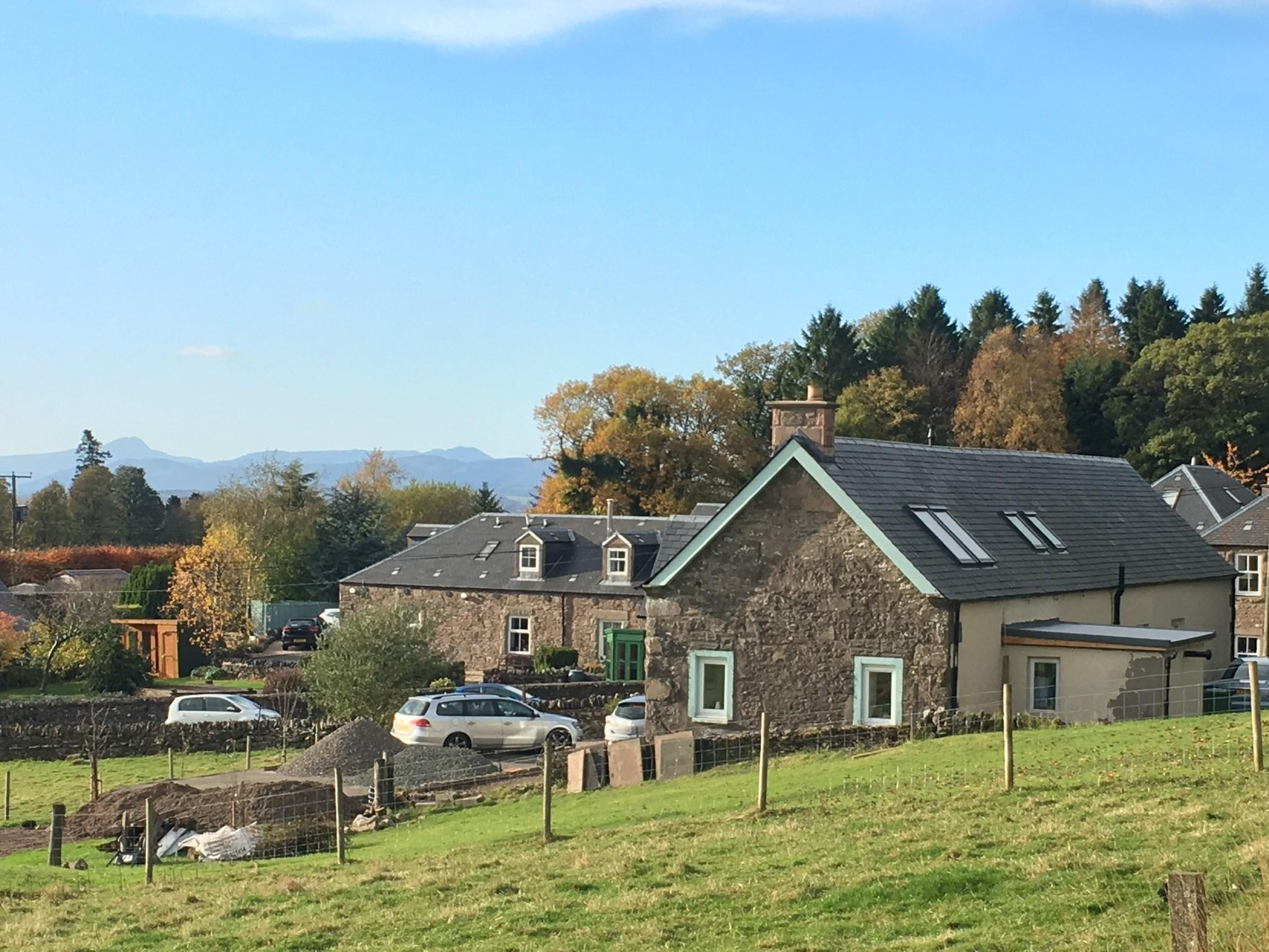

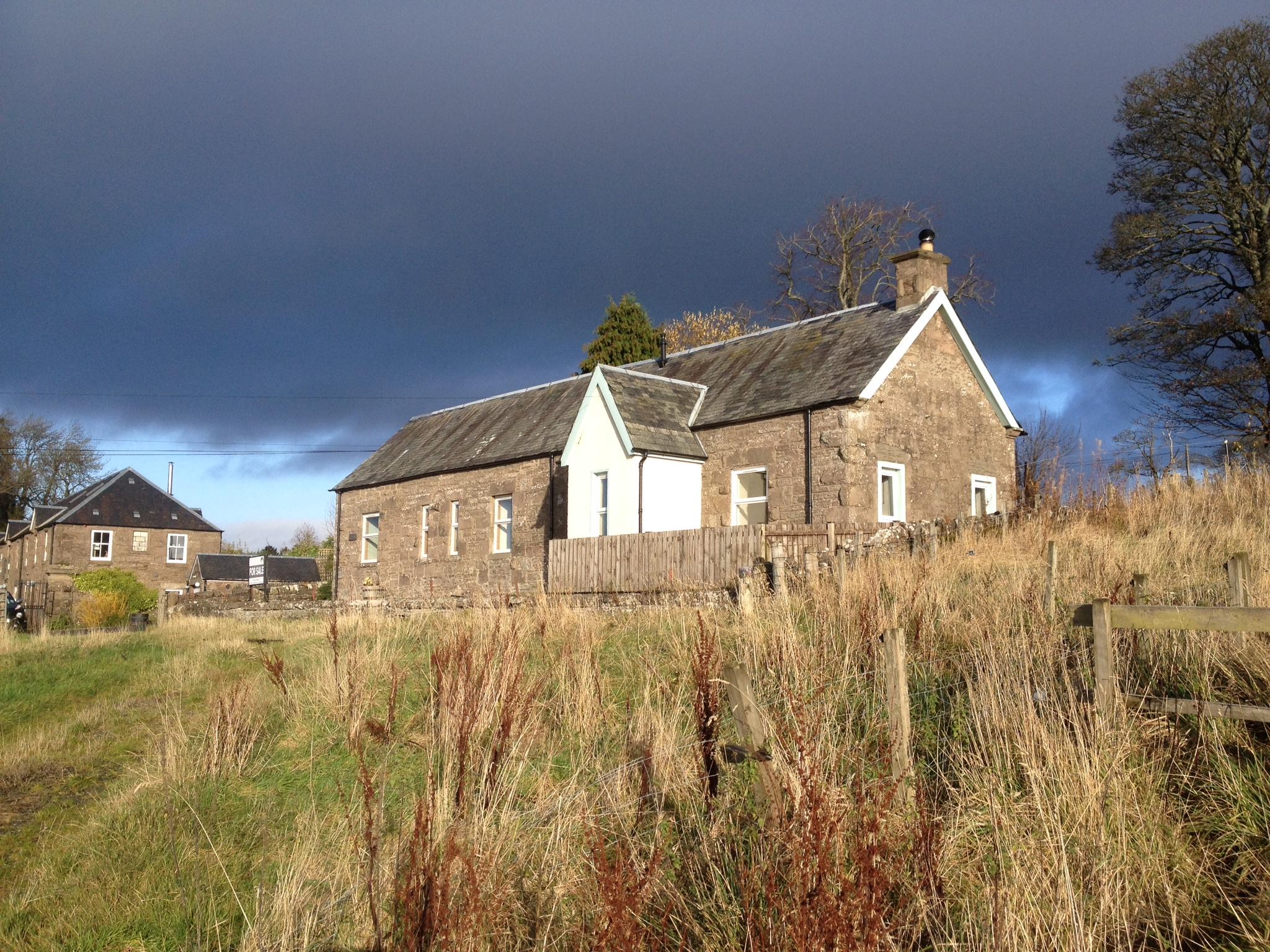

Hi folks, as you may have seen in my intro we are currently renovating an old 1850s cottage! this year we want to get an extension moving and this is the early stages. We are not listed nor conservation areas, a initial chat with the local planning officers has not thrown up any issues that could be major stumbling blocks so I want to progress things. The extension will be to the side of the house off the gable end and will be gable rather than flat roof with the ridge sitting lower than the existing (I think that’s a requirement but would rather it was anyway). Style I not sure on but size is max width of existing house 5m by at least 8m ideally longer house is strangely high but very narrow! Glazed fully on the gable of the extension and some narrow full length windows on one side. Roof will probably be slate but I am interested in a folded seam type sheet metal but not sure how this would last in our very exposed aspect! Finally a reasonable retaining wall will be needed (at least 1m high on one side). 1. My first issue is whether to go timber or block work any thoughts appreciated 2. I know the extension will possibly sit over a private water pipe and our utility main waste pipe I have no idea how this will affect things!
