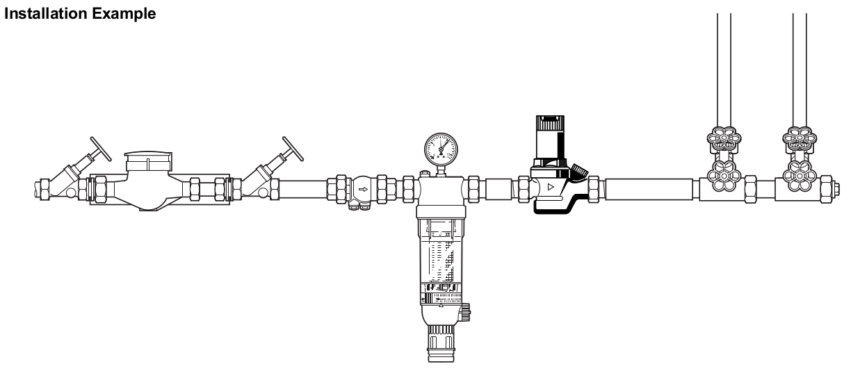

Gosh, isn't filtering the water supply a little extreme? I've managed 60-odd years without this. I've seen scale inhibitors installed. How common is this?
Just as quick Q, I came across this example in the Honeywell Pressure Reduction Valve (PRV) spec. I get the meter with isolation valves either side, the double check valve, the pressure gauge, the PRV anf the two main circuits to the right, but what is the device under the gauge? A scale inhibitor? Or any better guesses?

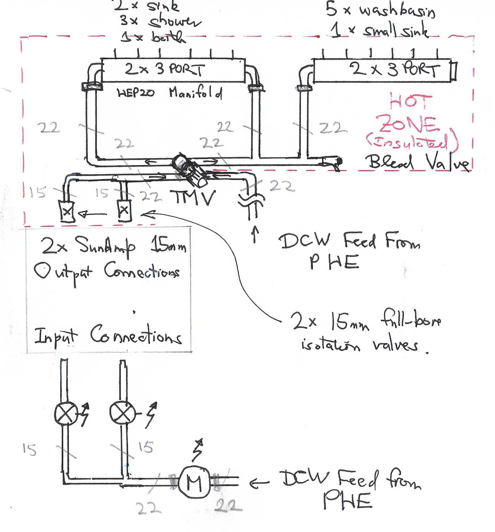

If you use the SunAmp inbuilt mixers then the full flow goes through the 15mm tails. By setting them to max, or 65°C say, then using the external mixers I will do a ~2:1 blend in the mixer with the DCW and so be able to sustain a higher flow. I also have 2 SunAmps in parallel and using the external mixer simplifies setup: only one TMV to trim. Anyway, that's my thinking, but we'll have to see in practice.

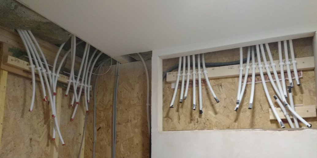

Nick swears by HEP2O. As to the layout, the basic rule if you use a manifold system is no buried joins if at all possible, and one (H +) C to one appliance. Our exceptions to this rule are: We have some elbows in the studding where the pipe is coming down the wall and needs to do a sharp 90° (e.g. the shower tails) We have the cold feed dishwasher T'ed off the kitchen sink cold. We have the cold feed washing machine T'ed off the utlity sink cold. IMO, laying out the pipe approaches to the manifolds is a bit like laying out a circuit board: it can get busy and messy and you need to avoid getting pipework in knots. Do your foulwater first because those are fat and difficult to route. Then the plumbing, then the electrics. I reserved the roof space in the GFL toilet adjacent to my manifolds for my "Clapham Junction" and actually did a full routing diagram for this before I laid a single pipe, and I had to go through three design iterations to get everything in the right order. Jan though I was being totally anal and going overboard -- until we started pulling the pipes and then she did a volte-face and agreed that it was a bloody good idea. Remember to space out the hot and cold manifolds to give yourself routing room. I am using 2×SunAmp instead of a TS or UVC. They immediately below the hot manifold so my hot copper runs total about 2m of pipework. That's it. Read through the various worked descriptions on the forum.
@jamiehamy, Have a look at the thread I've got running at the moment. We are doing ours in HEP2O using a manifold system as well. Deciding the runs and placing the manifolds is the bit that needs careful planning. We did all of ours in 15mm because our layout means that nearly all of the runs to the manifold were pretty short so standardising on one bore simplified it all. Though I admit using up a coil of 10mm for the low flow toilets and hand basins is something that we could have considered. I would question the need to use 22mm to the bath in a pressurised system. Unless you've a got ridiculously long run then 15mm will be fine, and avoid needing to use buried bends or joints.

So what is the current wisdom on TMVs? I am talking specifically about the mix-down of the ~ 55°C output from the SunAmp with room temp or colder Domestic Cold Water (DCW) to feed the DHW manifolds. Have you guys got any personal recommendations? Is 22 or 28 best here? The 28mm TMVs seem to cost crazy money. I've got 2 × 15 outputs from the SPV into 22 and the DCW into 22. The TMV output splits again into 2×22 a few cm after the TMV output. Our current house DHW is in a mix of 22 and 15mm copper which an internal cold header tank so is at ~ 0.2 bar and we've never had any problems. Is it worth a separate 15 or 22 TMV for the low flow hand-basins set at a non-scalding temp, say 48°C?

So my specific Qs are: Any recommendations for the TMW, the 2 × electrically controlled shut -off valves and the digital / pulsed water meter, bearing in mind that these need WRAS approval for use on domestic cold potable water. I've got a box some 30×15×60 with all of my hot stuff in it that needs lagging. Any recommendations here? I was thinking of using that Aluminium covered quilting. Beg, beg
