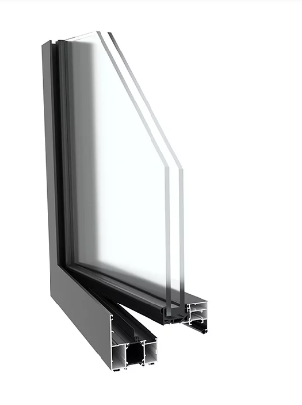

Thanks for the tips... however, neither of these are timber-frame alu-clad. We're specifically looking for alu-clad timber with a clear-lacquered internal finish, to match our existing Velfac 200E units. -
We are looking for inward-opening windows, with a 'hidden sash'/'concealed sash' design, similar to 'Cortizo COR 70 Hidden Sash' (pic attached), where the opening sash does not overlap the fixed frame at all. I can't seem to find any with this design which are alu-clad timber framed, only PVC/aluminium. Is there anything out there which suits this spec? Failing that, which alu-clad inward-opening windows have the slimmest opening sash overlap out there?

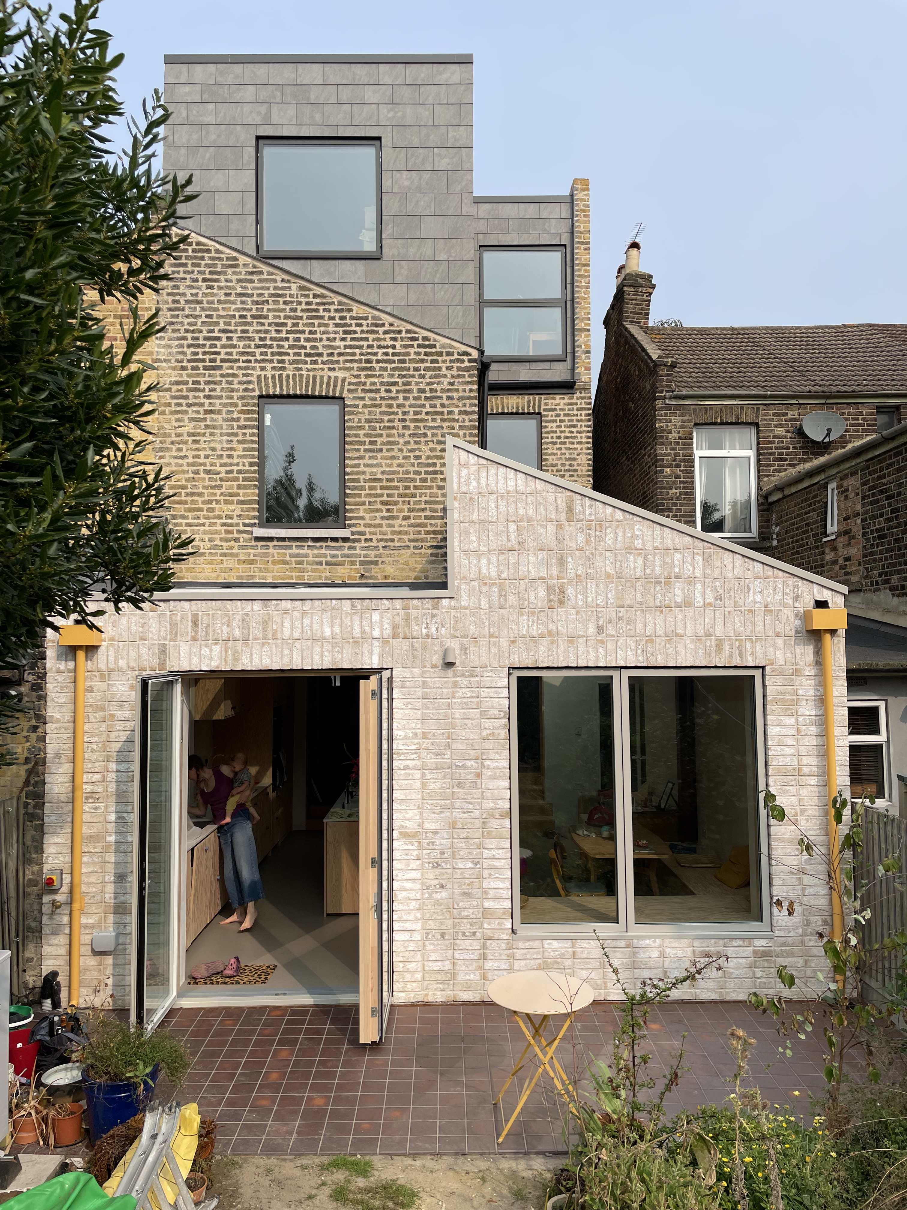

No, we looked at the Cortizo 20 sliding doors as part of an extension/retrofit. Visited a couple of installations and I wasn't impressed with the design. They look great though! Ended up with Velfac casement doors and opening picture window. Seals are very good. I've attached a pic.
I can't advise on installers, but having experienced the actual product (sliding doors with 20mm sight lines), I was not impressed with the design. Thermal bridges everywhere, sub-optimal seals and a poor threshold design which leaks air.
