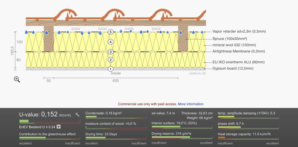

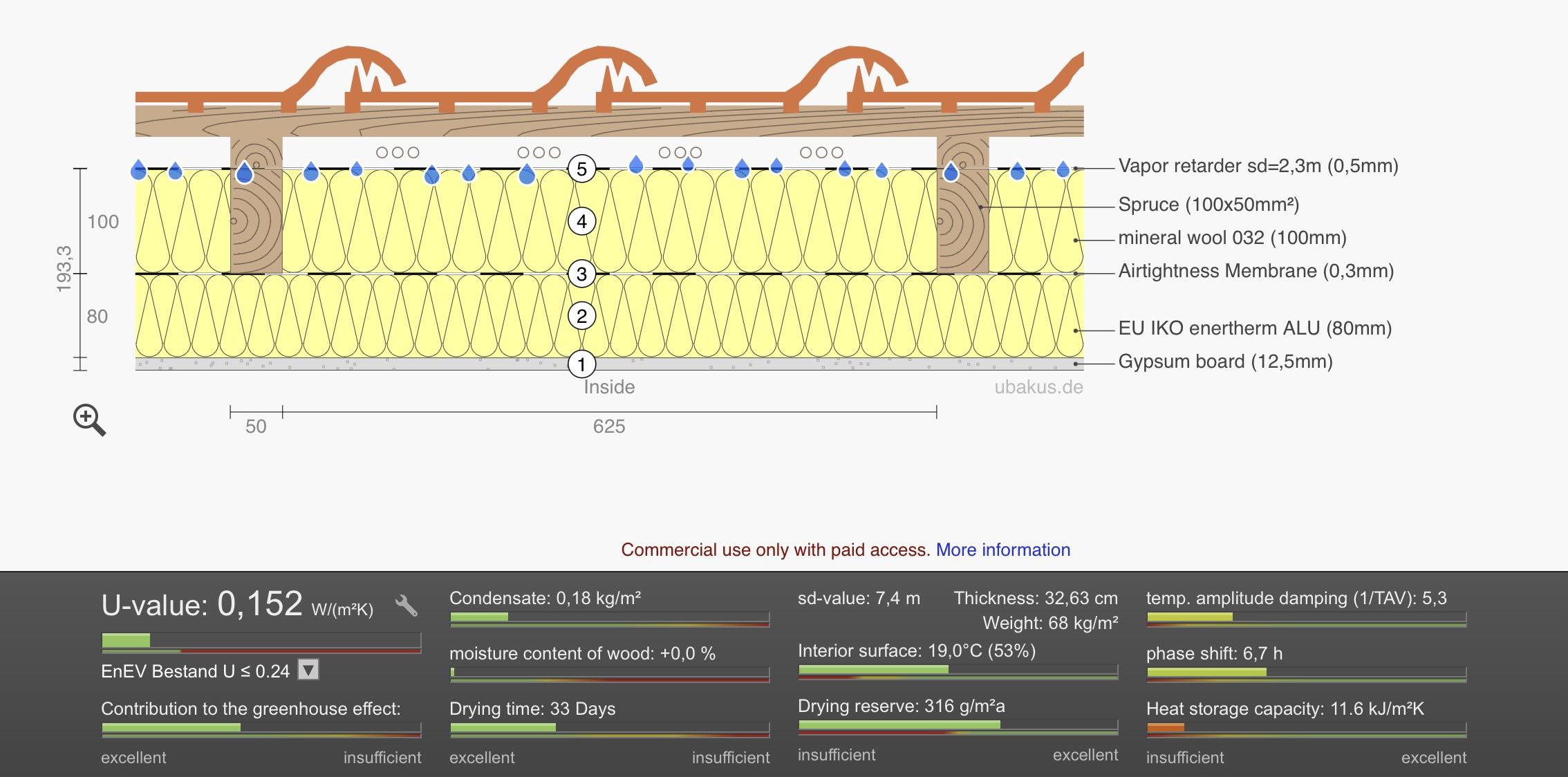

The rafters are ~100mm deep, with a wind-tightness membrane above, then slates. Would it be possible to full-fill between rafters with Dritherm 32, or would an airgap be necessary? -
We're having a dormer loft conversion built right now, and are almost at the point of fitting PIR between joists/studs. I'd like to wrap the lot in airtightness membrane, but not sure which type to get, or best-practices for applying it. Are there guides for doing this, especially for around window/rooflight reveals? Which membrane performs well without breaking the bank?
