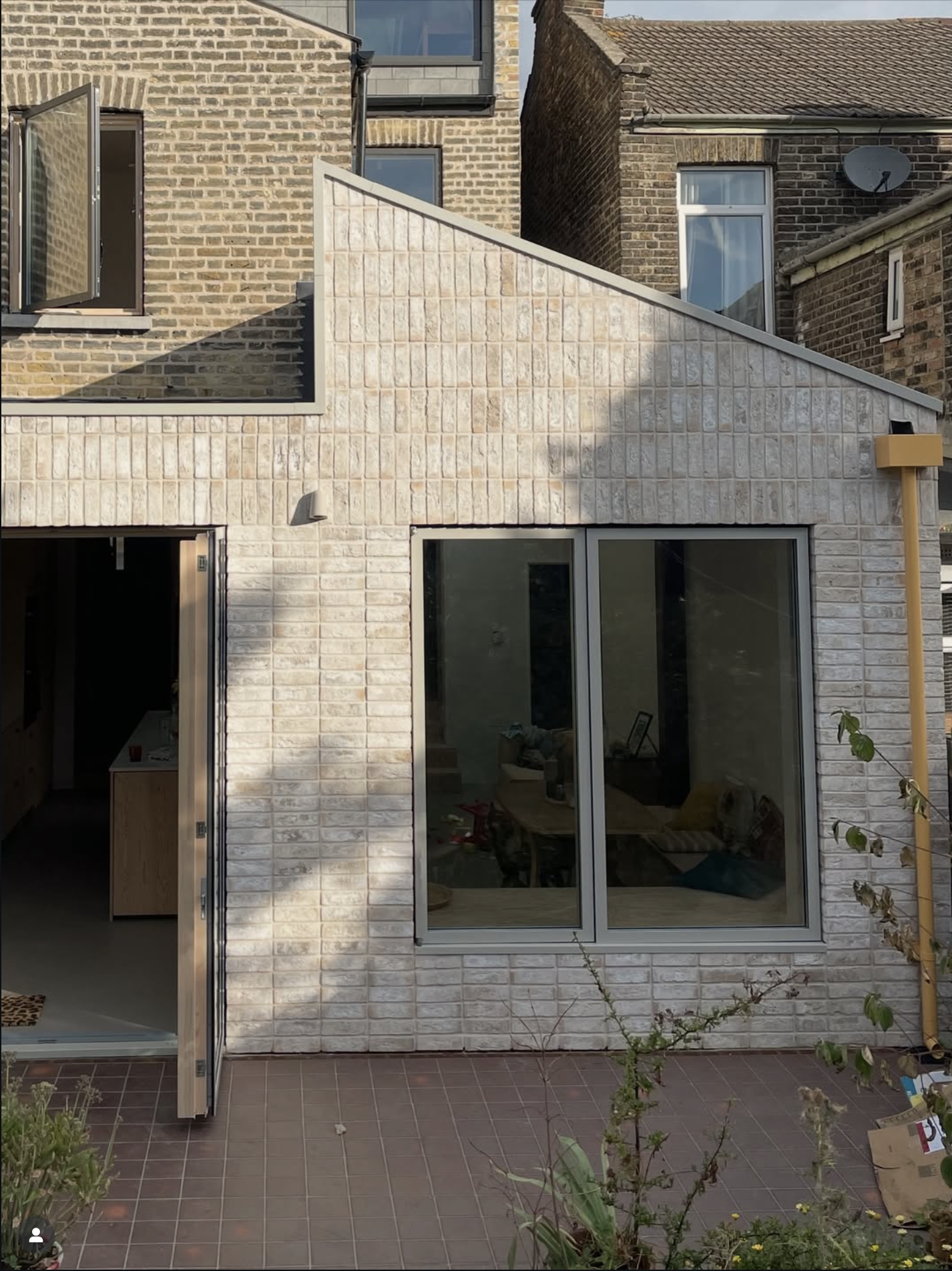

  2. Another shot. Difficult to see, but it's a creamy off-white in real life.
  3. I used Lime Green Natural Lime Mortar for our extension below: https://www.lime-green.co.uk/products/lime-mortar/natural-lime-mortar Comes in bags, just add water. Loads of colours; I used 'Chalk'.
