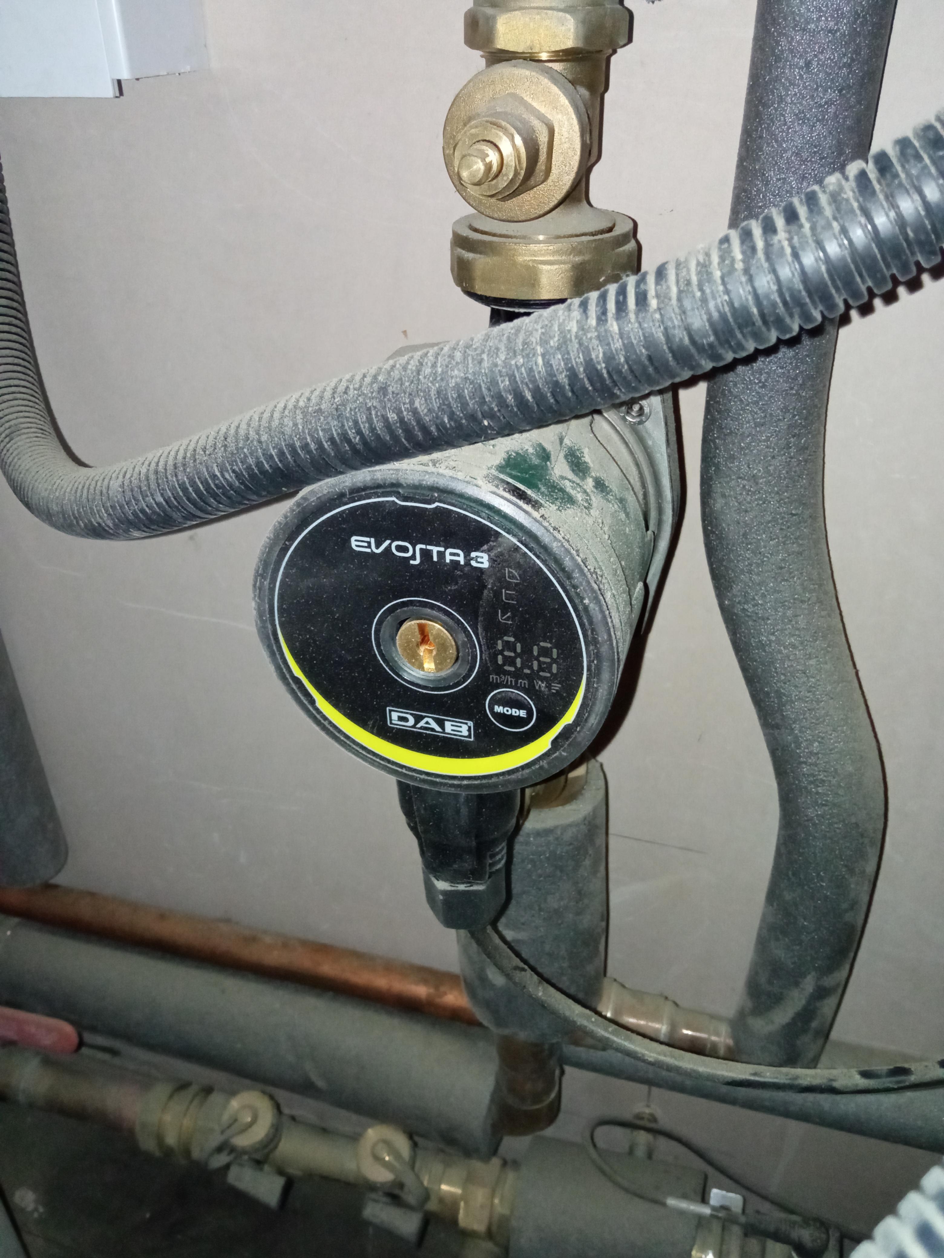

  8. Hmm, ok I'll perhaps up it to 48 then. I can't see any wire, just this (excuse the dust)

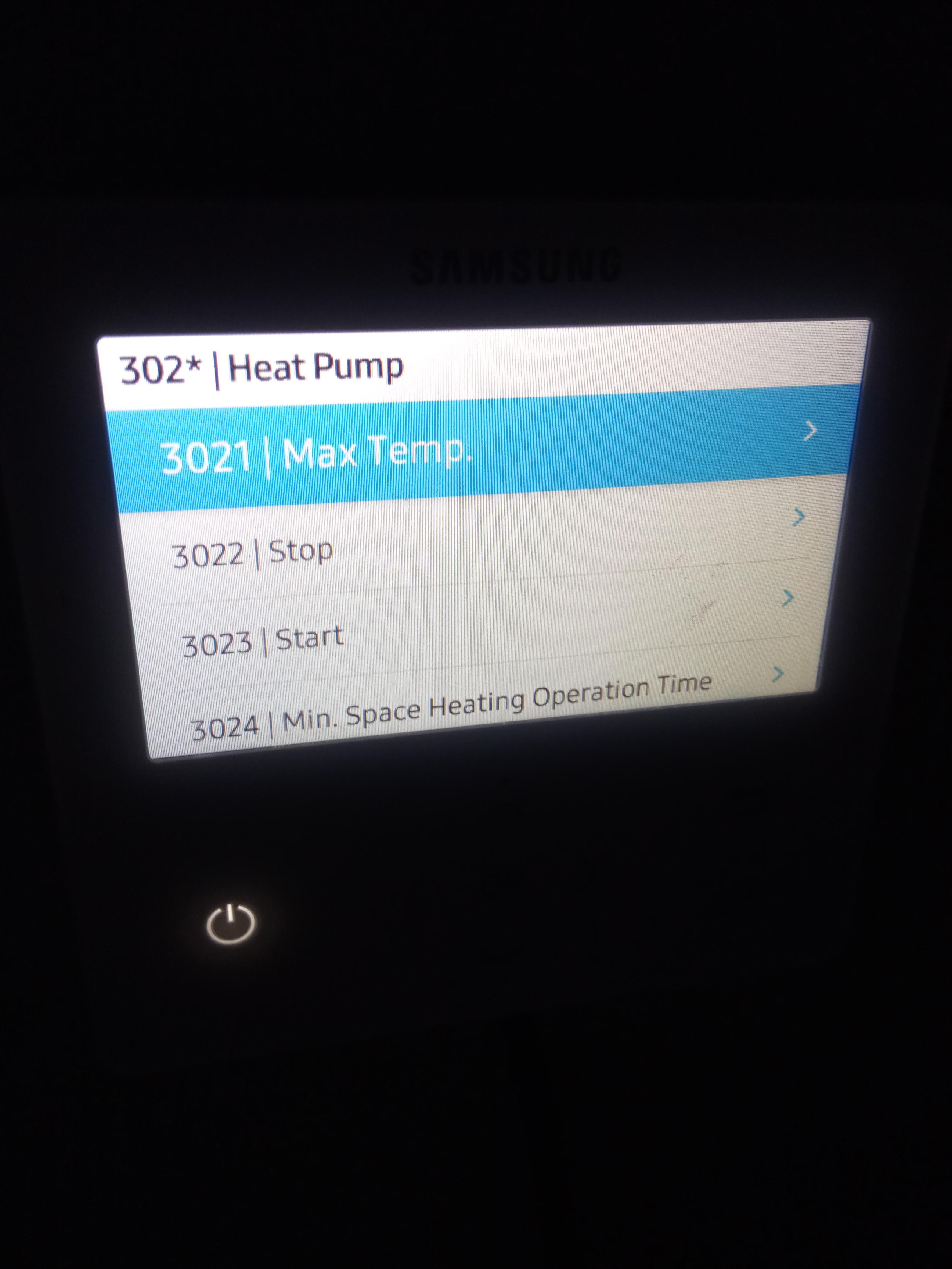

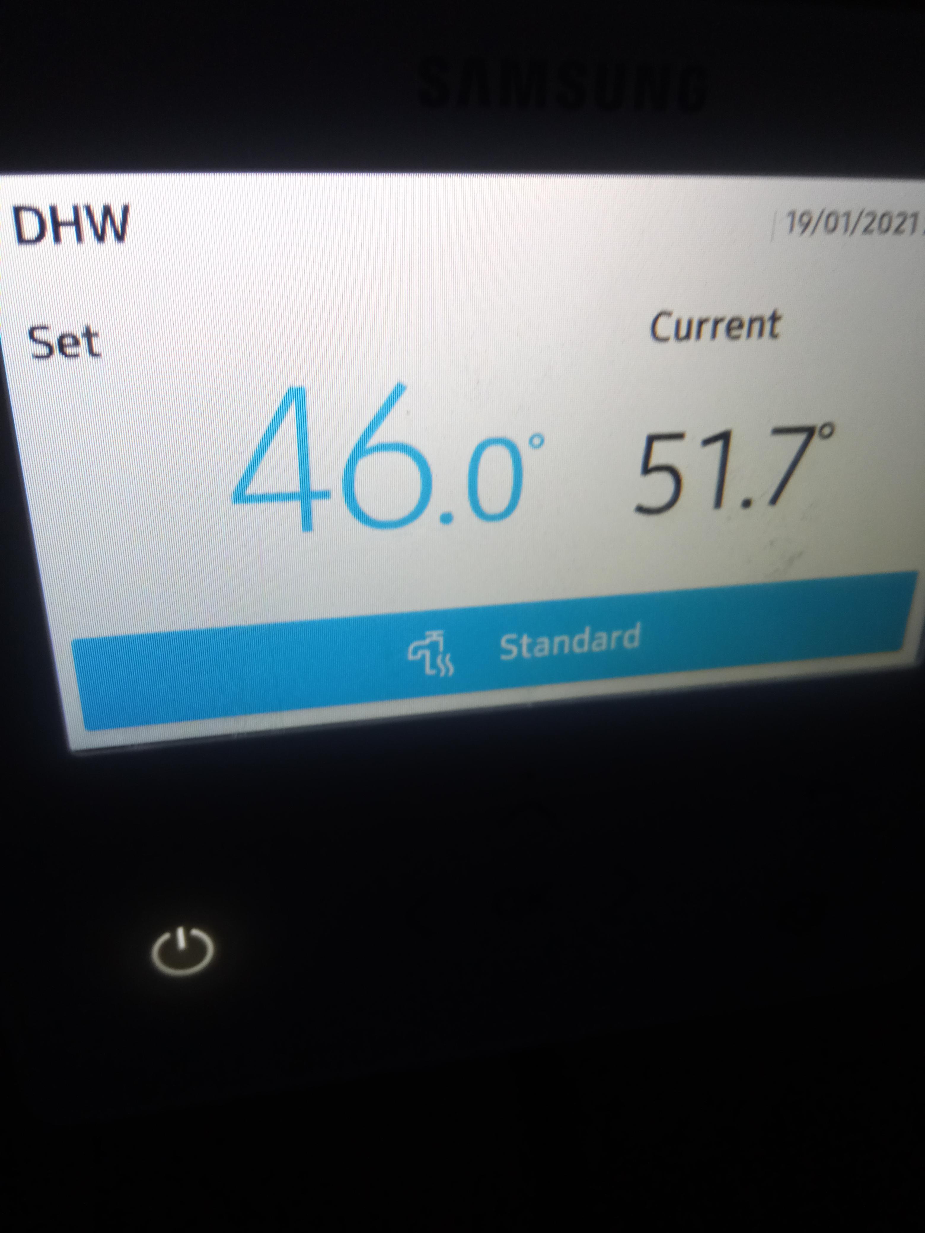

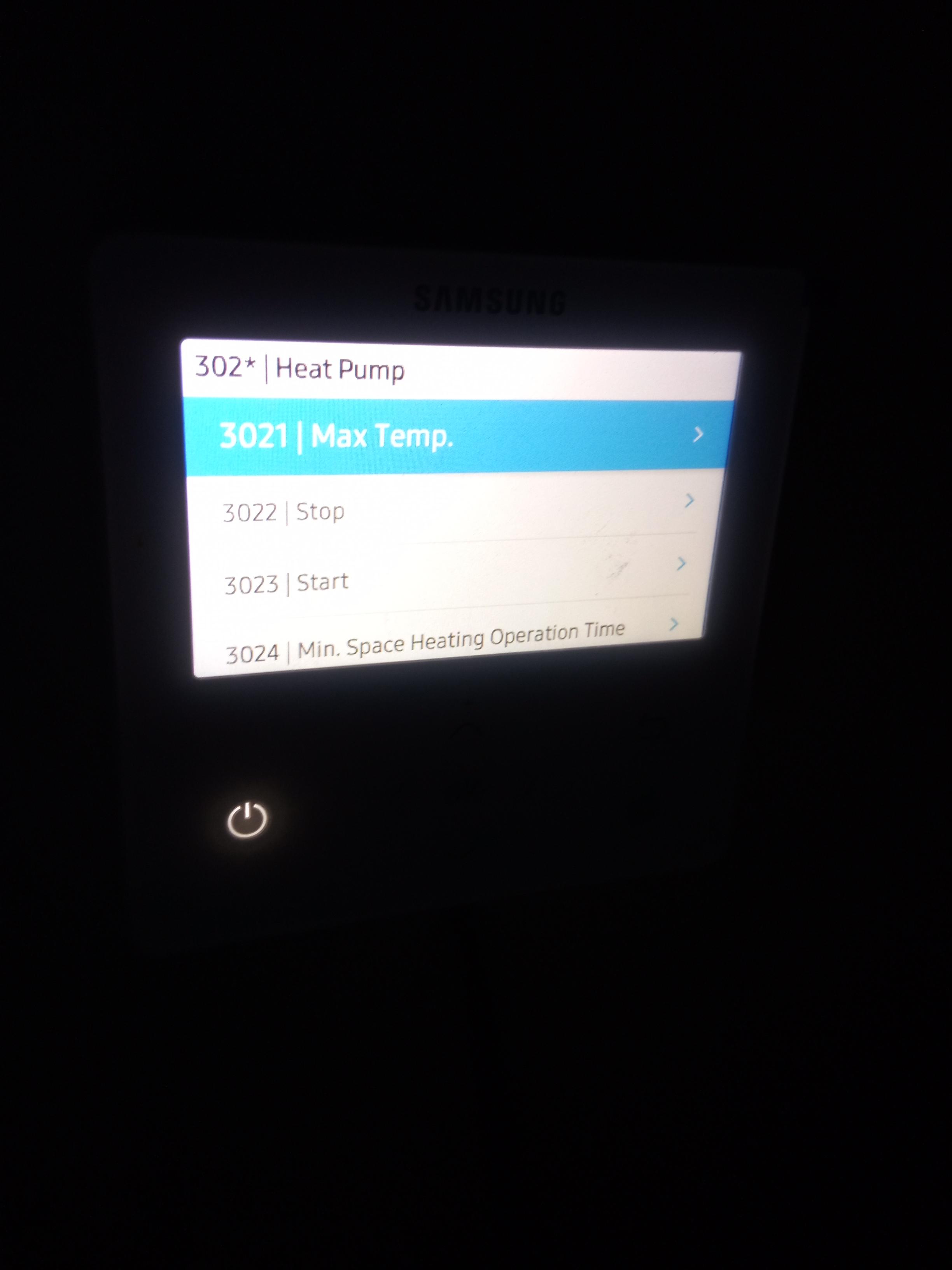

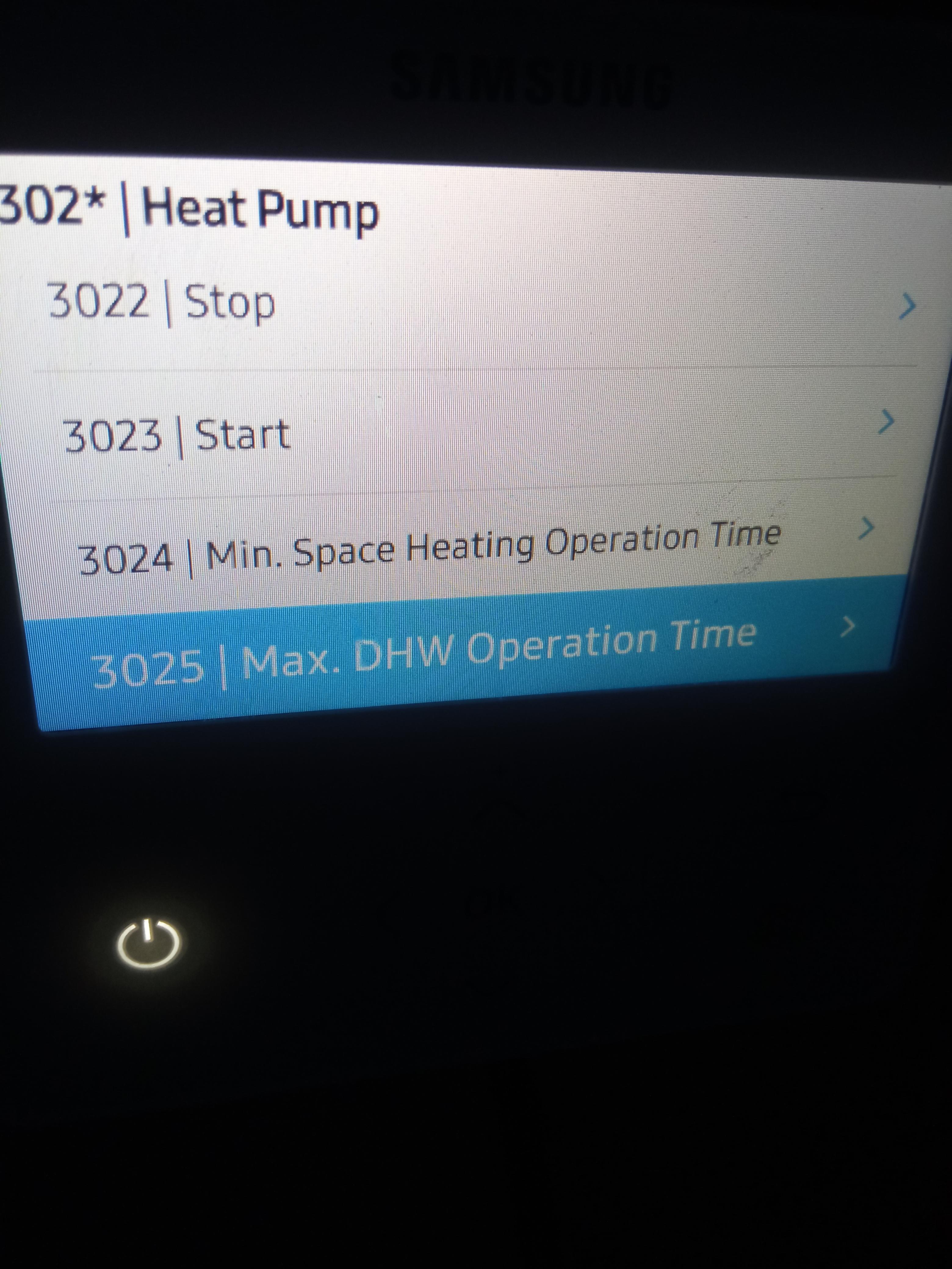

  9. That pic is the main screen. That is what is on the main screen, which I've just checked again and this is what is on the main screen. There is then the additional option under advanced settings under the *302 menu to change the heat pump DHW max temp which was set at 55 degrees which I've also reduced now to 46 to match the home screen. Seems there was some conflict there.
  10. No - I'll adjust the temperature to say 48 degrees. I found the legionella setting it was down as disenfectent and I've now set it to do not use.

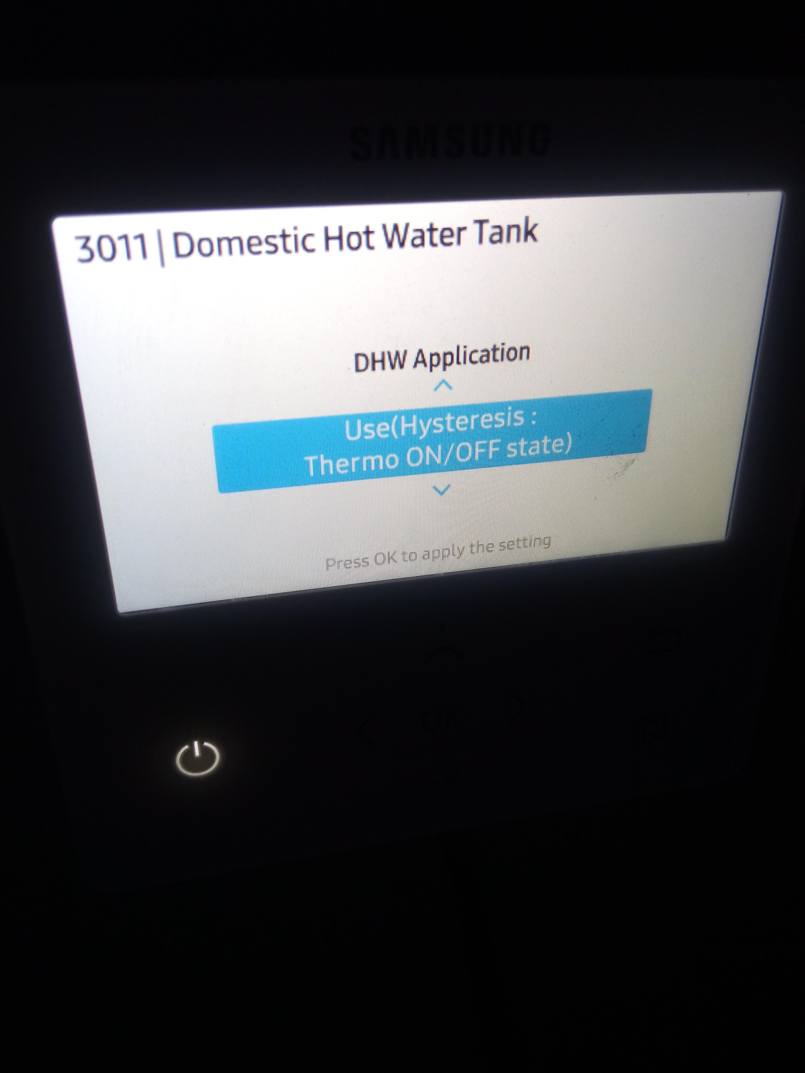

  11. Re the water. These are the only options I can see. There is this with this setting currently set to use or 'Do not use' Then there is the max operation time which was set to 90 mins. And then there is the DHW Heat Pump max temp which is set to 55 degrees.

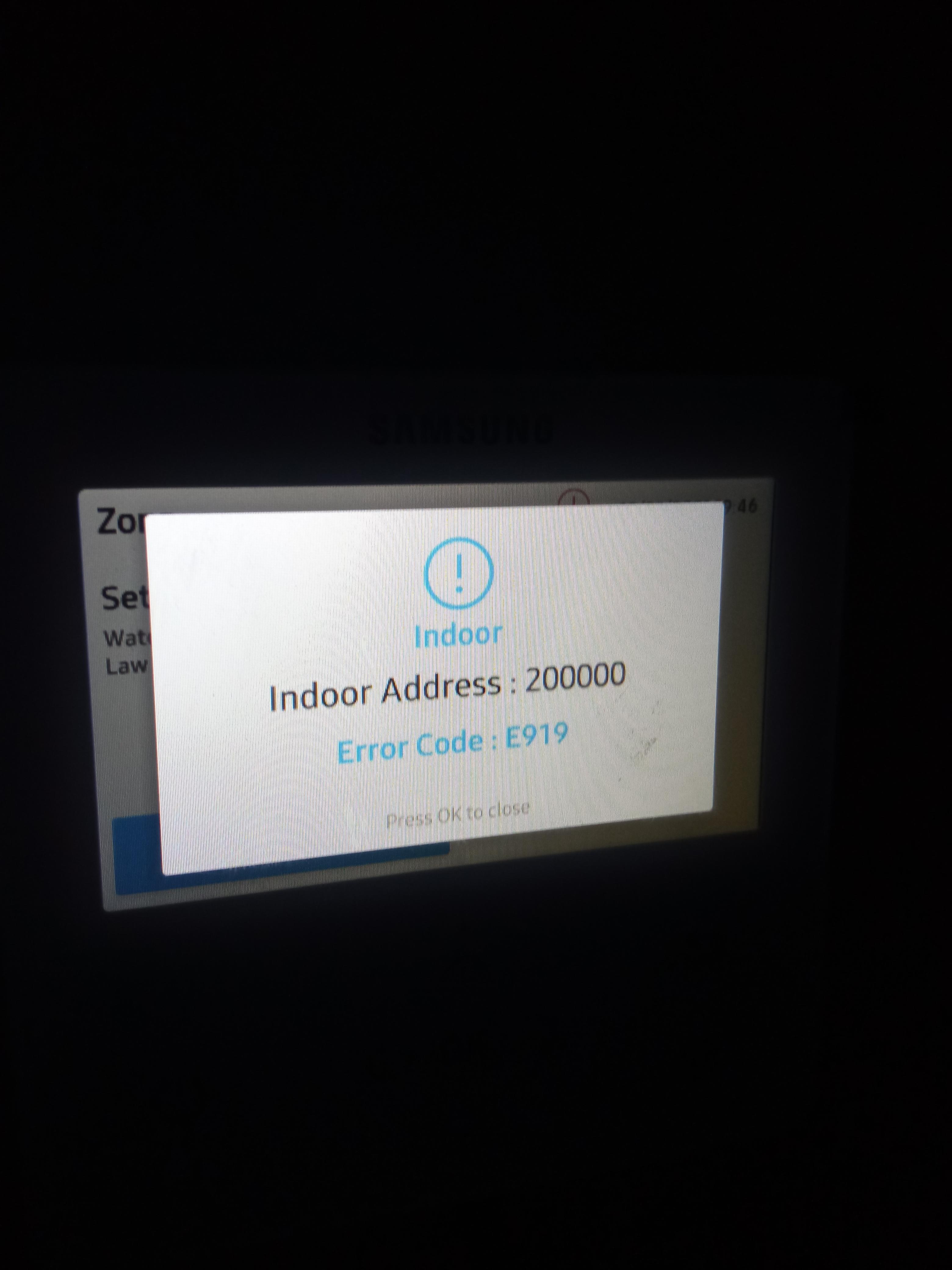

  12. In perfect timing just went to look at ASHP and there is the error code below. Manual indicates 919 Error the set temperature for disinfection operation is not reached, or, after reaching, the temperature fails to continue for the requested time. I guess this answers the question re the legionella cycle then so the problem must like elsewhere. Edit - I have however found the disenfectent setting and it was set to Tuesday at 60 degrees for 10 mins. I've now programmed this to 'do not use' so it may have come on at some point earlier and tried to come on again.
