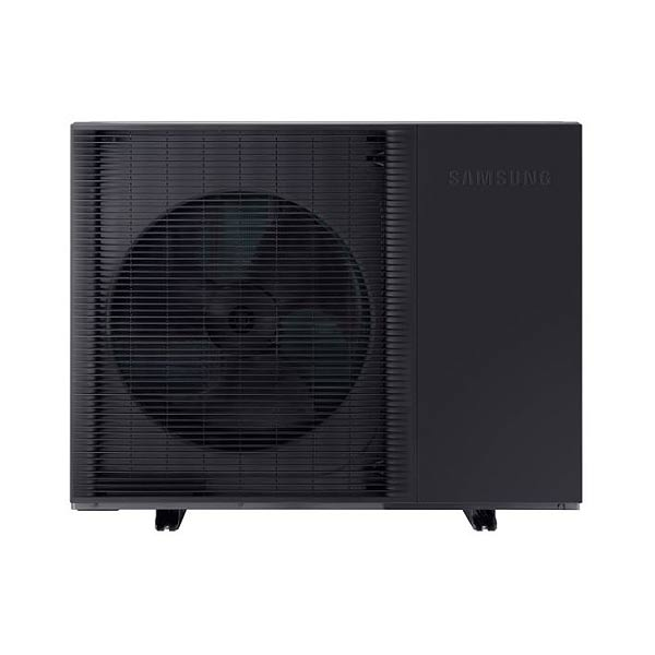

Of all the noise sources of a HP, the hardest to silence is the airflow. Compressors, expansion valves, pups etc can all be put in a soundproof box, on isolation mounts etc. But the air rushing through the heat exchanger and the fan powering that must be out in the open air. We use fans to reduce the size of the heat exchange area, but what if we just increased the area instead? A 1200x1200 triple panel radiator would extract 6kw if the delta T were 50C if we make a more conservative dT of 20C you get about 2kw. So if we had 3 of those 1200x1200 triple radiators we could extract about 6kw of heat using a dT of 20C (i.e. the refrigerant was at -25C when external air was -5C) Ecoforest have a system where they pump the "brine" for the GSHP system through some aero heat exchangers (i think danfoss used to have a similar system) So if we stuck 5 or so of those rads on the outside of the house (let's say on the upstairs between the windows so the effect was not unlike upstairs cladding) and pumped brine through them to a plate HX heat pump..... -
Beginning of the end for MCS?
Beelbeebub replied to sharpener's topic in Air Source Heat Pumps (ASHP)
In the US the "cube" style heatpump (mainly cooling) systems are common. They have a fairly large heat exchange area in a compact form and the fan points upwards. Even for a given noise output, if the majority was going upwards the effect of multiple units would be much less as there would almost never be anything for the sound to bounce back from. This would be particularly the case if the units were not ground mounted , but wall mounted on the upper floor, much like many horizontal heatpumps are. -
