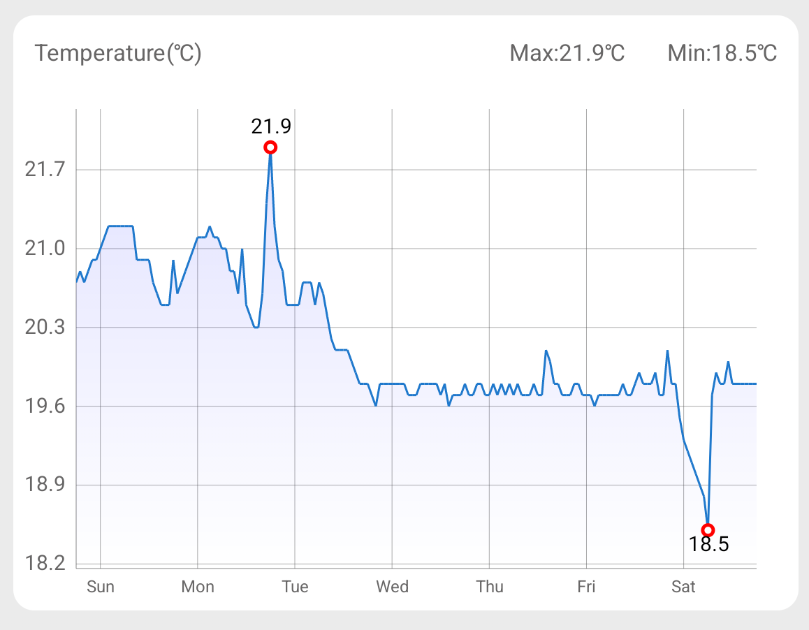

  11. Fan comfortably kept the room at 20C (low point of 19.7C) whilst it got down to 1C outside. Fan was on maybe 2/3 the time in fairly short bursts (my thermostat is a bit twitchy) flow temp was 40C ish, probably a bit below.

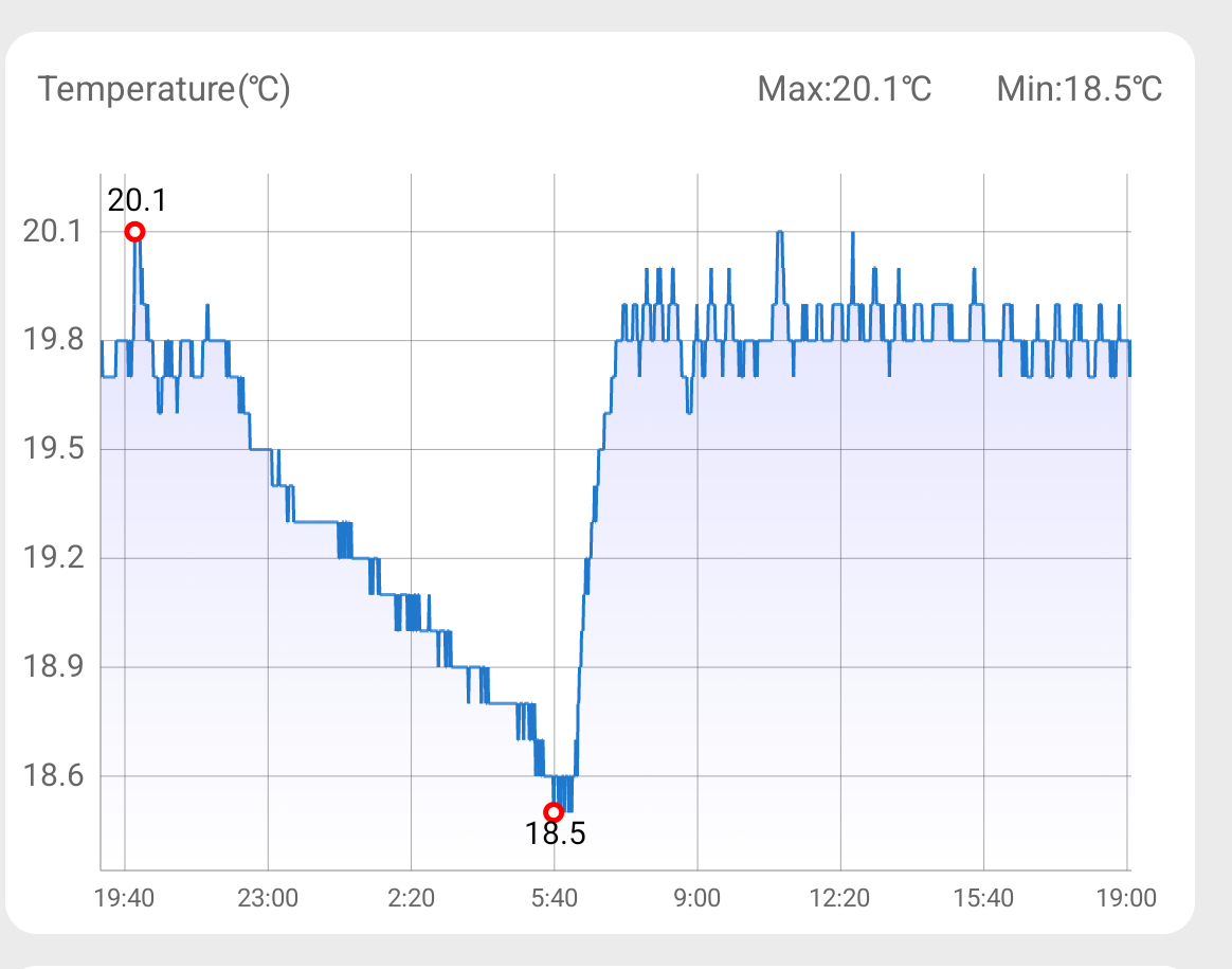

  23. Little zoom in on the 18C setback.

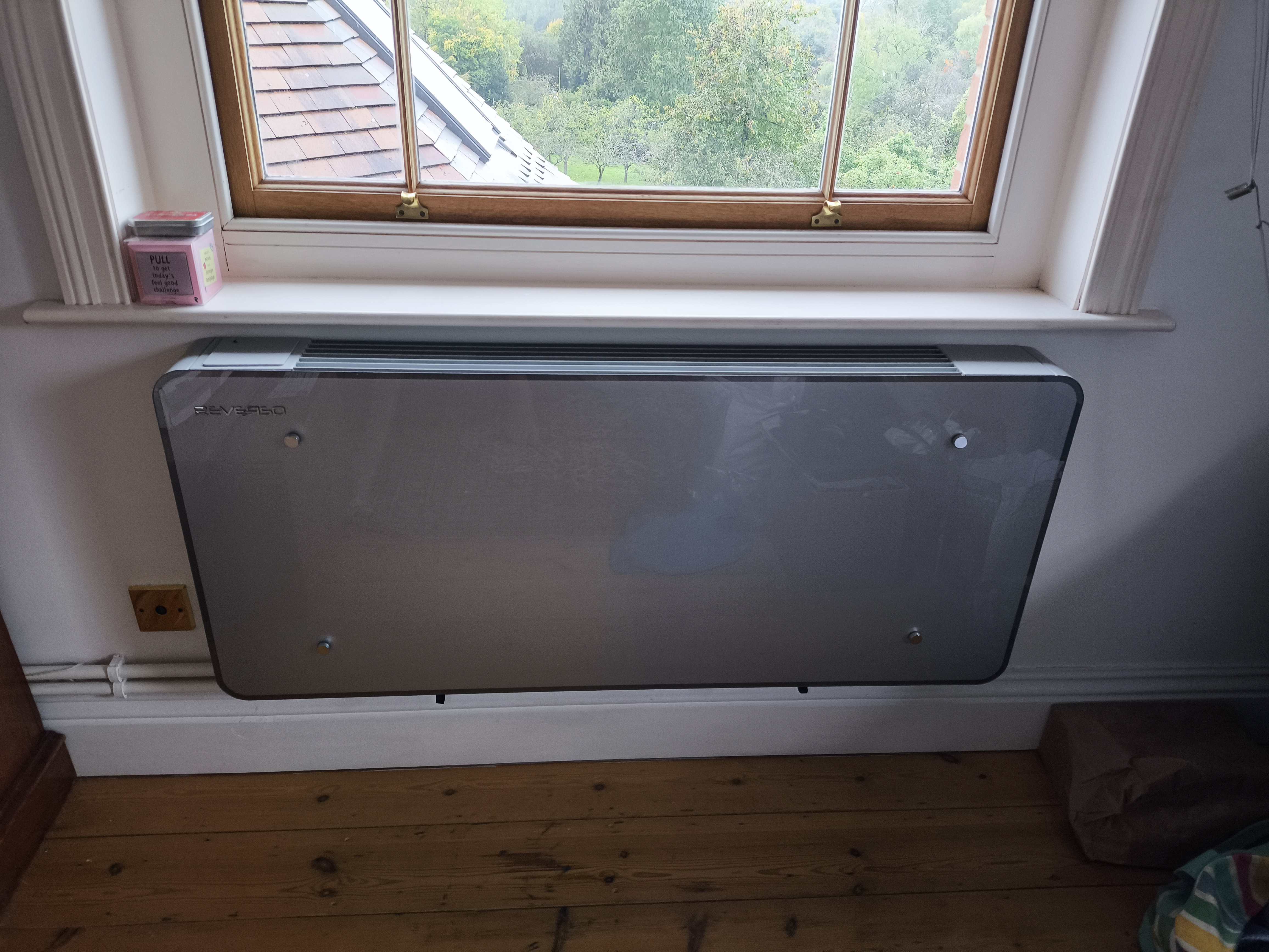

  24. So I fitted a reverso fan coil back last spring. Obviously it didn't get much use until recently. It's fed by a 40C underfloor circuit. The whole house is on underfloor so there is a single blending valve for the heating circuit. The fan coil was plumbed in tk replace the dud UFH circuit. The room was controlled by a thermostat (ancient danfoss unit) opening a 2 port valve. The warm water then flows and the unit's fan is switched by a slightly bodged setup triggered when the flow into the coil rises above 37C. Anyway, I have a few days of data to see how the system is handling temperatures. Prior to Wednesday the hearing didn't kick in as the room never dropped below the 20C setpoint The 18C drop on Friday night was due to me setting the setpoint to setback to 18C from 10pm to 6am. This also gives an idea of the unheated performance of the room. Overall I'm pretty pleased. The unit is not running continuously, which means i could have lower flow temps. It is near silent. The biggest clue to it kicking in is the ping from the thermostat relay.
