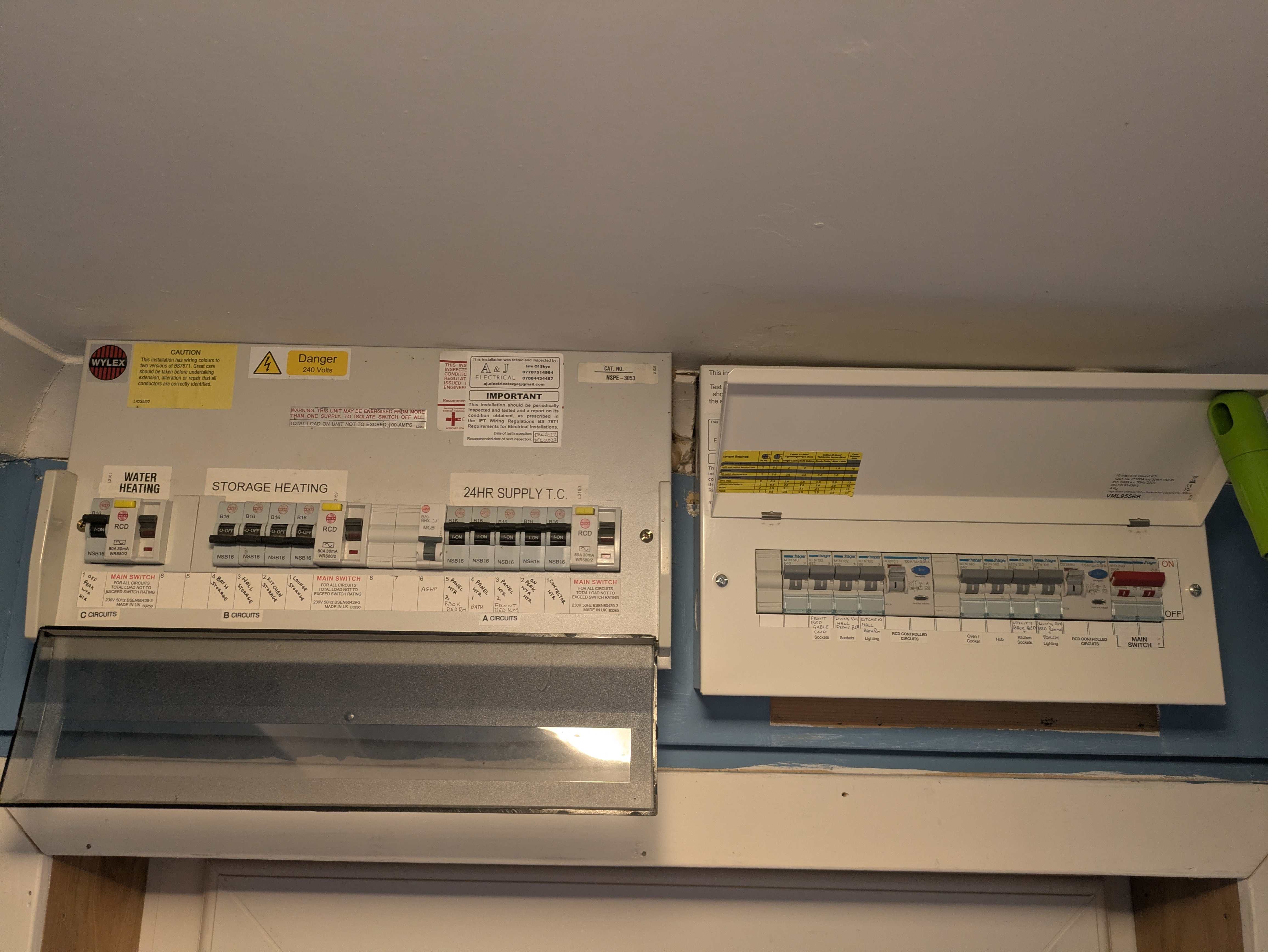

  2. That's exactly what I've done. The A2A just runs off the cheap rate. OVO are trying to sell me their E9 plan which has off-peak dotted throughout the day, but of course none of the times really match up with when I'd want to run the A2A. And the off peak rate is only 1p less than I can get a single rate from another supplier. So the obvious thing to do is jump from THTC straight to single rate, but they aren't offering that. I'm not sure what the implications are for the wiring in the house. I mean, worst case, can't they just install whatever meters are required and just bill me at the same rate for everything that I use?
  3. We're on the archaic Total Heating Total Control which was pretty common for houses using storage heaters, but is now being phased out. The Radio Teleswitch system is to be turned off imminently and we're being barraged with warnings from OVO, the electricity supplier, to get the meter swapped out for a smart meter. This is all well and good (assuming we have a good enough signal for the smart meter to work...) but they will not allow us to keep the current tariff, and are only offering us two flavours of dual-rate as a replacement. From back of envelope calculations, I can see that both will end up costing us more than we're currently spending. It looks like we'll be much better off switching to a single rate (especially once I have done my PV/diverter project) but they aren't offering that. Will I need to get them to install the smart meter first (which they won't do until I've chosen a tariff) and then move to single rate, possibly with a different supplier? Just FYI, we are using A2A heating so low overnight rates are of little use. Good for the immersion heater but that's all. What we want is the lowest possible rate accessible 24/7, as the times that we tend to run the A2A don't line up with off peak hours. And once I have my panels and diverter in place, I'm hoping that our immersion usage will drop substantially over the summer months, which is when the house is mostly occupied.

  17. Having lined them all up for comparison, it's now very hard to look past the Eddi! Hopefully something will crop up on eBay.

  19. @Roger440 how much of the gear have you already bought? The only way to guarantee no benefit is to leave it uninstalled. Just because you can't get the optimum use out of it doesn't mean it's pointless. You have to install the panels etc eventually, might as well do it now and you'll offset a bit of energy. And you can feel smug because you're doing your bit to help decarbonise the grid.
  20. You could load shift to when the sun is shining. Better than leaving those panels sat on a pallet. Link?
