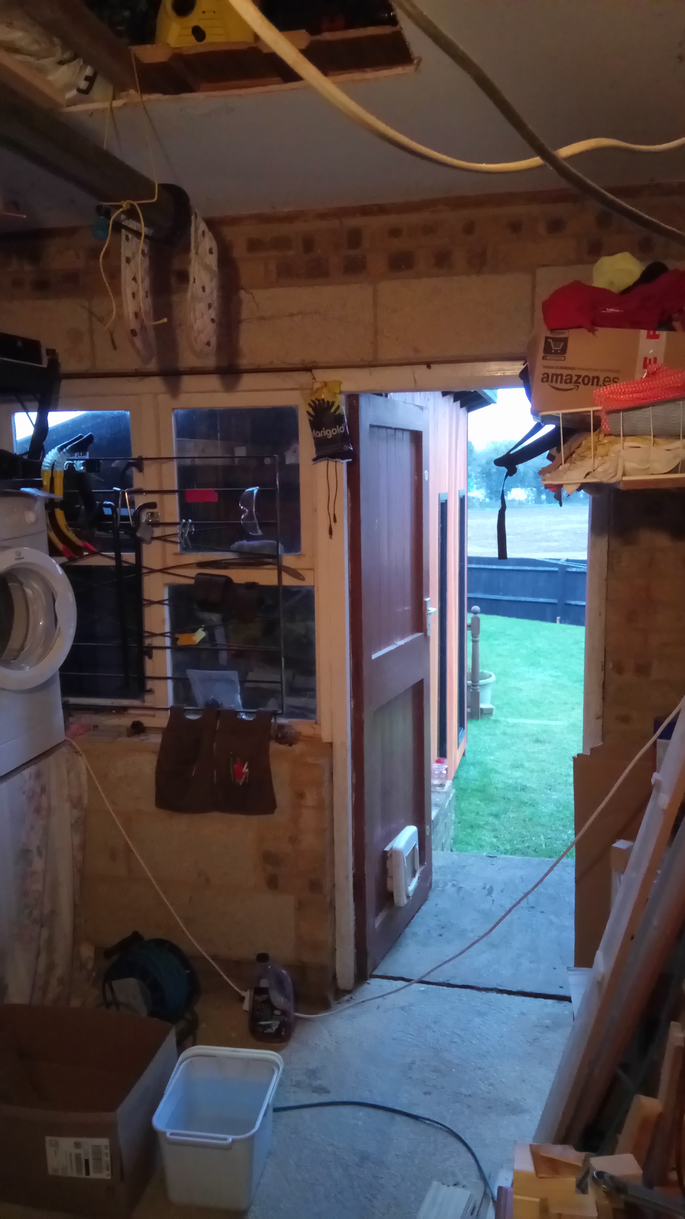

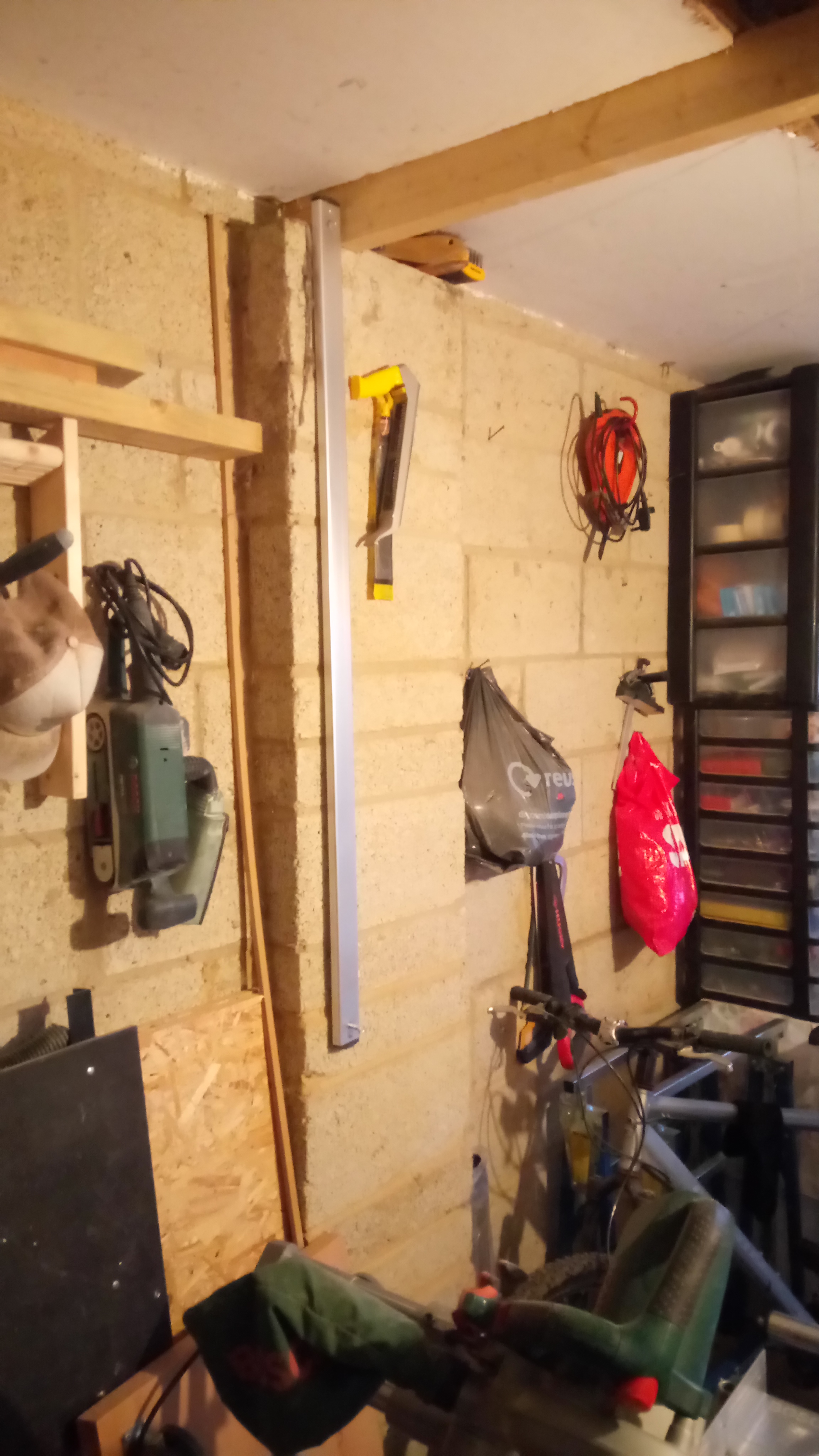

AliG the price limit is one thing I have to be really careful of as the house is currently one of few with this much space even before the planned above garage room, I am going to be speaking with an estate agent soon to fire a few questions at them regarding this. I am now planning on keeping the garage and for convenience I am planning a door from the utility room into it. The size of the space I create will hopefully be enough for a double bedroom and bathroom and as you said a clad box I was thinking SIP panels might be the answer. I have just remeasured the garage internally and its 2.6m x 5.1m and the centre wall is breeze block including the weird buttress like thing in the middle (see pic) -

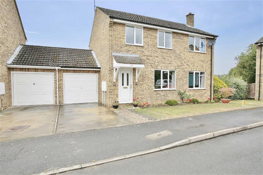

Hi ProDave, I had the same query regarding the neighbor going the same route, Alphonsox posted above about a joint conversion. I have no plans to sell the house on I am just looking for extra space and to add value for when we sell in years to come. The land to the right is the neighbors garden ;-) Hey Steptoe I was the same a few years back until I was taught the ways of the estate agent :-) . All I new was Terraced, Semi or detached BUT then all of a sudden they started using Link Detached as it had no habitable rooms joining them (Also as ProDave mentioned above). I did label my piccy in the original post as Link Detached . Ta for the info everybody, top quality as per usual -

Eh up and a Happy New Year to the awesome people of buildhub community ;-) So over the Christmas period I had time to think about a few project ideas for the house, one of them being a new bedroom/bathroom over the garage. I am in the very 1st stages of seeing if it is do-able and have a couple of questions that I hope maybe the people at buildhub can advise me on. 1st I thought I would supply a piccy of ma wee house so you can see what we are dealing with Its a link detached so only one of those garages is mine unfortunately. So I would love to take the roof off the garage and build up one story giving the space I need for the bedroom and bathroom, the staircase runs straight up from the front door so is in a perfect position as all I would need to do is knock a landing through the wall into the new space. I wanted a door but regs and space at top of stairs wont allow it. I know the foundations of the garage need to be quite deep for this to be allowed by the local planners so here is the question that I am unsure of, IF I build with wood frame/SIPS or regular brick does this make any difference to how deep the existing garage foundations have to be. I was thinking the SIPS constructions would be lighter and therefore not putting as much stress on the garage below. I have always been very interested in the SIPS build method since back in the day when I was planning to build my own house. I have this vision in my head of having a warm roof so the bedroom ceiling is vaulted but that's just pie in sky stuff at present. Anyway that's enough warbling for now so if anyone has any thoughts on my project I would love to hear them, Ta very much people ;-)
