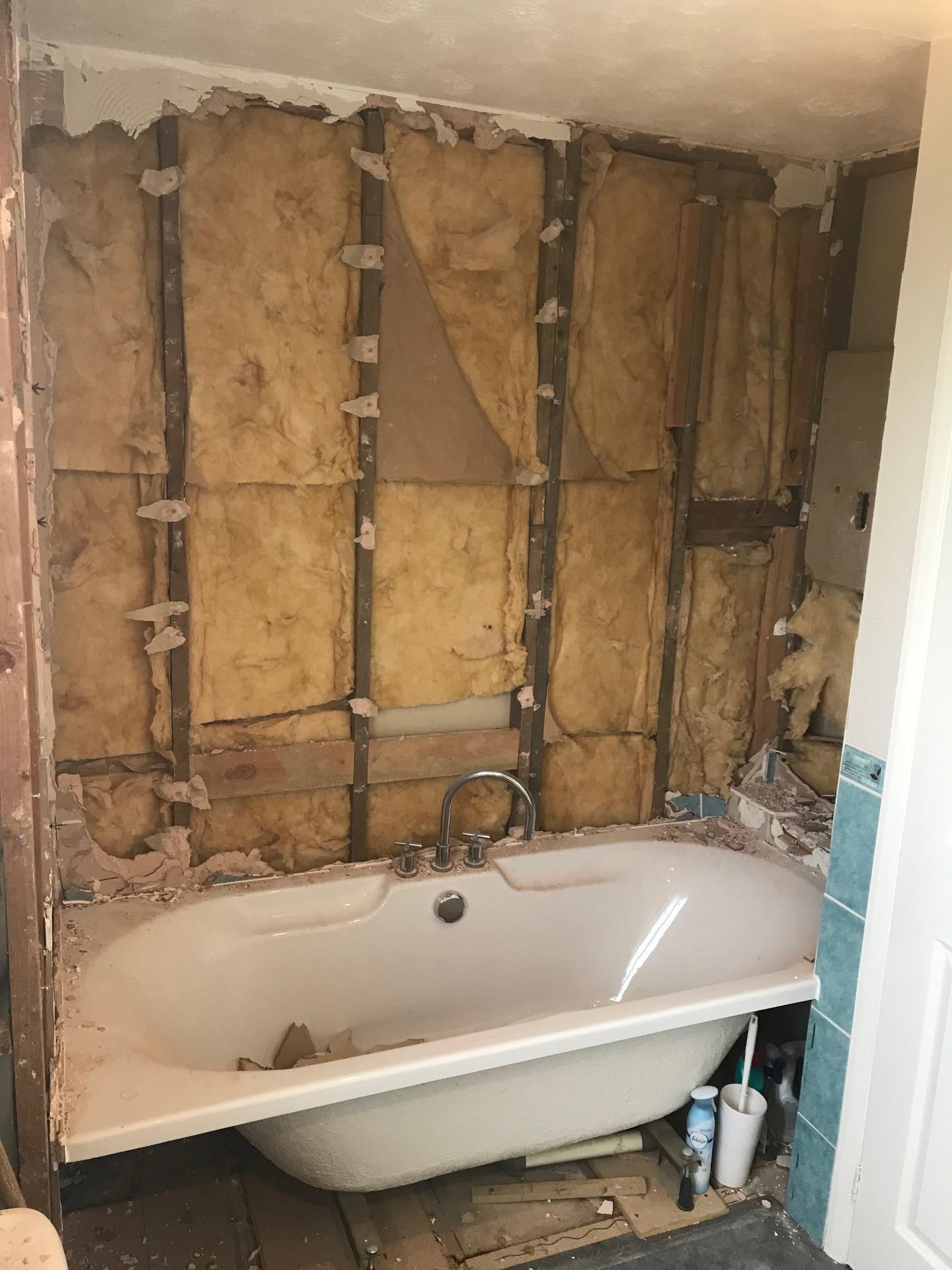

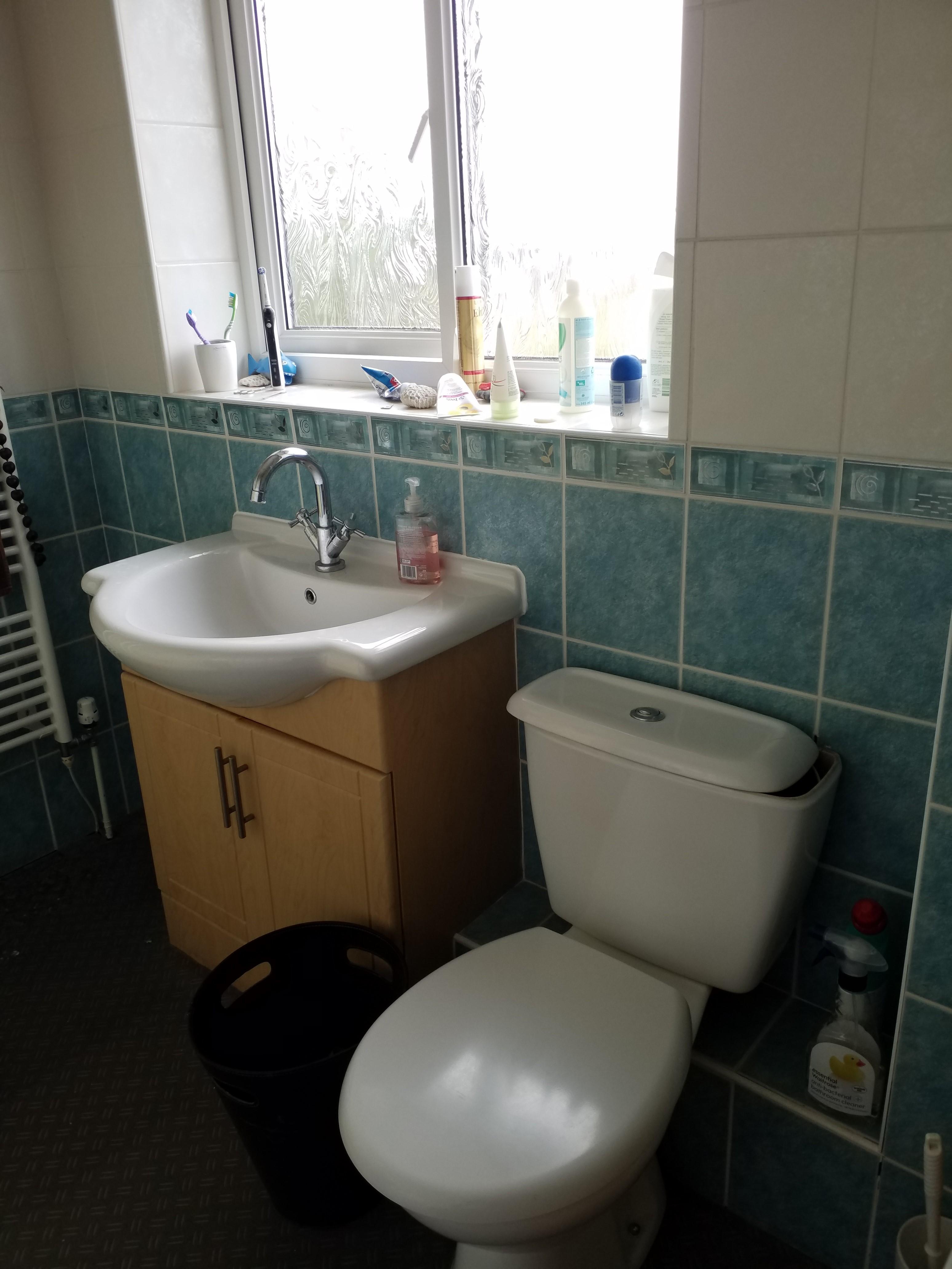

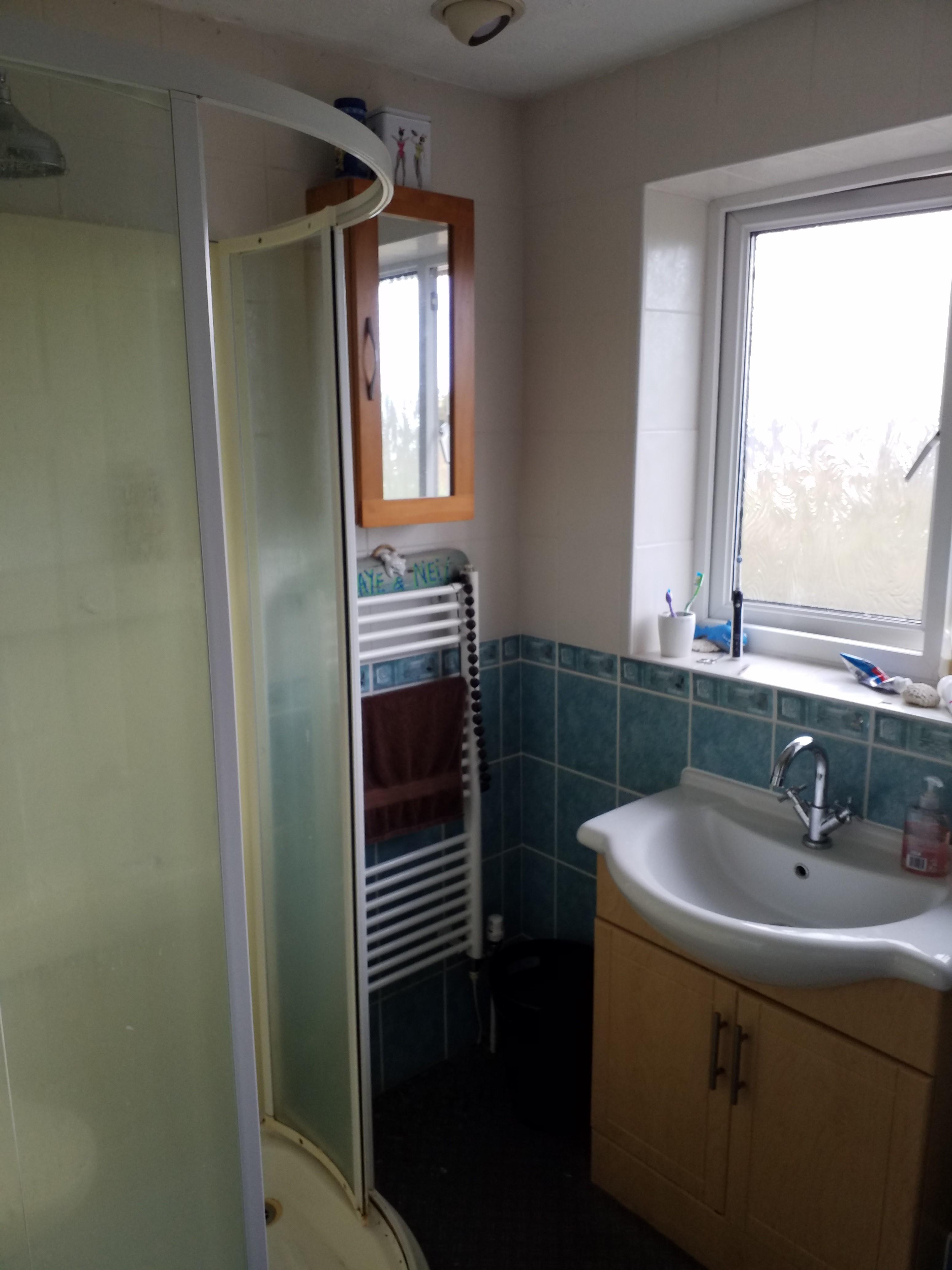

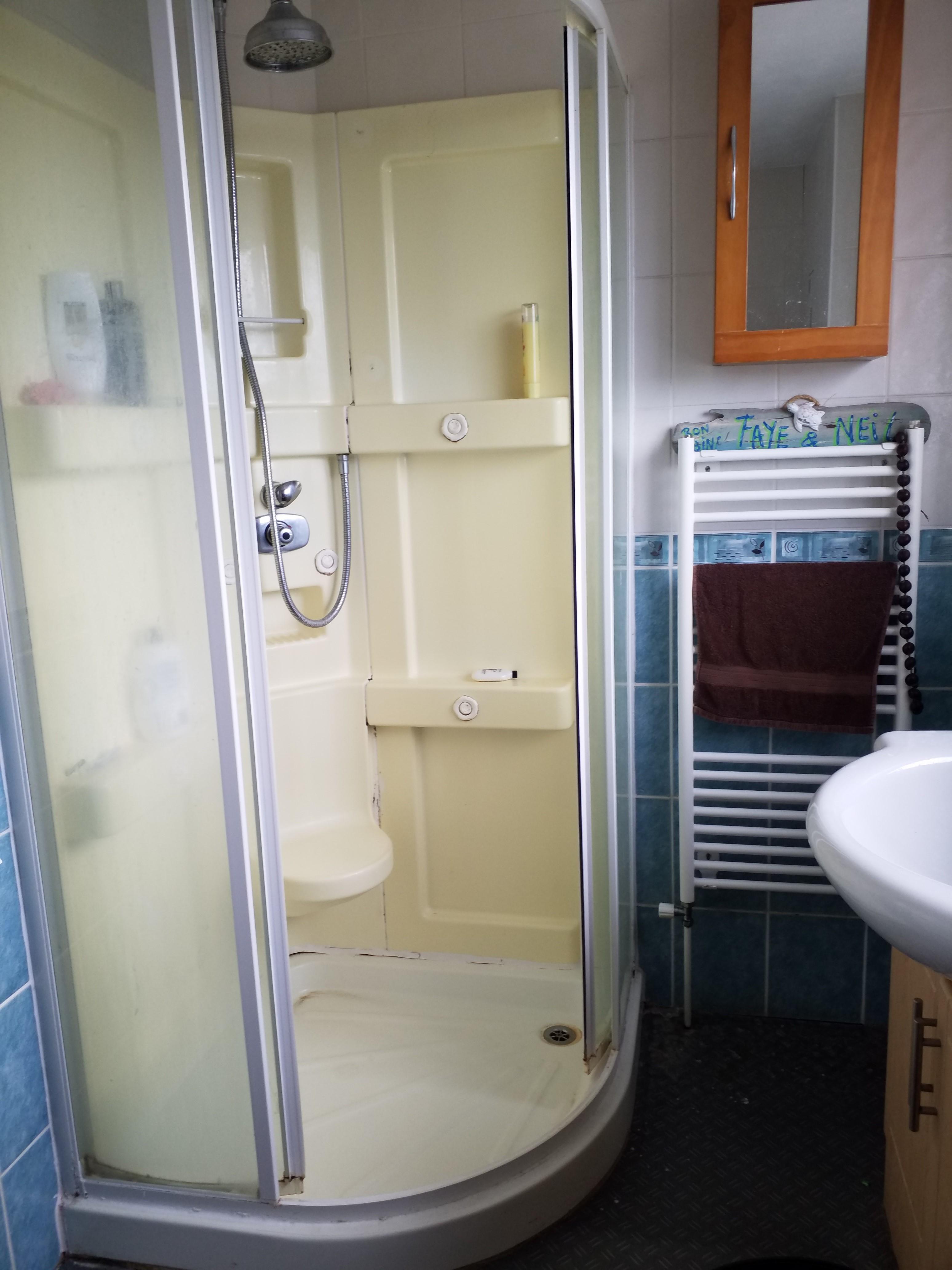

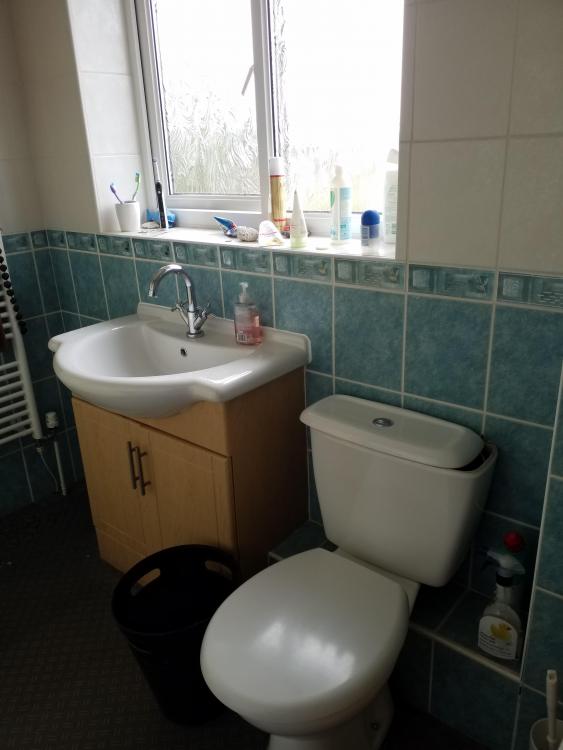

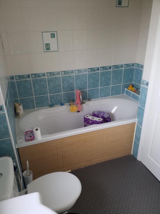

  1. The suite is about 25 years old except for the bath that the last owners installed to sell the house. Never ever use a bath so that's been a waste of space for the last 4 years but the monster spiders think its great, the shower tomb is a death trap ? and I smash my elbows on it when showering as its so small. It used to have massage jets but last time I tried to operate them the garden ended up getting more water than me.? The lighting gives off more heat than my oven......blah blah blah thus the need for a new bathroom?

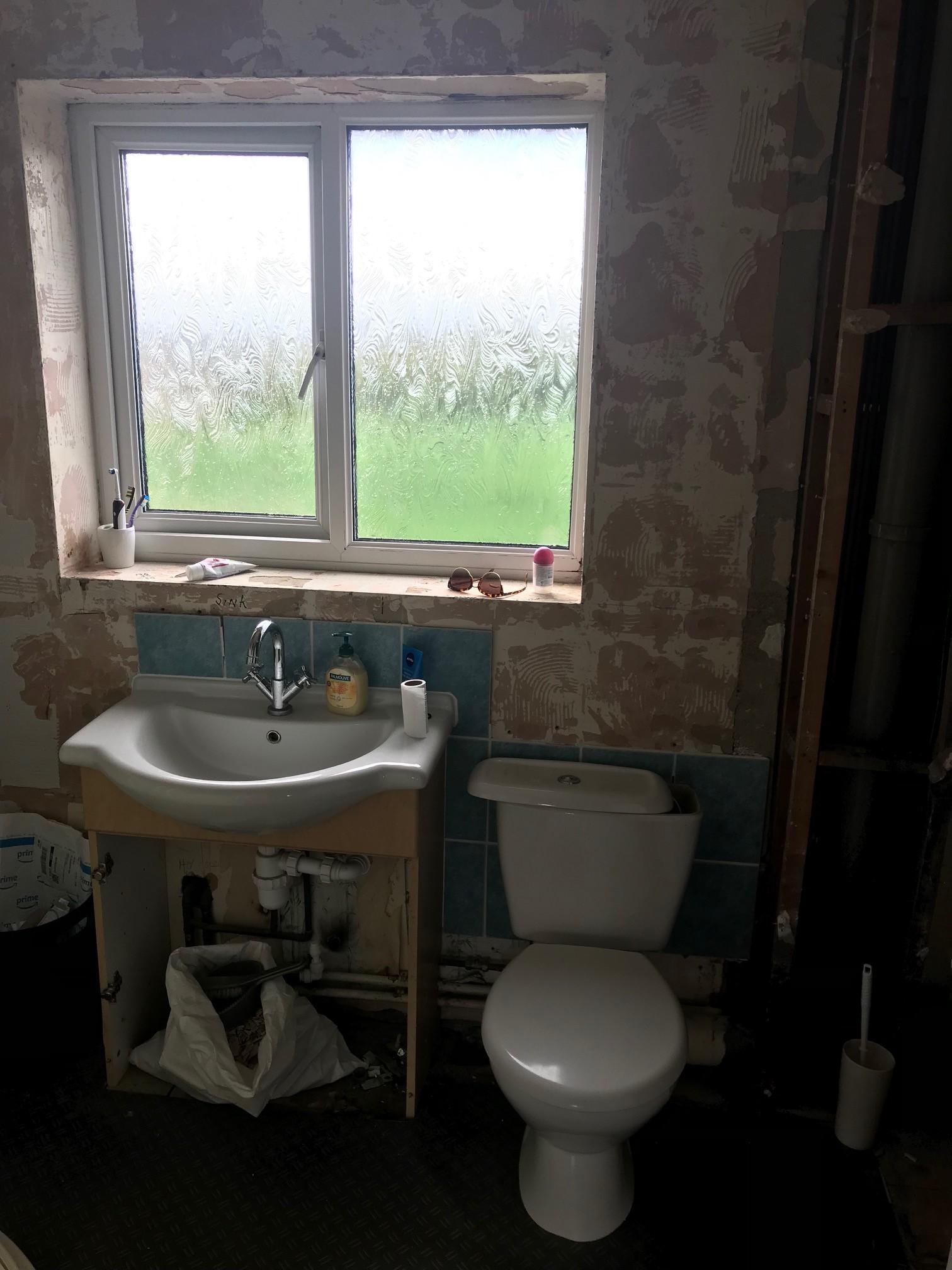

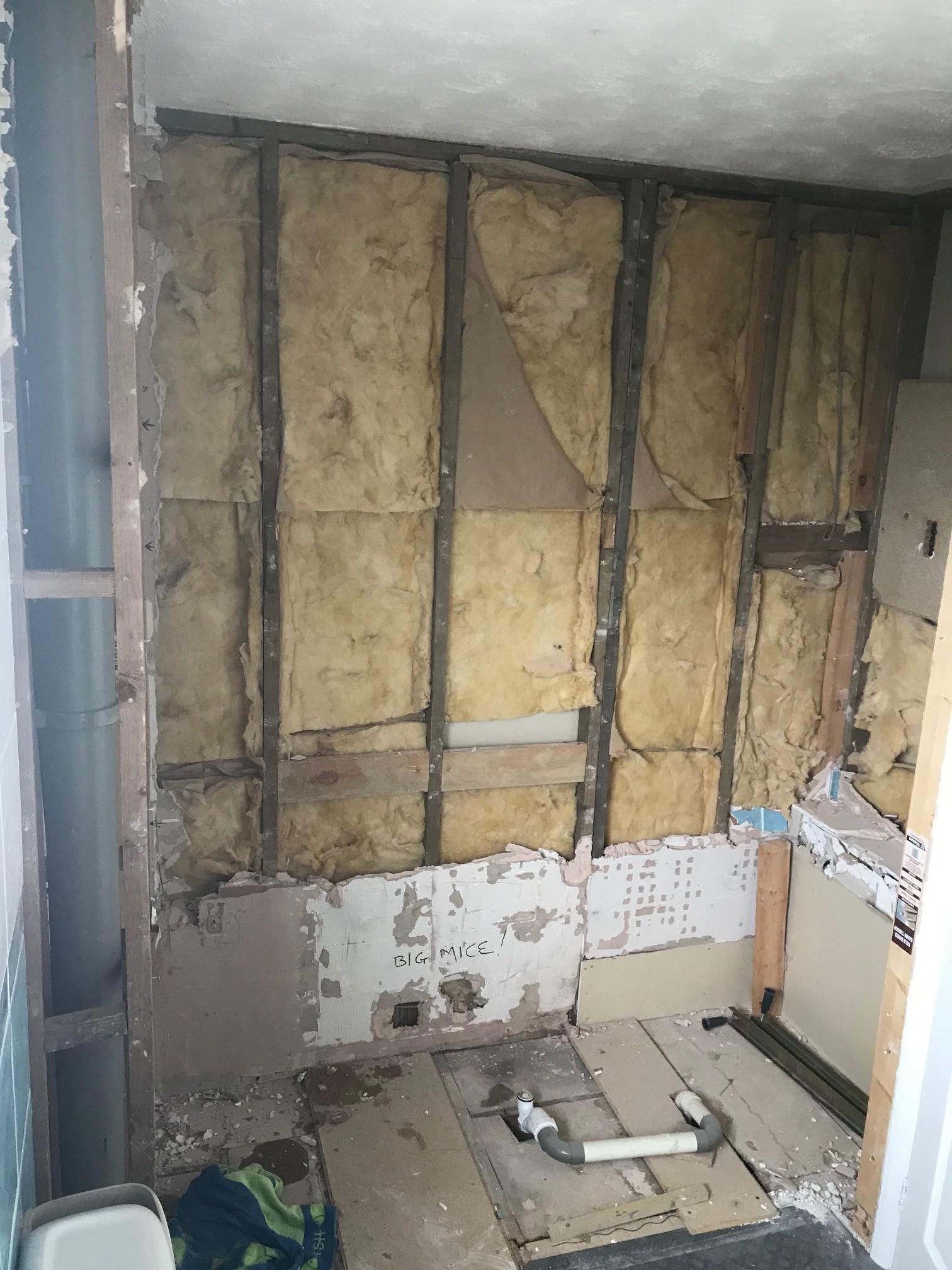

  3. Hi all I have decided to fit my own bathroom due to my bathroom fitter letting me down on dates and just wanted to check in on build hub to make sure I’m going about things in the right manner. In the past I have completed quite a few DIY jobs around the house but nothing as complex as the bathroom so am treading cautiously. I am currently ripping out the old bathroom and have just booked a plasterer to come in in about 10 days time so hopefully I should have finished all the plumbing and laid the new floor by then. I am placing noggins at 250mm intervals in between the joists to give good support for the 18 mm plywood floor I will be lying down and hopefully this will support the tile floor and the stone resin tray properly. I have purchased some KA bond SBR to seal all sides of the plywood which will then be glued and screwed to the joists, I will also leave a couple of millimeters gap in between any joins in the plywood. After the floor, pipework and plastering is complete I plan on fitting a stone resin shower tray, The instructions for the shower tray inform me to use a acetic silicone to lay the stone resin tray onto and also makes a point of not to lay the stone resin tray on a concrete/cement base. I have not purchased any acetic silicone and so was looking for recommendations on what brand to buy? I have also just purchased an Aquaseal wet room system kit so hopefully that will do a good job with the tanking, The walls of the shower area is mostly solid block work but has a small plasterboard cavity at one end where the shower pipework will run. I have also been studying the tanking thread here on buildhub and plan on sealing around the edges of the stone resin tray with silkaflex as demonstrated brilliantly by Nickfromwales. This is as far as I have got with my planning at present but any advice from you guys will be much appreciated. Pics of what is being pulled out: Making a start:

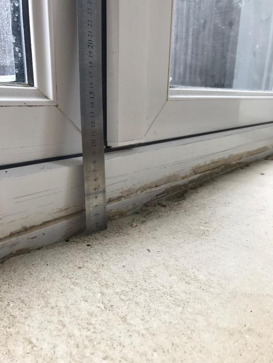

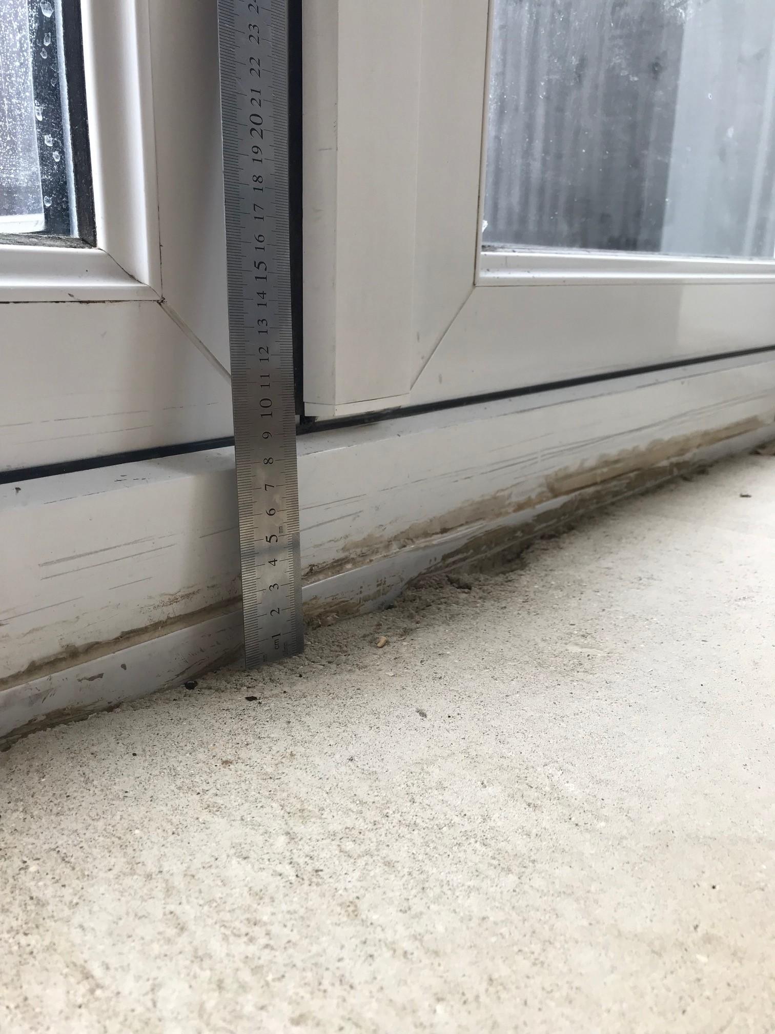

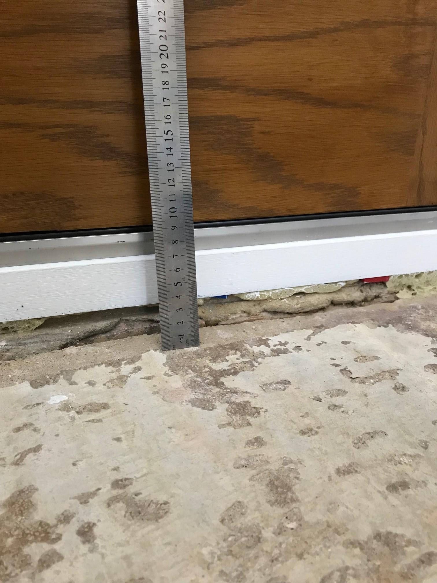

  17. I'm going to be laying a floating engineered wood floor but I'm puzzled about the fitting at the back door and PVC double doors as in pics below, What do you use to build up to/tidy the gap? Googled for a while but found no useful info or pics, maybe I'm not using correct search terms. Any help mucho appreciated?
