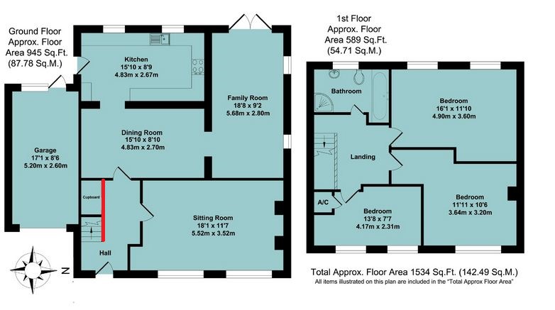

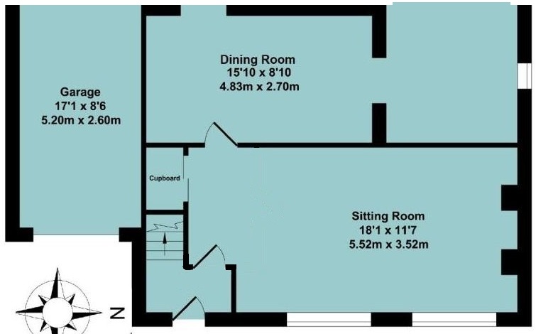

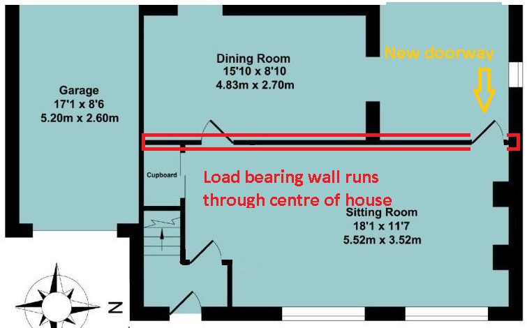

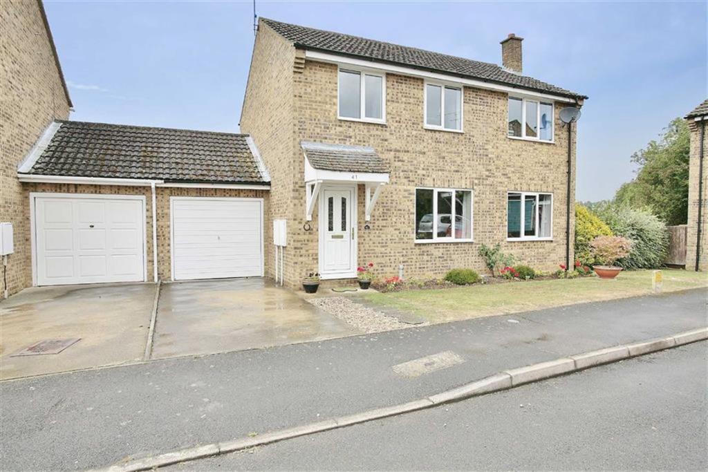

Hi guys I am installing a concrete lintel in a single skin block work load bearing wall and just wanted to run through with you guys how I am going about it just to make sure I'm on the right tracks, I have searched google for most of my info but every project is different so I thought I would run it through with the Buildhub crew. 1st off background details: I have a house - pic below The footprint is width 7m x Depth 6.32m - see pic below The trusses run front to back of the house and there is a Block work central wall which runs the entire width and this is where I want to create a new door way - pics below Above the ground floor load bearing wall is another block work wall that kinda follows the same path and creates part of the 1st floor rooms and above this of course is the roof. So that's the background info out of the way and here is what I have made decisions on so far. Lintel to be a expamet pre stressed reinforced concrete lintel as in link http://www.diy.com/departments/expamet-pre-stressed-reinforced-concrete-lintel- l1200mm-w100mm/150791_BQ.prd Lintel specs: Height 65mm Length 1200mm Width 100mm The existing hallway door which sits in the ground floor load bearing wall also has a reinforced concrete lintel so I made assumptions that that would also be adequate for the new opening which is by the way a standard doorway with a planned cut out width of 82cm. Moving onto the pad stones, I plan on cutting one of these to create the pad stones http://www.diy.com/departments/expamet-pre-stressed-reinforced-concrete-lintel-l900mm- w100mm/150788_BQ.prd I decided this route for the pad stones as the pre made pad stones came in at nearly £30 each and the to be cut up lintel is only £9 I will seat these either side for the lintel on a bed of mortar and as these are only half the height of the existing blocks so I will have 2 each side. Mortar mix - should I buy pre mixed? Should I buy a Mortar Gun to force the mortar into the gaps, have read that mortar needs to be quite thick for lintel installs so may not apply very well from the gun? I have read about packing the space above the lintel with slate so I plan on using the following https://www.travisperkins.co.uk/Estillo-5-Prime-Spanish-Slate-6-8mm-x-250mm-x-500mm/p/763823 I will be using acros with strong boys as my set up for supporting the above load although the only location for the spines is quite close to the ceiling so its going to ruin my coving but hey. I'm using a reciprocating saw with a giant masonry blade for the cutting of the hole. That's it so far but I'm sure as I get closer to the job in a few days I will start doubting other ideas as I always do. Ta guys

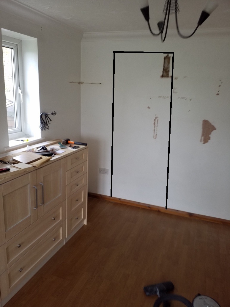

Come to think of it there only seems to be stud and plasterboard on any areas of the house that have been modified since when it was built in 1985, as you say maybe lifting the floor boards upstairs will give a clearer picture of whats going on. the airing cupboard itself is built entirely of breeze block as are the bathroom walls. Where the arch is in the hallway downstairs used to be a door way and I was suspicious of why it was not completely removed when the layout was changed, maybe they just liked arches as there are another 3 made of stone like the one in the background of the 1st piccy. I will be removing them ASAP as I keep knocking my head on them and ruining my handsome looks. Ta Dave

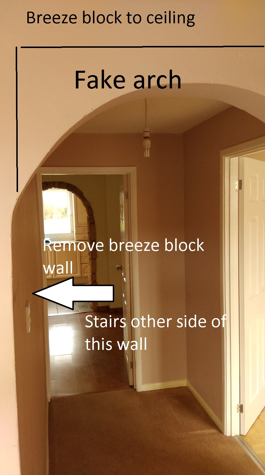

Hello fellow "buildies" I am planning to open up my stairs in the near future but have a few questions regarding its structure and surroundings. hopefully below you can see a picture of what is to be removed and also a floor plan. I would supply better pics but I am away from home at the moment. So when I first started thinking about removing the wall I thought it would be simple but the more I think about it the more unsure I become. One thing is for certain is that the floor joists run from the front to the back of the house so only 1 joist would be resting on the wall. The things I am concerned about is the fact that the wall is breeze block, why the need for it to be so solid? at present as you can see from the floor plan it has a small bedroom above it with an airing cupboard holding a small water cylinder which would have some weight to it but joists run front to back so should be good. So the house on the ground floor has an internal load bearing wall stretching the length of the living room and then stretching through to meet the garage but up stairs the load from the joists in the loft are only supported about 2/3 of the width of the house by the wall inbetween the 2 larger bedrooms as the landing and stairs create a large gap so I was wondering if the small bedroom wall near the airing cupboard are load bearing and transferring down onto this breeze block wall at the stairs. ****The kitchen and half of the family room at the back of the house is a single story extension with nothing above it***** Any thoughts from you guys would be really helpful but I am leaning towards getting a structural engineer to do some calcs. Ta guys - Neil
