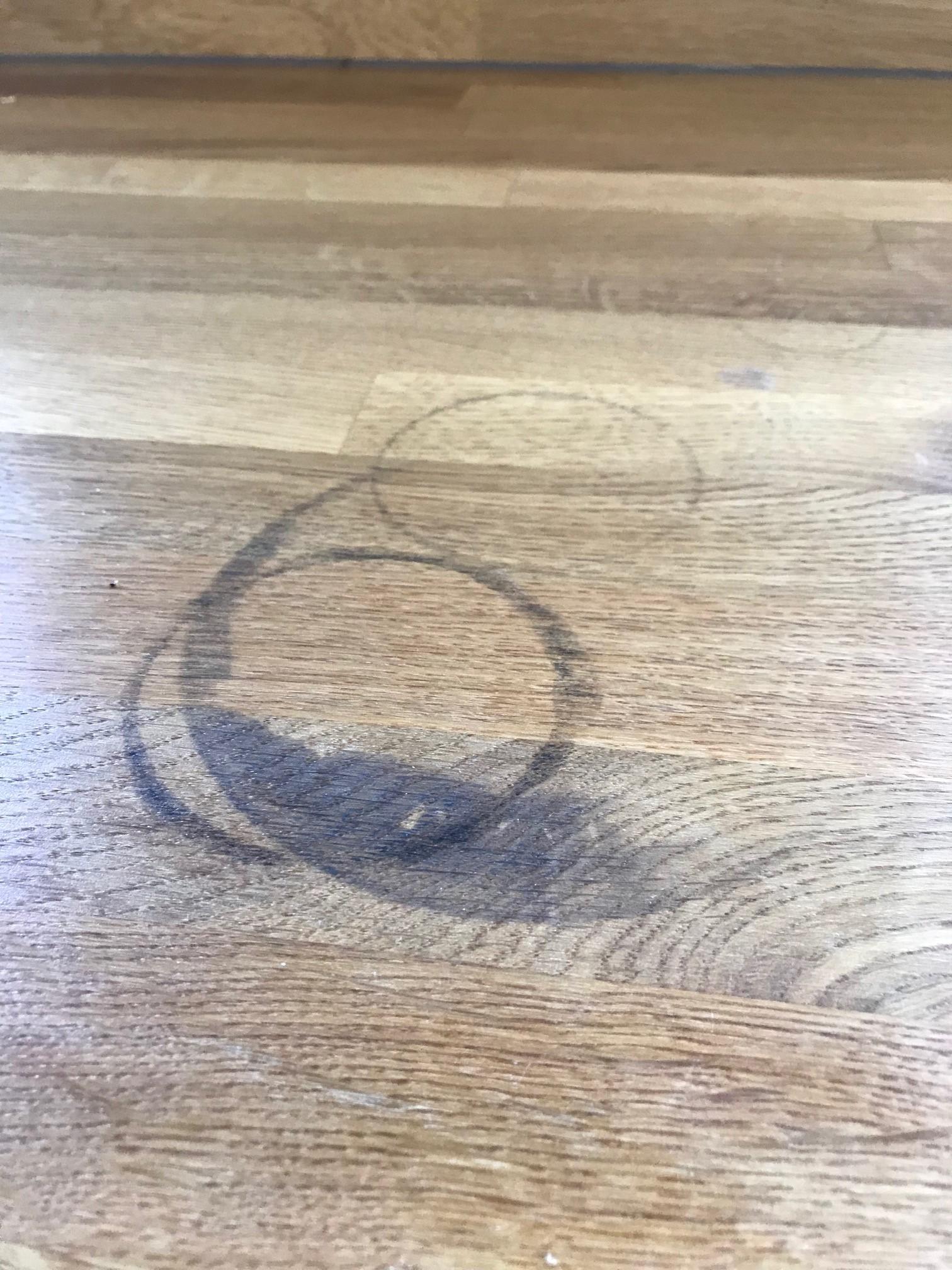

  11. But how is the Iron coming in contact with the oak? I thought the Danish oil would stop this....humph
  12. I am about to blow a fuse as my new oak kitchen countertops are getting black marks from certain metal objects such as cans that have contained food (not soft drink cans) and the bottom of some of my pots and pans. The marking does not happen if the item is dry, it only happens if the item is wet. I have done tests and it is nothing to do with heat, I never put items straight of the hob onto the work surface anyway. I went to great effort to apply many coats of Barrattine Danish Oil to try and protect the new worktops and now this has happened, I am gutted ? Can anyone please please tell me what the hell is going on

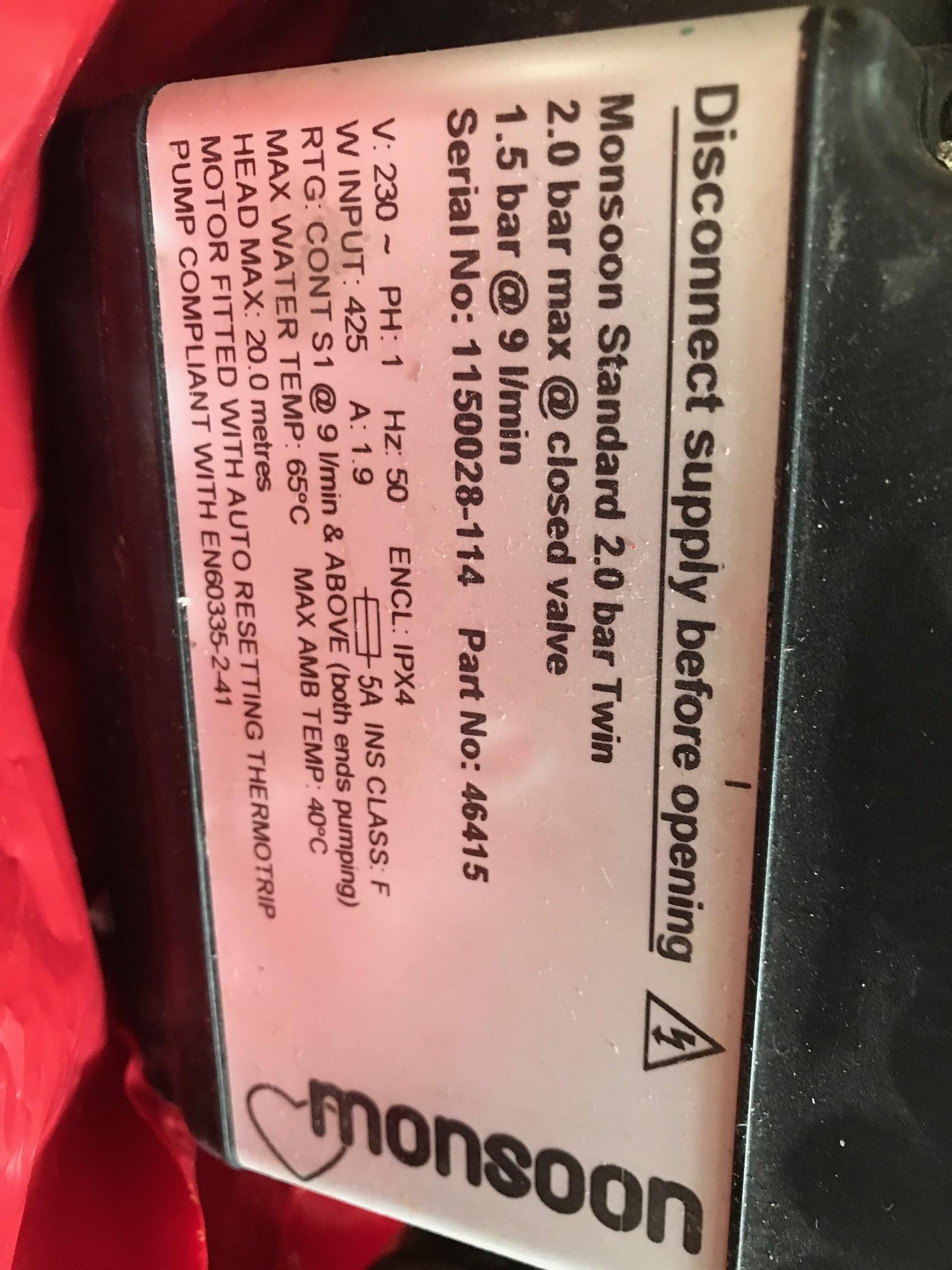

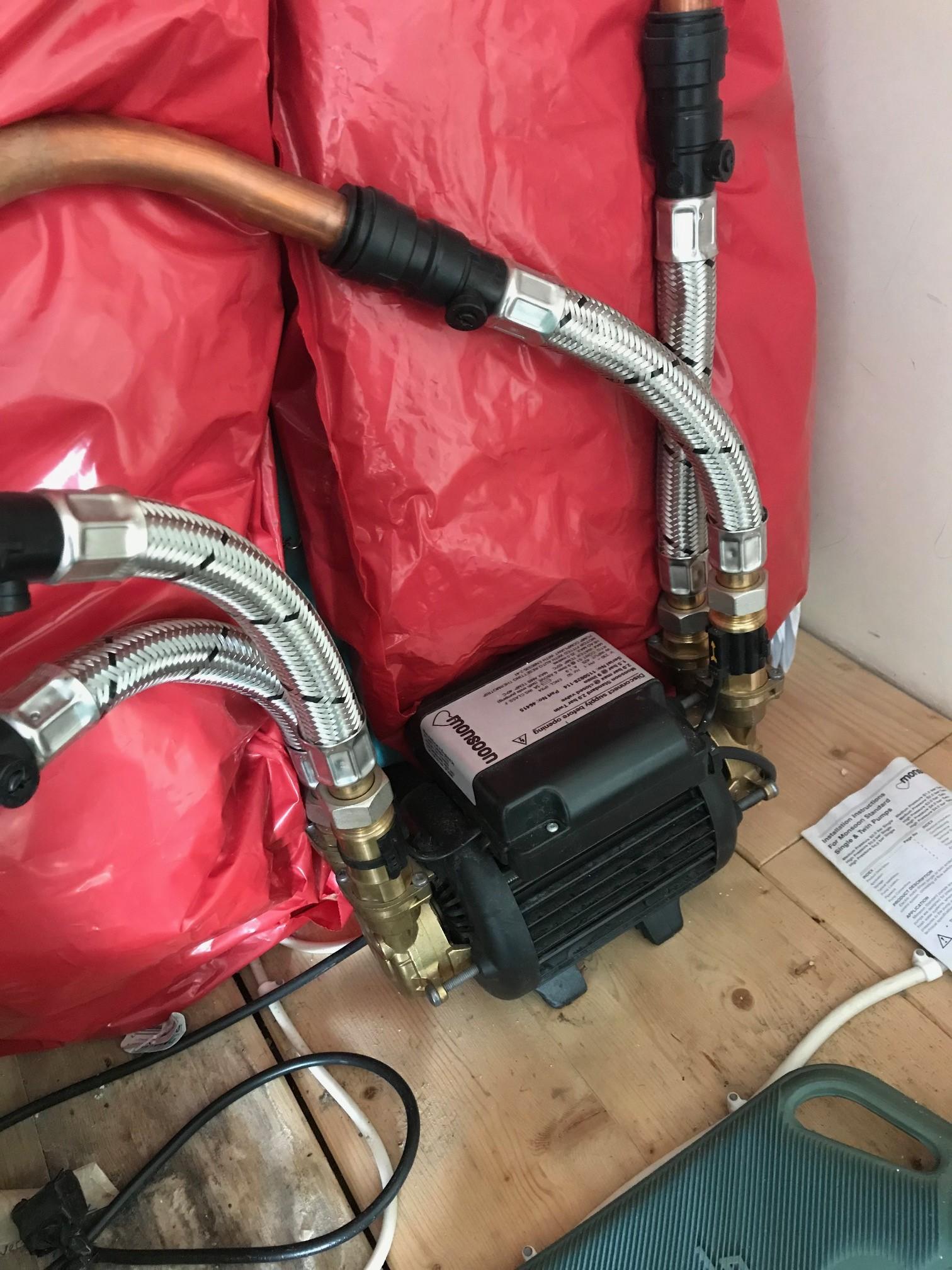

  15. Hi guys I'm just double checking here but do I need non return valves between the my Monsoon shower pump and the thermostatic shower mixer, I'm going towards no as it would interfere with the pumps operation in sensing when water is needed by the drop in pressure and this wouldn't happen if I fitted non returns. ? Pics of pump just in case its relevant - sorry for the rotation of the 1st pic.

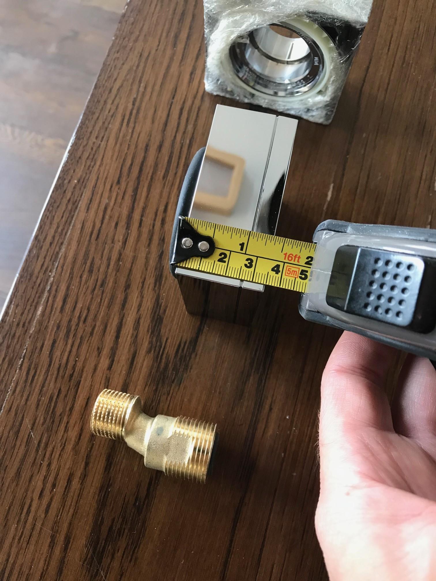

  17. The shroud has a little sleeve inside it which after fitting you pull out over the 3/4 nut ?

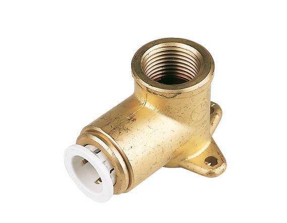

  18. Now that's what I'm talking about, Thanks PeterW. do these fittings have a washer or an olive in between them or is it just a bit of PTFE tape as you suggested

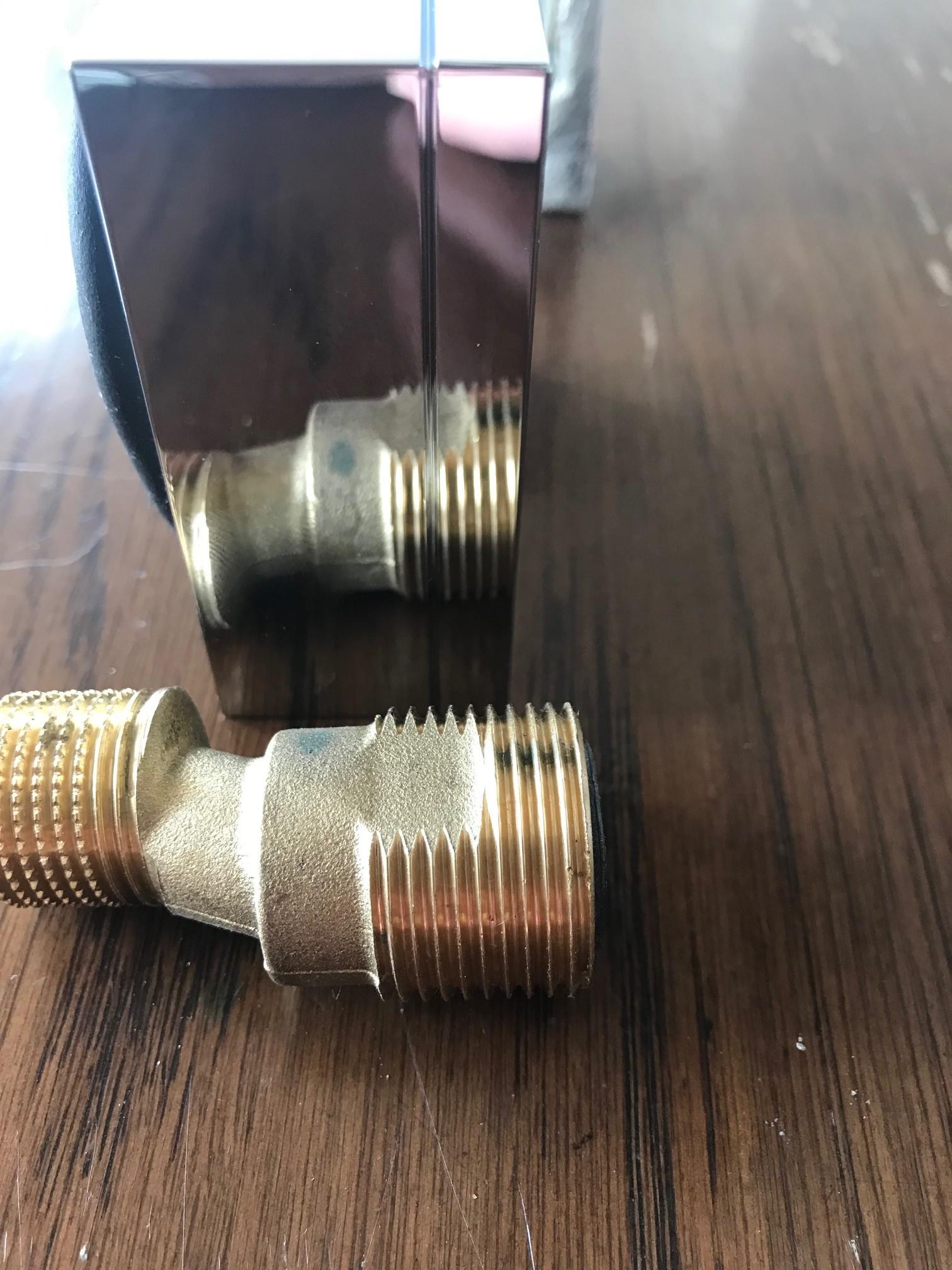

  19. I need some kind of extension in between the wall plate elbow and the Grohe fitting
  20. I though buying Grohe would have a good design and easy fitting but I really regret it now?

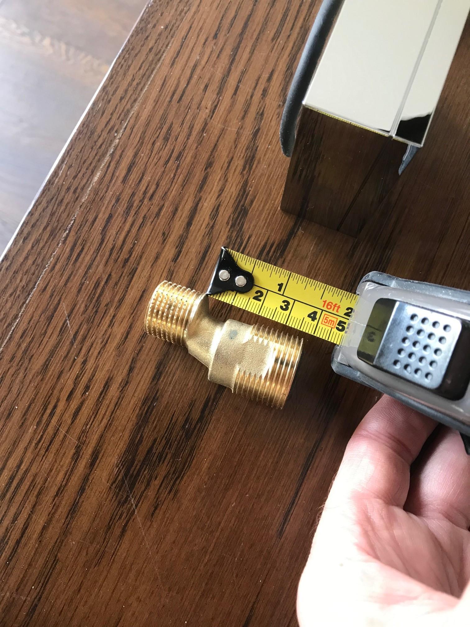

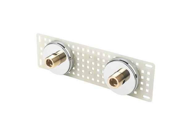

  21. OK so I'd like to fit this wall plate elbow behind the plasterboard cavity which could take the 1/2 supplied Grohe fitting, Grohe fitting BUT
  22. As in my pics the shrouds are 35mm in depth + 1mm for the seal up against the tile so the thread needs to be between 34 - 42mm to putrude through to enable the connection of the mixer bar fixings. If the thread is 30mm it doesn't clear the shroud and you cant tighten the 3/4 bolt from the mixer bar.
  23. Thanks for the reply Onoff, so how would I manage to fix the 90 degree fitting to the wall inside the cavity where my pipes come up from the floor as the whole weight of the shower mixer bar sits on the hot and cold connection? So is the 1/2 bsp is just a standard compression fitting as on a radiator so I can go and take a nut from an old 1/2 fitting and then use a new olive?
