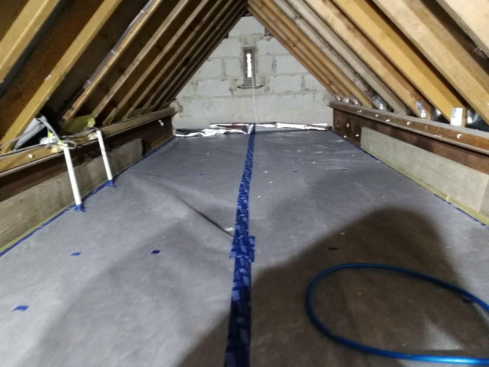

For me what it has is a dual purpose, its wrapped under my steel and joined to the vapour control layer on the large warm flat roof that's connected to the other side of it as I, A) don't want condensation on the warm side of the steel and B) want to get my house as airtight as possible for an MVHR system install and don't want drafts from all of the holes through the ceiling plaster board to the open air ventilated loft. As Radian says the most cost effective and time proven solution for you loft is lots of un compressed mineral wool. On your flat roof there are lots of detail drawing on the web of how to do a successful cold roof. If you leave lots of uninsulated gaps and have ventilation open to the outside as it should be the insulation you have put in it will get bypassed by all of the leaks and massive cold bridges where you've left it out. Also you don't want the ventilation paths above the insulation (to the outside air) being blocked by noggins (you should maintain your 50mm ventilation gap above your noggins). My BCO was happy to see that I'd put a warm roof on our extensions as he saw lots of issues with cold roofs that builders have bodged and blocked the ventilation with cross members for roof lights etc.

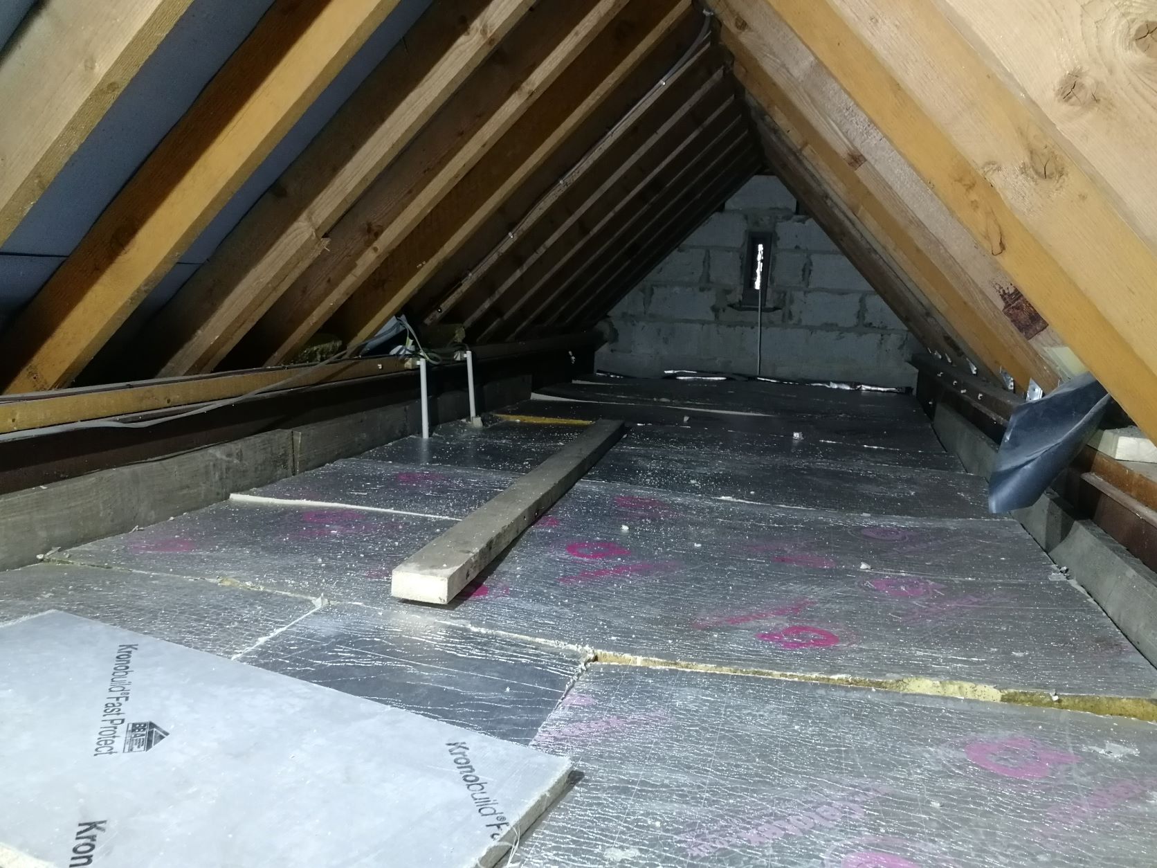

I'd bite the bullet on the flat roof and get well fitted (tight and no gaps) PIR insulation up in between all the gaps in the rafters, plaster board is reasonably cheap and a quick job for a plasterer to plaster a small ceiling. In our loft I installed an air barrier at ceiling level then a layer of 50mm PIR that I salvage from the demolition of our old conservatory (floor) and old extension topped with 200mm of uncompressed rockwool and again some reclaimed timber to hold a deck above it for storage I did have some nice big bits of steel up there to support stuff off though. But PIR is a much better insulator than rockwool just not cheap and not as safe.
